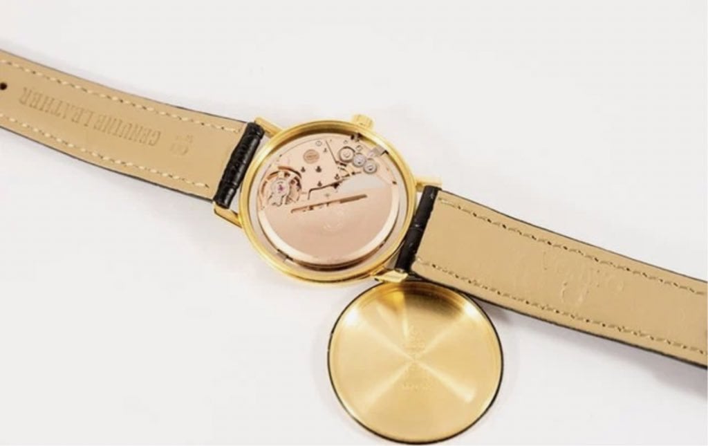

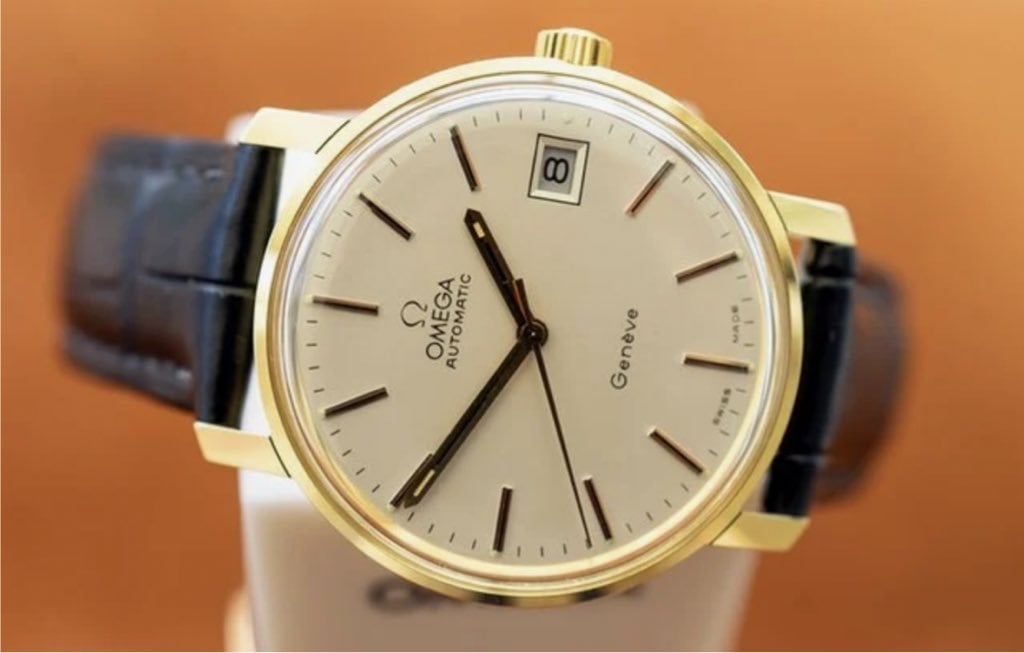

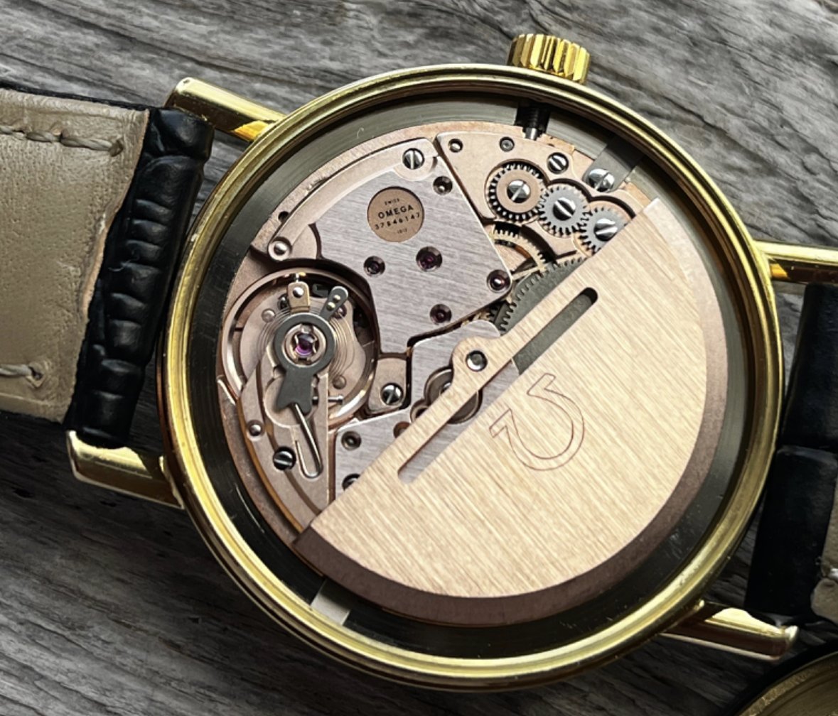

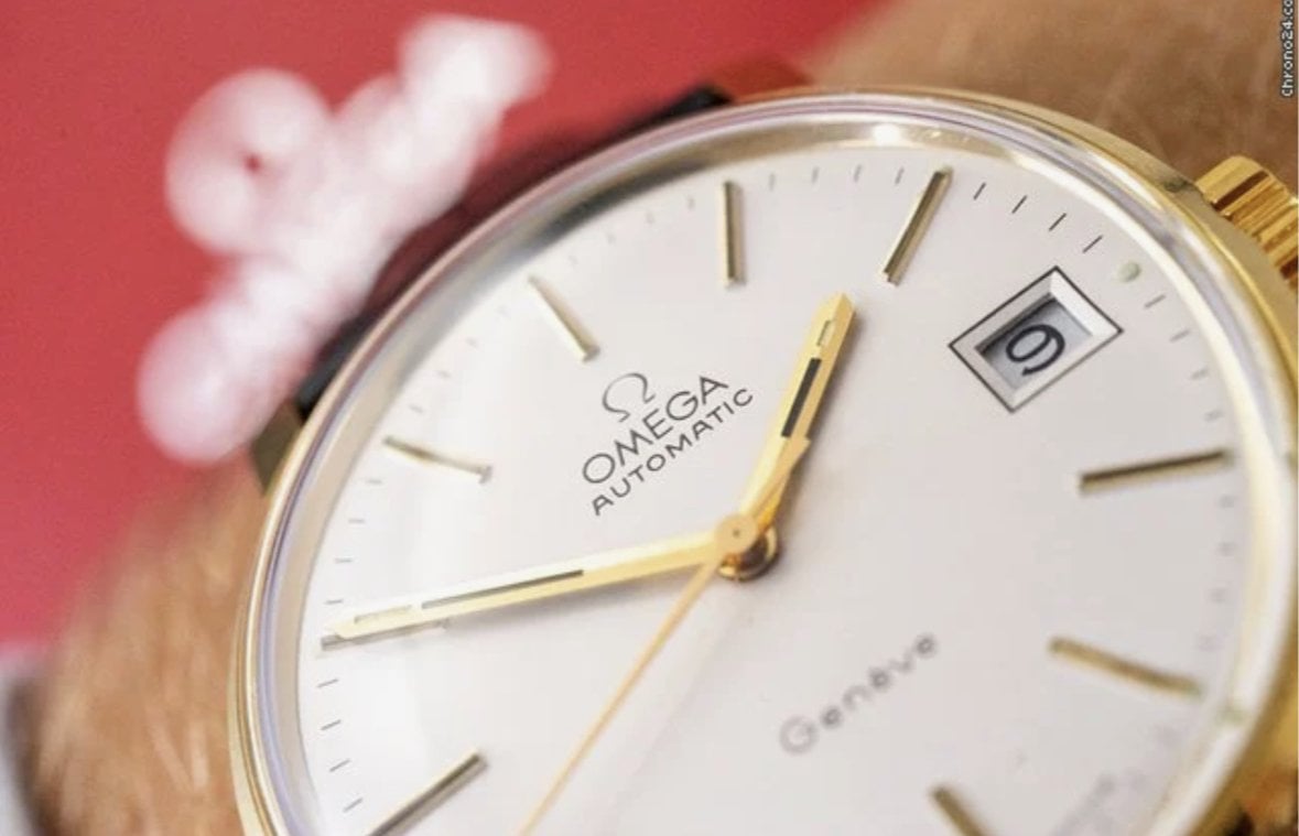

A few things are disturbing me:
- overall aspect seems too « new » for a 50 years old watch with original pieces (except the glass and the band according to the vendor)
- the back case is oddly engraved
- the reference number engraved is 1669163 and it should be 1660163 for this type of watch
- no « 1012 » engraving on the movement nor other engravings on the bridges
- some bridges appears to be in a different color from one photo to another
- the 12 o’clock indice seems too thin
- no « T Swiss Made T » on the dial
- not sure the hands are good for this kind of watch
- Omega logo on the dial feels strange: painted and very thin. I expected it to be applied and golden
Is anyone of you would be able to tell me once for good if it’s a real one or a fake, please ?

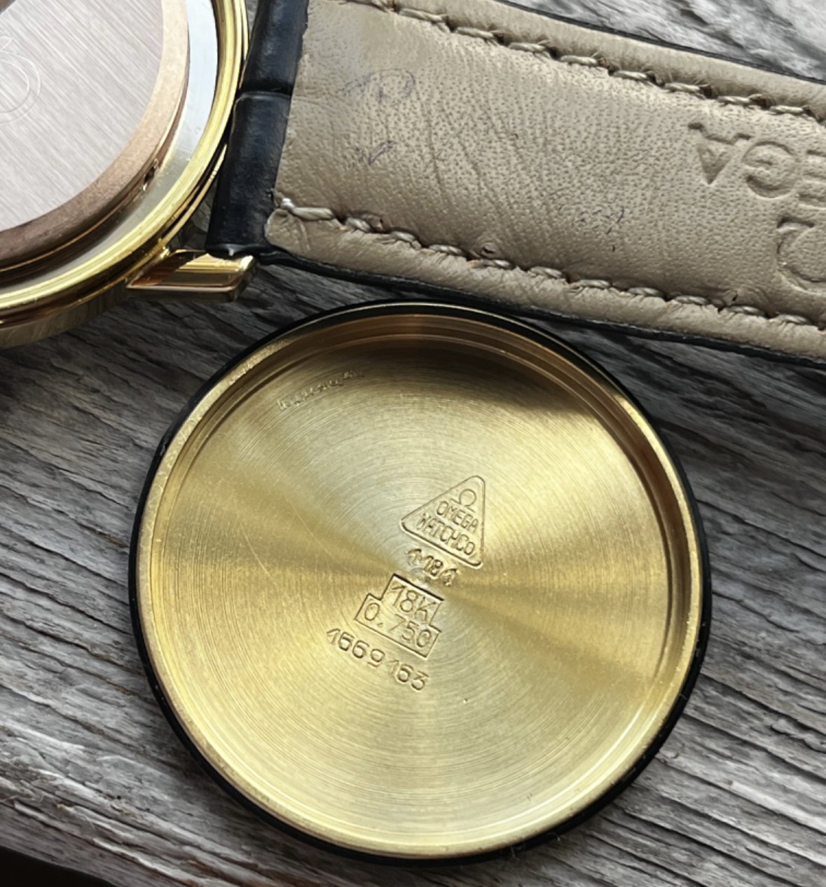

I'm with you on that. No clue whether it is legit but weird indeed
8
Here is the justification I received from the vendor regarding this specific point:
« I'm not sure why they are not printed with "Swiss Made," but my guess is that the cases were locally produced in the country where they were sold. This might be due to high taxes on gold exports from Switzerland. I know for a fact that this was the case for watches made for the UK and US markets.
The movement, dial, hands everything except the case is from Omega in switzerland. The case was produced by Omega in the country it was sold in and the watch was assembled there also by Omega in that country. This is to avoid expensive tax for exporting gold. Google it and you will find information. »
Indeed, I found information on Google saying cases were built in France, Italy, England or Sweden. So I could trust him in this point.
What do you think?

I see no sign that the OP watch was cased locally. It has a normal reference number and no case-maker mark. The Helvetia hallmark appears to be present (twice), although hard to see. Moreover, even locally cased watches are marked SWISS MADE (or something similar) on the dial. I don't understand your concerns about the watch.

Also, it’s really difficult to find another watch from this model and this year with exactly the same hands or back case or caliber with the same engravings to compare. The biggest doubt is on the serial number. I don’t understand why it is engraved 1669163 whereas it should be 1660163 for this model. And I don’t see the Helvetia hallmarks nor local casemaker neither…

You are talking about the reference number, not the serial number, and 166.0163 is a different reference, with different lugs and case, if you look closely. Observe how the lugs meet the case, for example. The Helvetia hallmarks are present, again, if you look closely.
If you google Omega 166.9163, you will find other examples similar to your watch. Interestingly, they are mainly previous sales from Swedish auction houses.
I have no concern about the watch and the condition is good. Continuing to raise questions is a waste of time, IMO. However, from a collector's perspective, it's not particularly desirable, hence my feeling that the price is high. The case and dial are utilitarian, the movement is not especially well regarded, and it's not from Omega's best era. These are nuances that collectors gradually come to understand. But if you like it and it fits within your budget, don't worry about the price, just buy it. Just be aware that you will take a haircut if you ever decide to sell.
