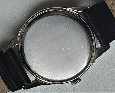

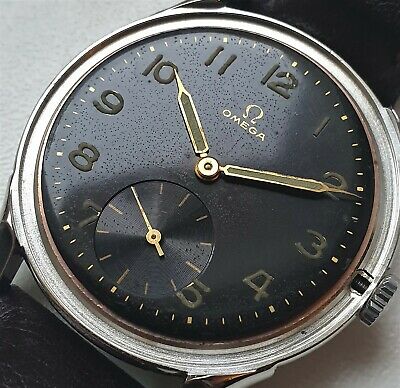

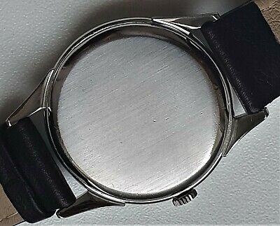

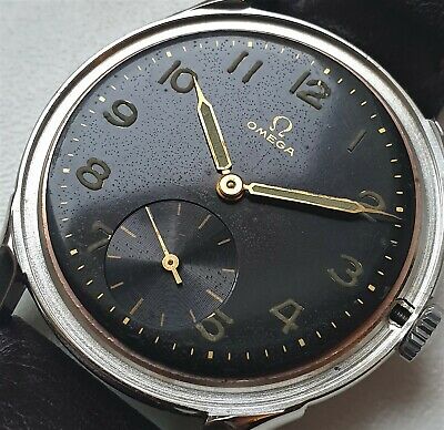

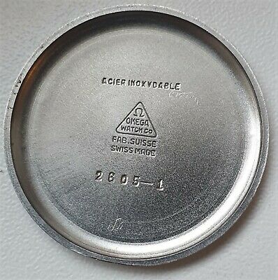

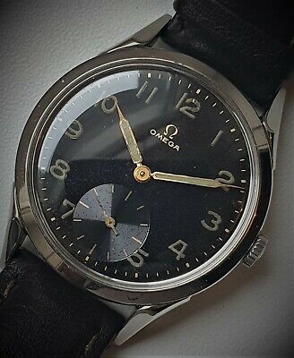

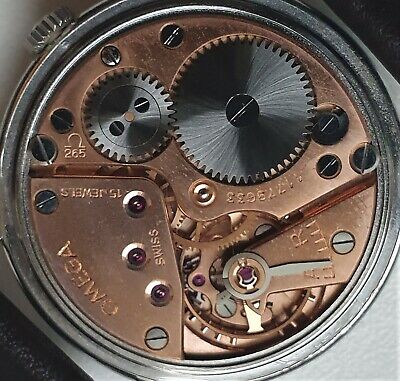

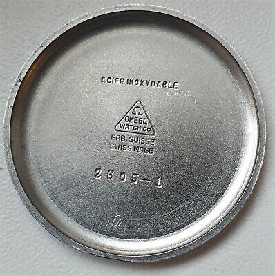

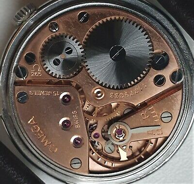

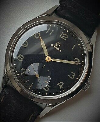

Watching this watch on ebay, quite interested due to gilt hand and suveran look dial but watch case carry reference 2605-1 which dates to 1951 but serial number (11779633) dates to 1947. Is this a franken?
2,326
1,887
Serial number lists for Omega are less accurate the farther back you go. I have a watch that one source says 1910 by serial and another source says 1917 by when the very rare movement was introduced.

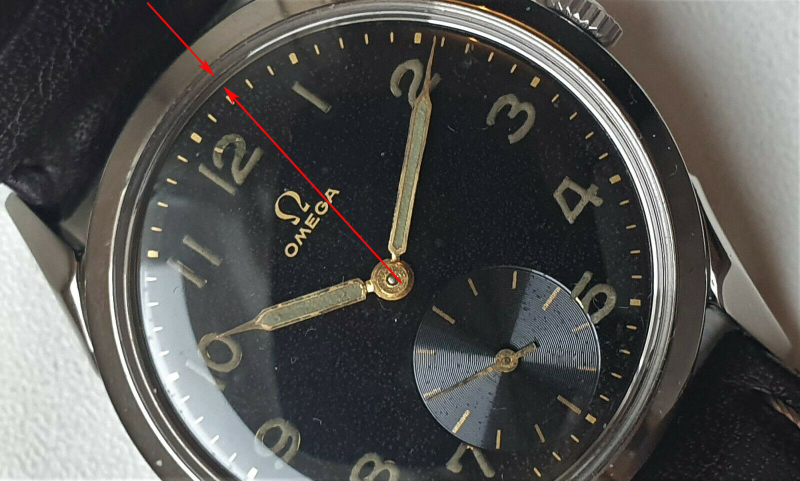

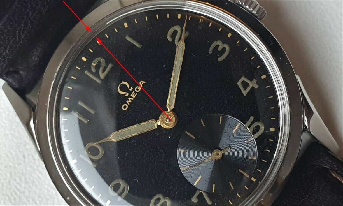

Dial seems small for this reference, do you have a photo with the bezel in place?
13,493
31,814
Wrong dial for the case as I suspected. This gap should not be there, the dial should come all the way to the edge of the bezel.
