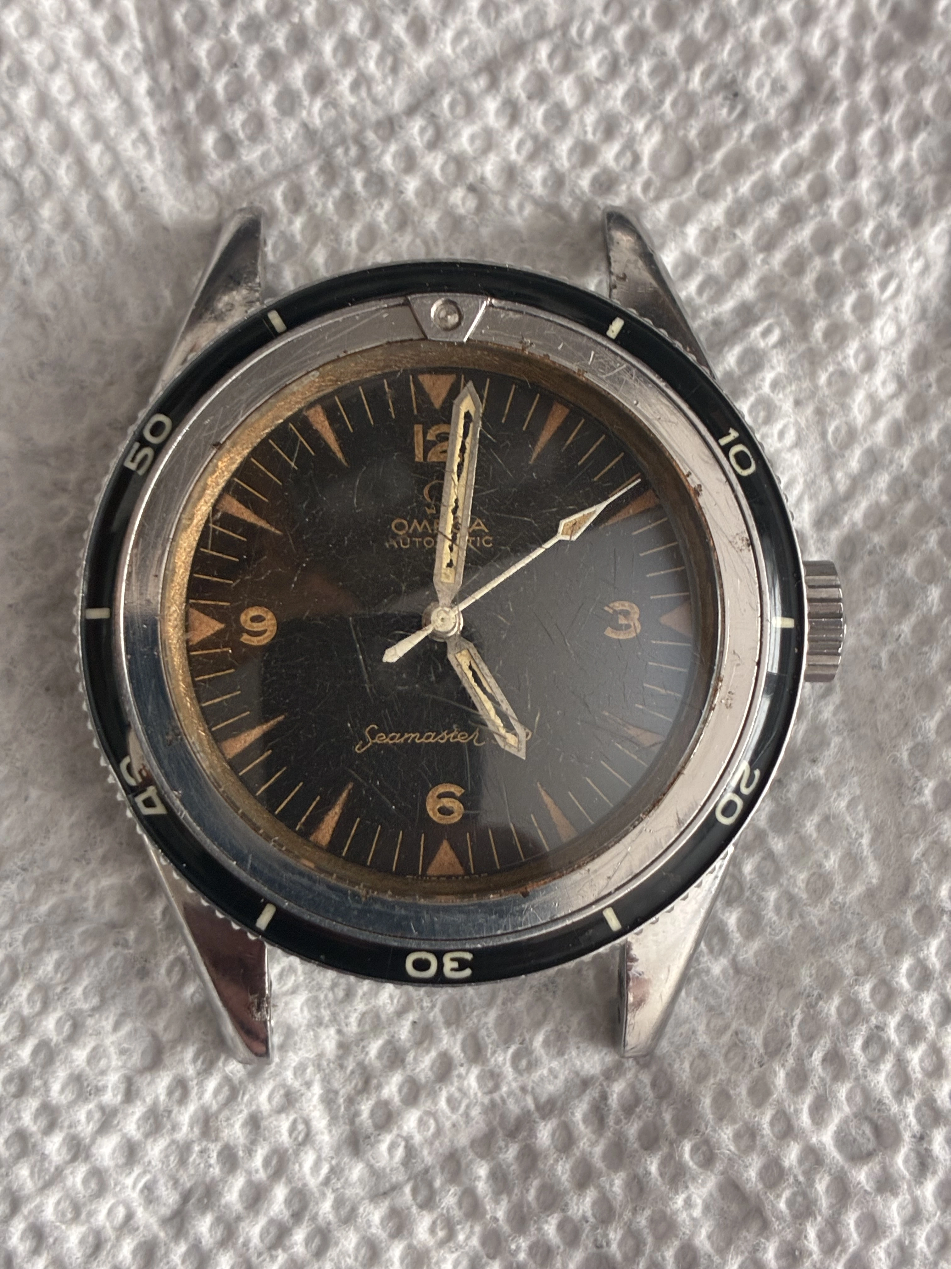

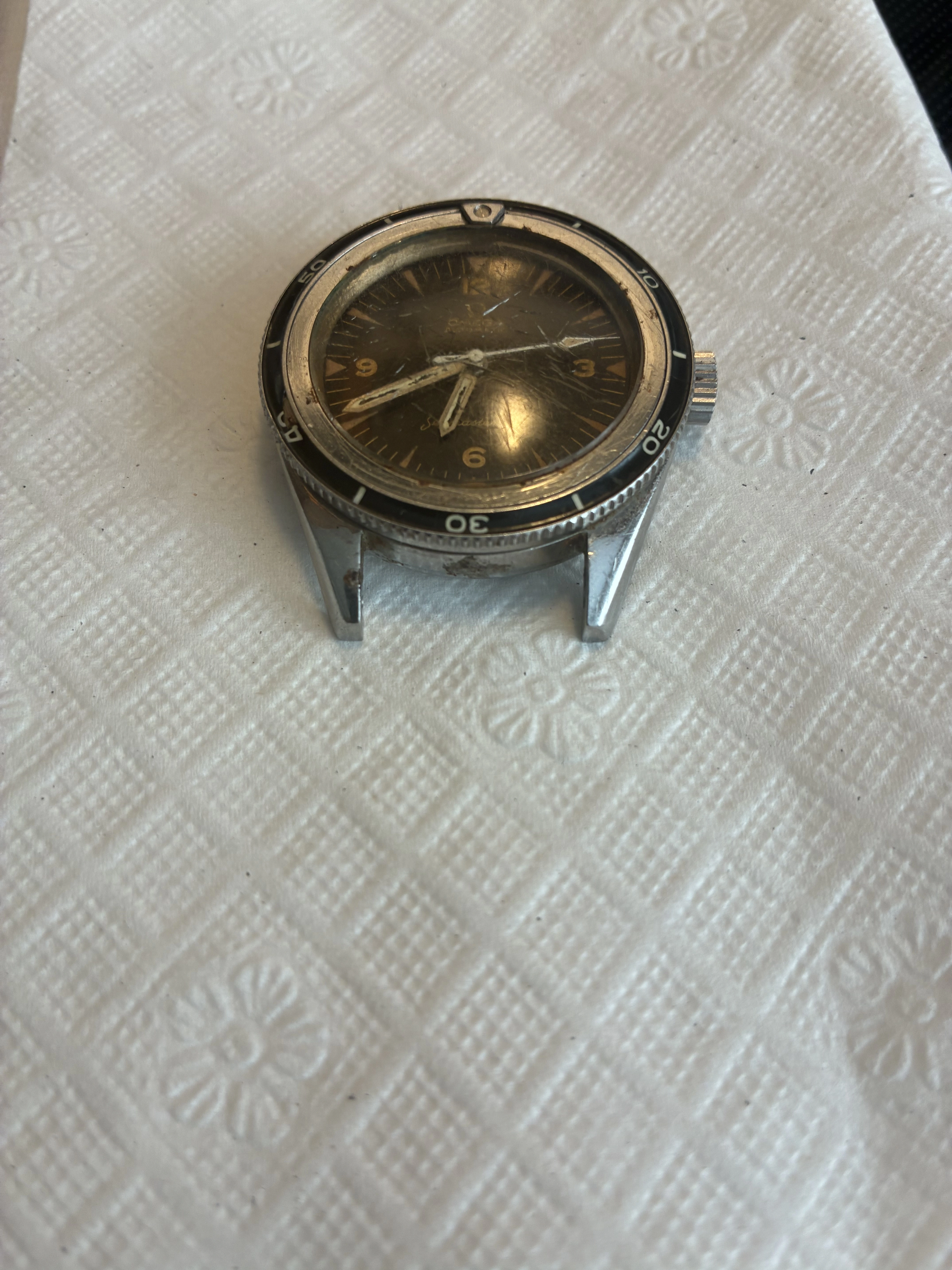

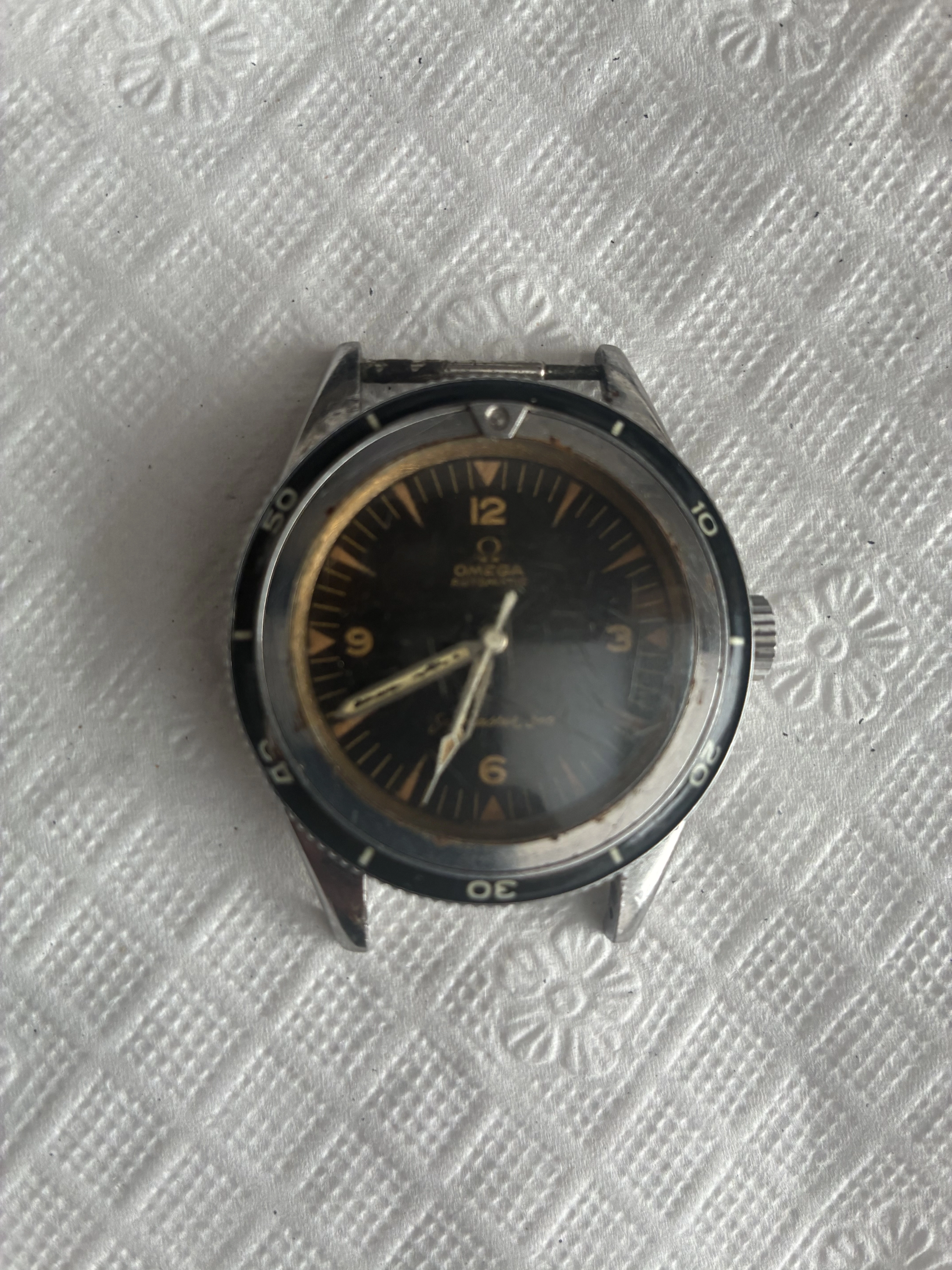

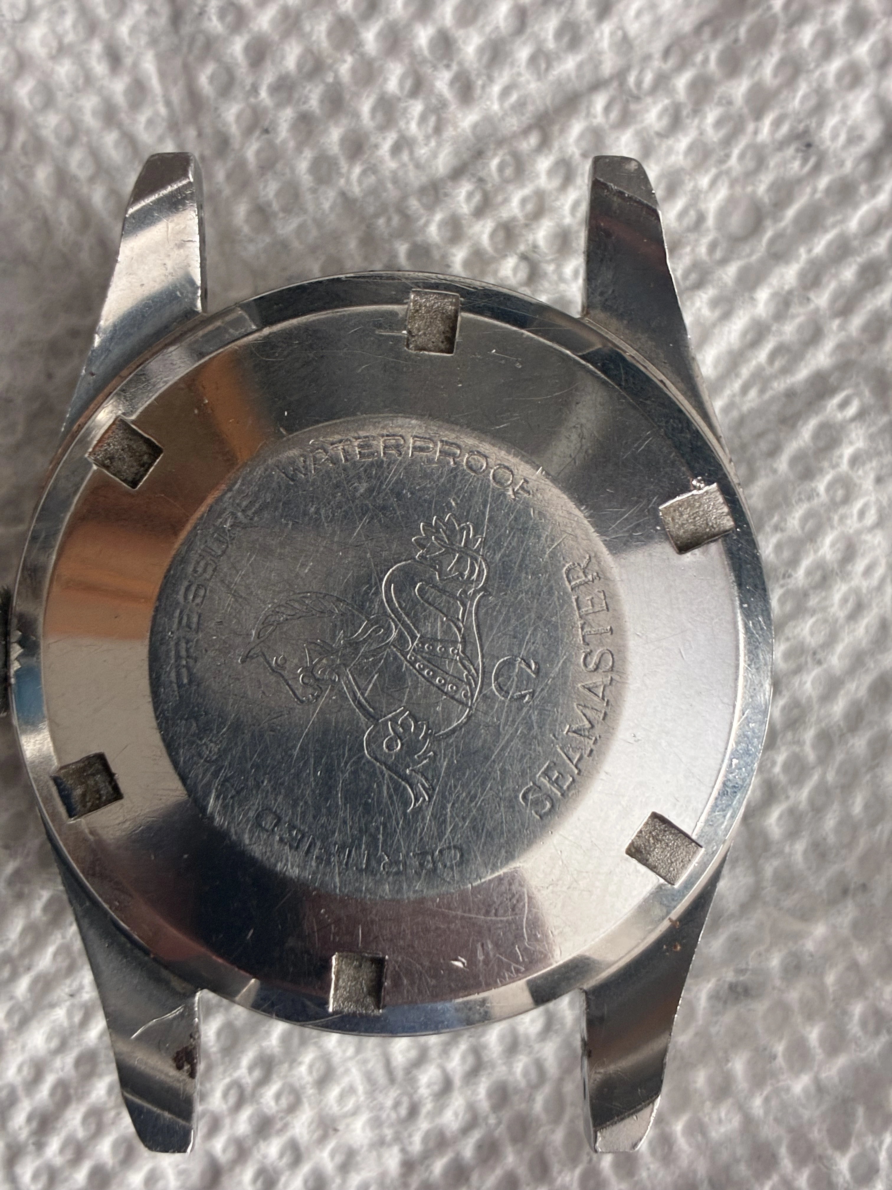

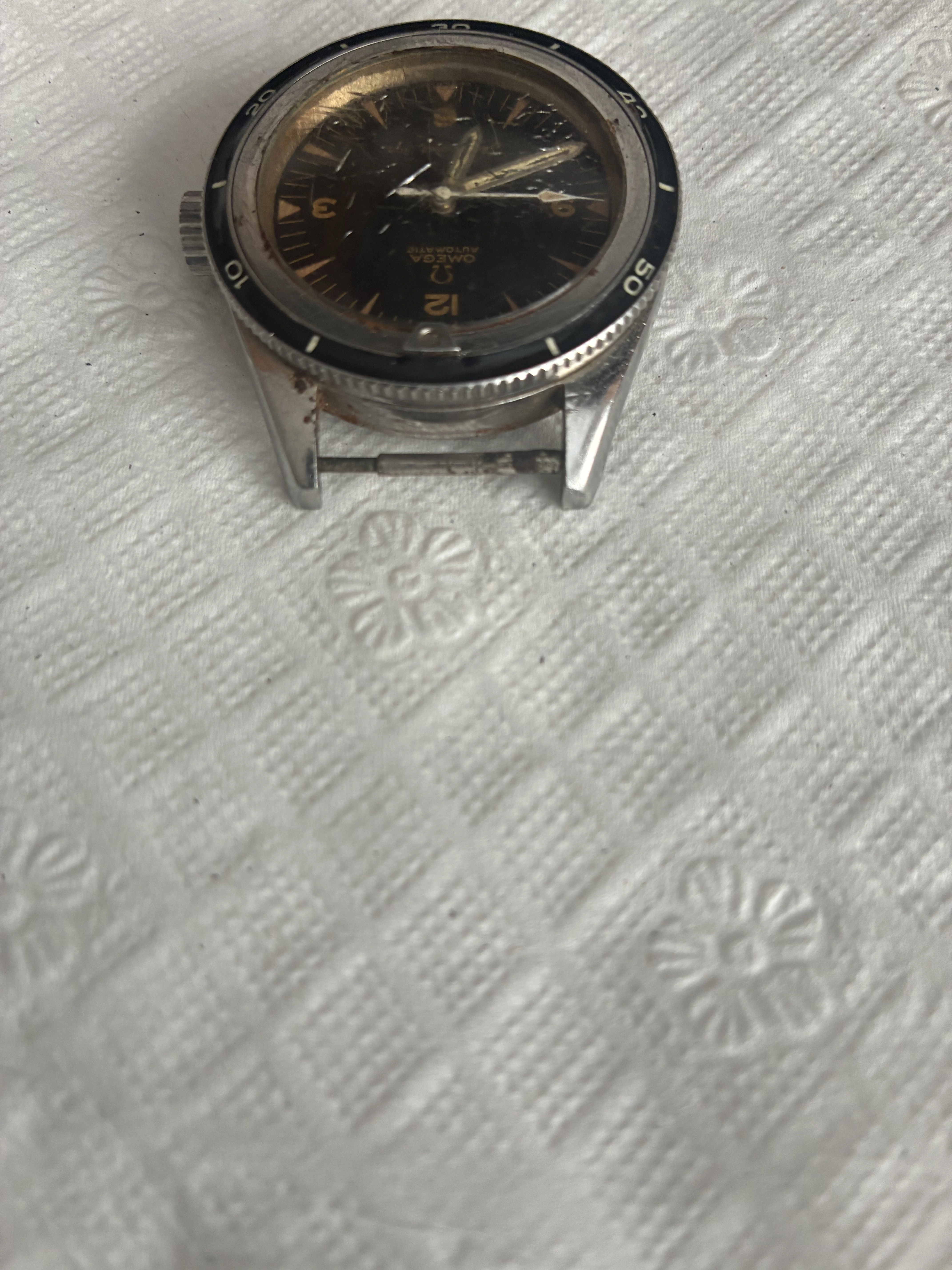

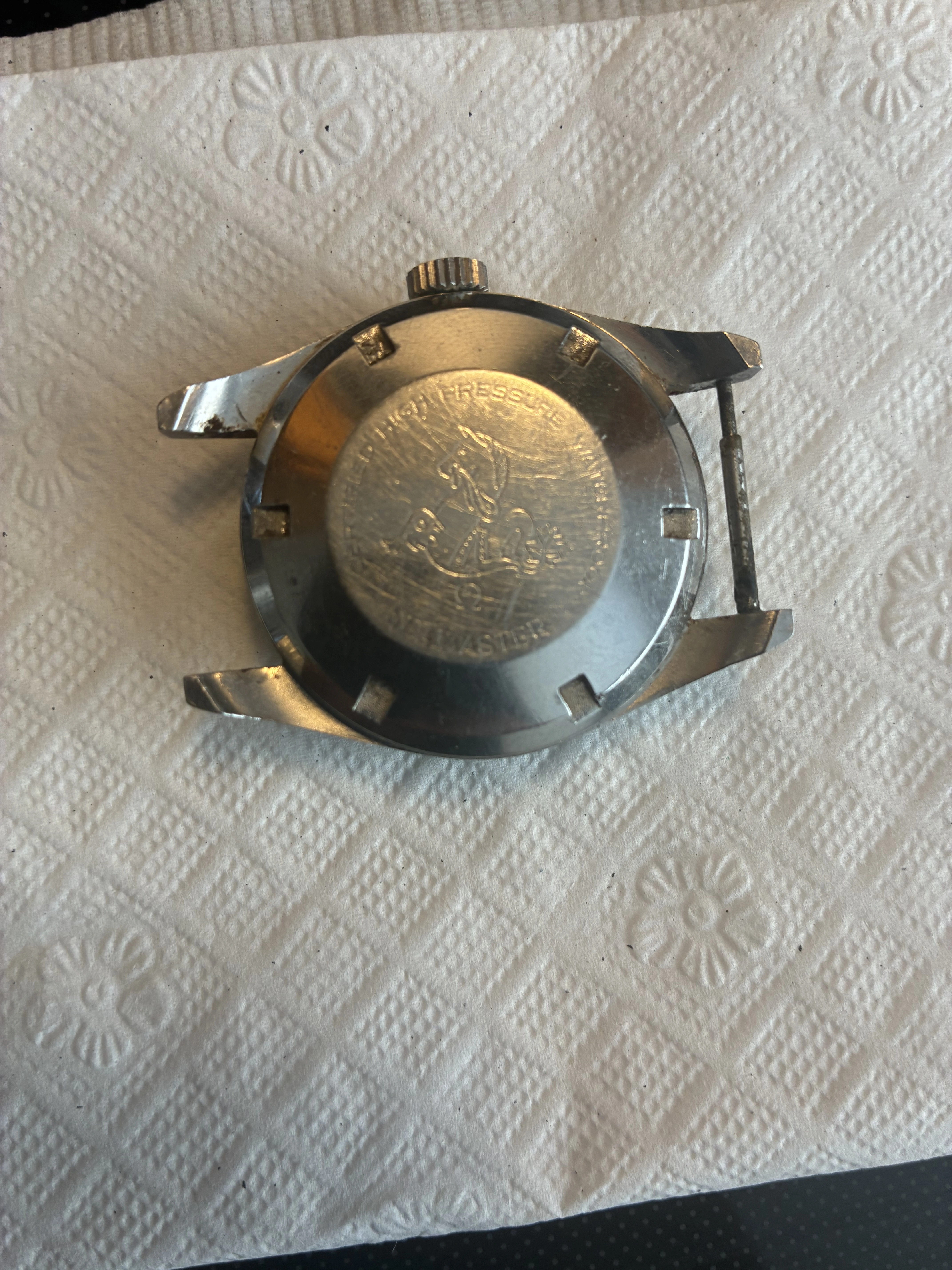

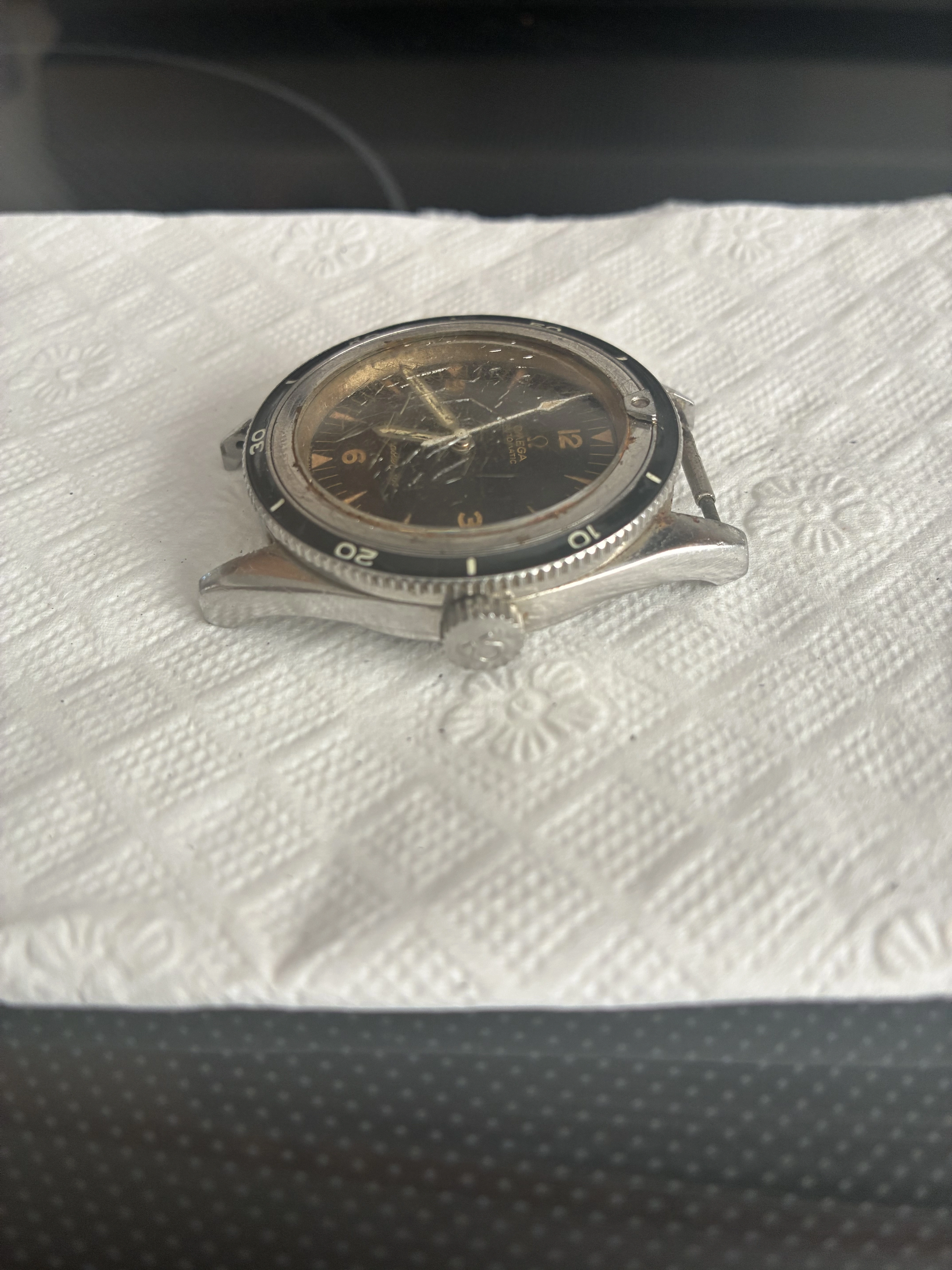

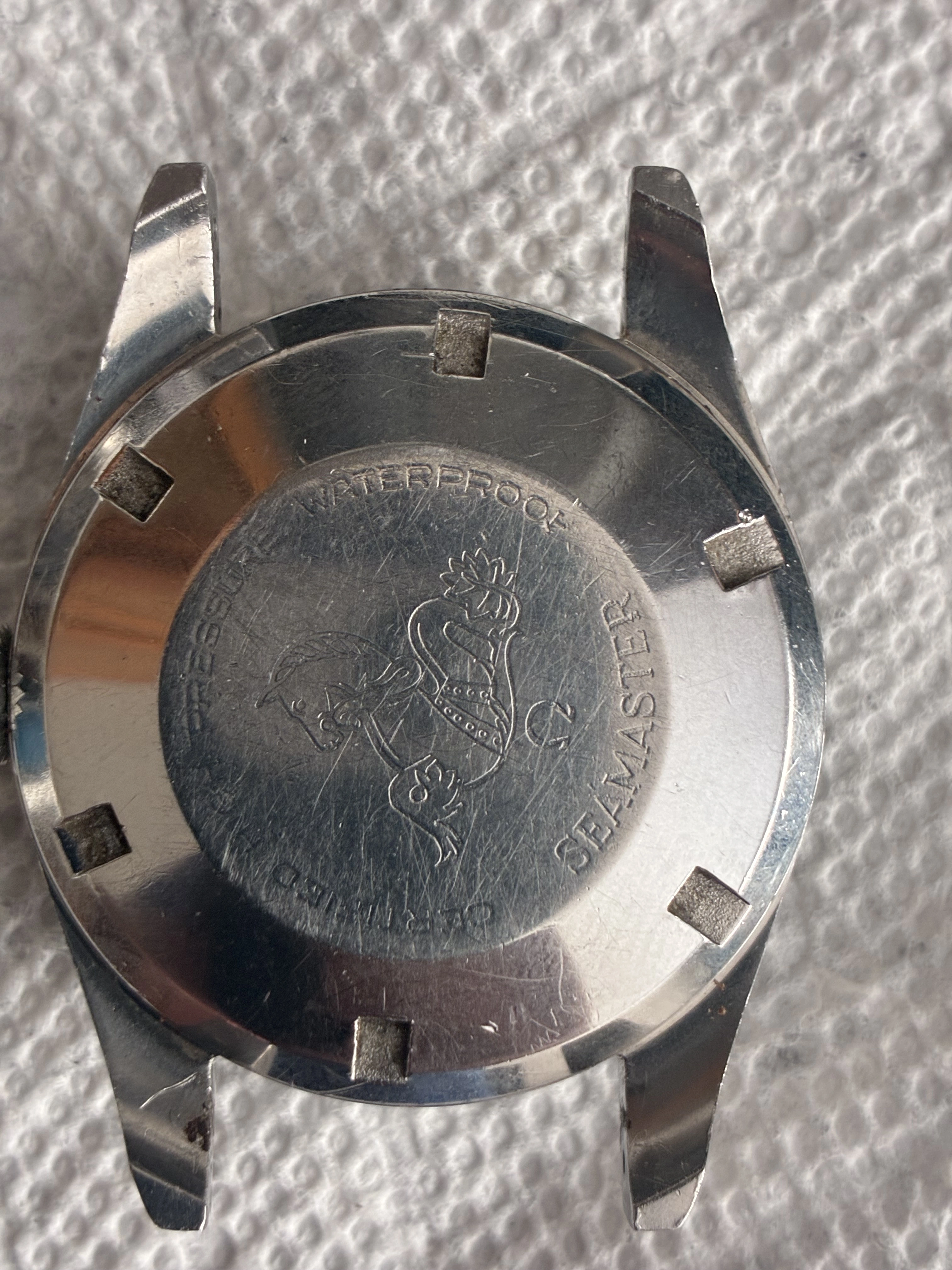

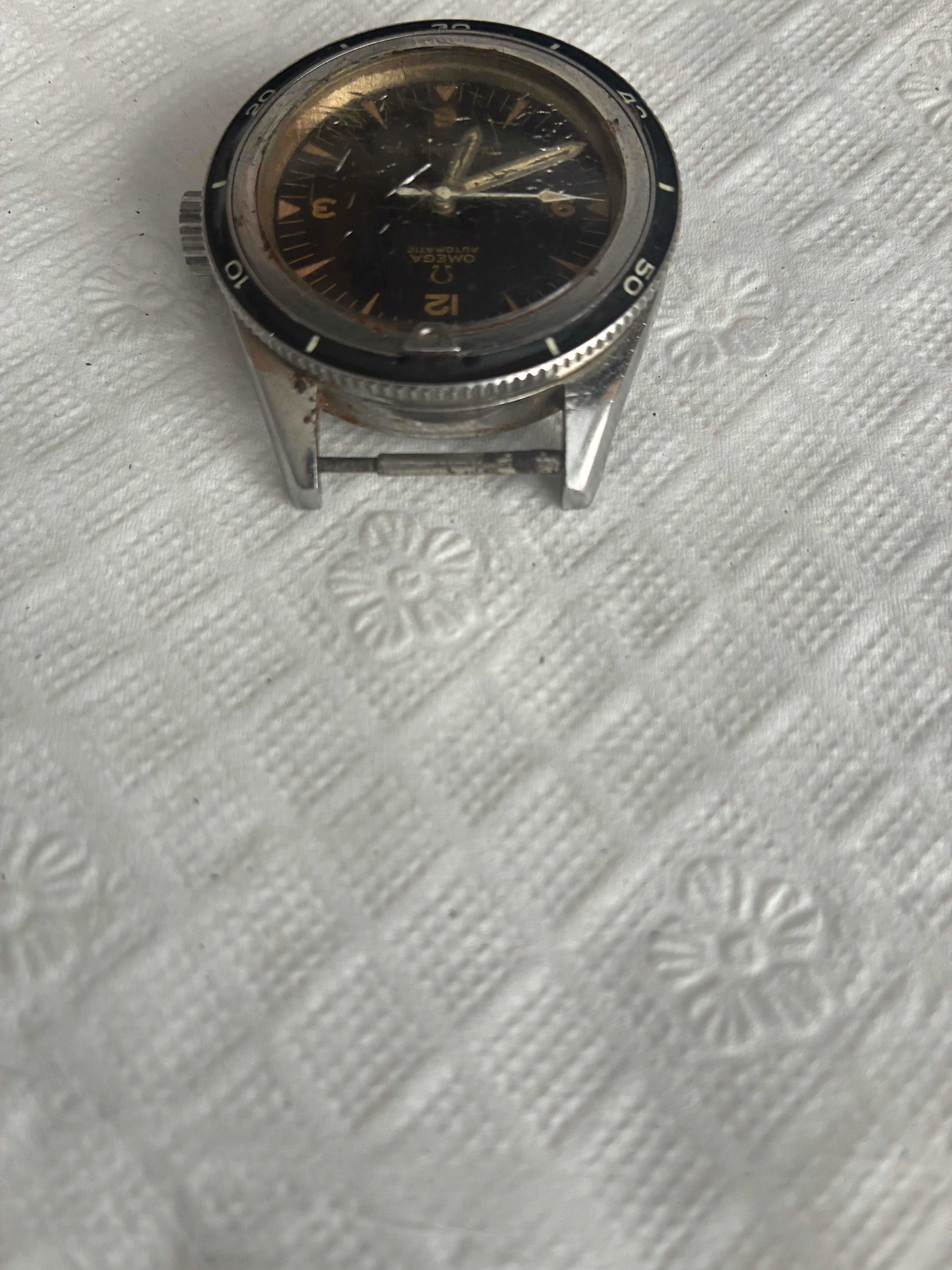

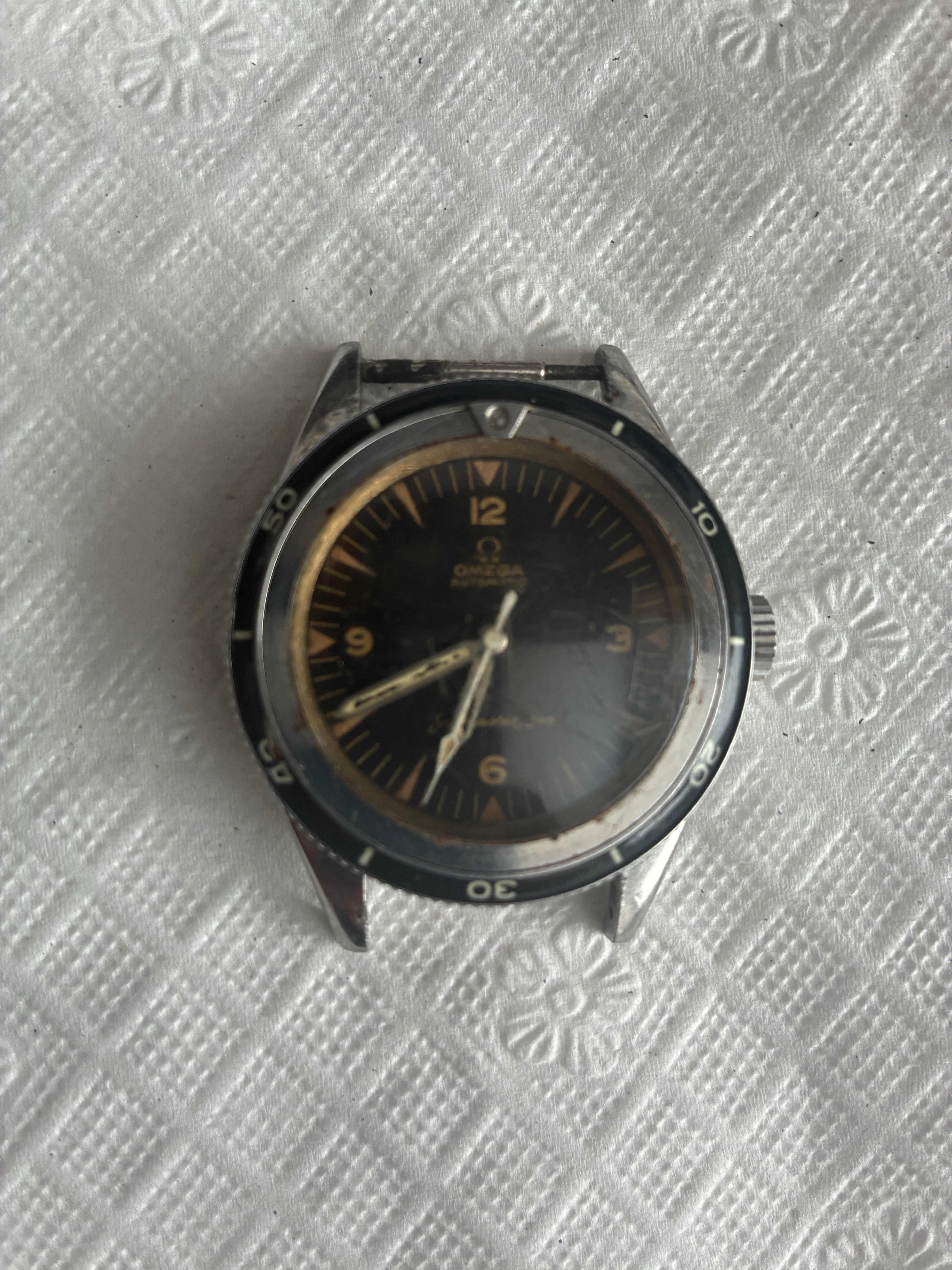

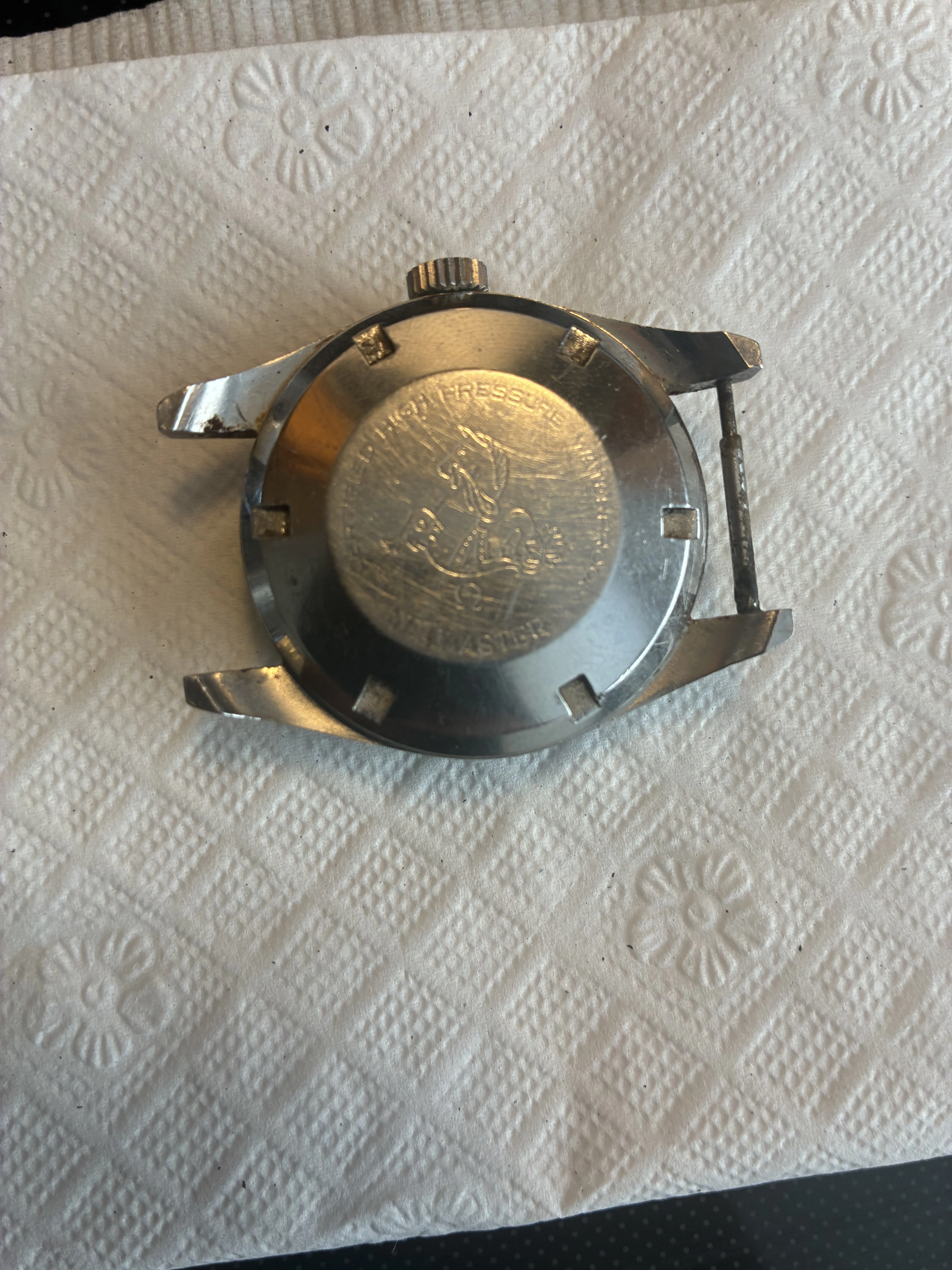

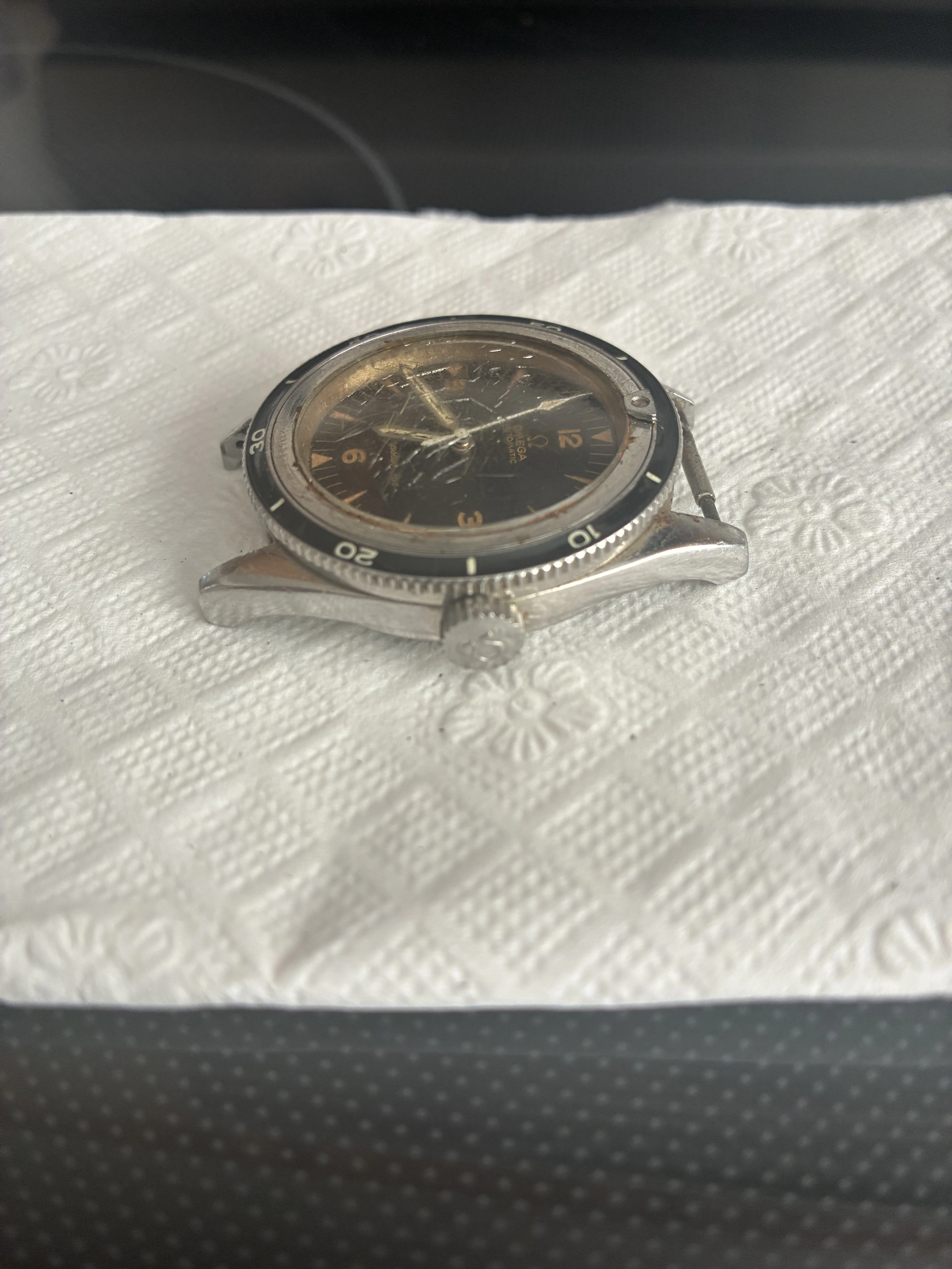

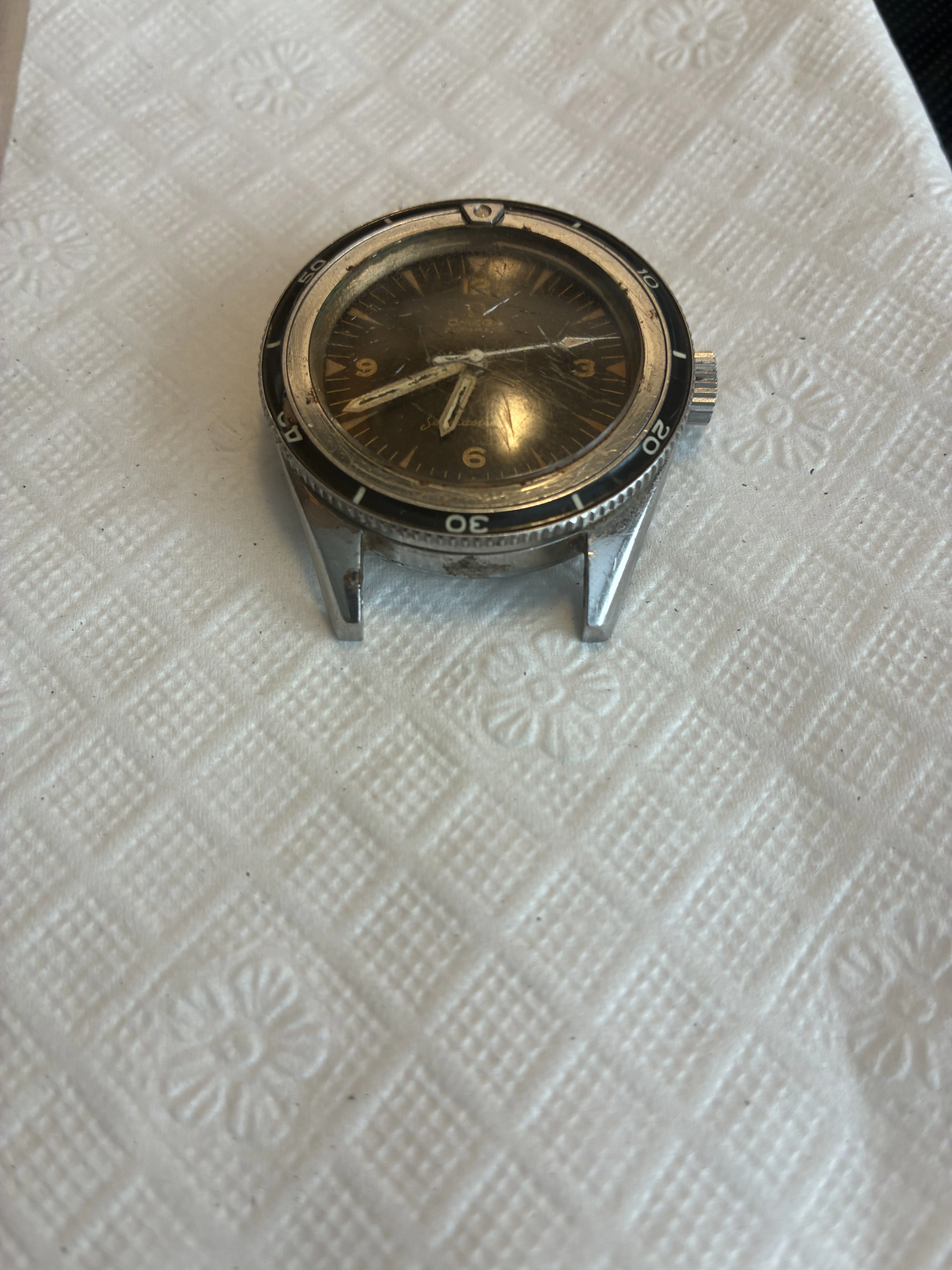

I’ve spent a few hours on this forum and have learned a lot. I’m not a high end watch kinda guy but I acquired this old seamaster 300 from an estate. It looks like it’s been worn for a few decades. Would Omega be able to bring it back to life through servicing? Is this one too far gone? I haven’t opened the back yet, but it runs and keeps time if worn (or lightly shaken). Feels a little “clunky” like something’s loose inside but still works.

It’s extremely rare to have the bezel inlay intact. I would not mess around with that watch. Go slowly. Movement service and hands relumed by an experienced independent watchmaker. Definitely not omega!
Please post in focus photos in better light

To any work here slow and right. Rushing into something and getting it wrong will have a large negative impact.
If you can post some better pictures along with what country you’re in, you’ll likely get some recommendations

I’m in the US. The crystal is definitely cracked and crazed. The hands are completey worn through in the center. I’m going to take it and have the back opened up. I’m really curious as to its age. I’ve seen so many variations of but nothing that is a direct match to this one.

Yes definitely worth saving. Looks to be a 165.014 1963 ish through 1967 ish. Hands need a re-lume, exercise caution everywhere else.
Replacement crystals are available but OEM replacements from NOS (new old stock) will be expensive. Parts for the movement will be readily available, in fact, running movements of this type are available if a full replacement is needed. Don’t over polish the case, the back will definitely not handle an over polish situation. You’ve got a great start on a great watch.

Not sure what you mean by this, this is not a rare model. Probably a 165.014, but opening it will tell for sure.

I wouldn't even be worried about the movement noises, the Cal 552 powering it is about the cheapest part of the whole watch and you can find a donor for parts super easily. Really nice find.

Great watch - do NOT relume, just clean and service the inside (from parts of the old lume).
Hands will not match after reluming with the "overall patina" (Jose, Perezcope). Esp. with a test later under UV-light.
There is no need for any lume on the hands.

Ahahah what you have here is every SM300 lover’s dream project! 😁
Honestly, if that kind of patina doesn’t attract you, just sell it to someone who does 😀
You’ll get enough cash to buy a watch you want and that one will have a chance to get a new life!

Nice watch!
It's a 2913 with the 165.014 or 024 hands.
The caseback is thicker than the refs. 14755 and 165.014 because of the old cal. 501.
The dial is radium. The hands tritium.
Don't send it to Omega for the restoration they will remove all the valuable parts.
You have to search the original hands. Maybe on Ebay.

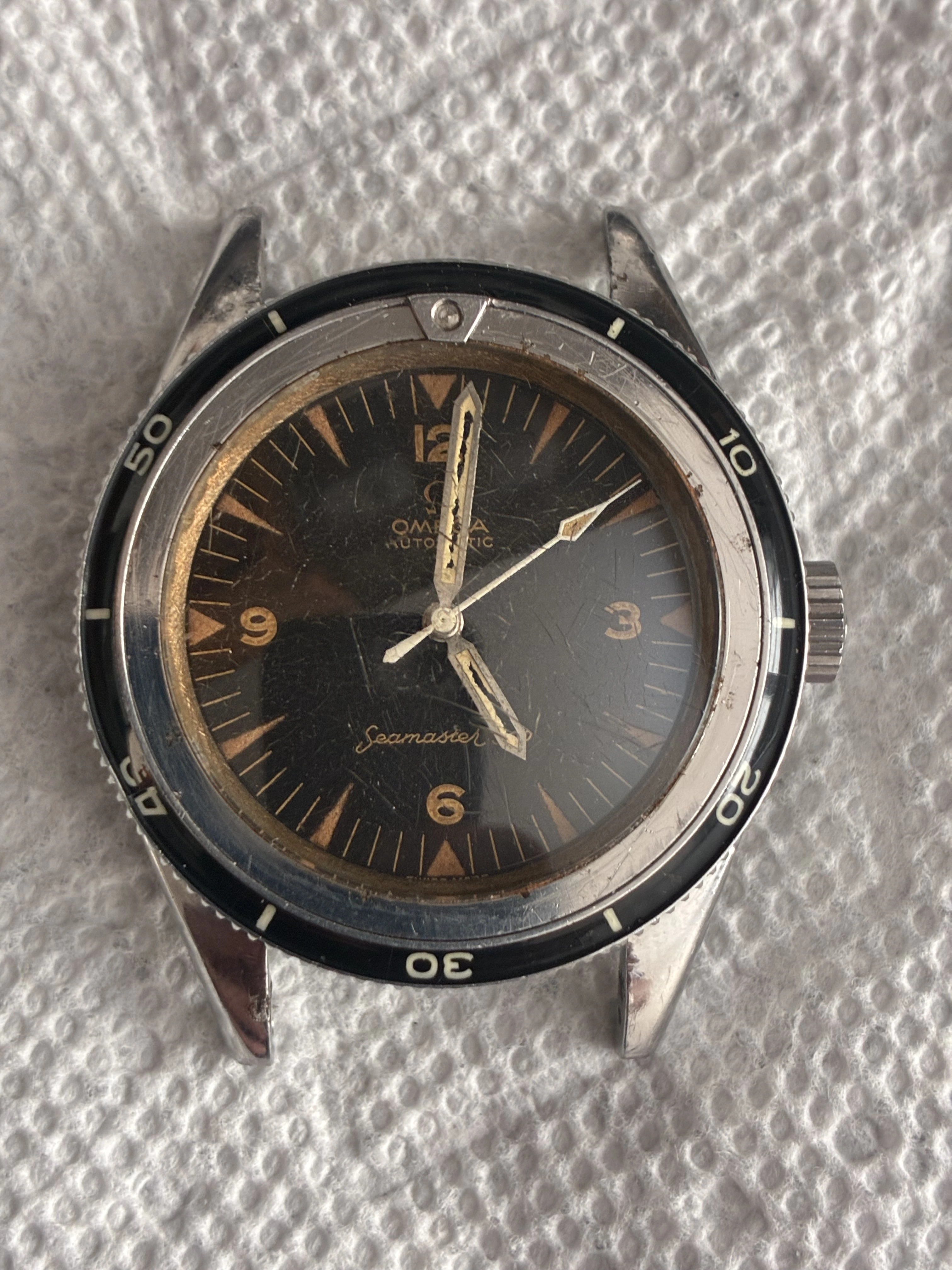

Thanks for all of the advice and feedback! I’ve been occasionally walking with it to simulate wear and it’s been keeping accurate time. I spent a little time with some toothpaste, toothpicks, and a polishing rag yesterday cleaning the old 2913 up. I was able to get a few of the corroded spots looking much better. I plan to get the movement serviced, the crystal replaced, and a black leather band for it. Maybe this Omega is turning me into a watch guy.

Really fantastic watch

A good watch-maker can stabilize the rest of the lume of the hands by laquering - on the back-side

If they are not the original hands I wouldn’t hesitate to have them relumed and color matched.

While a leather strap will look fine, that watch deserves an appropriate bracelet. Should not be hard to fine, but won't be cheap 😀.

Definitely not cheap! But, yes I agree.

Wow, wow, wow. As others have said, do not send it to Omega for service. You need an expert.
