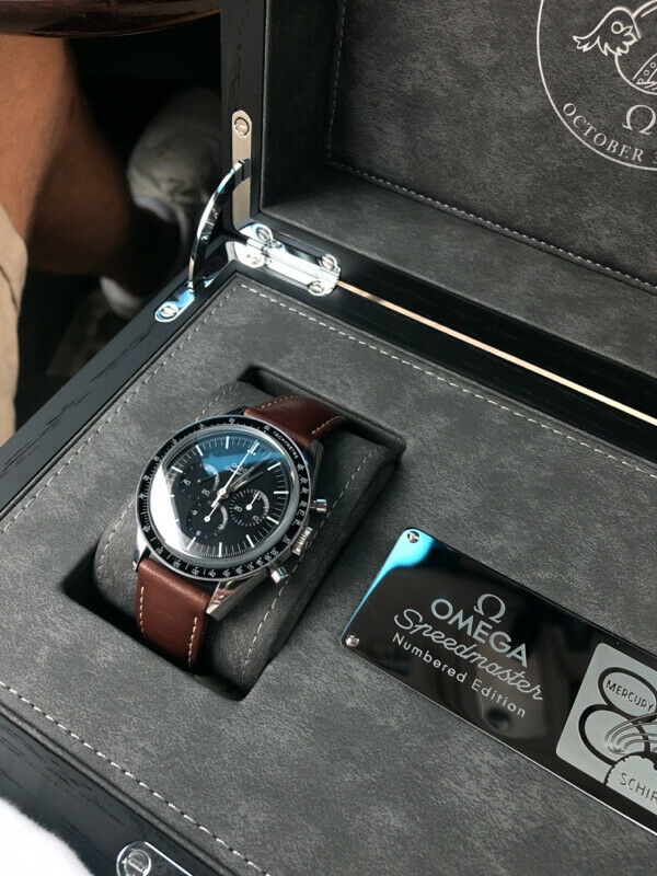

Not very familiar with this model so Im asking the experts.
Based on these photos, does anything look off?
Comes with box and papers.

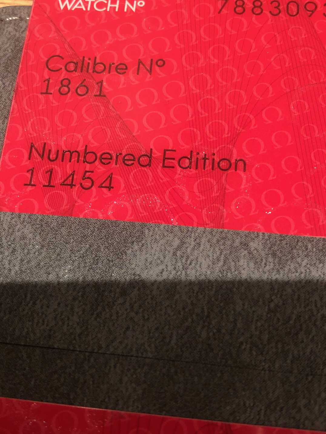

The number on the plaque in the box should match the number on the watch if I’m not mistaken.

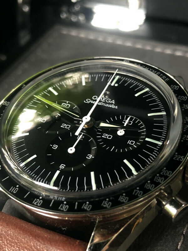

Everything looks legit, as far as that can be seen on the poor quality pictures. But I’m no expert on spotting fakes. Does it have the subtly stepped dial which the FOIS has, and the Pro doesn’t? I can’t really see it on the photos.

Looks legit. If the chrono works then it should be okay. If it’s fake, the chrono second hand will act as the time second hand and tick like a quartz. Also the hour markers at 3, 6 and 9 will be shorter than the rest if it’s not real. I’ve not heard of anyone saying the Chinese movements can run chrono - having said that I’m only going on what I’ve read previously and I’m no expert.

It's supposed to have a stepped dial? Can't really tell. Waiting for more pics.

you can sort of see it in the pictures posted above. When the light hits the dial just right.

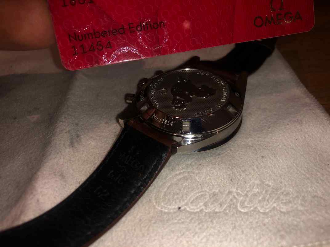

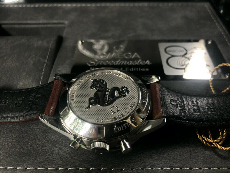

There's a big scratch on the case cover underneath the edition number. Not sure why someone would try to open a relatively new watch. And for this I'm 2nd guessing it.
What do you guys think?

Apart from poor photos seems fine to me
