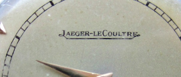

Couldn't resist putting in a bid and I ended up getting it. This always happens when I'm trying to save for something else...

I favor original, Kyle. Nice one! Perhaps Dennis will pipe in. What's the case size? Reminds me of this 35mm of mine:
It should be a little smaller than the Seamasters, I think it measures about 32/33mm. That's a really nice one, do you still have it?
Kyle, I'm not sure if it's original or not. The spot to study is the tips of the C. Yours is plain while the originals usually have a little barb on at least the top tip. Adam's watch has it on both ends.
There are several different iterations of the JLC logo. Not sure if all had barbs on the "C" or not. Here's one of mine with very small barbs. Sorry that I lack focus! However, that particular watch seems to be a little too "busy" at the bottom above the 6. I would need to examine up close and personal to determine if dial was original. Take care, gatorcpa Edit - After putting the two pics next to each other, there are some things that concern me about that dial. 1. The line under the logo has sharp angles under the J and second R, that the other dials shown here don't have. 2. The "U" seems to be a tiny bit off-line. 3. The middle serif of the E's are not eccentric like in the other dials. I'd pass on this one.

D - Can you post a pic of one of your JLC factory redos here? I wonder how they stack-up against the logo on Kyle's watch. It's that good. Take care, gatorcpa
You got it. Let's start with the '66 Memovox, which was confirmed original by Le Sentier. The barb is very crisp at the top of the C. Here's the '65 caliber 800C. A little less crisp, but there nonetheless. Now here's the '46 caliber 428 - a very close relative to Kyle's watch - that just came back from restoration. I don't see the barbs. Weird, huh?
I blew-up your picture a little bit: Still no sharp angle to the underline, the bars on the E's are closer to the top and the U is on line with the other letters. gatorcpa

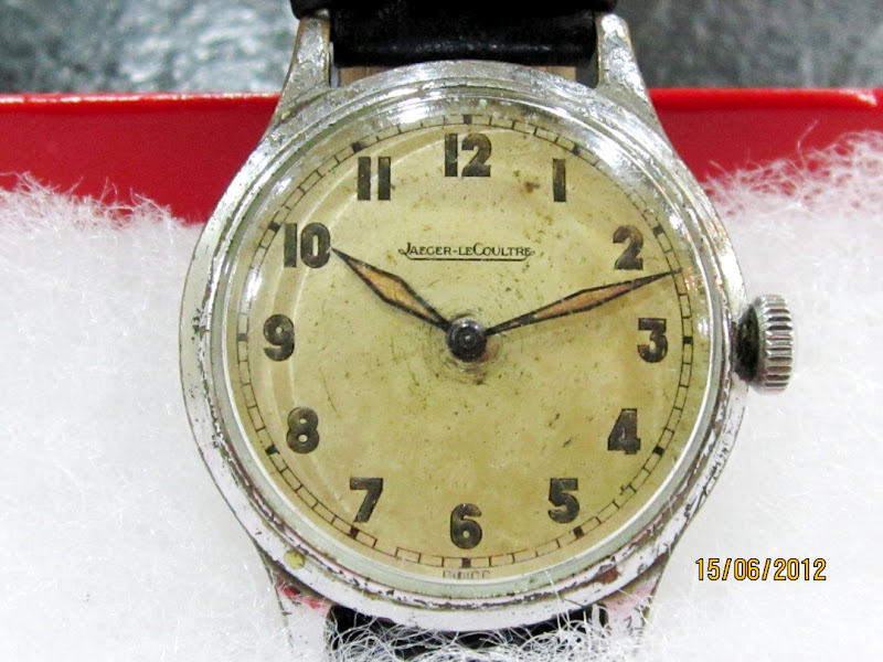

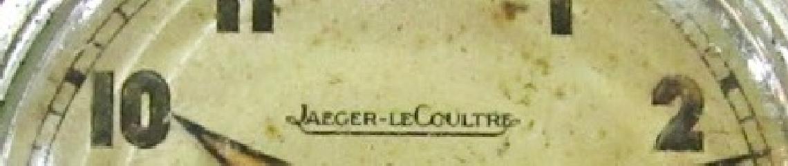

Well...the markers are actually yellow gold. I thought it might be a bumper but it actually has a manual movement. Printing and minute track aren't that crisp under a loupe, so I'm thinking it's an older redial? Some other iffy areas: Also wondering, what year is it from?
That looks like my caliber 428. Is the serial number 417747? I'll look it up for you in my book but it's really close to the serial of mine as you can see. That puts it around 1946.
