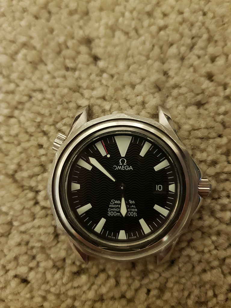

Can I expect my local watchmaker to be able to easily align the bezel? OSC doesn't want to touch it because they "might damage the spring" even though they have the proper tools to do it.

1. Bezel doesn't look mis-aligned to me.
2. Don't know why OSC wouldn't do it.
3. Easy job for a competent watchmaker.

The pip of the insert is aligned to 12, but the bezel itself isn't.

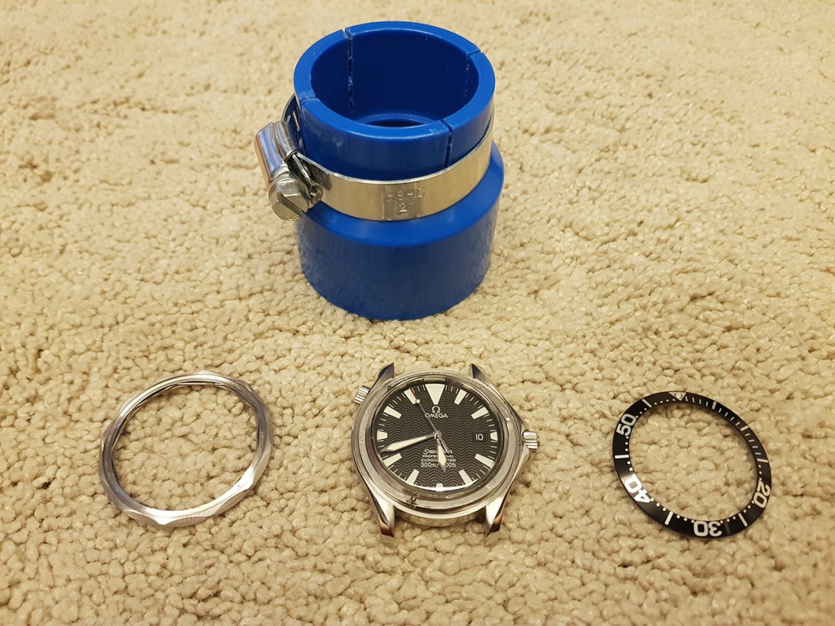

Thanks to you and an old post here on the forums, I was able to make a DIY bezel tool and safely remove the rotating bezel. The placement of the insert isn't the problem -- it's the bezel itself that won't center.
Could the click spring be the culprit?

It looks to me like you have just turned it one click too far. I have this exact model in my hands right now, and if I turn it one click past 12, it looks exactly like yours.
The tabs on the click spring look pretty worn, so if you can't make it line up then that would be the thing to change.

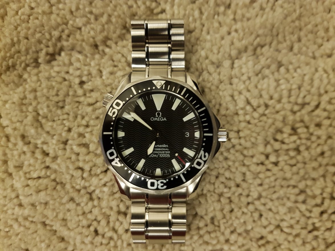

I really appreciate all the help, Al. I was hoping that was the case but a click to the right is misaligned as well.
Will the service center sell me just the click spring on request? How much do those usually cost?

No, this is a case part and they typically do not sell those to just anyone. You might try a local AD to see if they can order one in for you. For the 22545000 the click spring is part #129ST0510. As with many Omega parts they have jumped in price a lot - I remember when these were $10 Canadian not that long ago, and they are now $35.
They also used to include a new click spring when you would buy a complete new bezel, but now it has to be ordered separately...
