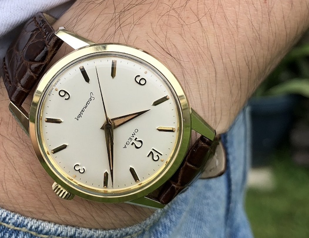

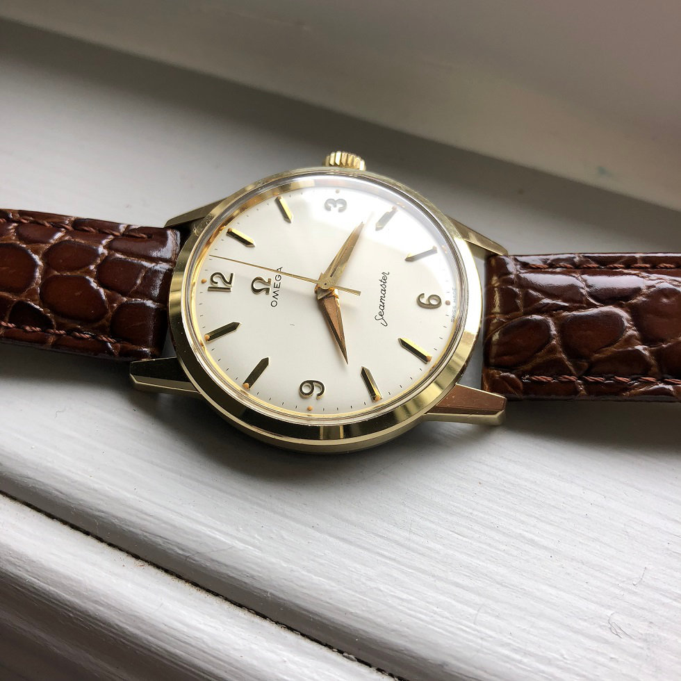

Is this a redial or I don't understand reflections?
477
489
I am not an expert of checking paint on the markers, but here it seems pretty even and it spreads across the whole index sides. Even if it looks white in the pictures, the sides are too "clean" for me to have some paint on it: it is the reflection of the white dial.
I guess that when looking for paint on index, it is more about "speckles" (not sure if the word is correct), uneven look / paint stains on the sides of the markers.
Most of the time I spot a redial (now even of models I never saw before) because of the typo (uneven spacing, not sharp, same letters that look a bit different) and the secondary (painted) markers that are not all pointing to the same direction. People that are able to reproduce these 2 things perfectly are also capable enough to not put any paint on the markers. If I do not see anything wrong and I am interested in the watch, then I look for other examples and/or model history guide to confirm it is legit. But I never check for paint on the markers...
I do not know this model and I do not know too much the Seamaster typo and its evolution. But at first glance it seems legit. If it is a redial, it was well done.

Looks very good. Did you buy it?
No, thinking about it. New to vintage, doing my head in!

It looks legit and doesn’t set any alarms off for me but take what I say with a grain of salt as I am fairly new. Trust the opinions of the knowledgeable people here.
247
1,086
Omega logo is spot on. If it were a redial, which I do not think it is, it would likely be an older redial because lume dots rarely survived a redial back then, and these dots have age appropriate patina. But the dots themselves look pristine and perfectly placed, which old redial jobs rarely managed to pull off.
