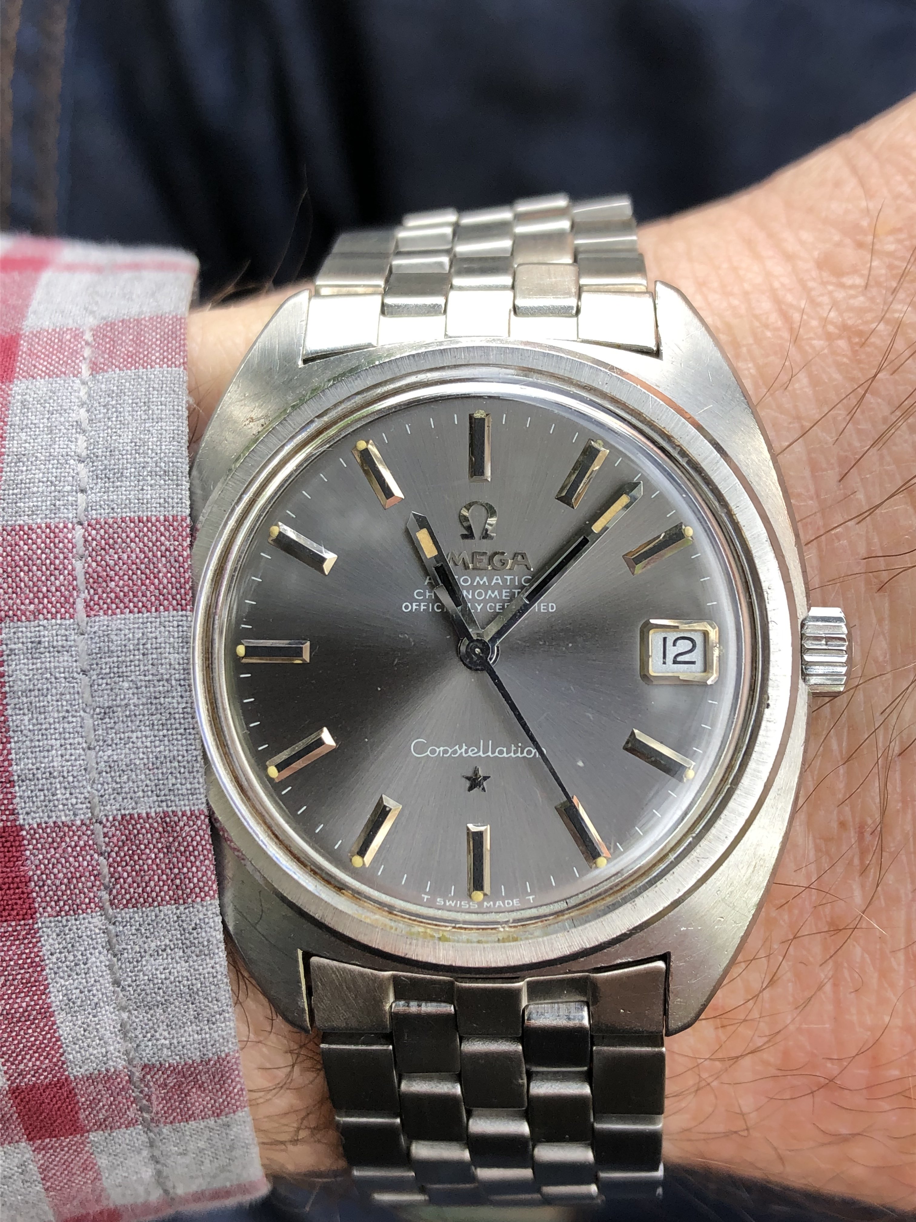

Is this a reason to return my Constellation?

Almost there, guys, I will report more fully...
But first, a question.
I was changing the date (going back and forth from 9 to 3 and back), and suddenly the crown didn't turn the hands anymore, and seemed to be screwing itself off the stem.
I pushed the crown in and did some winding, to tighten the crown endpiece to the stem, and that seemed to normalize things again.
The crown is signed, and, I assume, original.
Is this normal?
Also, when going backwards to 9 (to then advance another day), I noticed the second hand pretty violently jumping back and forth in a wide angle.
On other watches I've done this with, the second hand also goes back and forward, but only slightly.
Again, is this normal?
I really like this watch and would like to keep it (the consensus in this thread has been to keep it), but I don't want to start having technical problems with it already. That doesn't jibe with the pleasure one is supposed to have with a nice new/old watch. 😉
And I still have the 30-day option (maybe 2 weeks of that left) to return it, which is reassuring.
Or I could ask if the seller would fix it, should it be a technical problem...?

These are representative of the kind of things you may find when you buy an old watch that hasn't been serviced. Mention these issues to the watchmaker when you bring it in and he will fix them. The seller did not represent the watch as having been serviced, and as far as I can tell the watch is operational. If minor repairs are going to cause you stress, and decrease your pleasure in owning a vintage watch, then perhaps old watches are not for you. Return the watch, change your user-name, and buy a vintage-style new watch from a dealer, which will be perfect, and under warranty.

Of course old watches are for me. This is my first Omega, and I'm just aware that the cost factor will be higher than, say, with a Seiko.
I want to know if the things I described are normal, or, if not, well-known, and easy fixes.
I obviously don't like the idea of having a fix-it list right off the bat.
The seller buys watches from various sources and checks them personally before selling them, something he has been doing for the last 25 years, he says.
He claimed that this watch does not need a service. He said a service had surely been done, but he did not know when.
About the rotor, he said it is not loose.
I tried the suggested tests for metallic rotor noises, and can feel movement in the watch when moving it, more than hear it.
What I do hear is not scraping or metallic, but rather the sounds an automatic makes when you shake it.
At least, no alarming sounds.
But that's why I'm here, because I don't know what's OK, and what might not be.

Just get the watch serviced and enjoy it. Easy fix for anything you have questioned.
Unless it comes with a service receipt it’s going to need a service. It’s a nice watch so don’t return it just service it and wear it trouble free for the next 5 years.

Hey @Vintageous. Since I don't have the watch in hand (and I haven't seen the listing nor do I know who/what the seller is) I can't pronounce it 100% but let's just say that normally, even for a non-serviced watch, some of these issues shouldn't arise. But let's not panic!!! All is fixable.
Crown "issue" - there is a stem that comes out of the movement. It has thread on it and the crown simply screws into it. Normally it shouldn't come out like that but it happens. Sometimes watchmakers use a bit of glue when screwing in the crown to prevent it from coming out.
Hand jumping violently - this is something caused by a part called the cannon pinion which simply needs to be tightened (not too much else it'll cause other problems).
I would say that you were a bit unlucky and you didn't draw the longest straw (and I wouldn't buy from that seller a second time) but at the same time these things are fixable.

Yes, every mechanical watch is going to need a service, and depending on the watch or usage, some need more than others. The sticking hand while setting and crown backing out tells me the watch hasn’t been serviced within at least the last decade- that’s a common issue with watches that have say for years and the oils/ greases dry up and get gummy- almost impossible to set the time/date.
Omega still makes parts for these movements any worn parts should be available to a watchmaker with a Swatchgroup parts account. Any used watch I buy, I factor the rough cost of a service barring special parts needed- then I deduct that from the asking price and figure out if that makes it as attractive if a value.
I think you paid a fair price for the watch as-is, it’s in lovely condition and a service will make it a joy to own. Pick up the period correct “bricks” bracelet for it and that will up the sex appeal to 11.
You got a nice watch at a nice price and all the issues are very standard deferred maintenance issues- relax and enjoy the pride of owning something that pretty.
