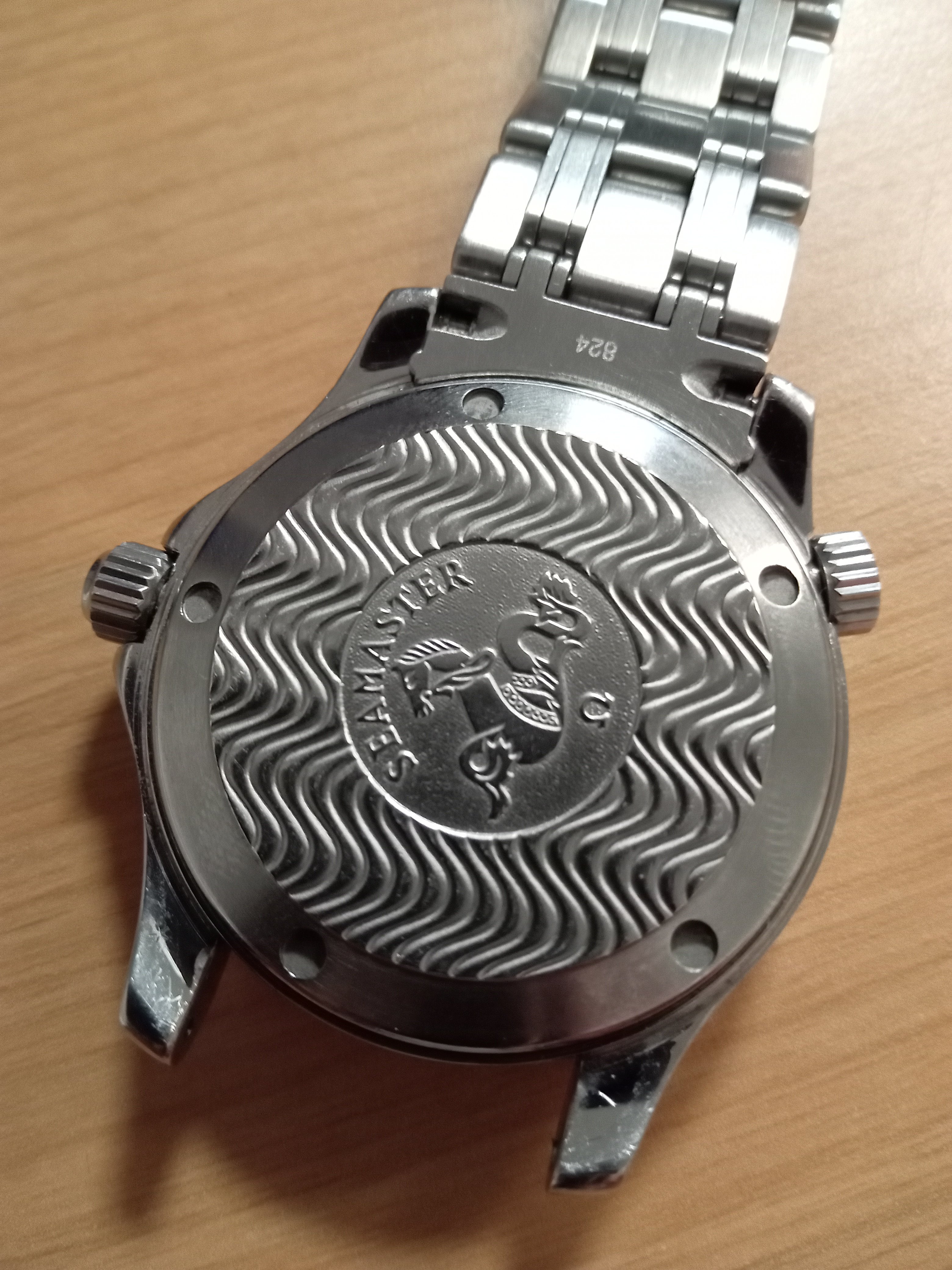

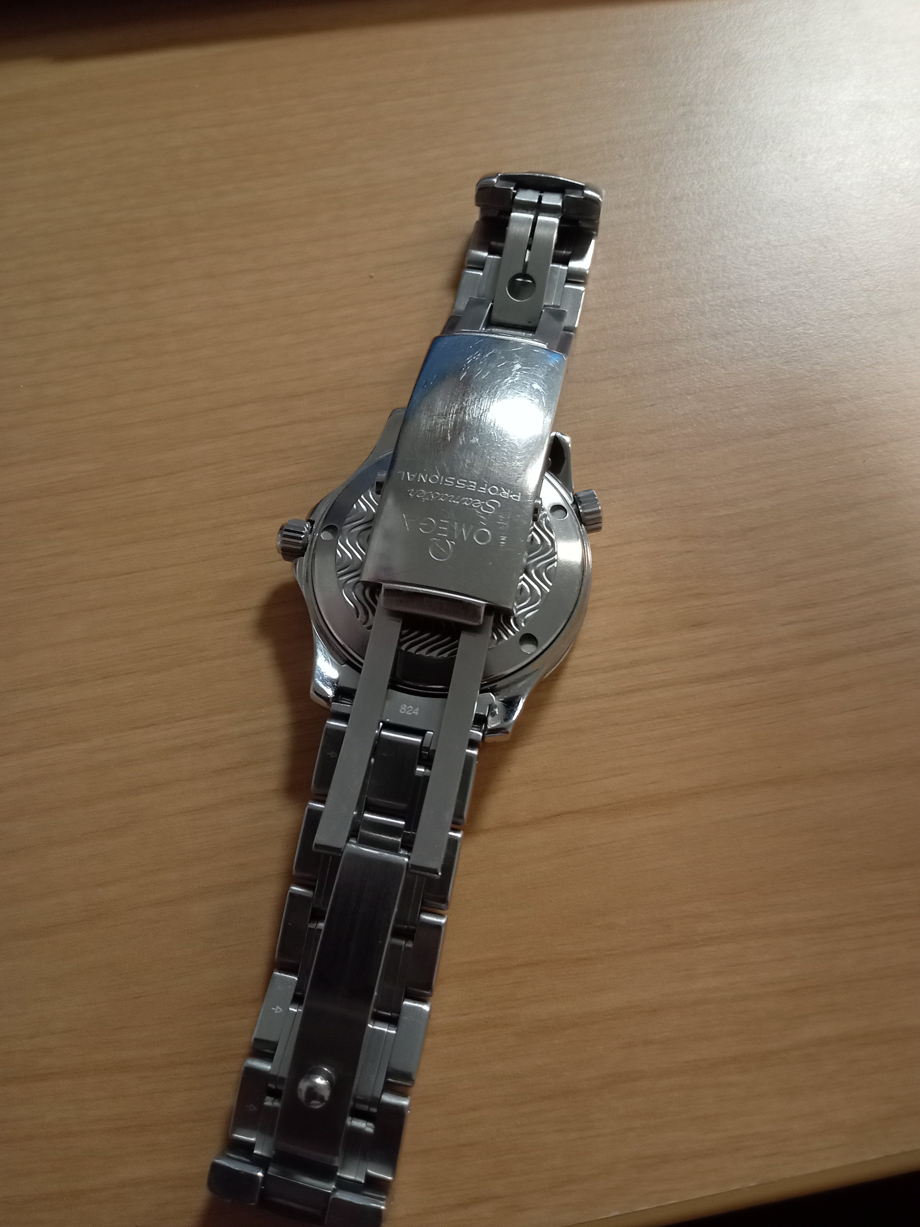

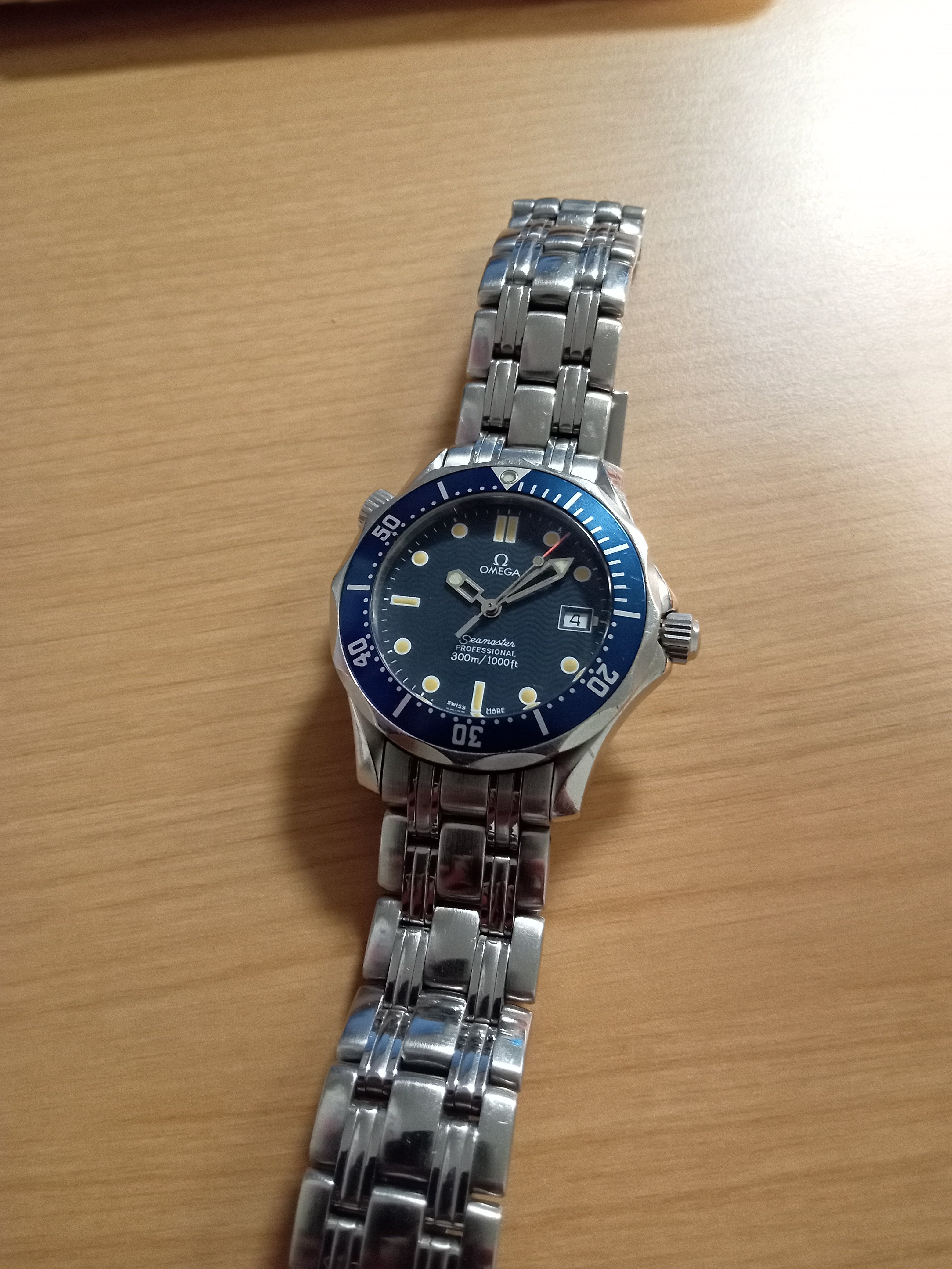

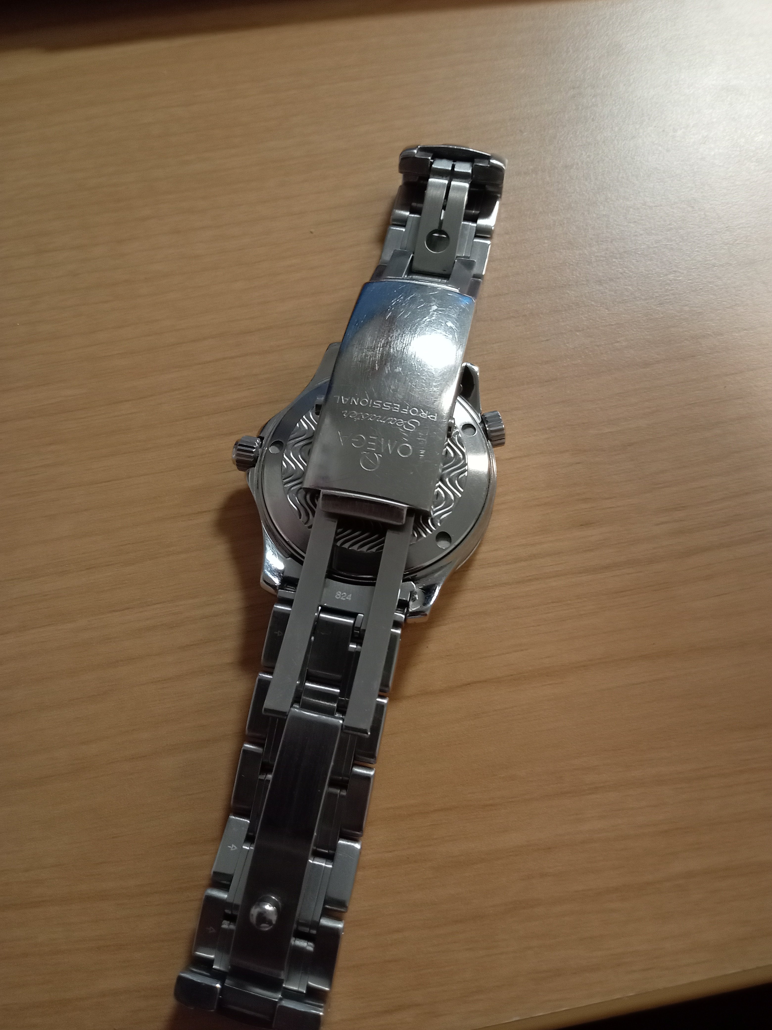

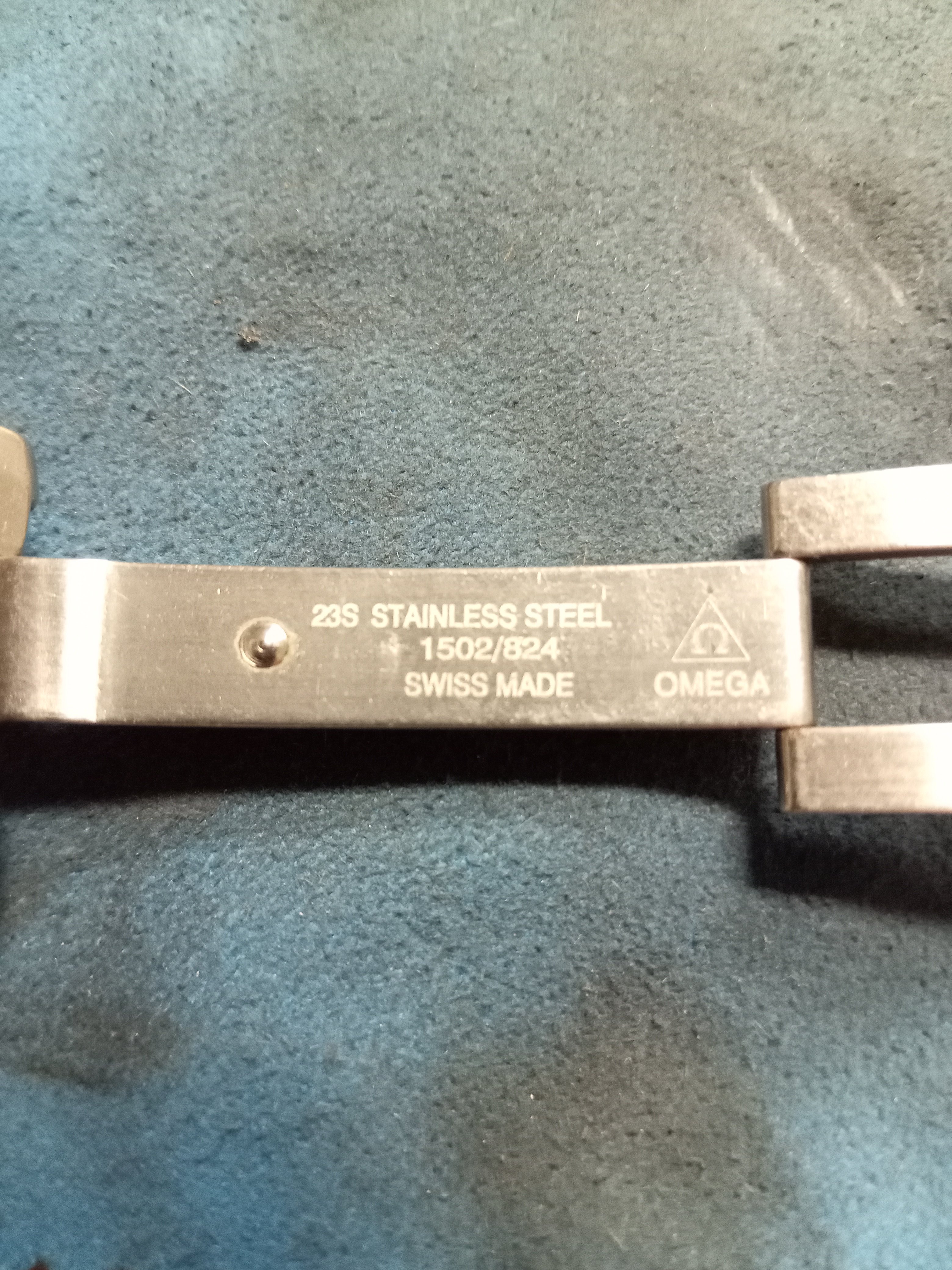

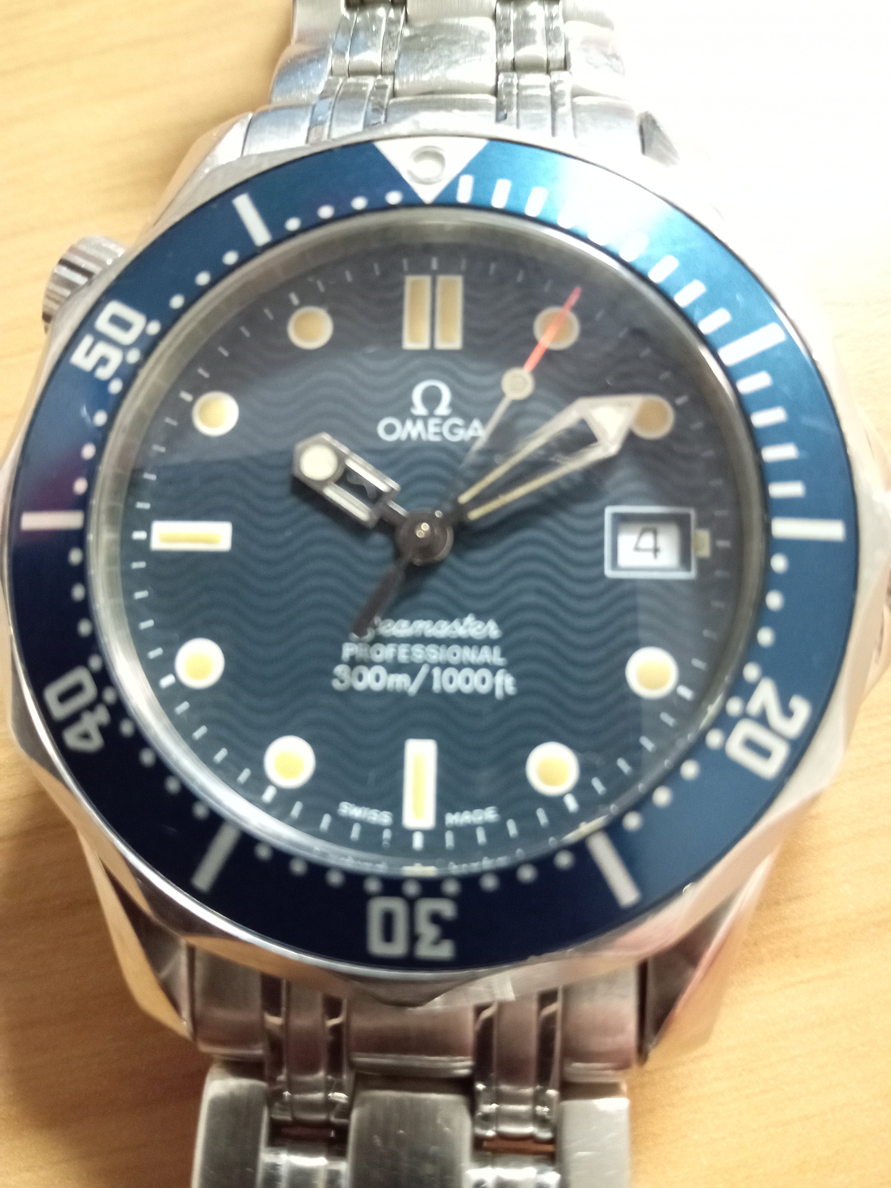

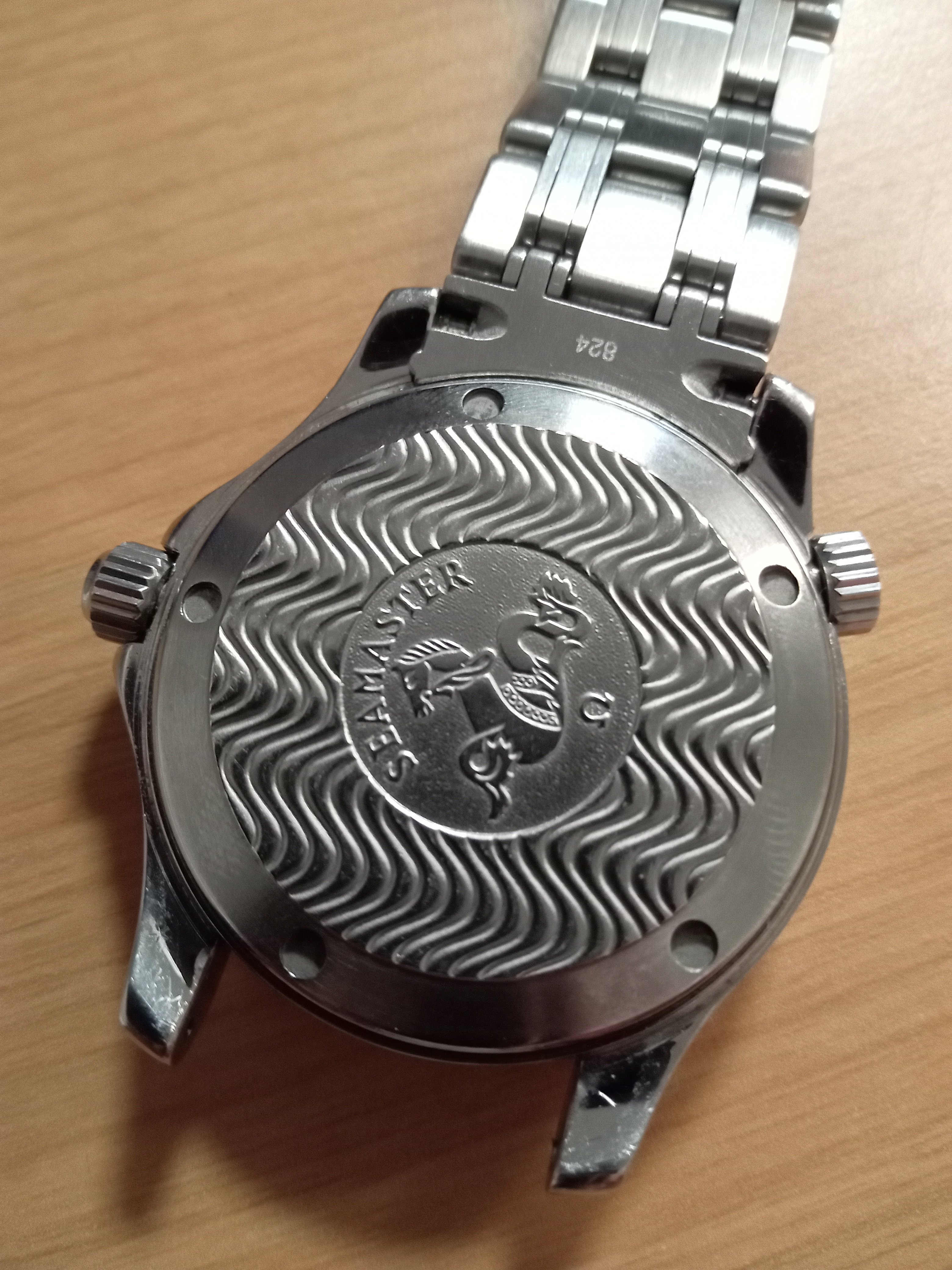

I recently got this from my family member and he told me that he got it in the 90s. Though i am doubting that if its an authentic piece. What do you guys think? thxx

I don't see an obvious problem with it. What are your concerns?

I couldnt find a serial number

Maybe there is a sticker on the movement somewhere. I'm really not so familiar with the quartz models. Hang in there, someone will know. I guess it's possible that the serial was obscured by polishing.

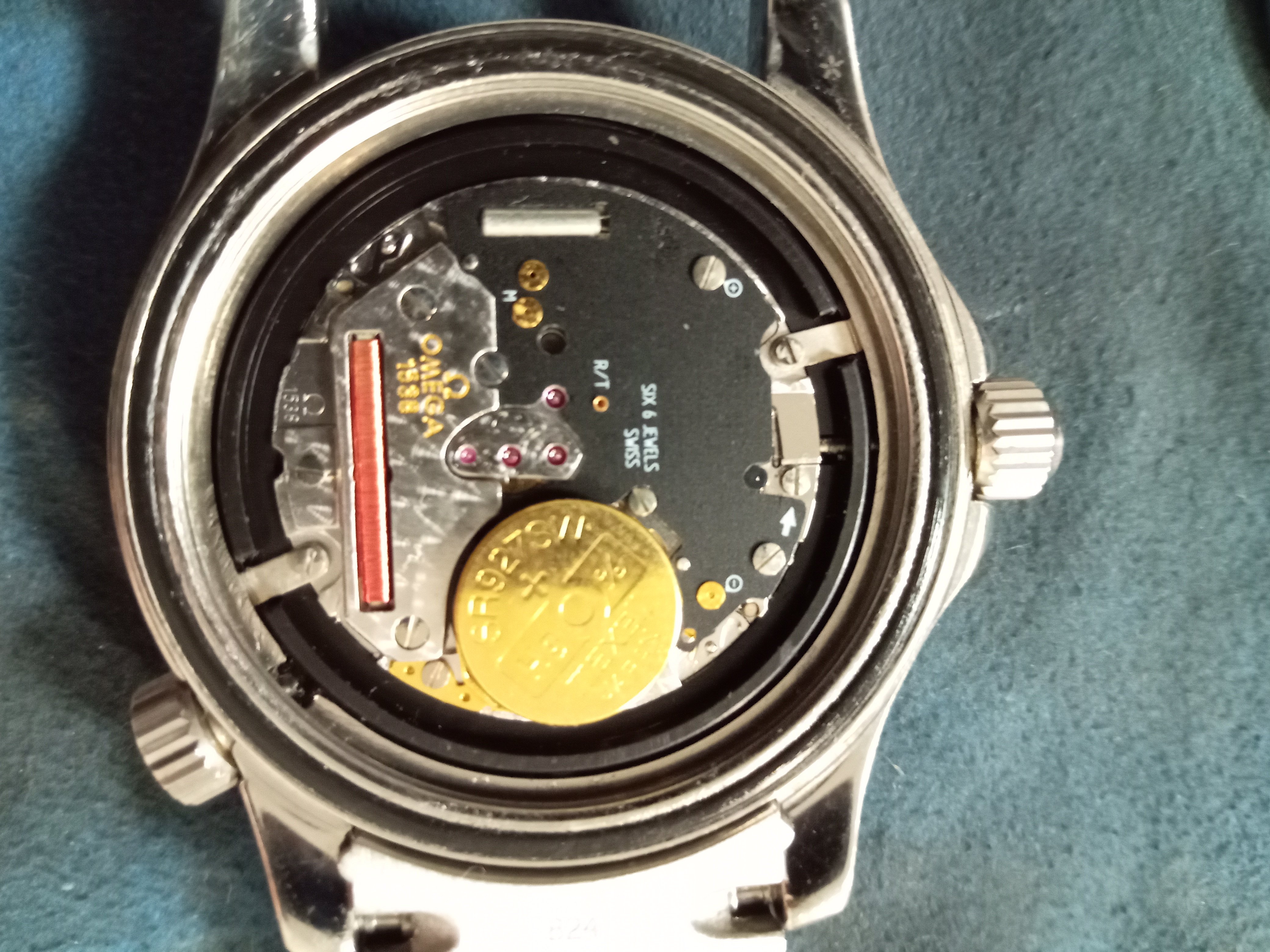

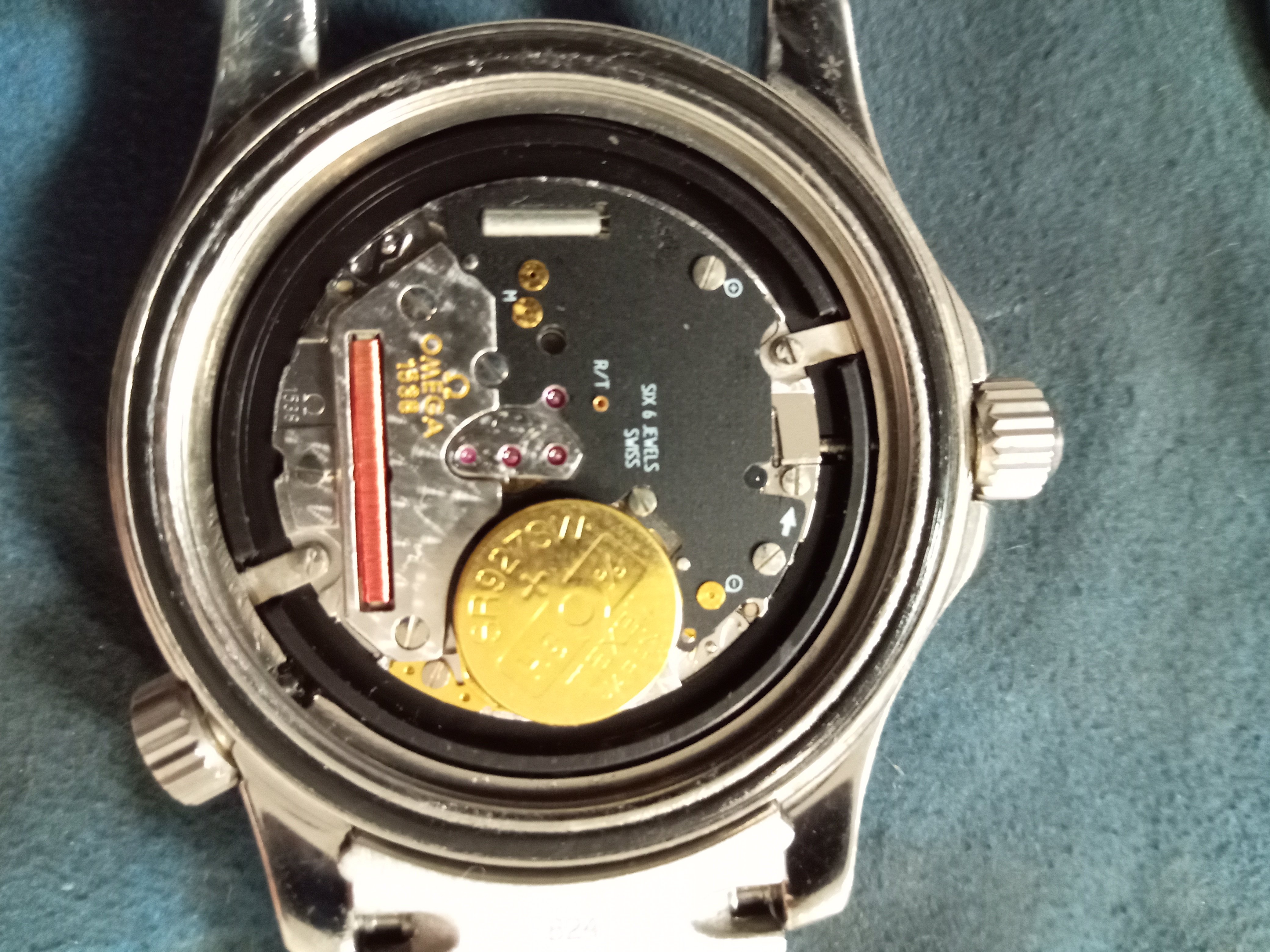

The movement is not made by Omega, so no Omega serial number like on Omega in-house movement. It's an Omega re-badged ETA 255.461, but I am pretty sure the watch is authentic.

Is it like OEM or something? The engraving on the band was so thin that it looked like a laser engraving but...

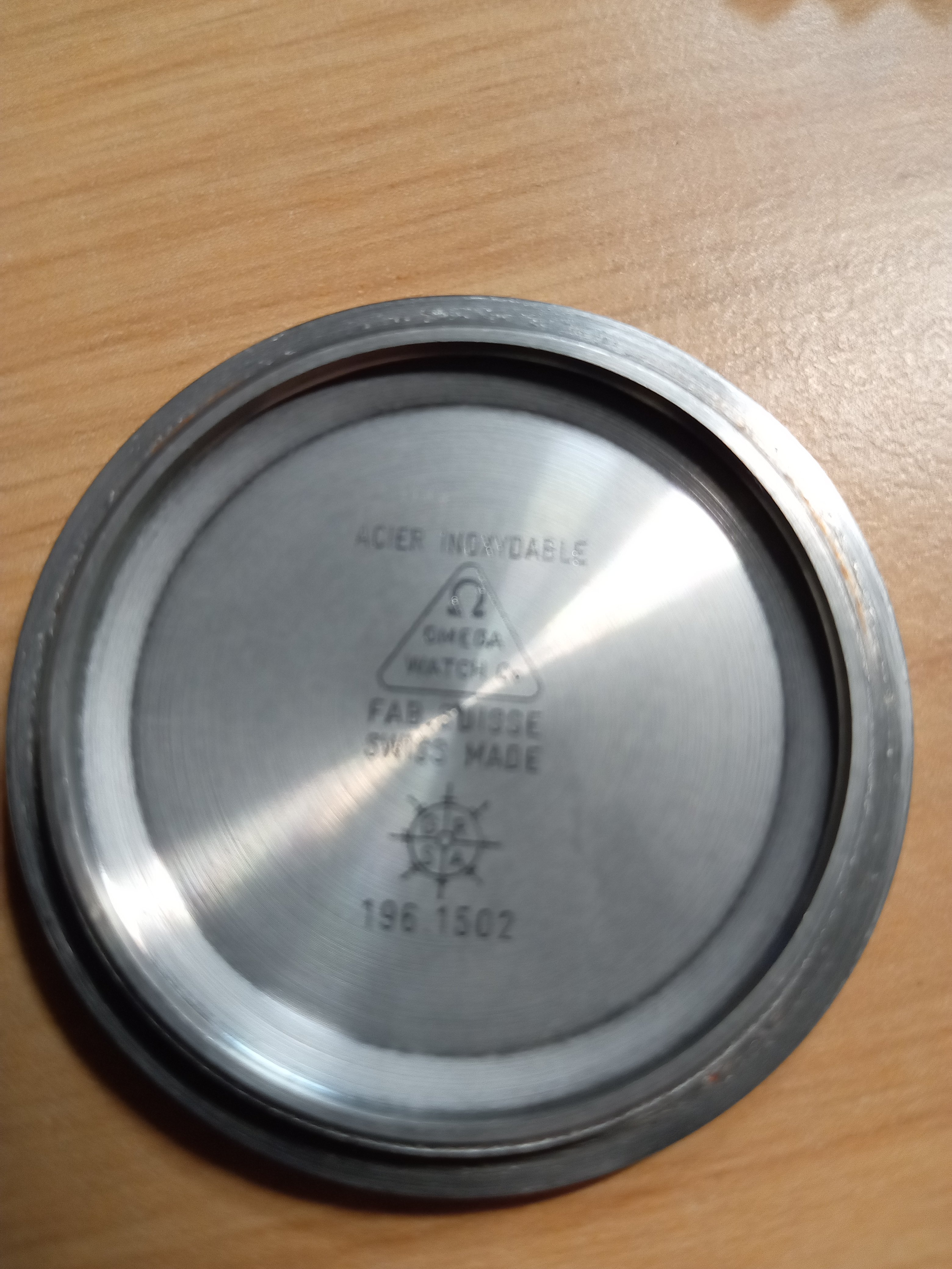

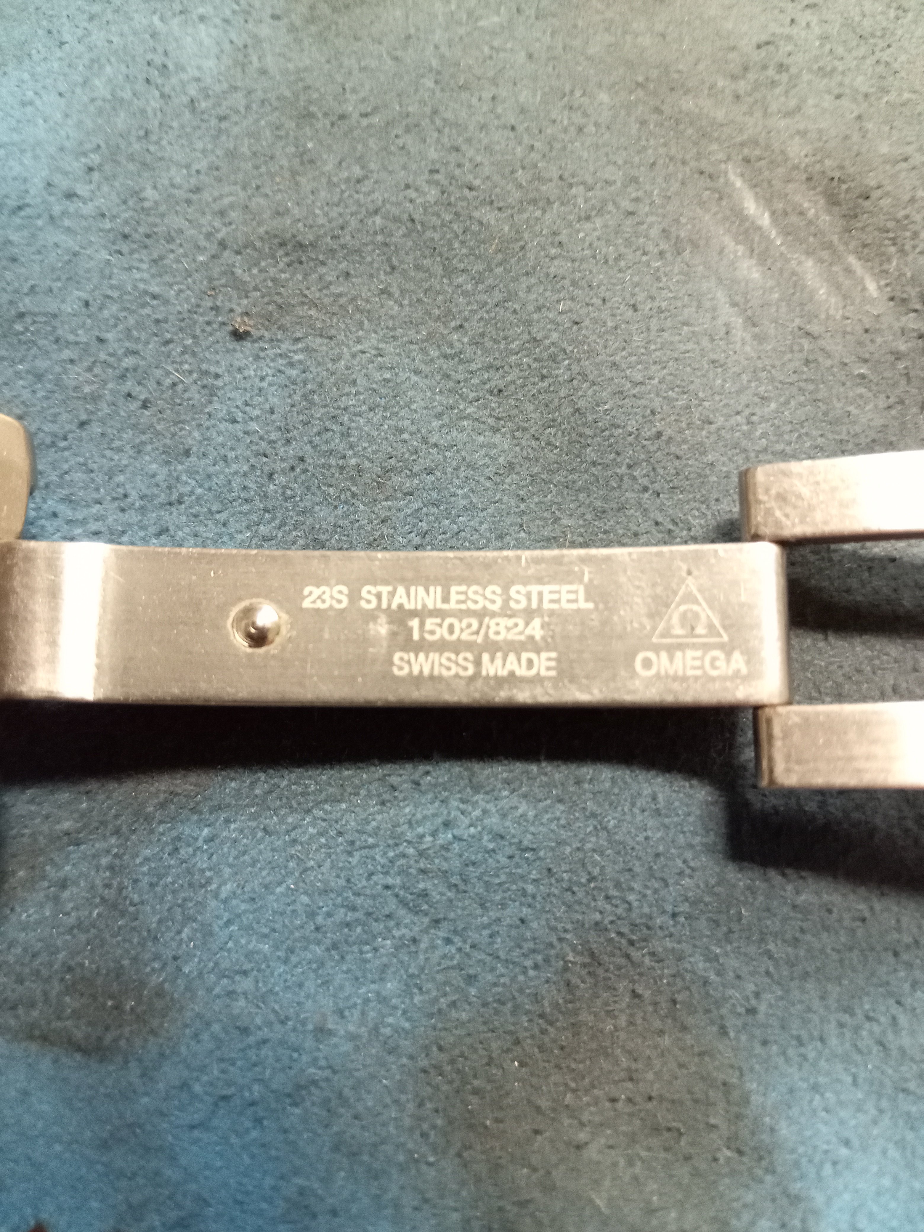

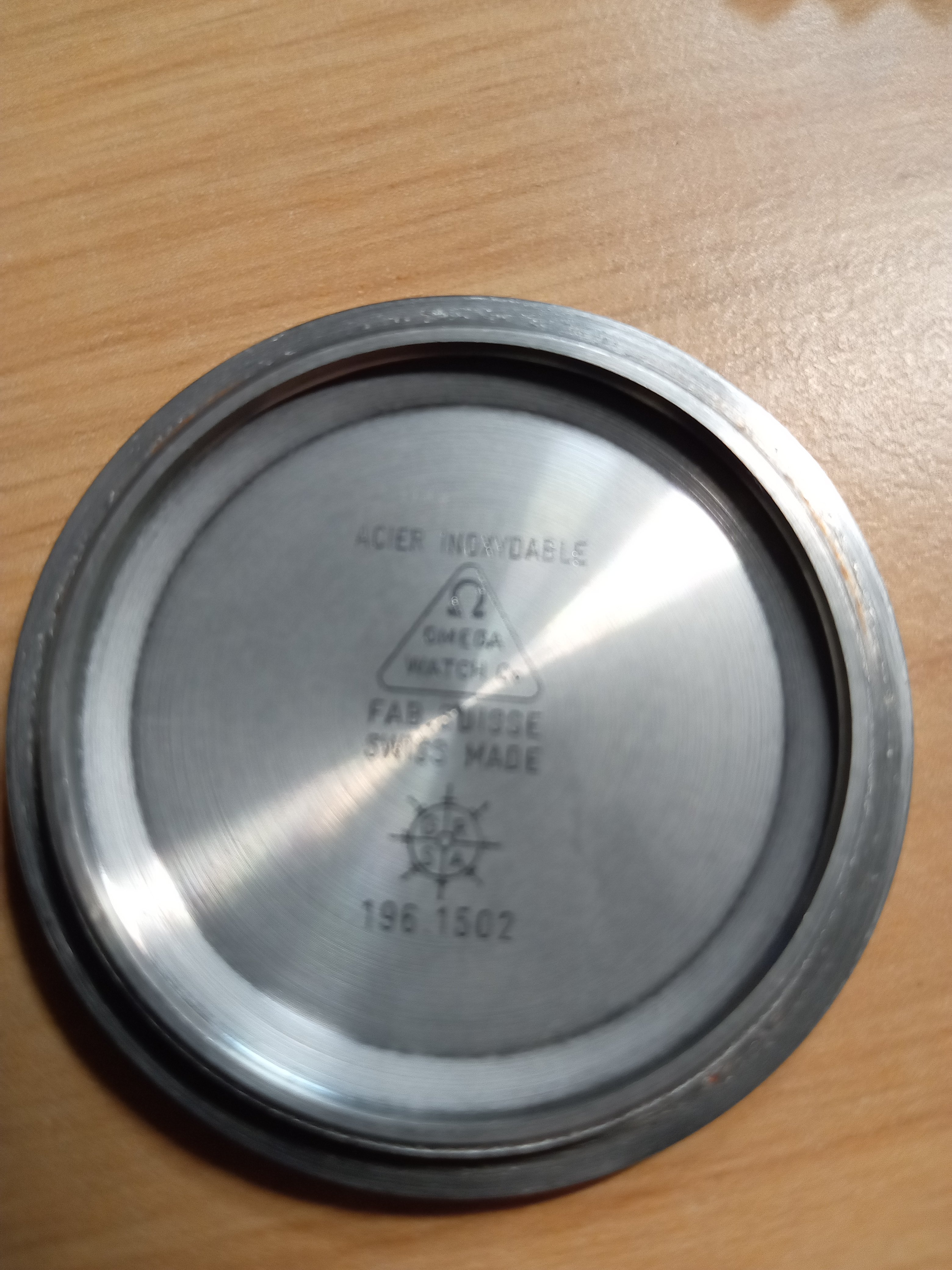

It’s a genuine mid 1990s mid size Bond SMP quartz. The serial was likely inside the caseback which has either been replaced or parts-washed off. It would have had it on a lug too but it’s been polished off. Maybe it was sold via a grey market dealer originally and they have erased it. That was quite common once. The serial was never seen on the movement as they were routinely swapped at service time.
ps it’s not what most here would consider vintage. The model was current until 2006, yours is an earlier one though as can be seen from the Tritium lume.

great to hear that! thank you all for the interesting info guys, take care

Is the serial number on the back of the lower left lug you might need a loupe, my 2005 chronograph automatic has one there.

i found a small star-ish shaped imprint but the serial number is just completely missing. As the other guy said, I believe its been erased or something

Just to be sure, you're looking on the back of the lug closest to seven o'clock? The star looks to be near five o'clock. It's hard to say from those photos, but I think I can see the remnants of a serial number on the correct lug. If it's no longer legible, it could be nothing more than wear from strap/bracelet changes and polishing.
The watch looks legit to me

yeah... i checked it again but its completely gone

everithing here looks original. The serial number could be on the back of the lug at 7 o'clock

it could happen, but it does not mean that the watch is a fake

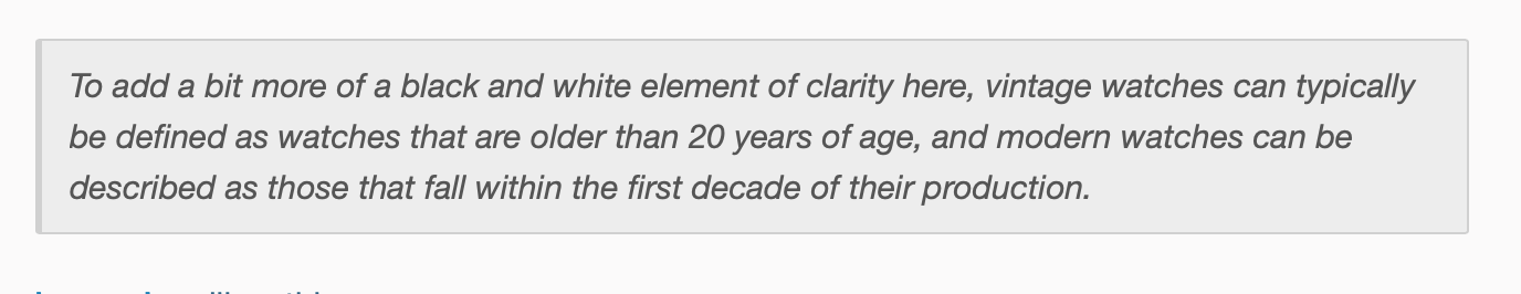

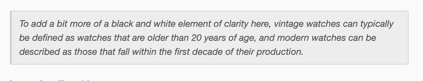

To add a bit more of a black and white element of clarity here, vintage watches can typically be defined as watches that are older than 20 years of age, and modern watches can be described as those that fall within the first decade of their production.
