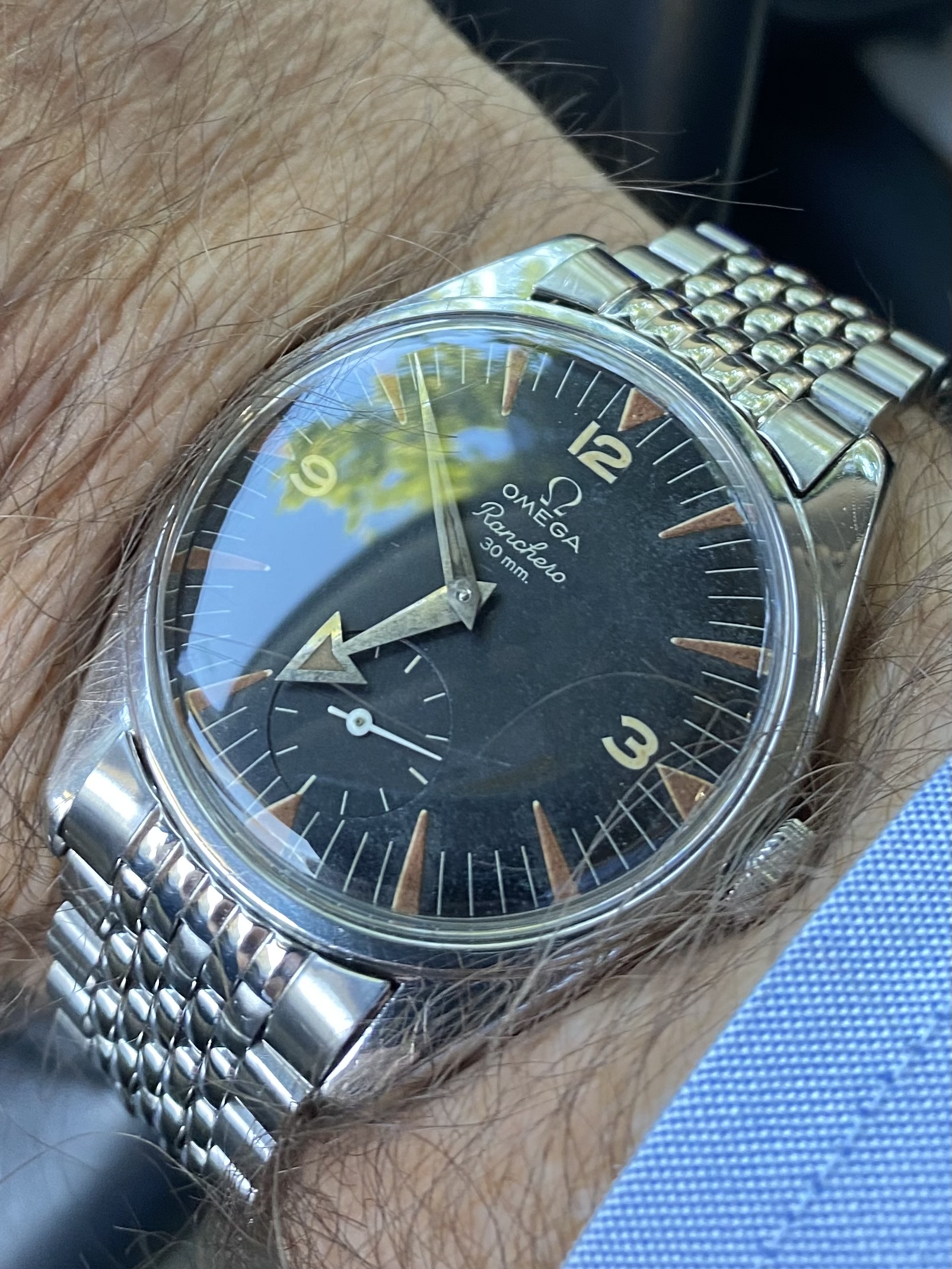

I would kindly ask the experts helping me to identify whether those Omega Seamaster 30 do have radium lume or not. I do think that both of them have radium lume as they don`t show the T for tritium before and after the Swiss Made. Both of them are earlier Seamaster 30 out of 1962. (reference 135.003)
Interested in your opinions as I do not own a geiger counter.
duffy
Try to contact the physics department if your nearest college or university. They will likely have a Geiger counter and would be willing to test your watch.
duffy
Bit of a late response!
As I say, the change over was around this time. Purely based on the look I would say the first SM30 has Radium lume and the second tritium lume ( or has been relumed with tritium at some point). The T marks were not seen until ~1964, the first year or so of Tritium use was not marked on the dial so the lack of Ts is not a reliable indicator for a '62-63 production Omega. Interestingly some Omega watches made in the 80s and 90s with Tritium lume dials are also missing the Ts, the first 4 years of Bond SMP production for instance. This had Tritium lume but no Ts up until the change to SL in ~1998.
