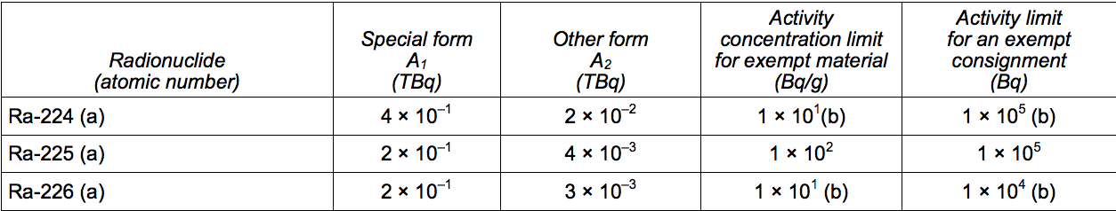

    I have sent radium watches internationally and never had a problem. But I was interested in this question and did a little digging. The first place I went to was Royal Mail. Which states the following are prohibited: "Radioactive materials and samples that are classified as radioactive using Table 2-12 of the latest edition of the International Civil Aviation Organization’s Technical Instructions e.g. fissile material (uranium 235, etc), radioactive waste material, thorium or uranium ores and luminous dials from aircraft."
    The most recent ICAO instructions I could find are here: http://www.ubak.gov.tr/BLSM_WIYS/TMKDG/tr/doc/20170130_112447_64574_1_64.pdf with table 2-12 on page 113 of that pdf. According to the Health Physics Society, radium used for illumination was radium-226. The above table indicates the following:
    However, I have no idea what this means, as physics was not my forte at school. Perhaps someone with more knowledge of radioactive decay could take it from here?

  6. Tony C. Ωf Jury member Dec 5, 2018
    7,384
    24,199
    Bq = becquerels
    Bq/g = becquerels/gram
    Not sure about how they are measuring.
    When watches are measured with devices, the radiation emitted is typically measured in sieverts or microsieverts. Sieverts are a measure of exposure; that is, damage done by radiation. Becquerels are a measure of radioactivity of a particulate.
    I suspect that vintage watches would fall well under the cutoff, and be exempt, but am not certain.
