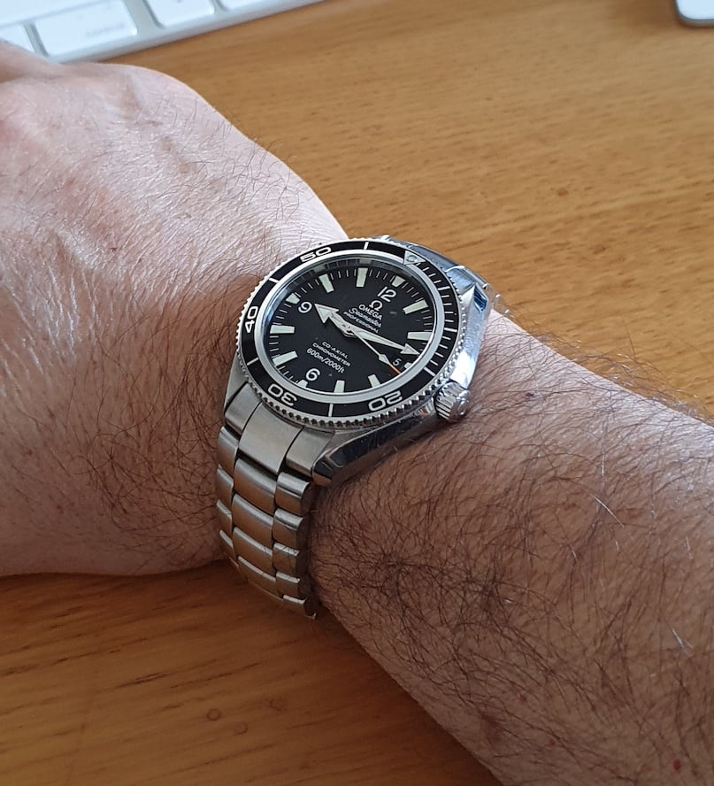

IMO it wears similar in size to my 5-digit SD, somewhat thicker than a Sub. But the dial is bigger and the bezel narrower, which can give the impression that it's bigger to some ppl. The bracelet of the PO is also thicker than the classic oyster, that also contributes to a more pronounced wrist presence.
I'll post some side by side pics tomorrow...

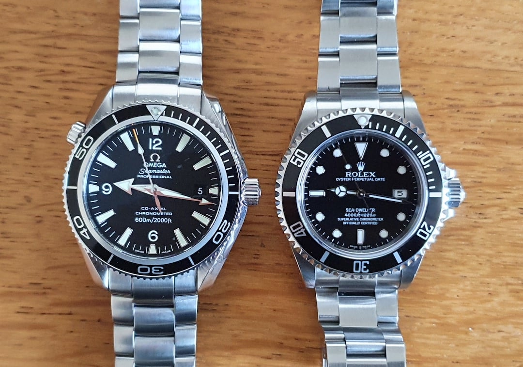

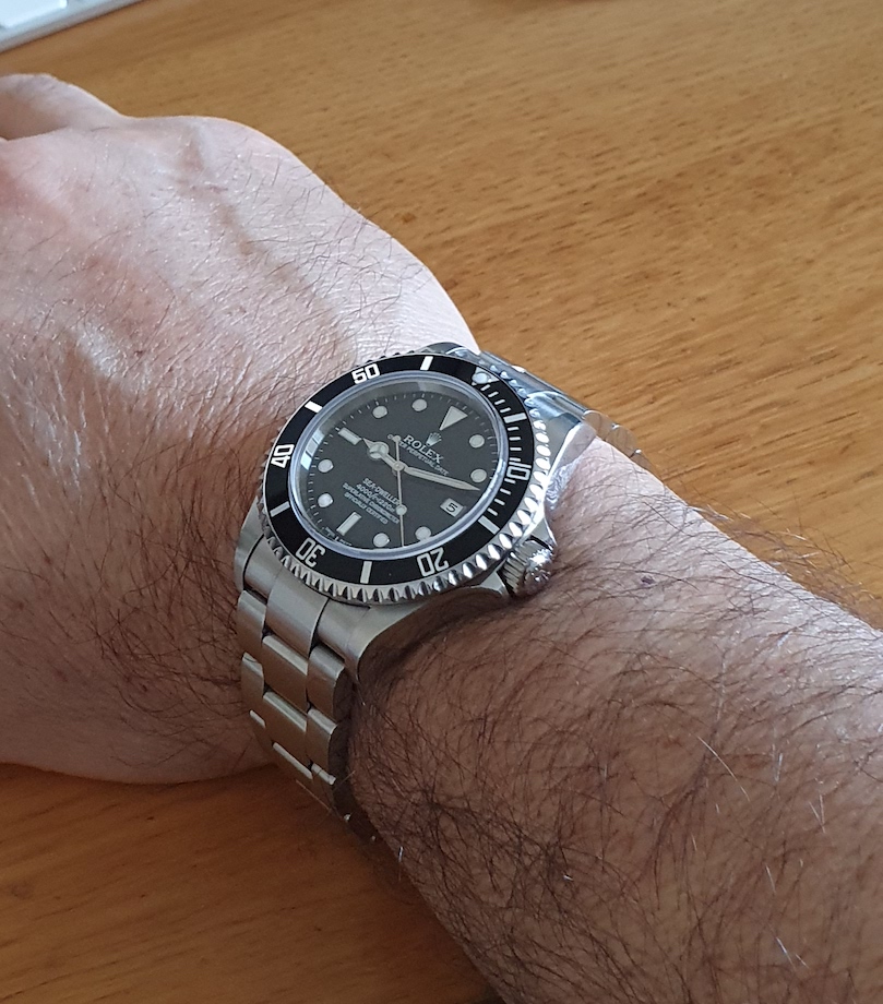

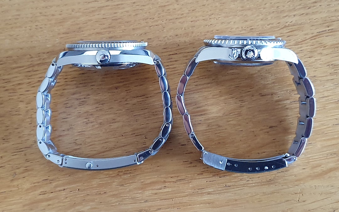

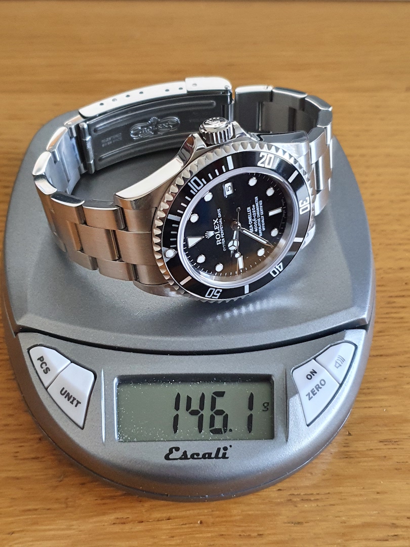

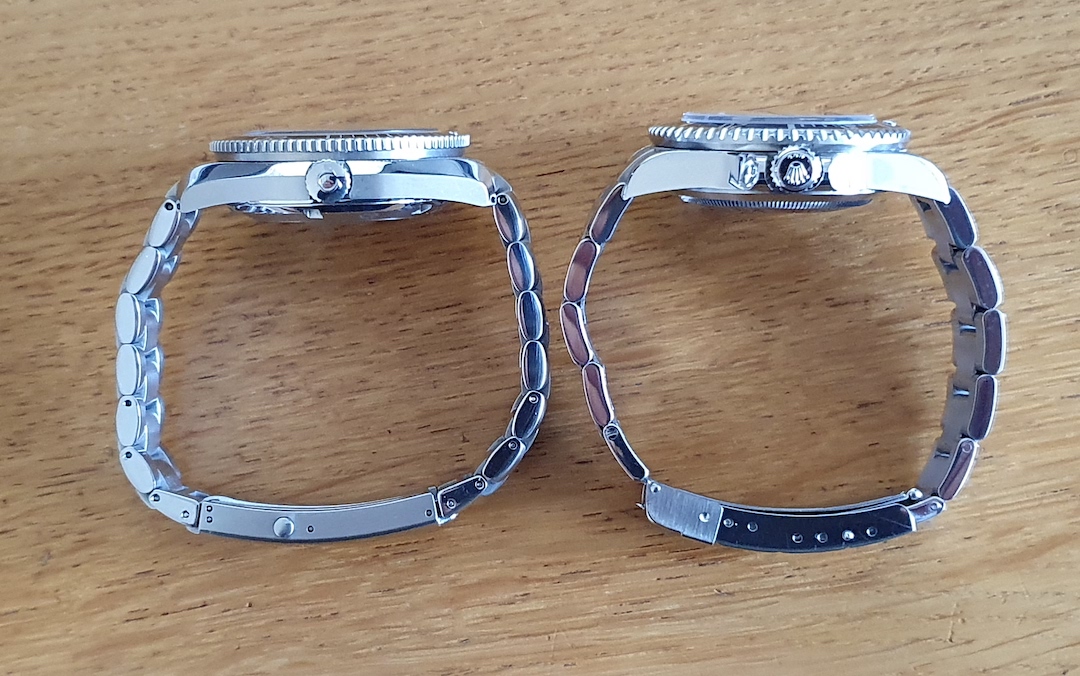

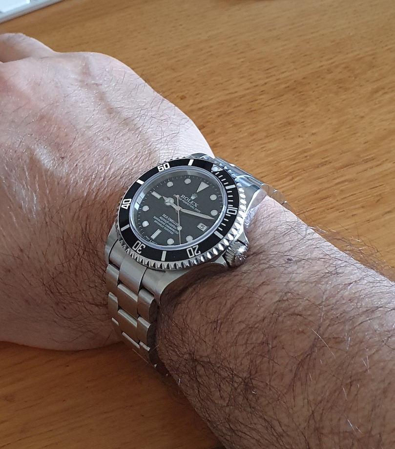

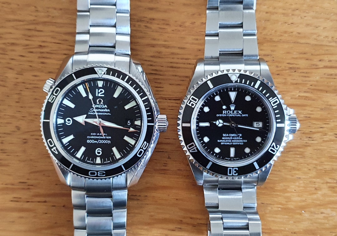

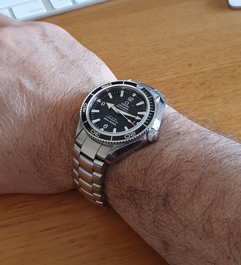

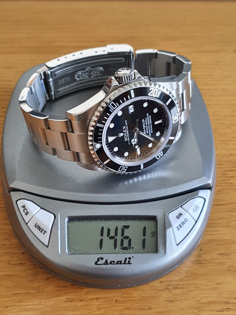

A bunch of comparison pictures against the 5-digit SeaDweller. Objectively speaking, the PO is larger by a couple of mm. You can clearly see that the dial is significantly larger, which accentuates the perception of it being a bigger watch. But I'd say they wear rather similarly.
Now, in terms of comfort, in my book lighter is better:
(Hmmmm, now that I think of it. Maybe I need to take the PO to Omega to have the Helium recharged... I knew I shouldn't be messing around with the HEV.... 😉)

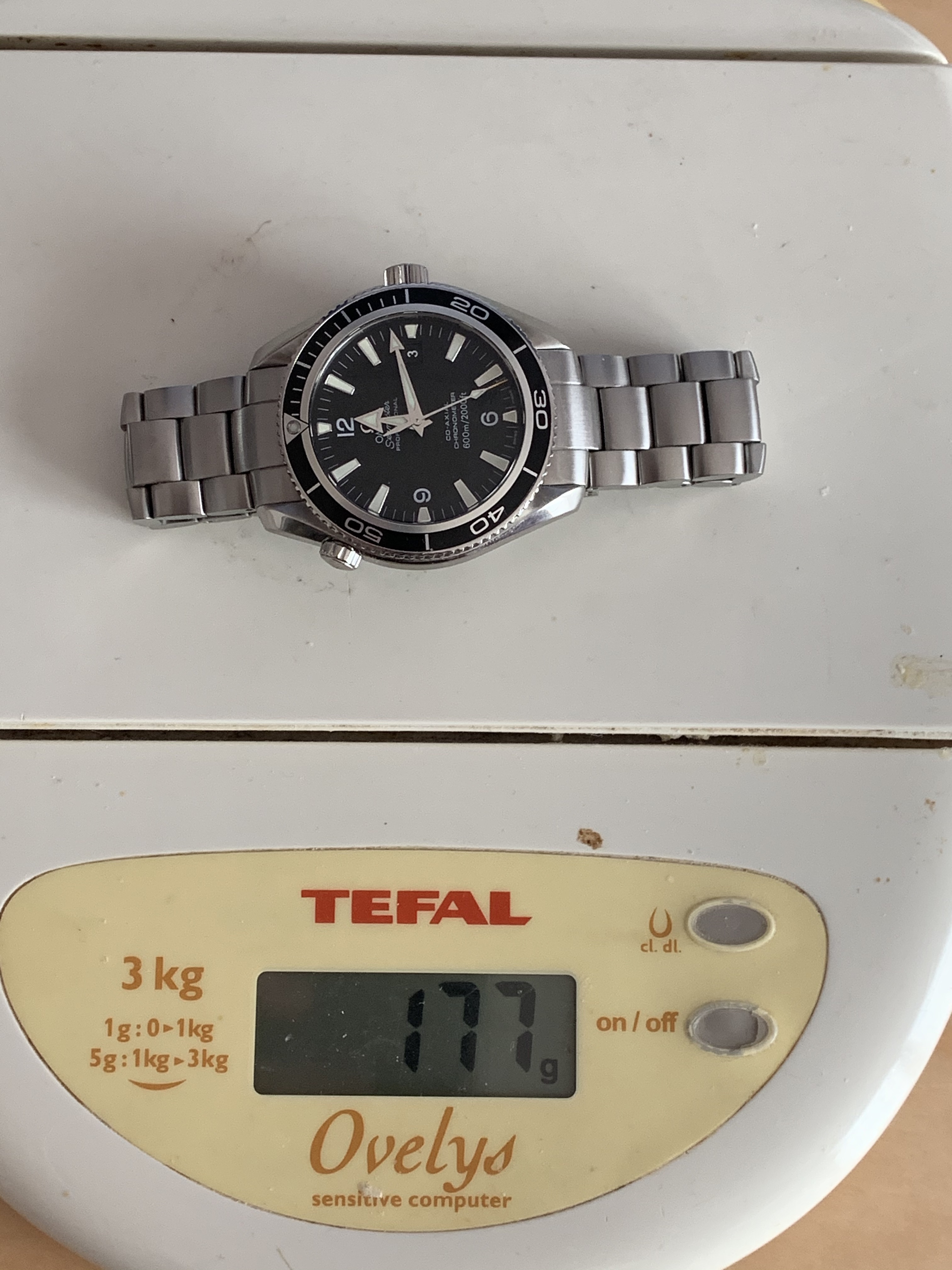

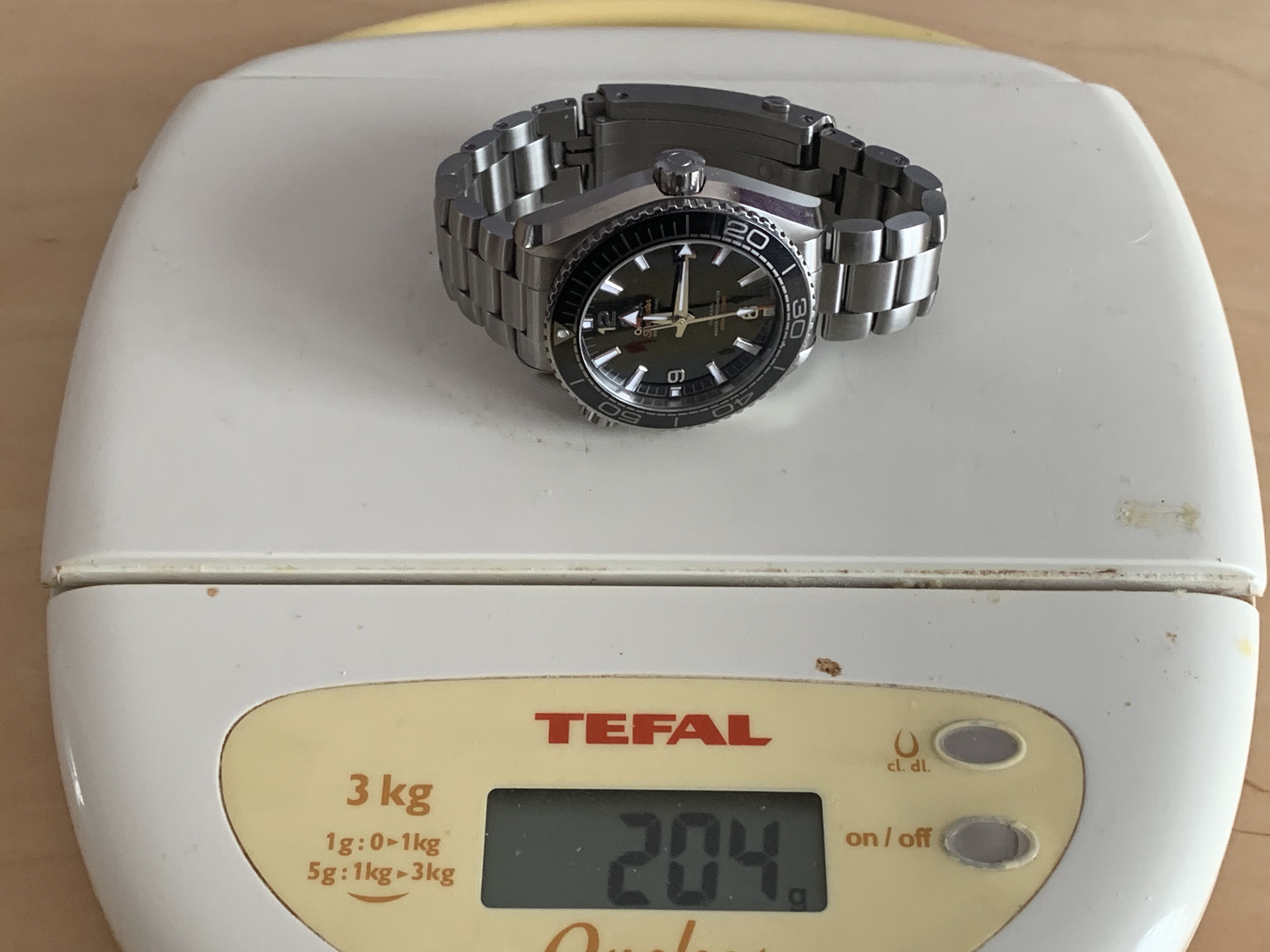

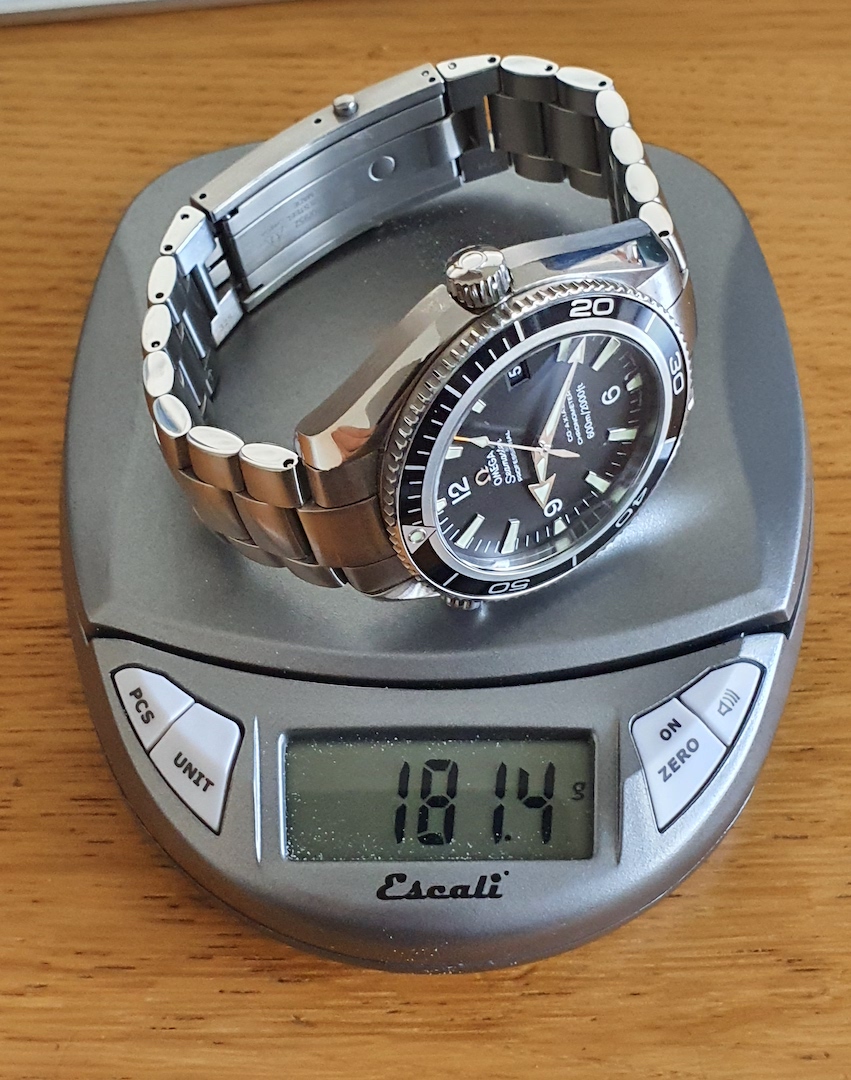

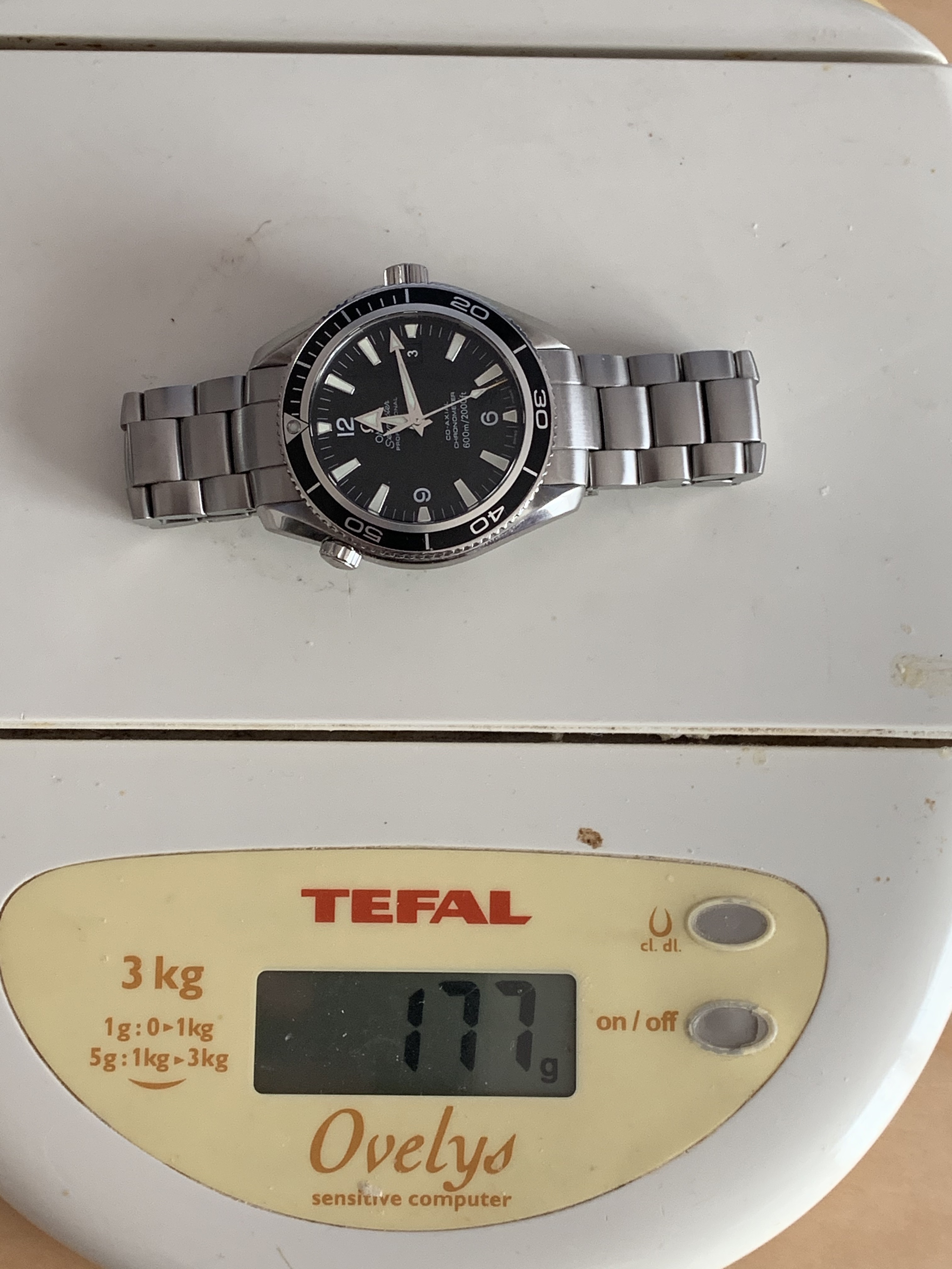

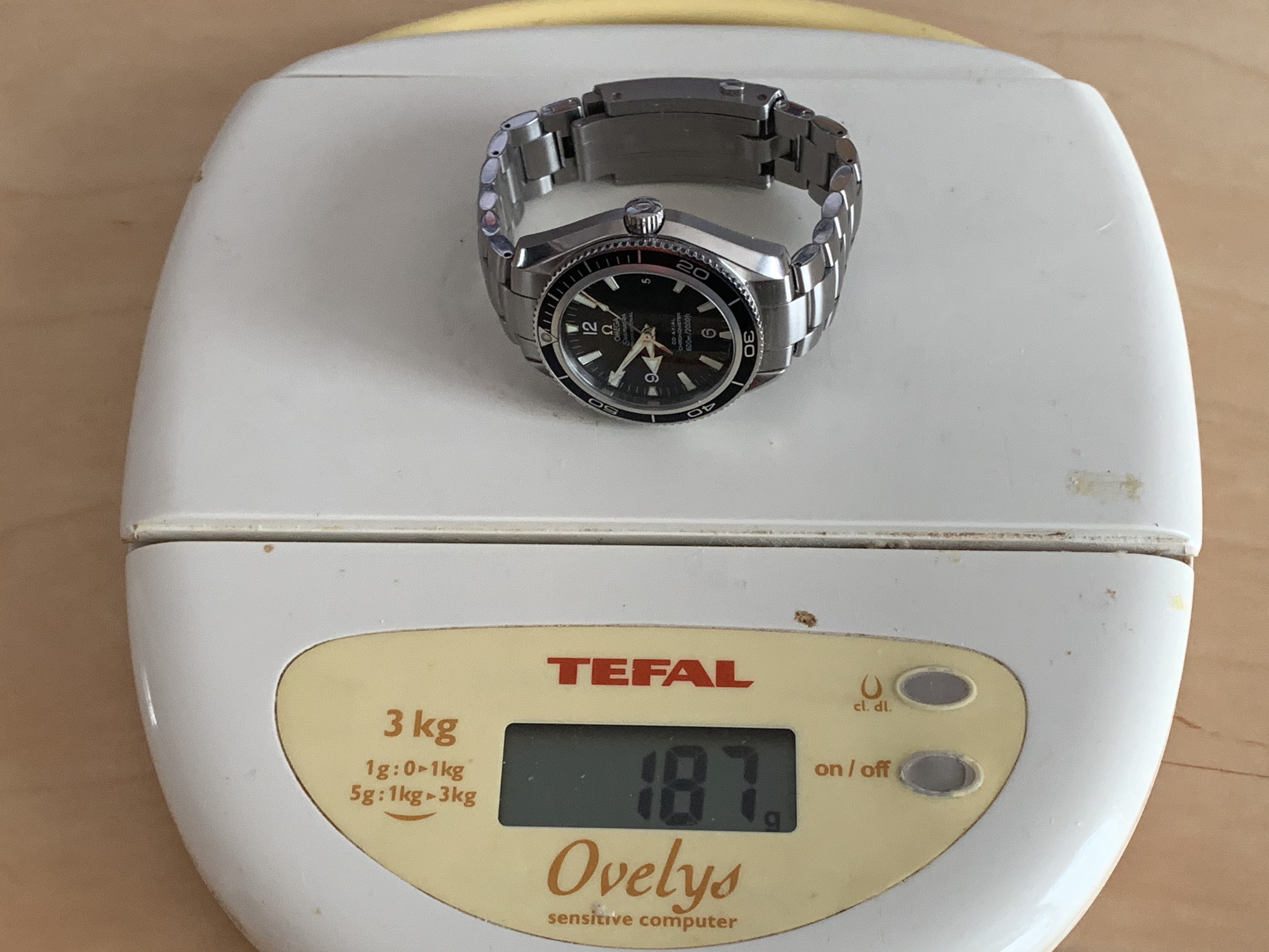

Those 5 digit Sea Dwellers, they are 40mm? The size and dimensions/thickness look very close to the 39.5mm 8800 Planet Ocean's.

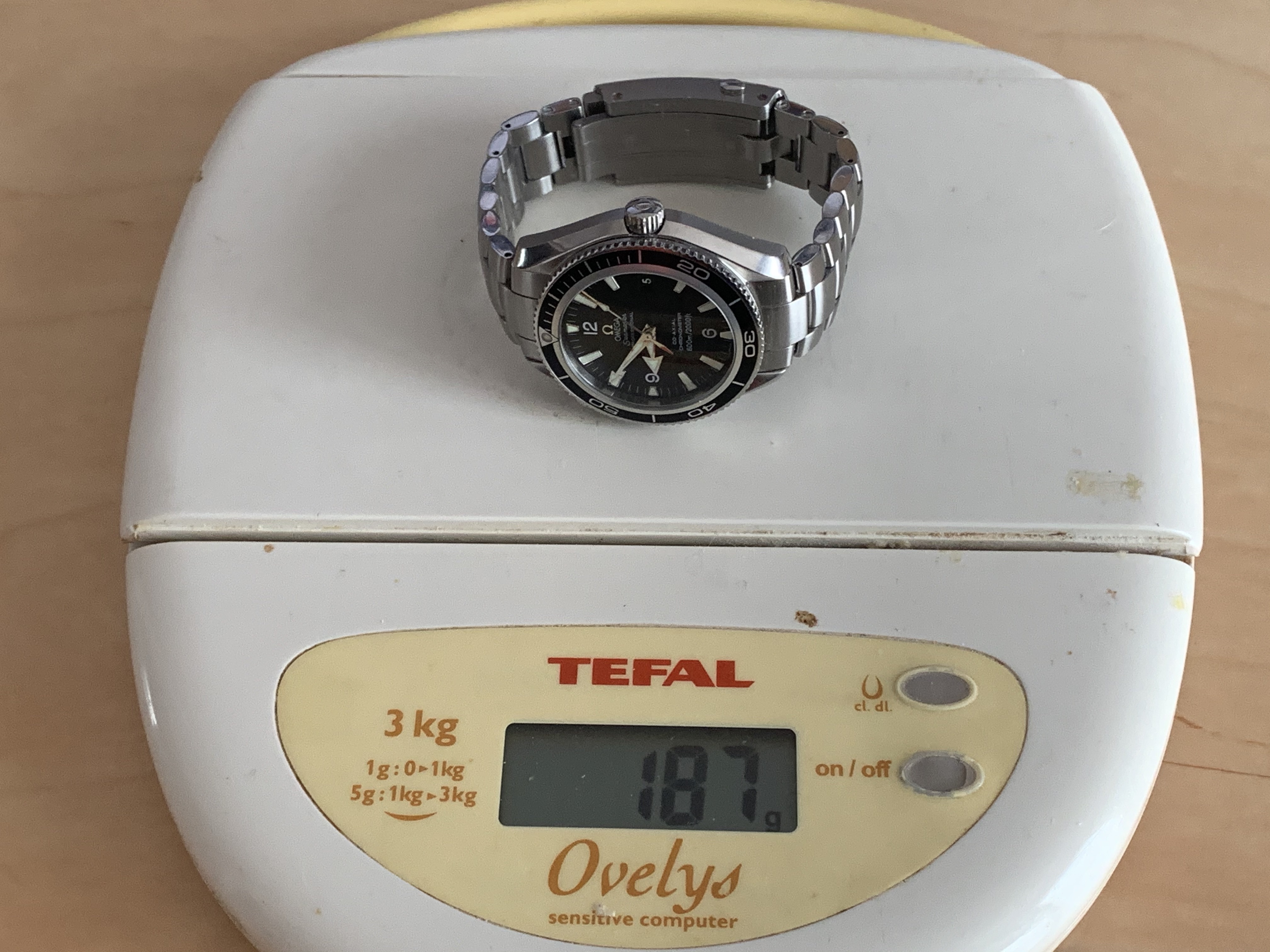

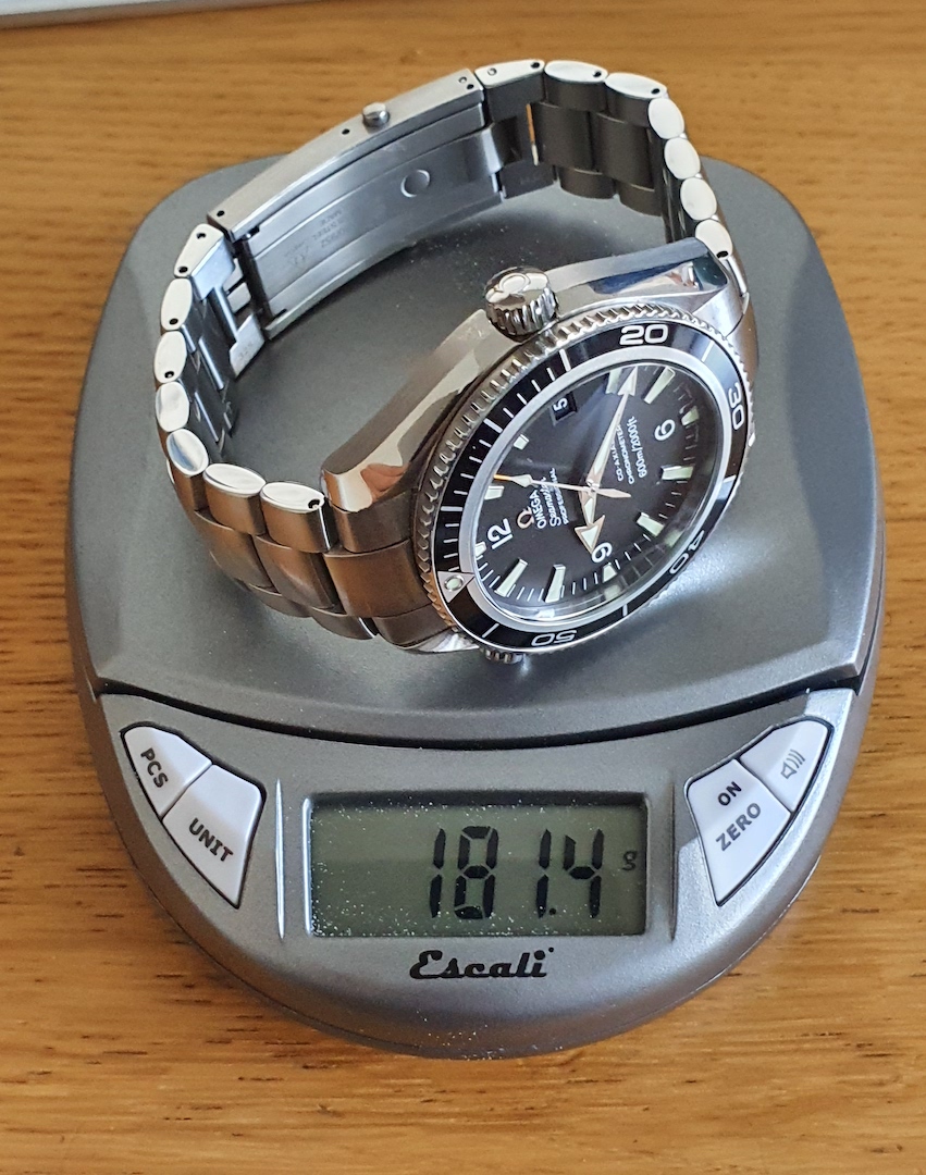

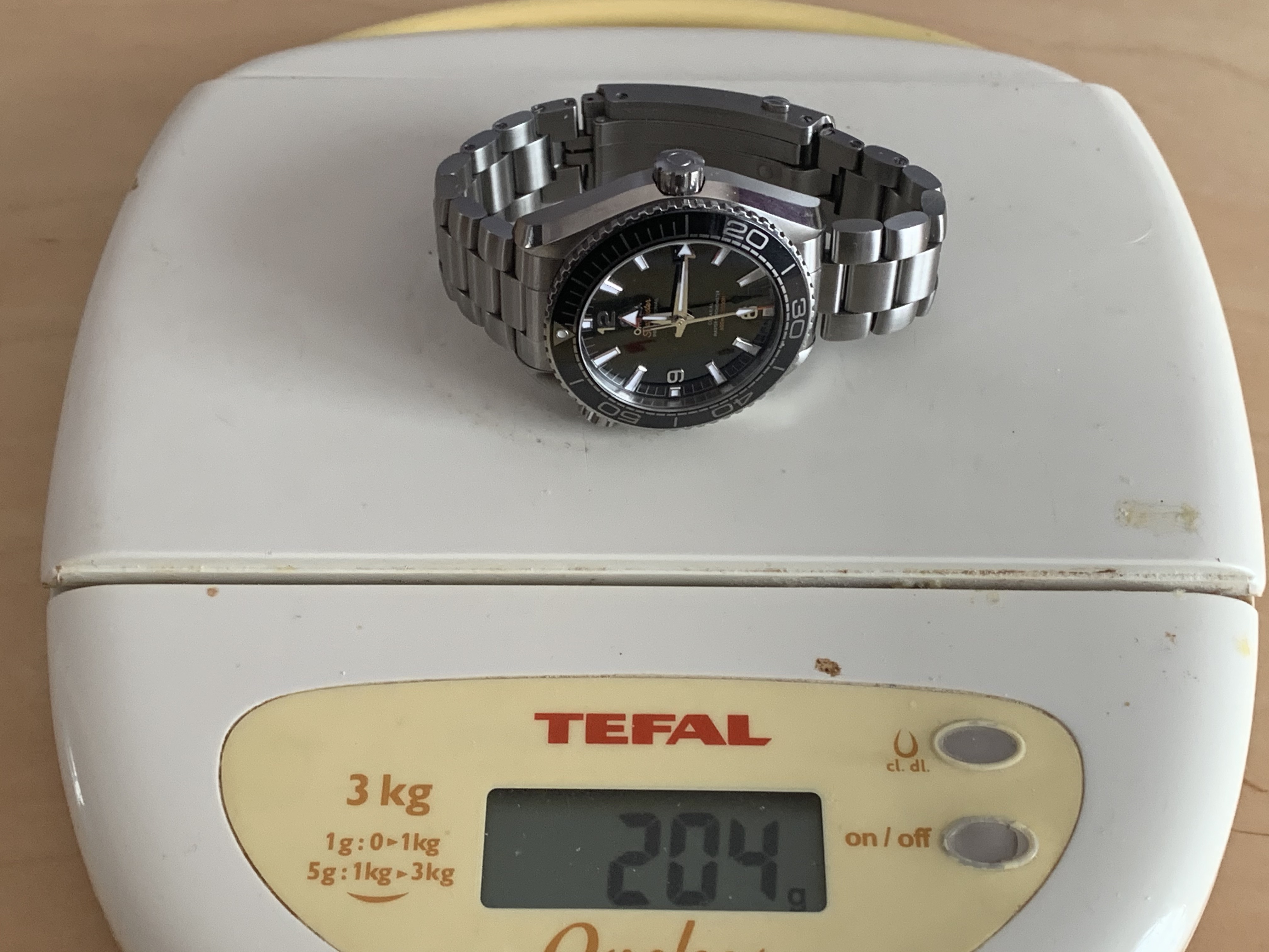

It is funny going from the standard clasp at 177g to 187g with the adjustable clasp, I do not feel any difference in the weight when wearing it.
However going to the 8900 at 204g which is adding another 15g+, the distribution/feel is quite different. Everything is bigger though from the thickness of the links on the bracelet to 2mm thicker watch.

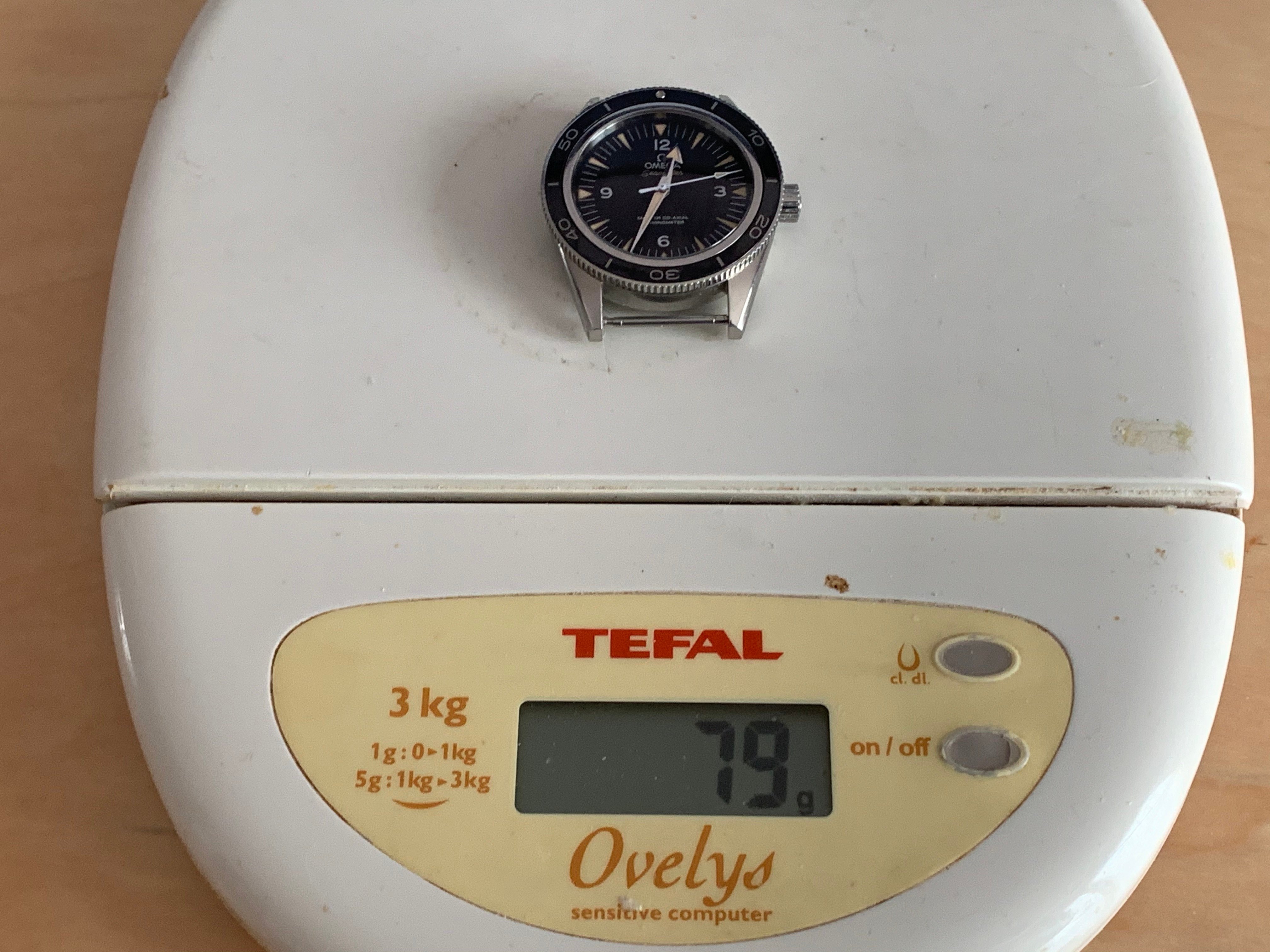

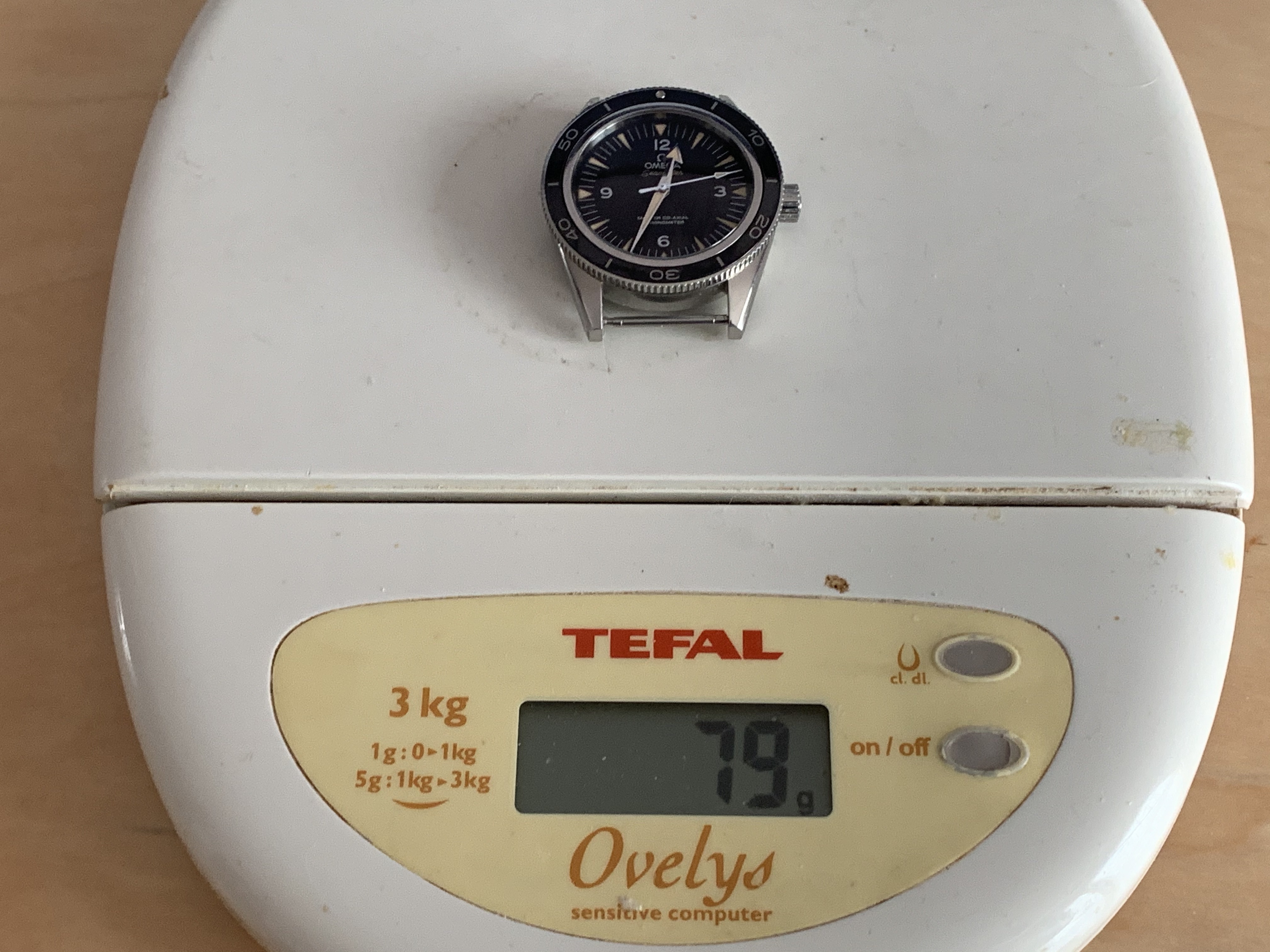

I wonder what the 2500 PO weighs without the bracelet. The 8900 PO's off the bracelet are 117g if I recall. The Seamaster 300 Master Co-axial off the bracelet came in at 79g on my scale. If I had to guess, the 2500PO is probably only a few grams more than a 300 Master Co-Axial.
