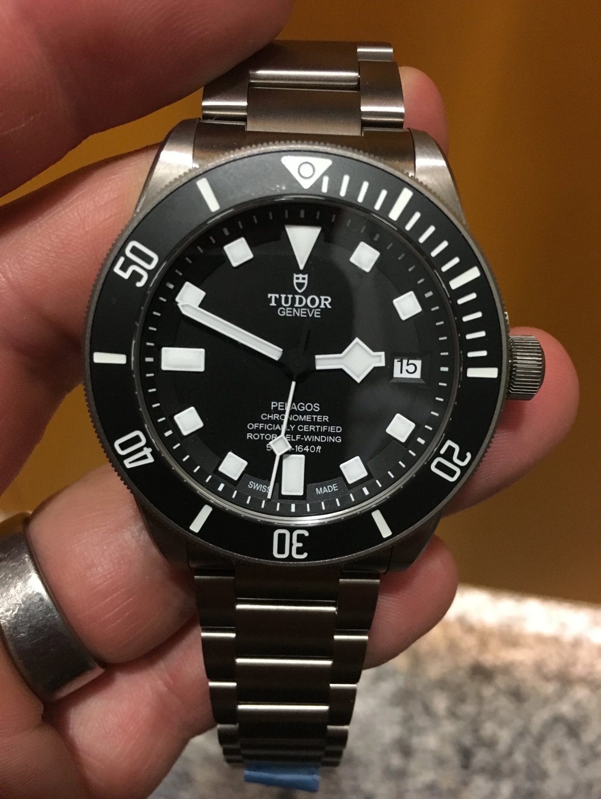

Tudor misaligned date wheel

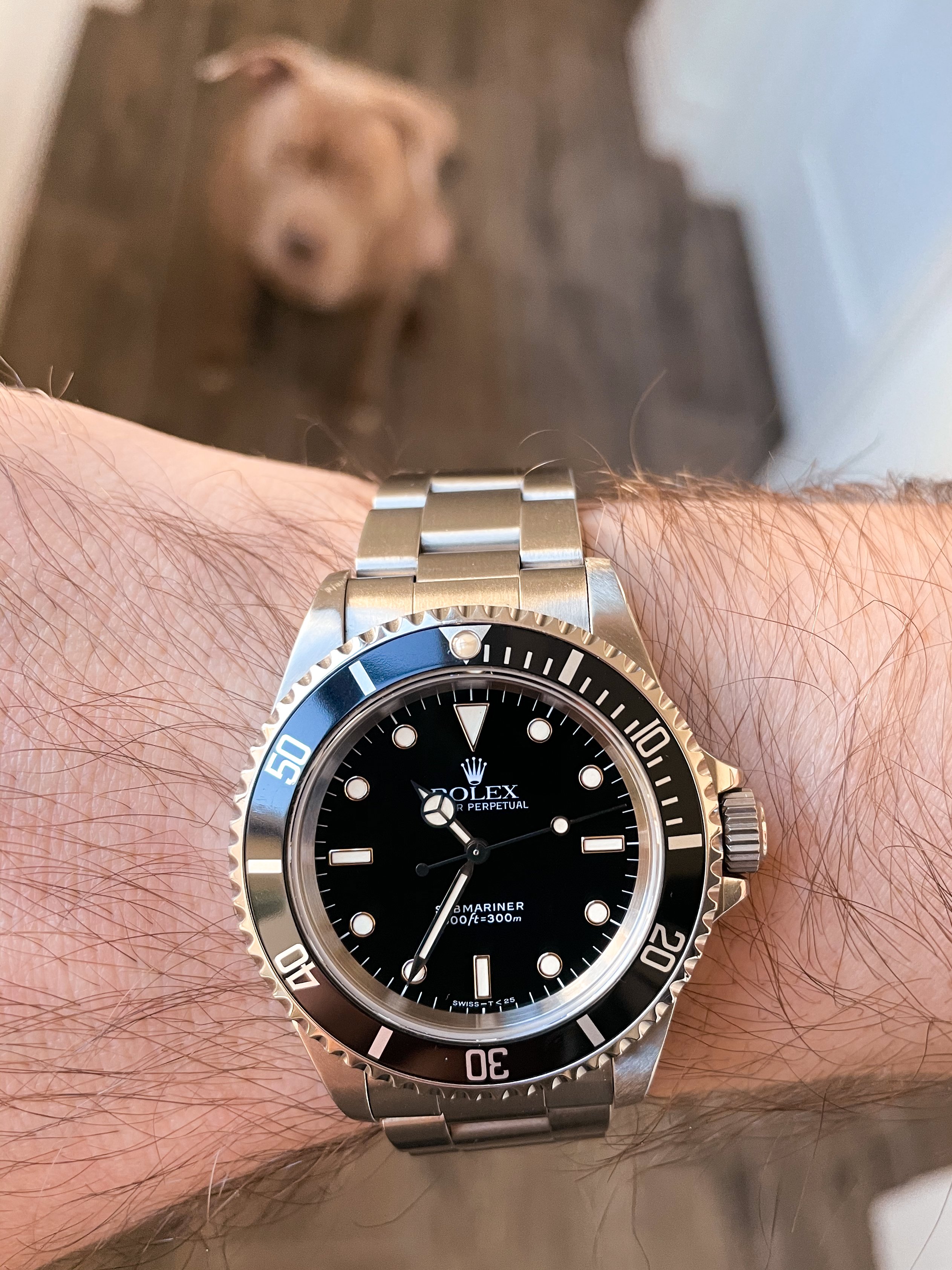

Misaligned hands. The proper way to see how “off” the hands are is to line up the hour hand with the hour marker… not the minute hand with the hour marker.

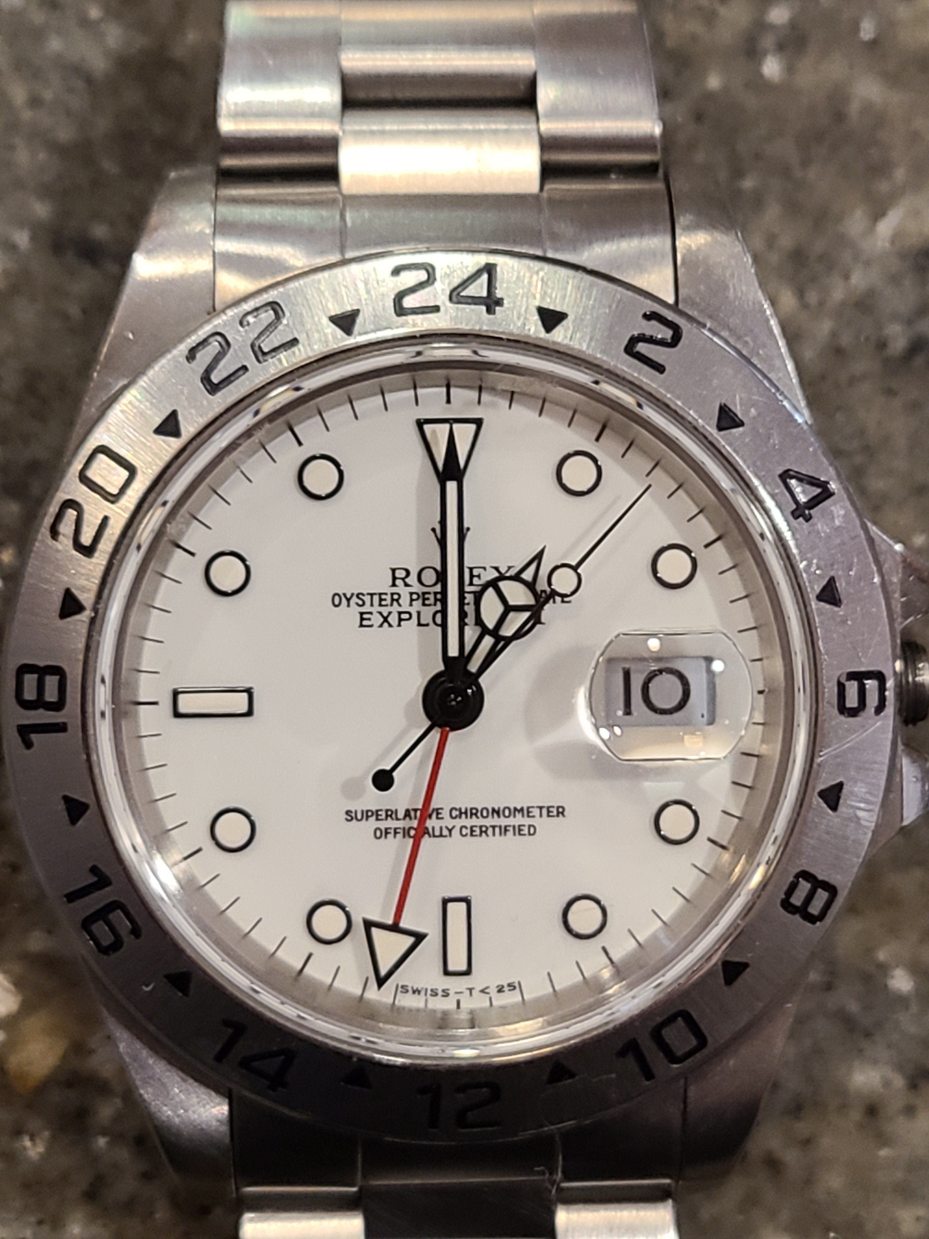

Engraving that doesn’t line up precisely at 12

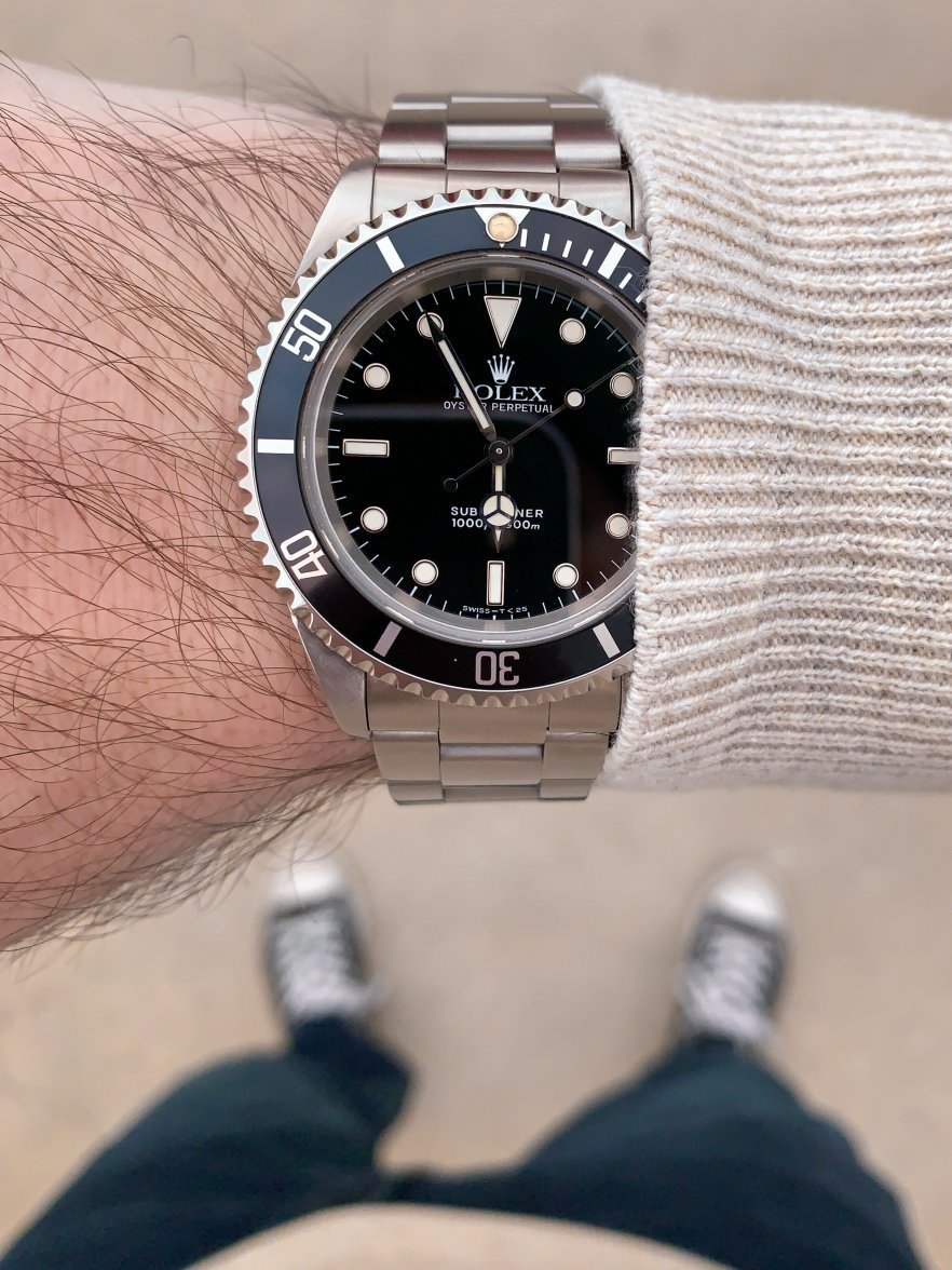

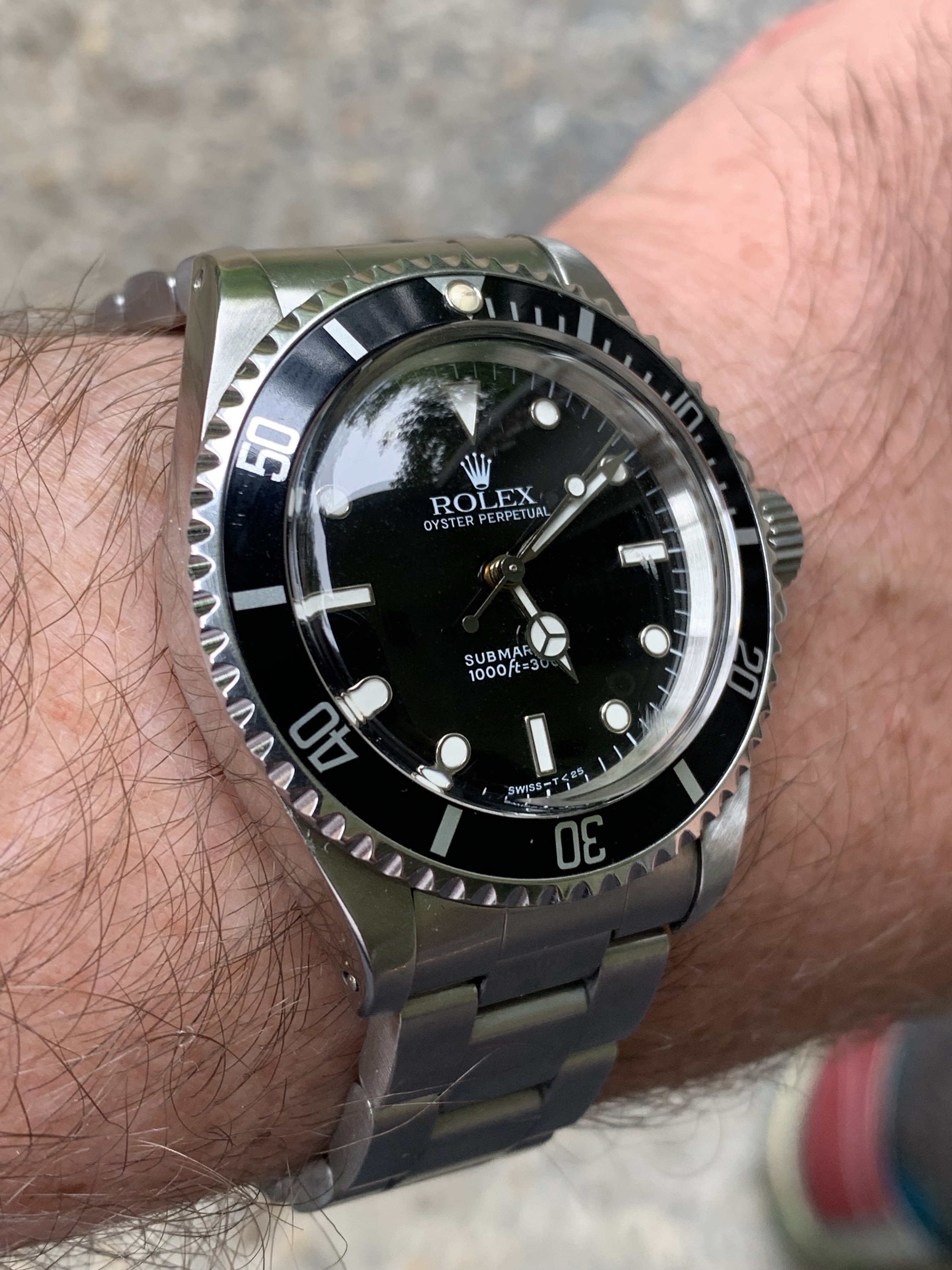

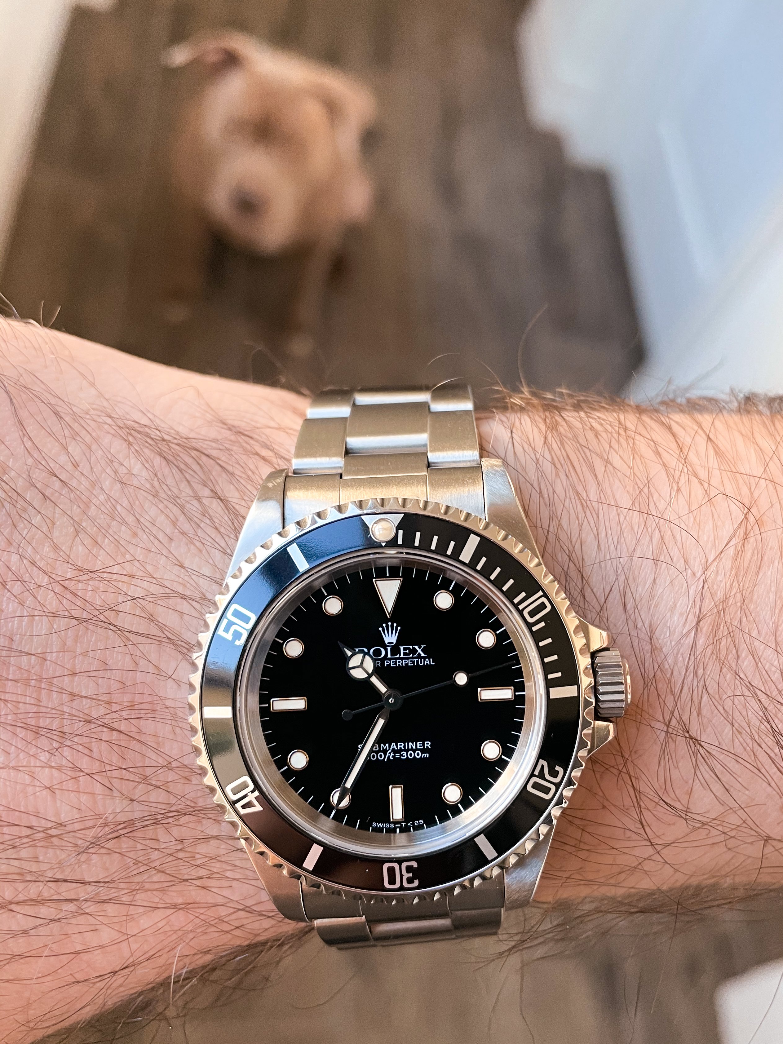

My own personal Sub had misaligned hands
The misaligned hands can be fixed and datewheel is whatever, the bezel is not great but okay, but that Explorer rehaut engraving would be absolutely infuriating. How did they let that past quality control? So simple to get that detail right. I think even the fakes nail the rehaut alignment these days.

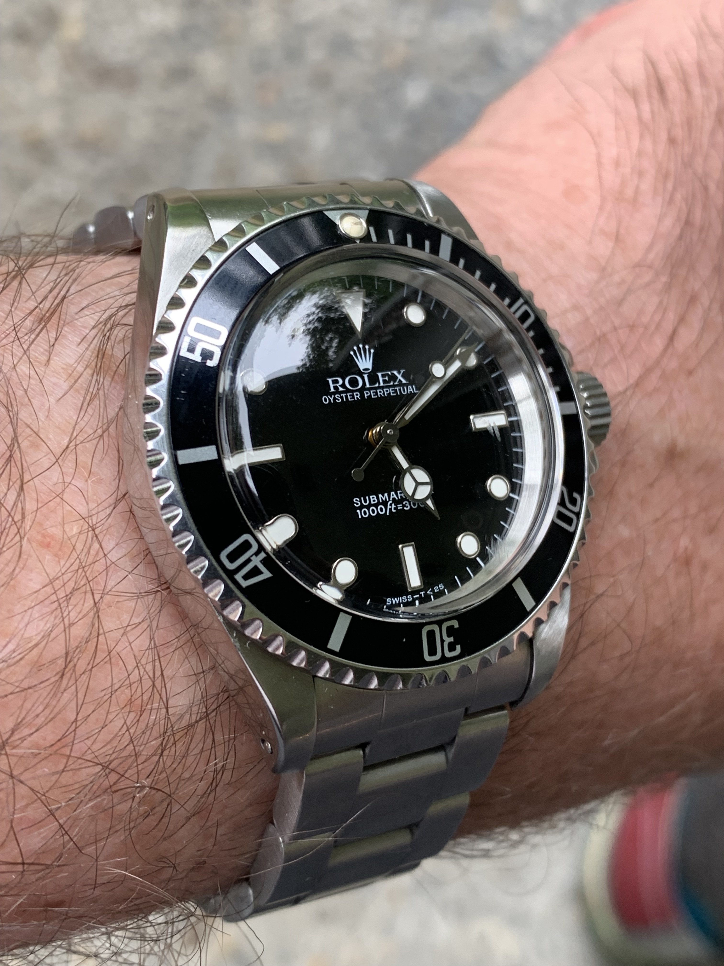

@Scarecrow Boat that's a beautiful sub, btw. Love that lume.
There are days that I do miss that piece. It is quite good looking. However, @JwRosenthal has been taking great care of it and enjoying it 😀
Edit- typo
One last wrist shot from when I had it
16,305
45,025
There are days that I do miss that piece. It is quite good looking. However, @JwRosenthal had been taking great care of it and enjoying it 😀
Yeah, Rolex would disagree….
