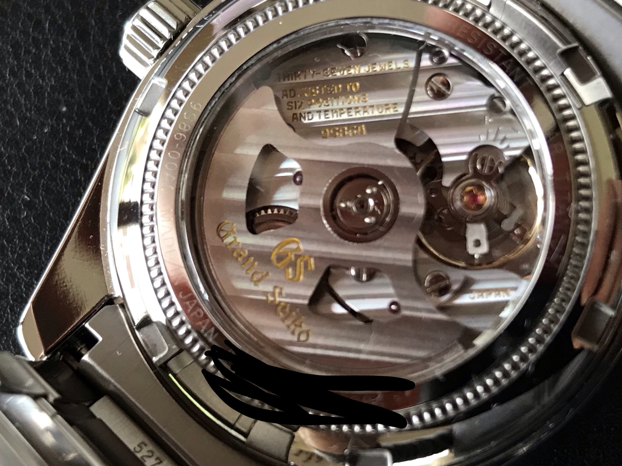

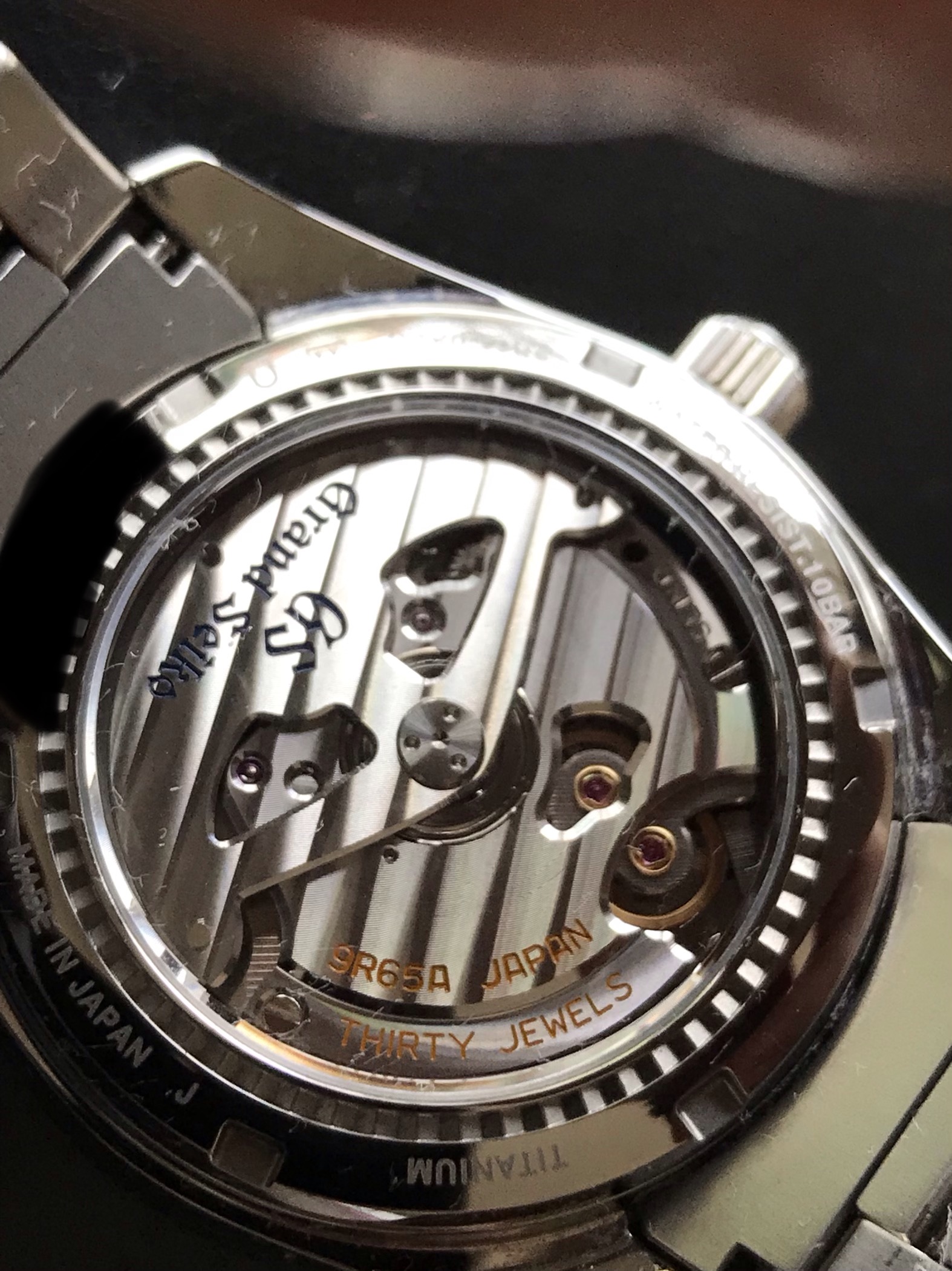

Here one of my Grand Seiko's with 9S86 Hi-Beat Movement. Very well regulated. Running around +1s/day already since I have it. Nice machine decorated:

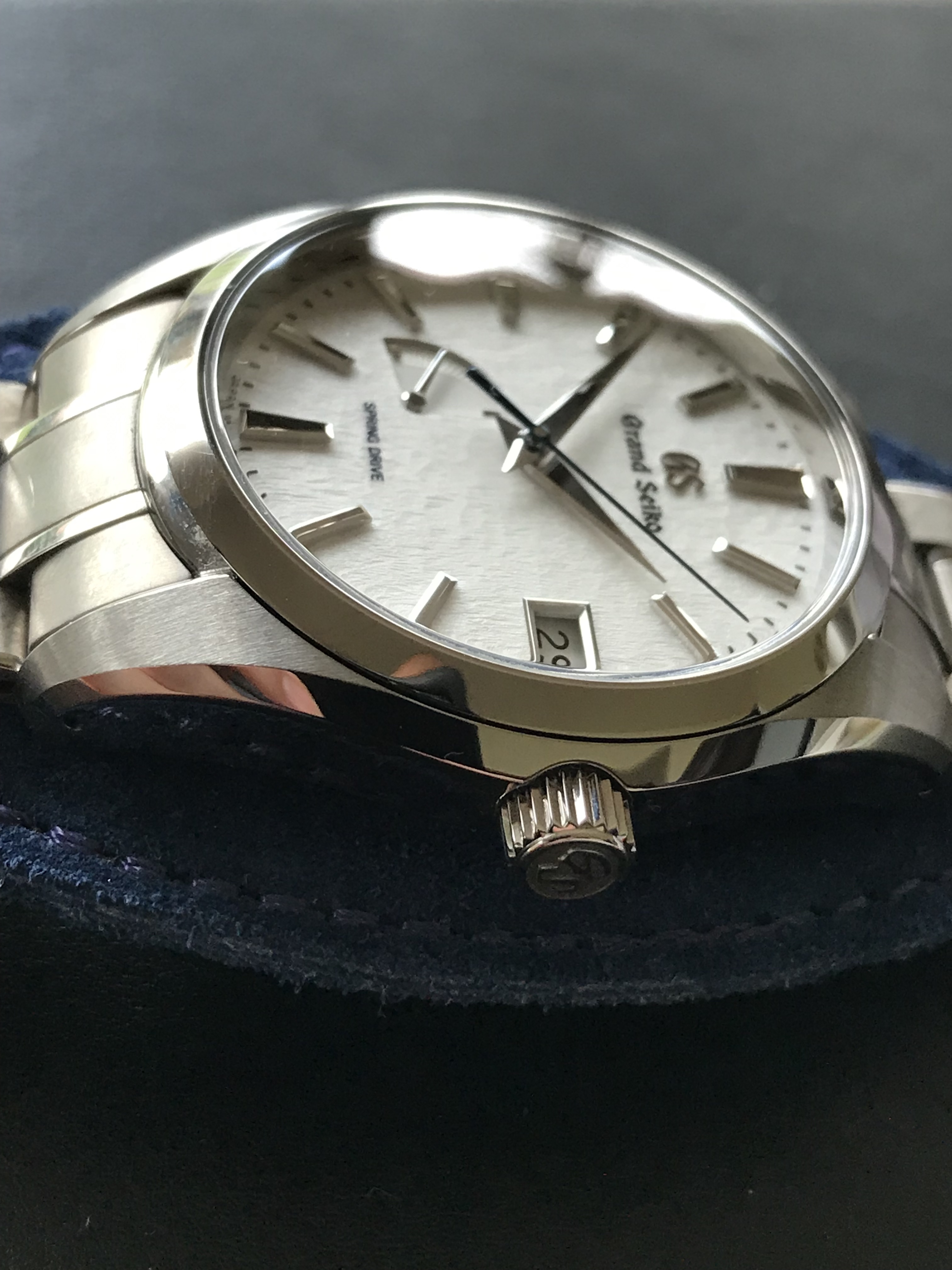

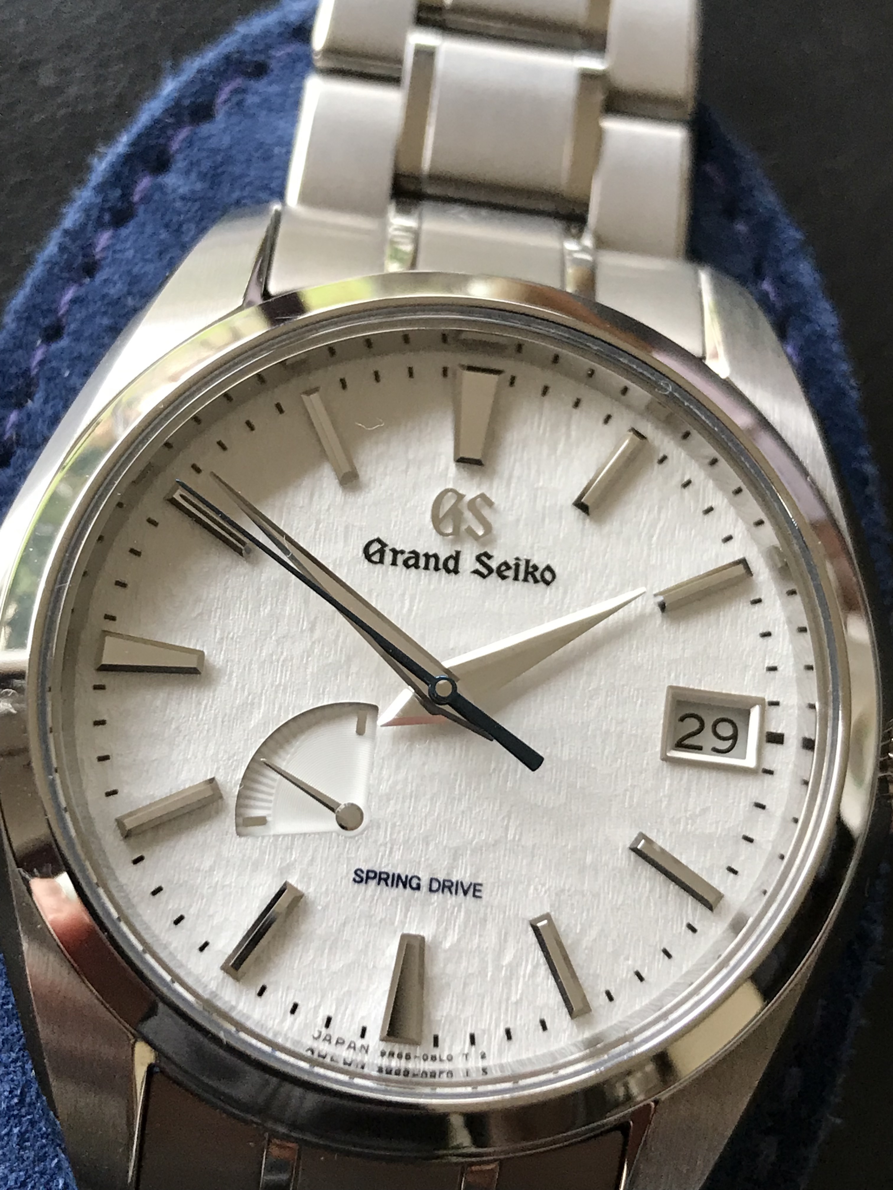

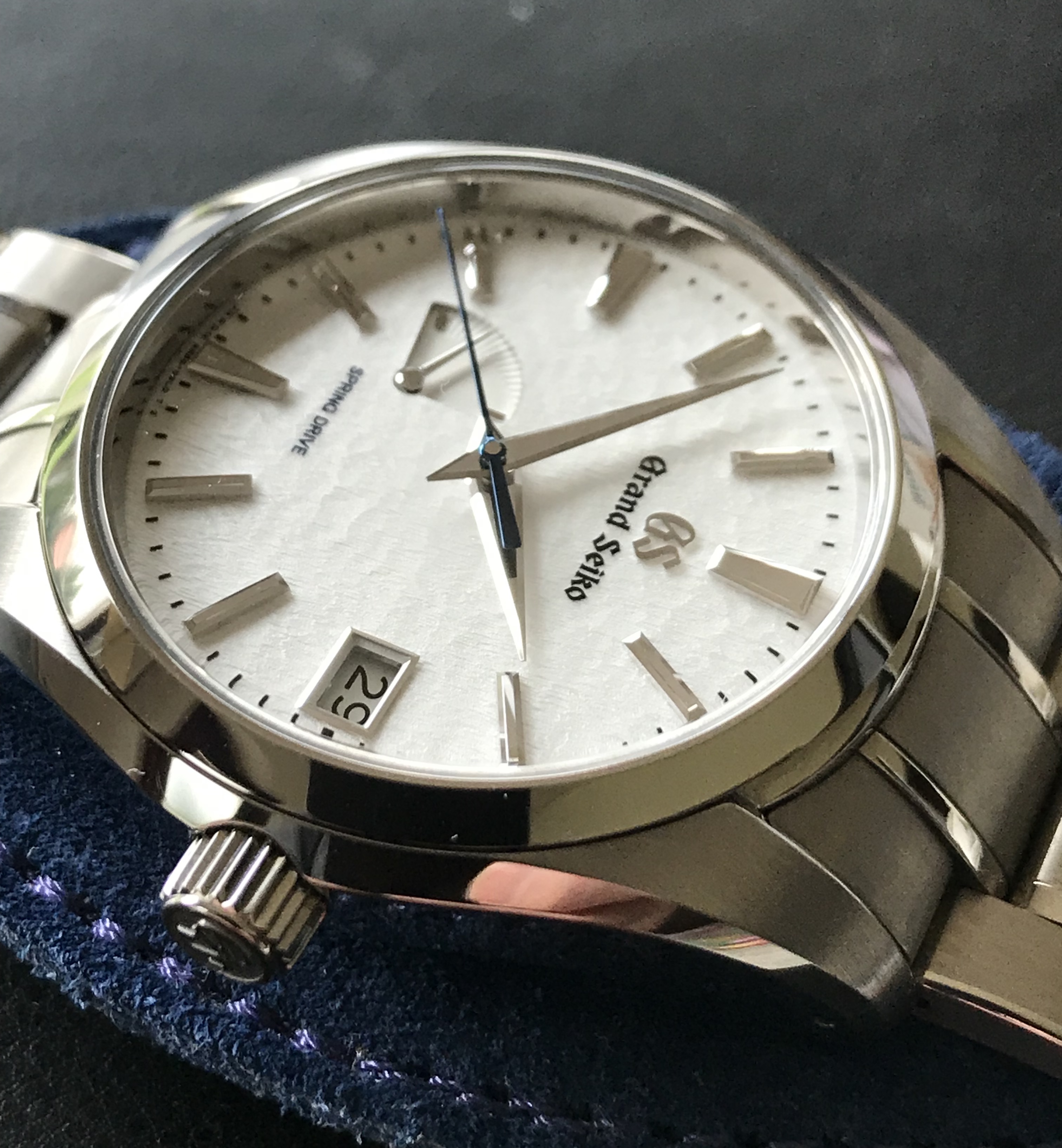

However according to my opinion the strength of Grand Seiko's is Dial & Hands execution, Housing polishing, the reliability of movements and their wearing comfort.
Here a photo of my preferate Grand Seiko "Snowflake"SBGA211:
Thanks! As far as the movement finish is concerned, I am not sure it is at the level of other "high end" brands, but nice watch indeed!
Generally speaking, I am under the impression that GS is more involved in case and dial decoration, and in movement reliability, than in movement finishing. Not a criticism, only my impression.
Depend which brands you include in "high end". It is not at the level of Patek or Lange - hand finished with anglage, gravure, bluing of screws,etc. , but it is on the level of Omega or Rolex - machine finishing/decoration like cote de geneve and perlage
You are right. To me "high end" is an open term we have to discuss. But even in a broad meaning, I would not include include Omega and Rolex in high end.

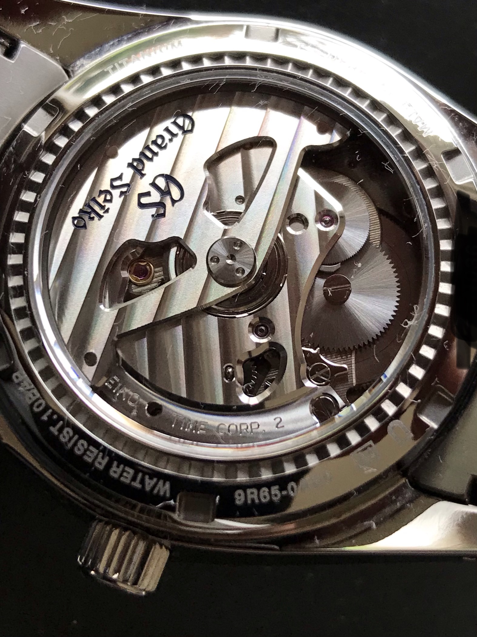

Further on, Grand Seiko finishes in e.g. the escapement wheel with so called MEMS technology for improved accuracy of finishing. The escape wheel is already for some time skeletonised for less weight and therewith longer power reserve - the thing which Rolex introduced now in their latest generation. They produce all the parts by themselves, even the hair springs. I thing they deserve the respect also for their movements.

You are 100% correct - the exterior of the watch is their focus. On the movements, it's mid-level finishing only. The average Rolex movement will be more completely finished than a GS movement is. GS primarily decorates only a few spots that are visible, and the rest are unfinished. The finishing techniques are of the "short cut" type also, so not hand finishing done on these movements.
I totally agree. I think from the viewpoint of an owner it is one of the most important part.

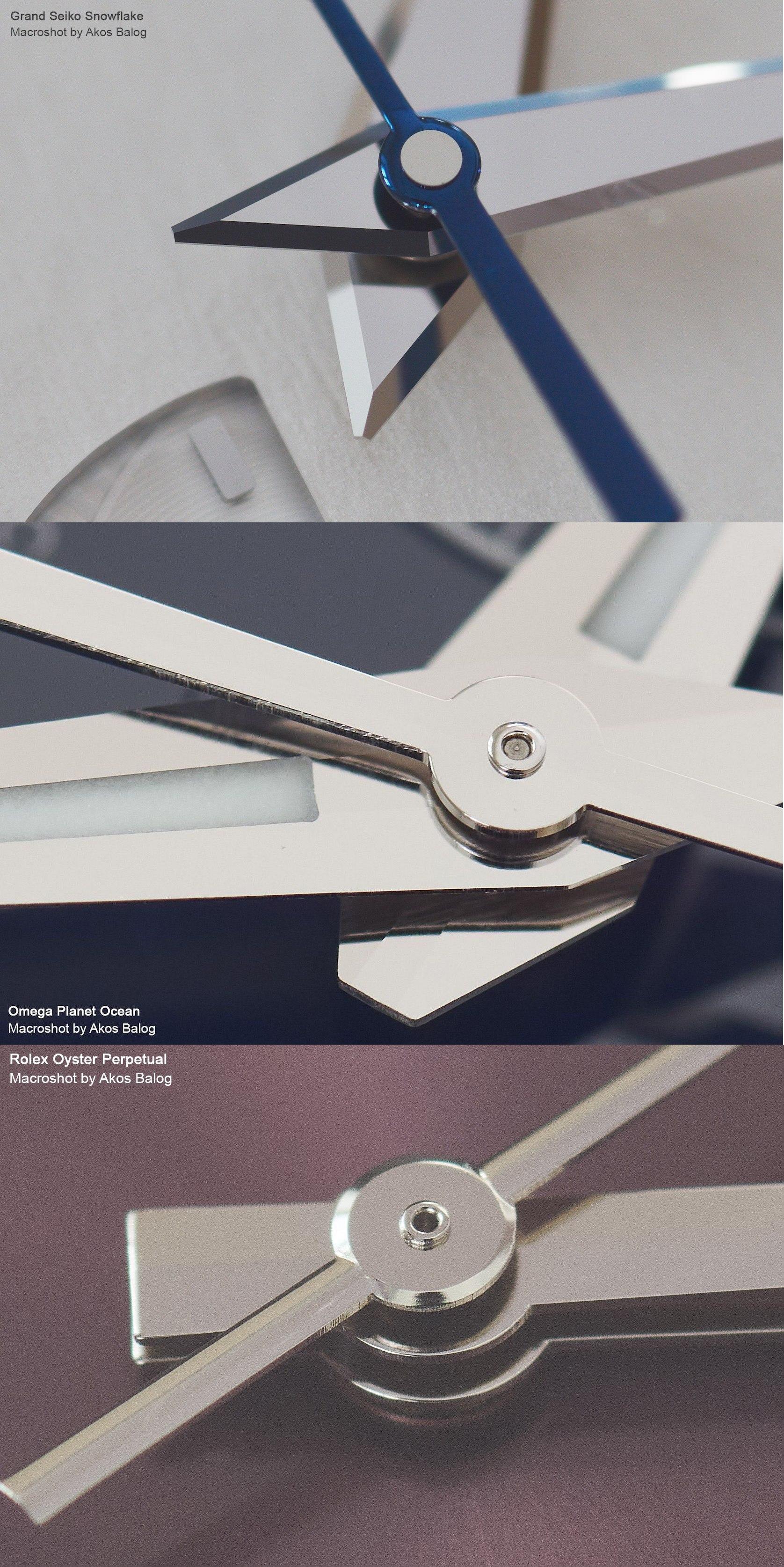

The hand/dial finishing is on a different level compared to the mid tier swiss brands like Rolex or Omega. (I'd be really interested in a comparison including high-end swiss watches)
I've made some macro pics of the hands, I'll make some pics of the indexes, and dial details once I'll have some time 😉
