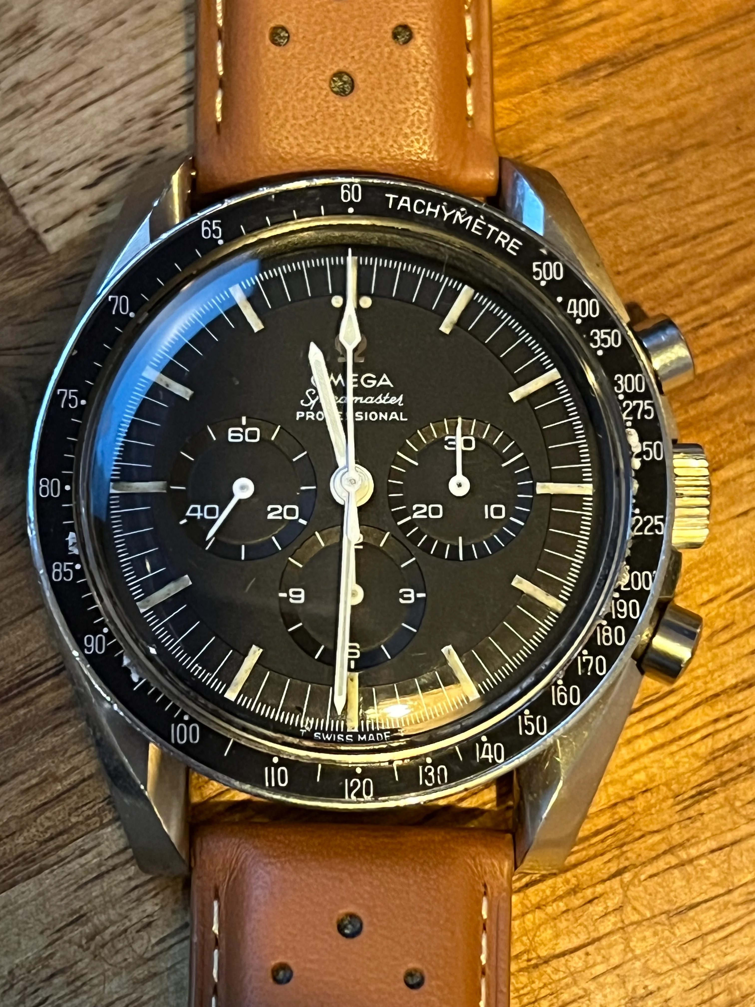

121
57
Ive just bought a clip on macro lens to try as well, having done some digging and Im seeing a few good examples online but this is more for dial details than overall shots

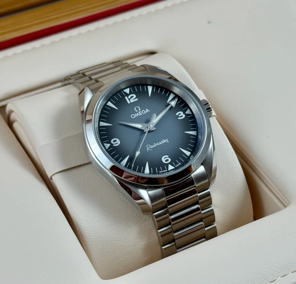

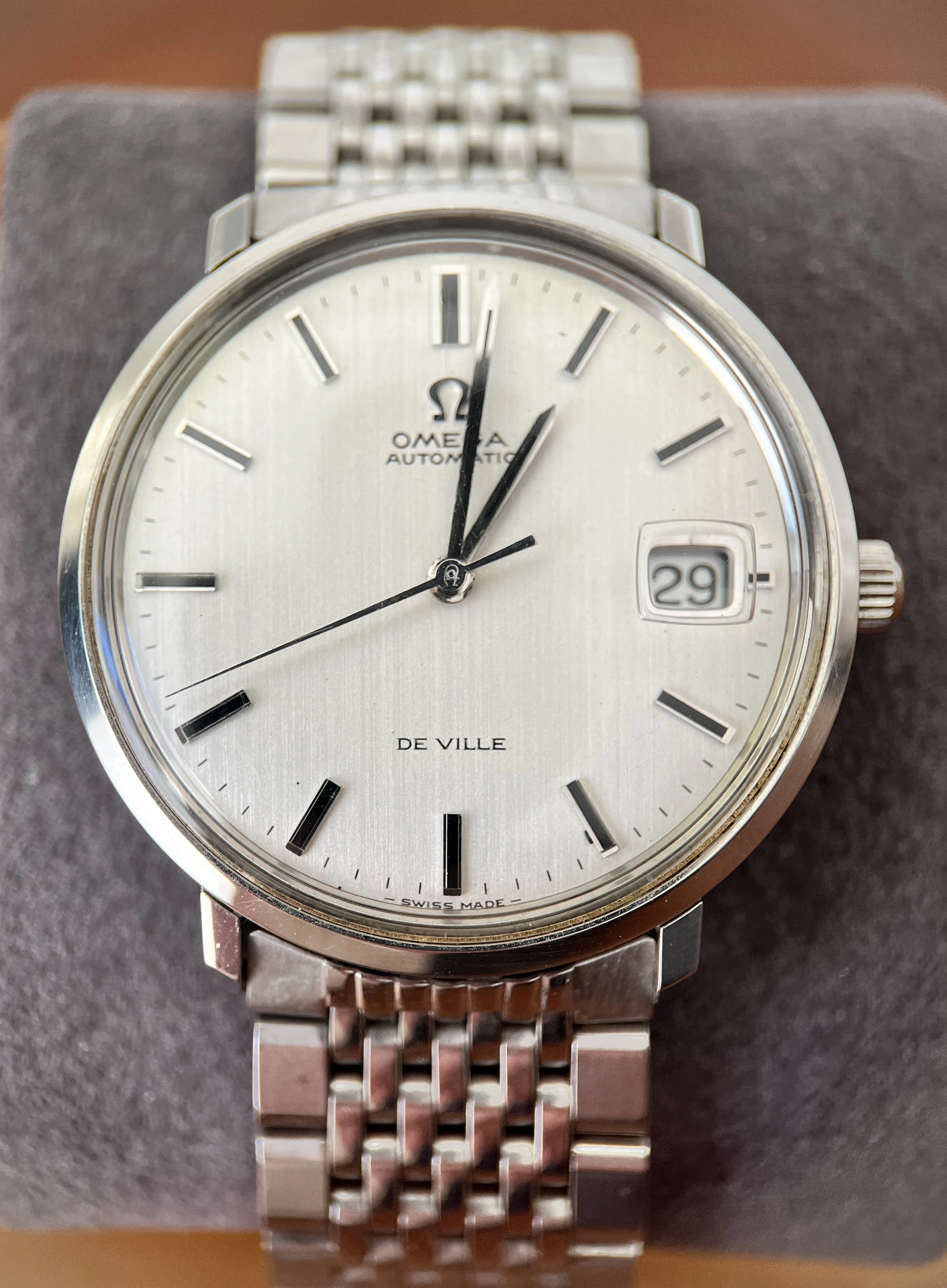

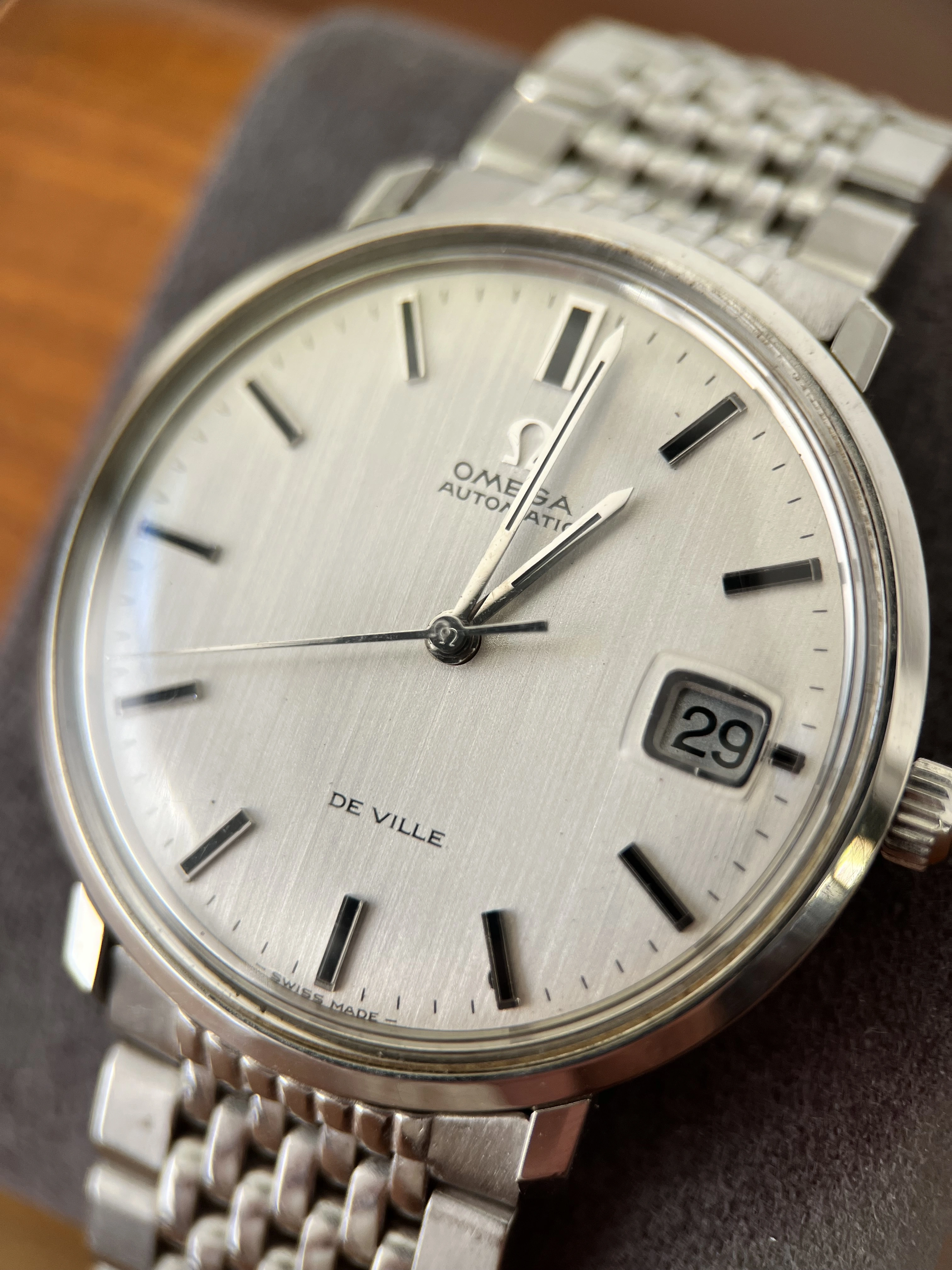

Hey guys,
I thought this thread was gone and forgotten but happy to share a couple of pictures and some learnings
Quick learnings, iPhone 13 Pro is OK but not ideal, the macro frequently gets confused or switched to low light (super grainy).
Some of the later cameras seem to do an amazing job without the need for the extra lens.
Second thing that helped a lot was a simple fold up diffuser so I the light form the window was a lot softer
And lastly some kind of stand that looks nice, in a lot of watch photos they lay the watch flat which is great if you want to do that but for ease a simplicity a stand is a lot quicker
I also bought a simple bounce card / reflector which I use sometimes here and there
90
30
The click on lens im using is this one
https://www.amazon.co.uk/gp/aw/d/B07TPLKT7D?psc=1&ref=ppx_pop_mob_b_asin_title
You can buy any lens you like, there’s cheap and there’s expensive, I went in the middle ground as these guys seem to produce a lot of lens that have decent reviews
One thing I will say, you are stuck at the distance you seen in the photos, which looks good but is sometimes is a little close.
Would love to take a shot with the kind of bokeh (blur) you see here that was a little further away sometime but I feel this is a good compromise until I can afford a real camera and macro lens.
Hope this helps whoever is ready and feel free to post some more pictures here

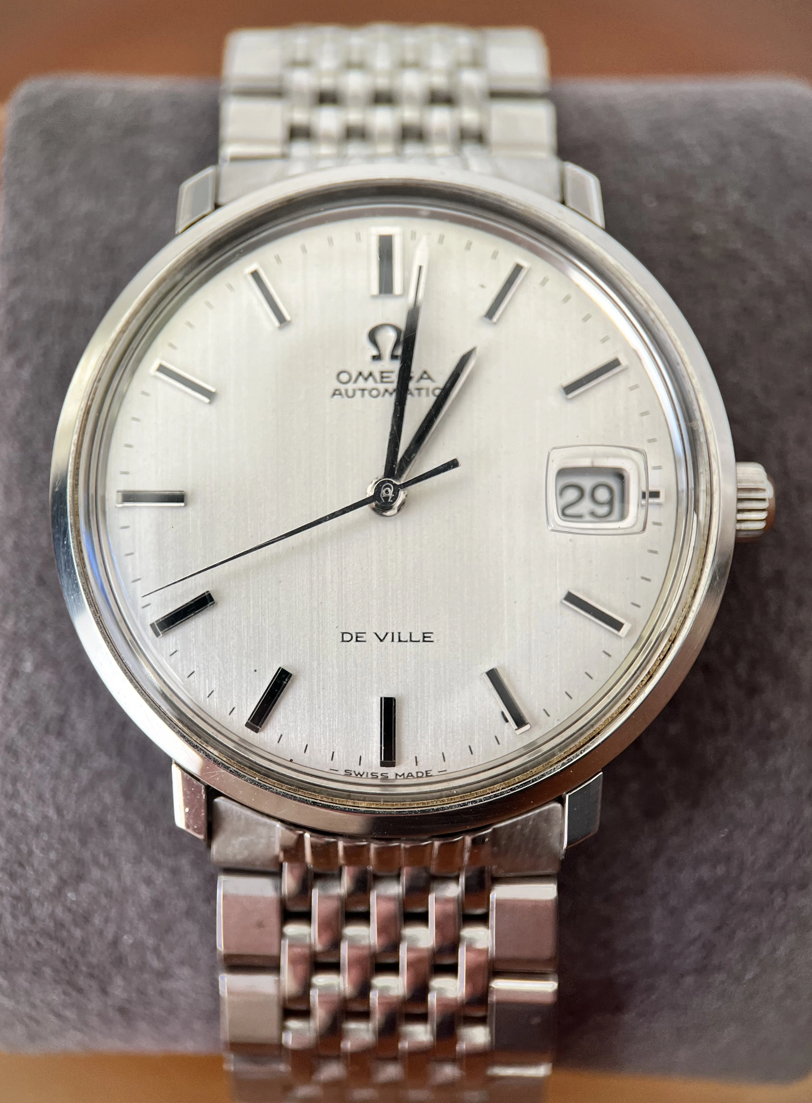

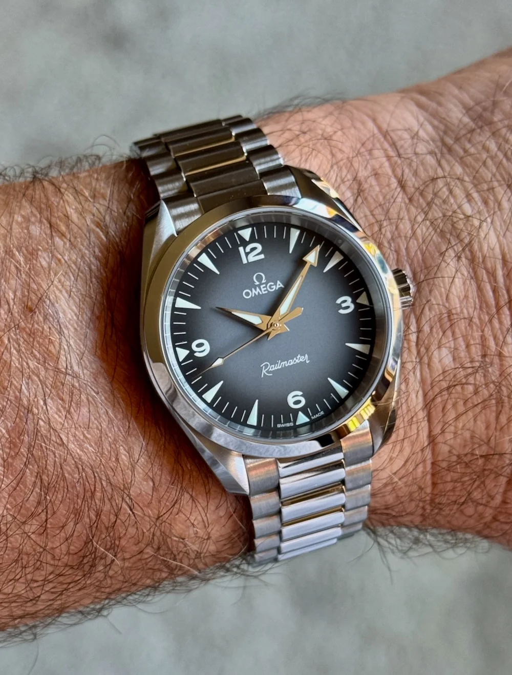

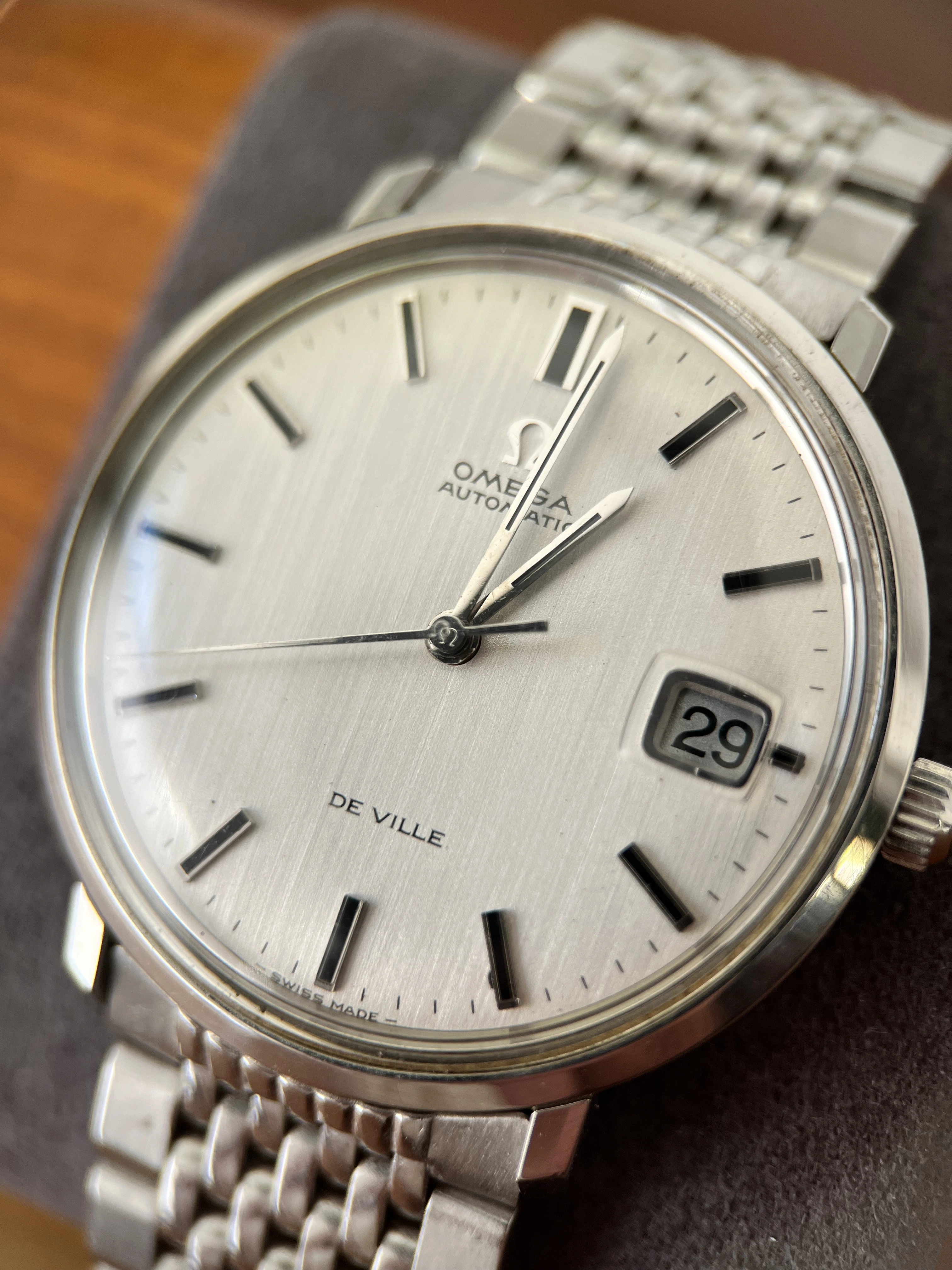

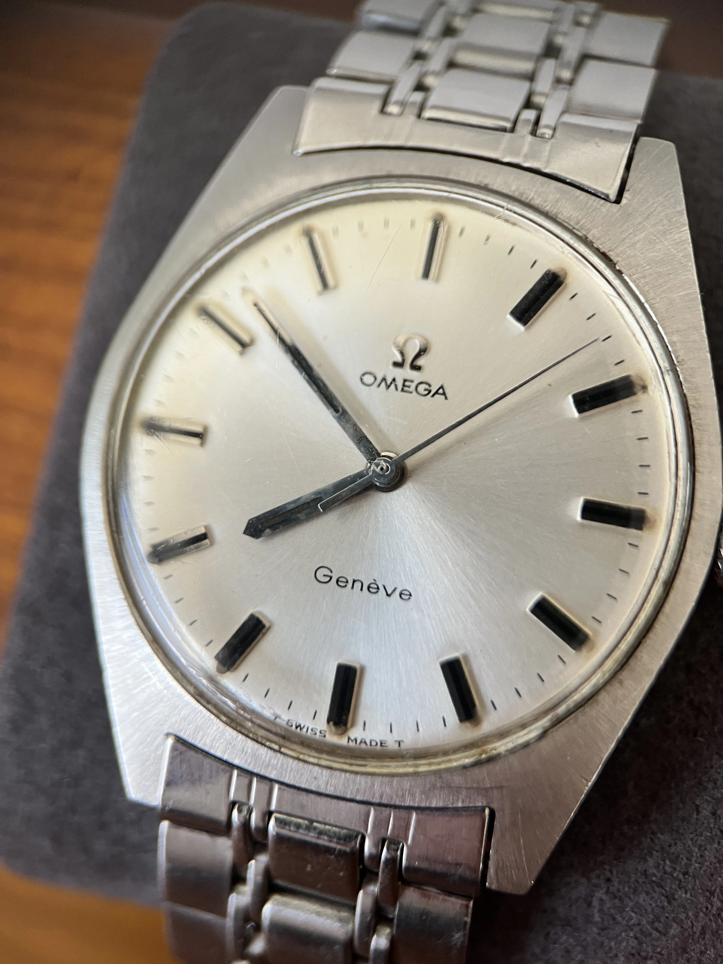

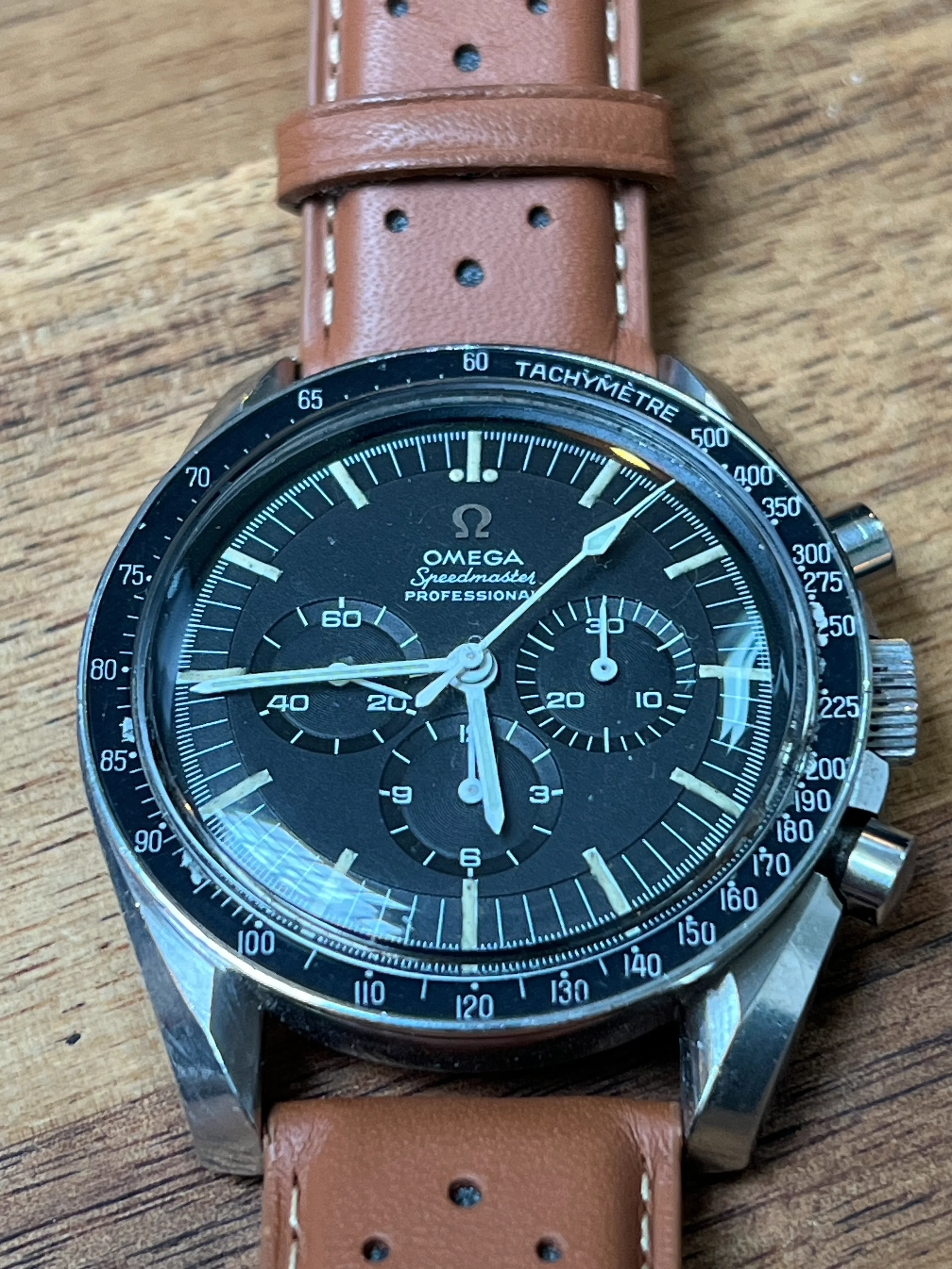

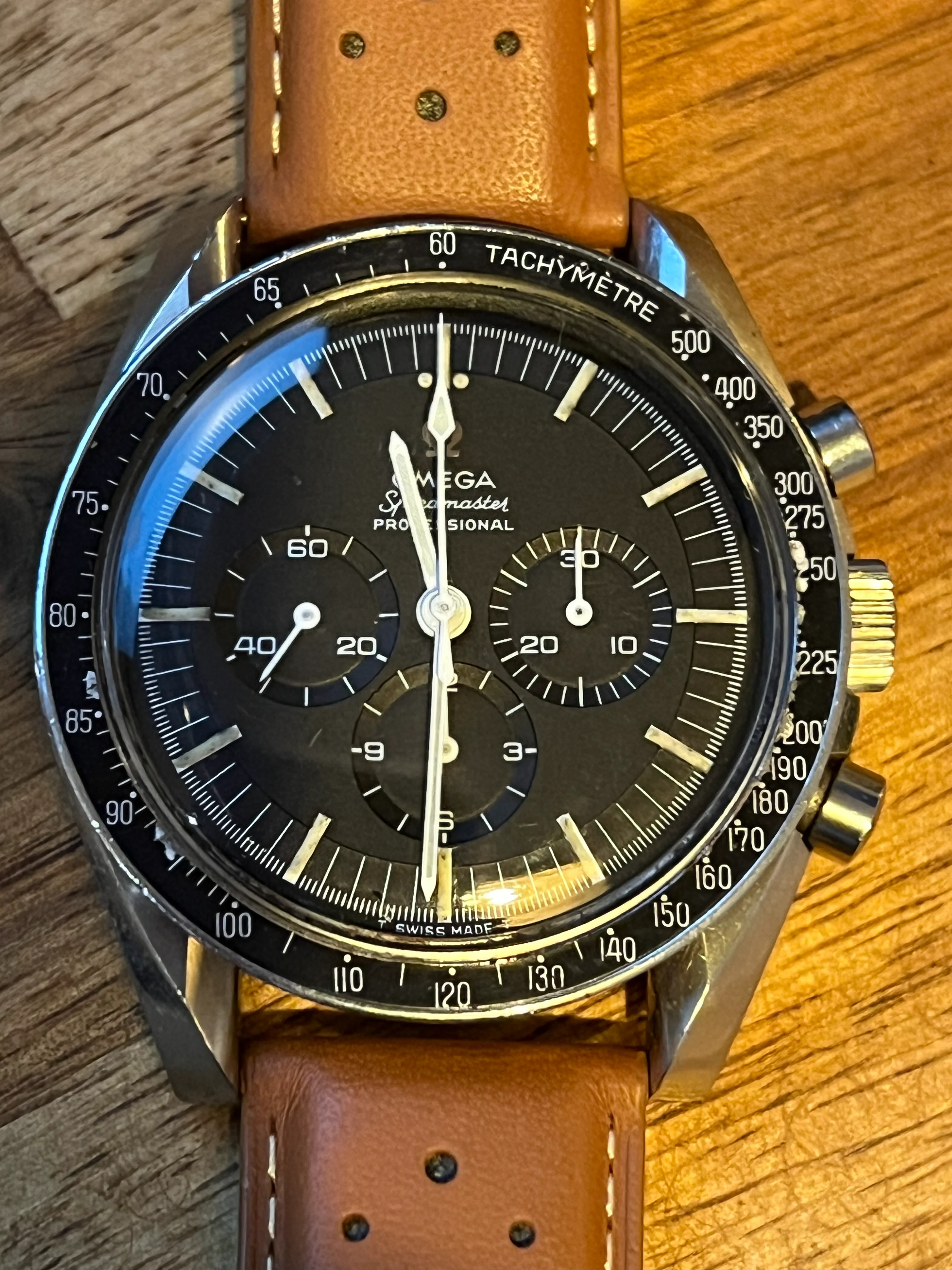

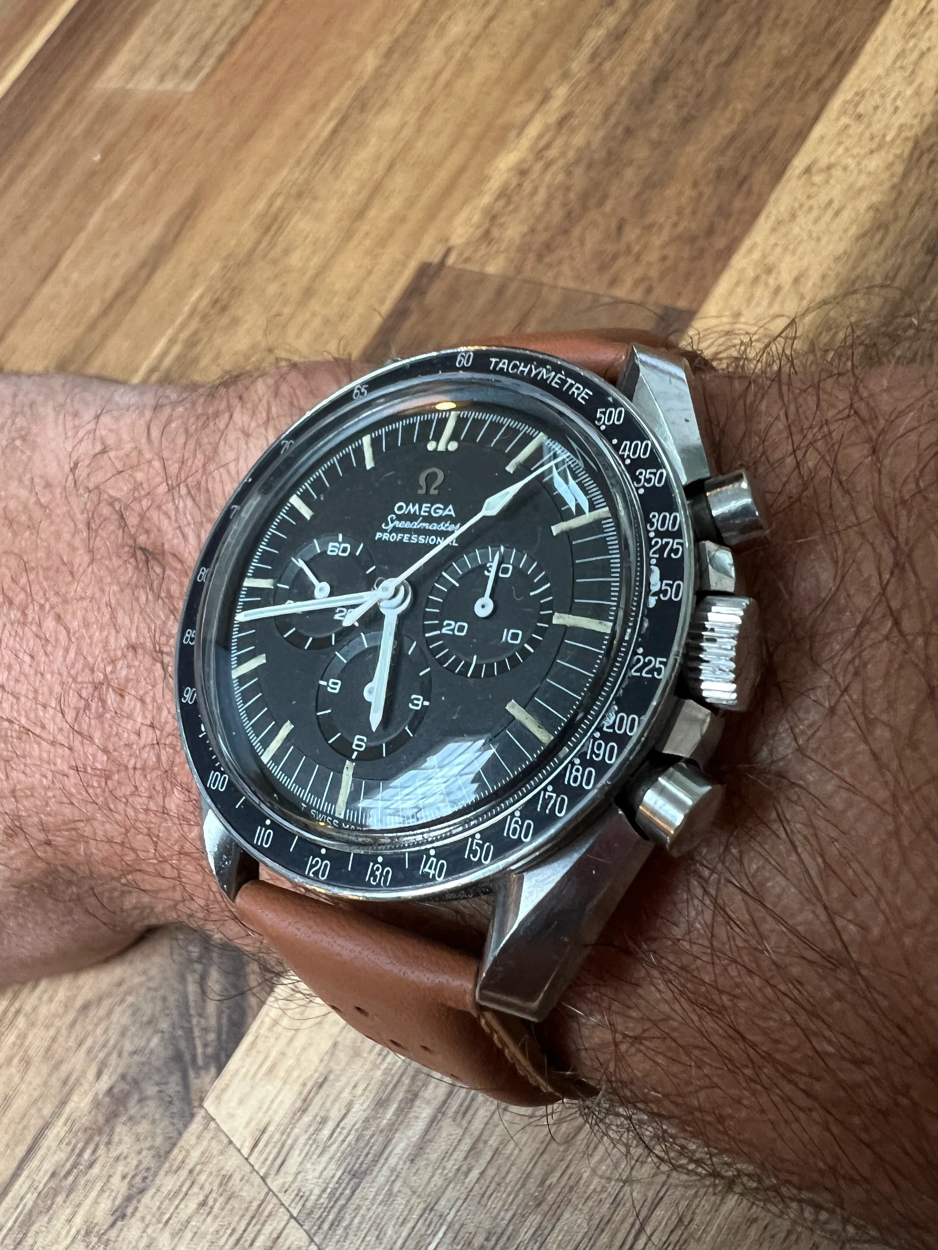

Photos got deleted, so here’s some photos I took of some watches using the lens
121
57
Thank you. Great photos showing what the lens is capable of.

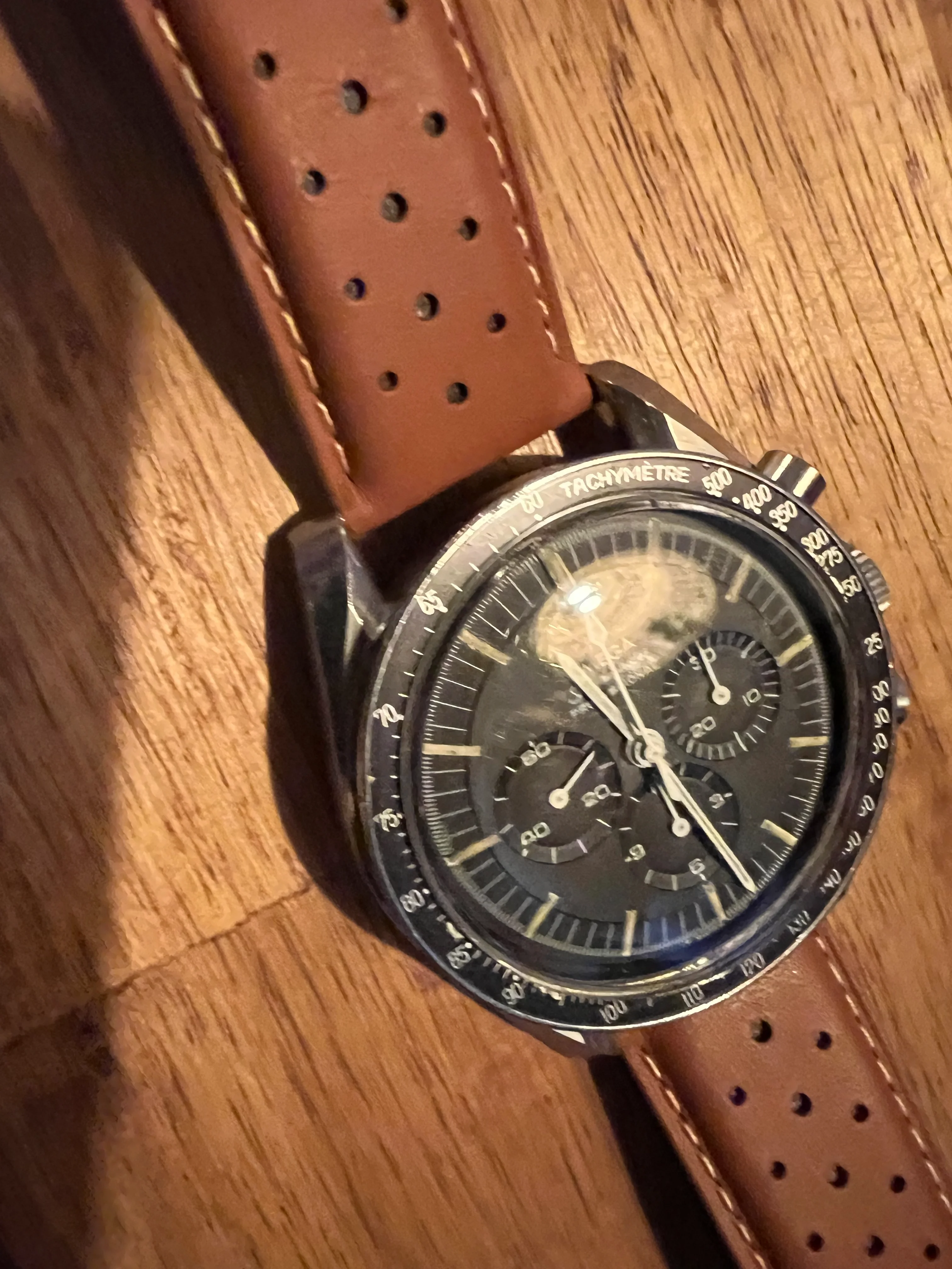

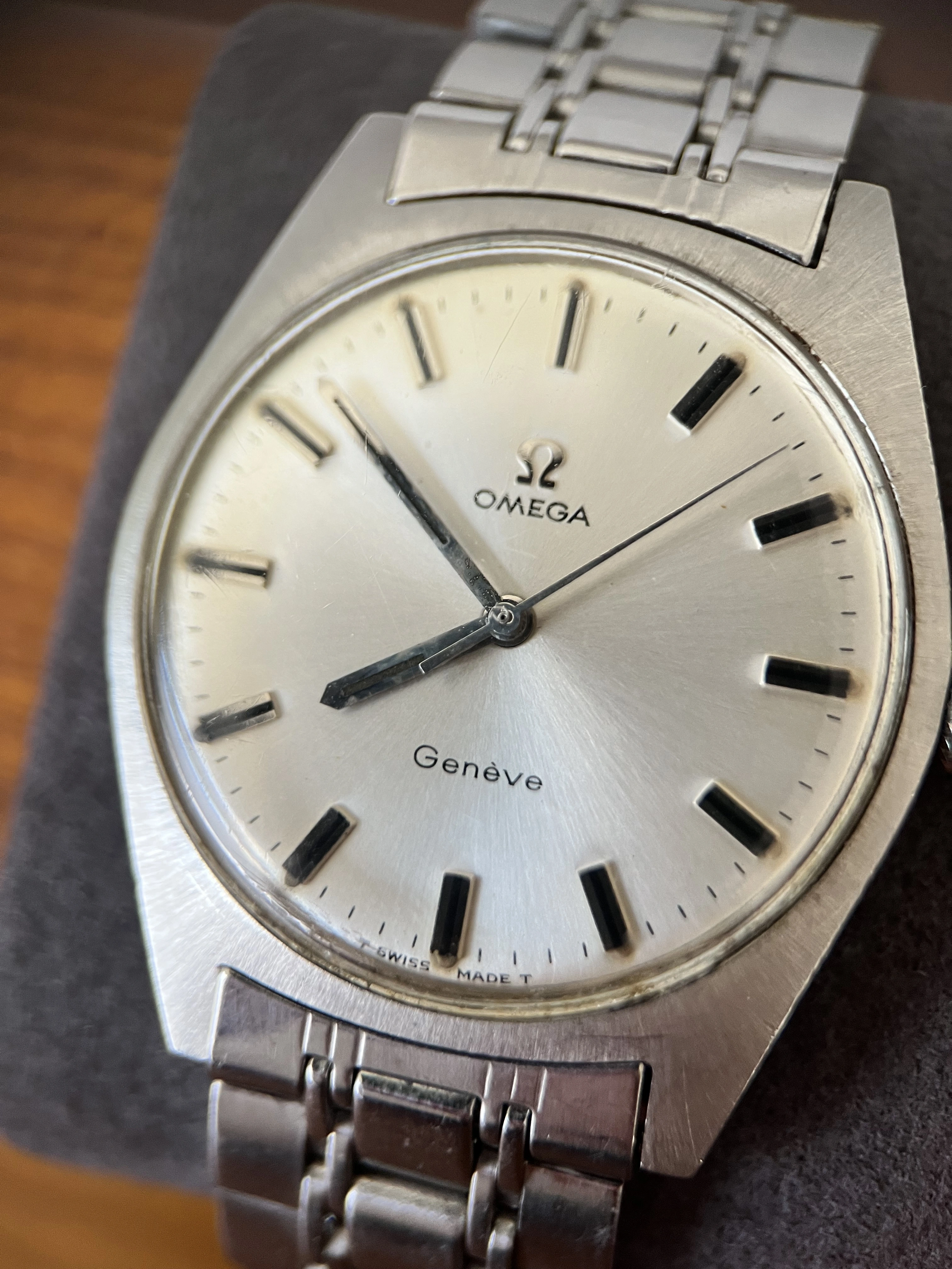

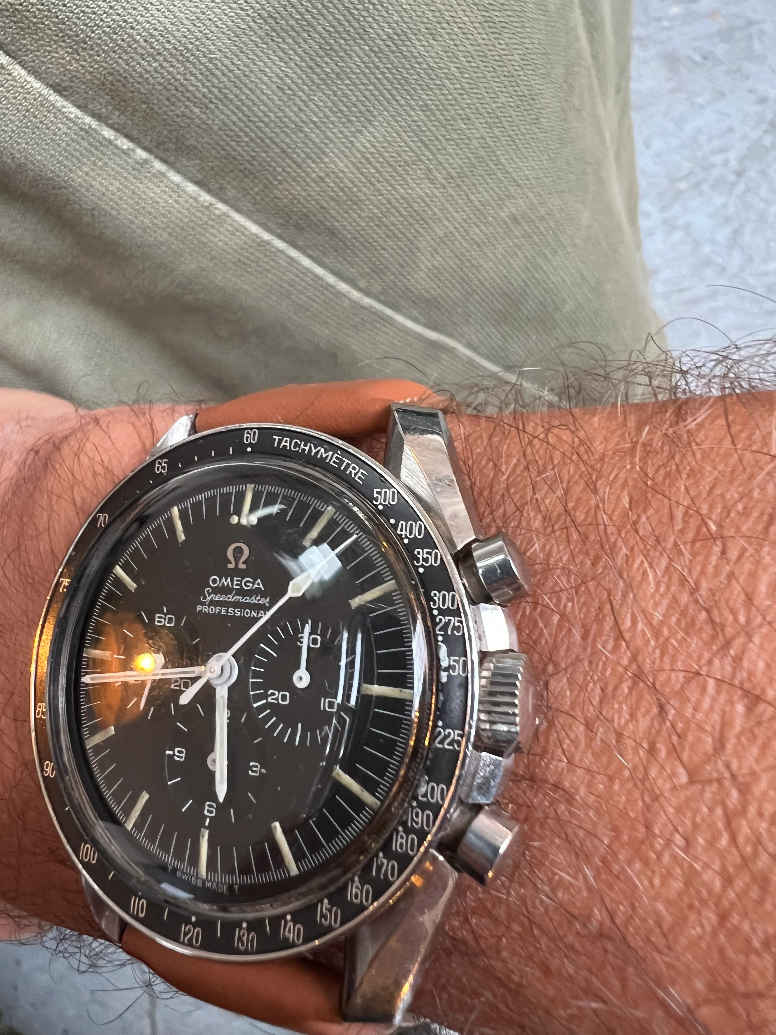

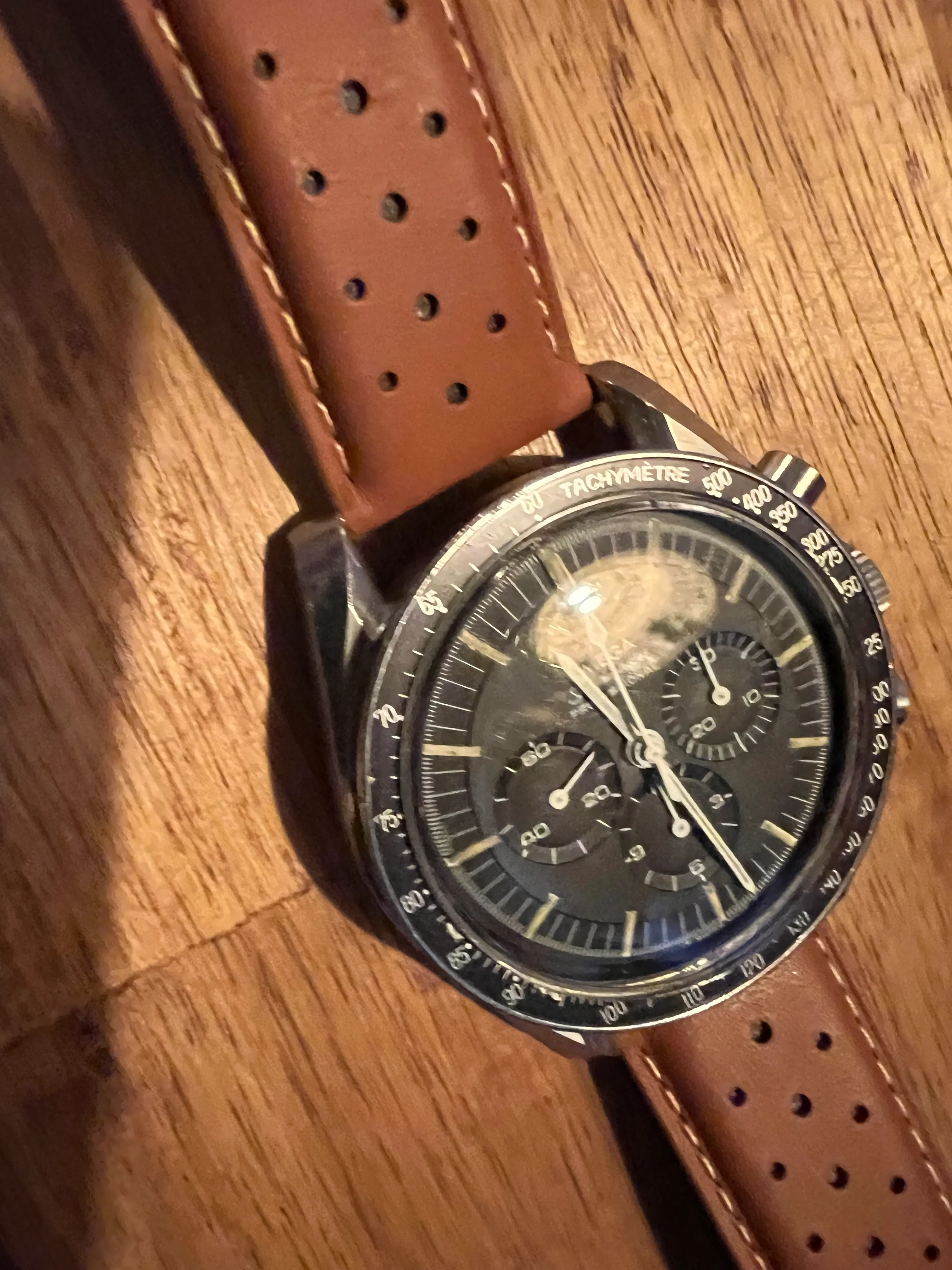

Any tips to avoid the reflect of light on the crystal ? Trying to take picture of my watch, hesalite crystal, and whatever the angle I am struggling with the reflects on it...
90
30
What are you taking the photo with, iPhone or camera ?
Have you got a picture you can upload ?
21
9

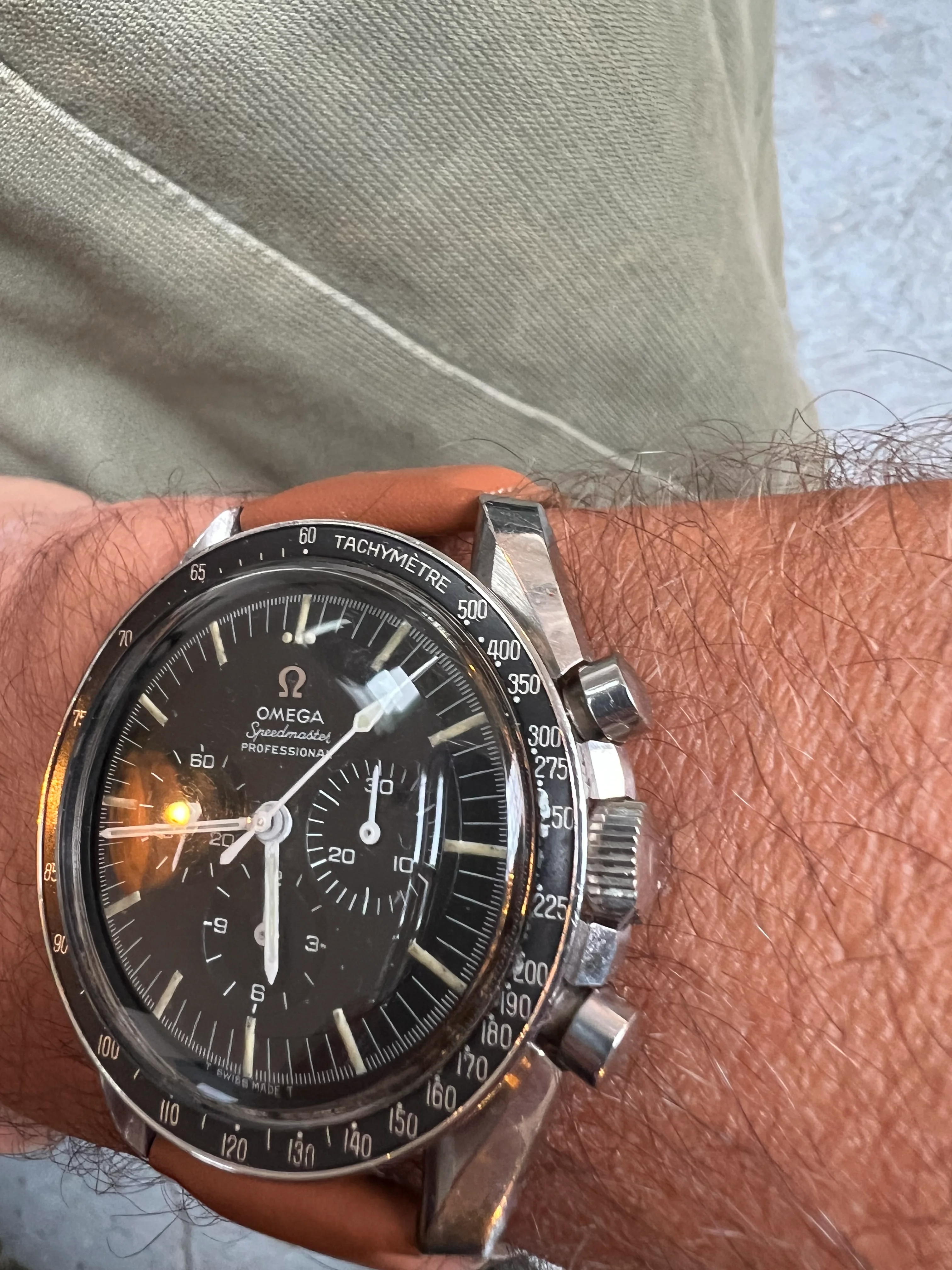

Taking picture with my Iphone.
here are some photos where I was struggling with the light and the crystal.
90
30
The watch will reflect or glass in general whatever id around it. So in your case it looks like a light and possibly a window but looks like it could something else.
To improve this don’t take a picture using a household or office light, it gives a yellow look to things and causes bad reflections and harsher shadows.
Use natural light diffused light, so a window in the house that doesn’t have the sun shinning directly through and set your watch up close to but slightly away from the window.
If outside look for somewhere where light diffused to be soft and natural rather than direct. Worst case buy a fold up diffuser.
