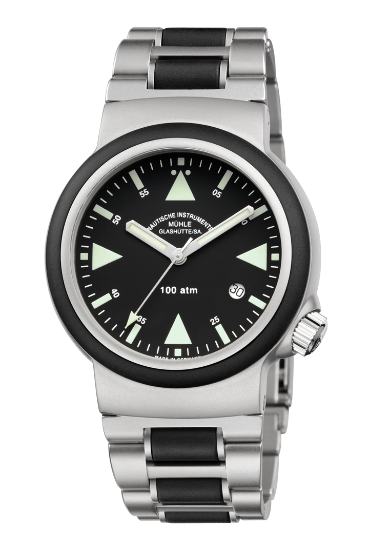

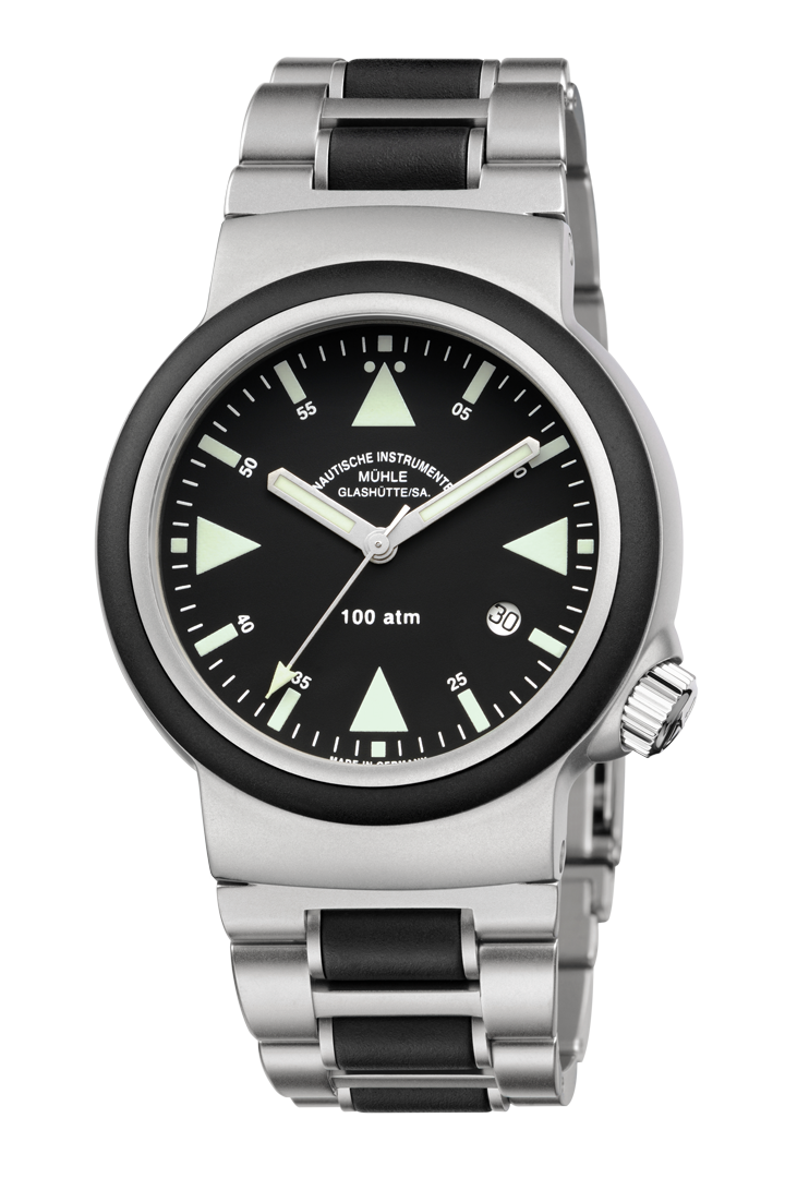

If you want to sleep well at night and not worry about water getting into your expensive Omega, I recommend you take it back to the dealer for a refund, or put it in a safe, and buy one of these, good down to 1000m and nowhere near as expensive as your Omega:
https://www.muehle-glashuette.de/en/watch/s-a-r-rescue-timer-metal-strap/
