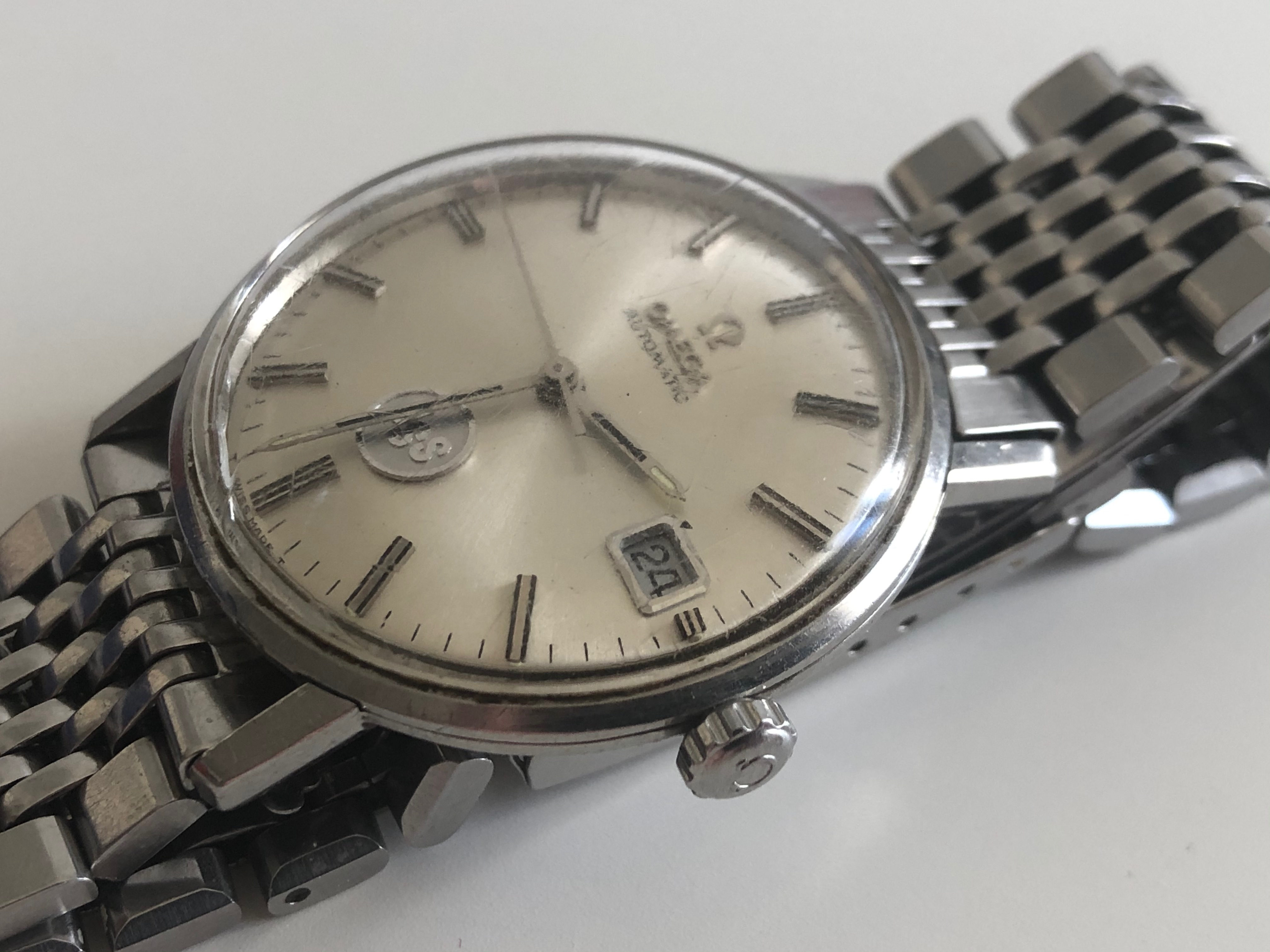

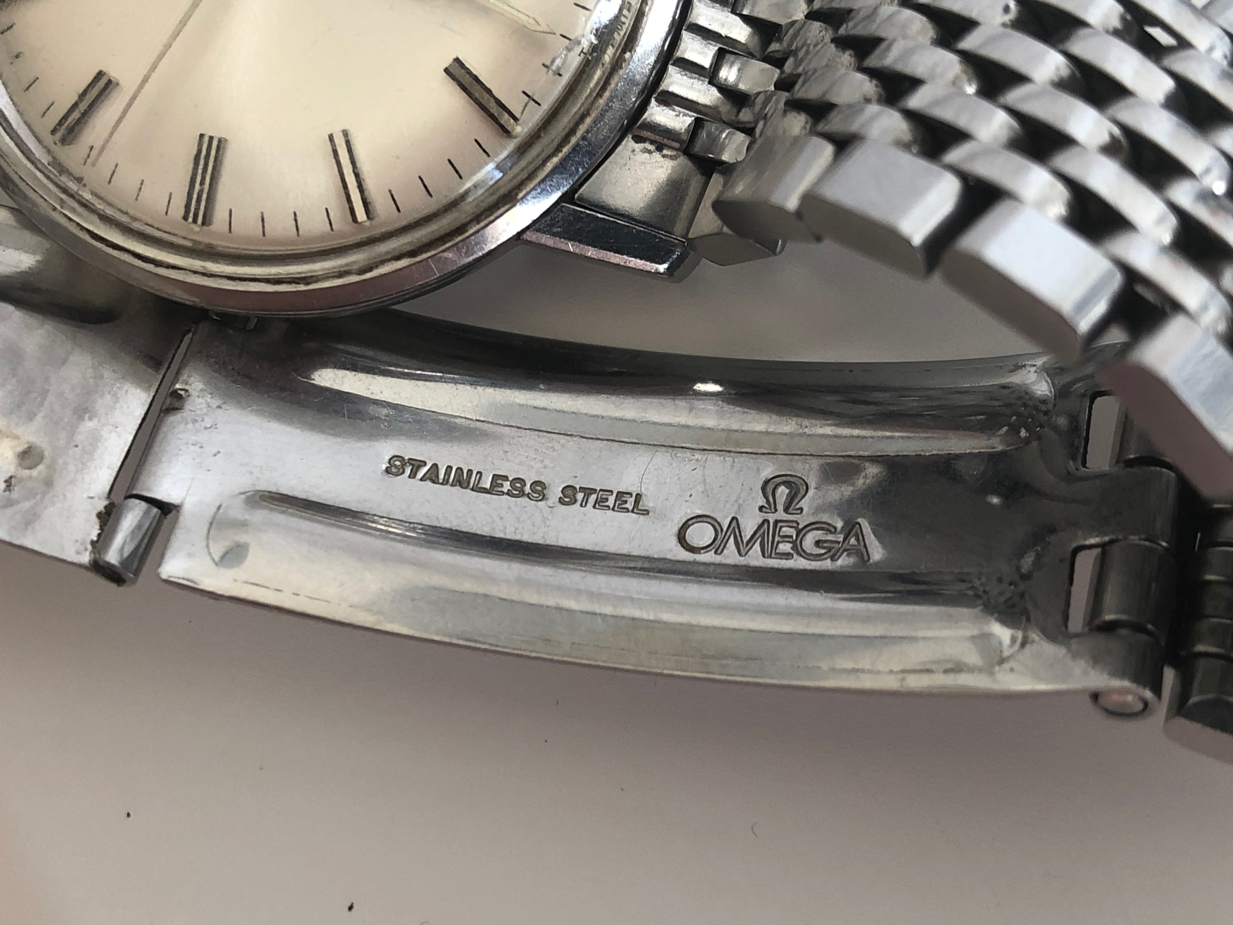

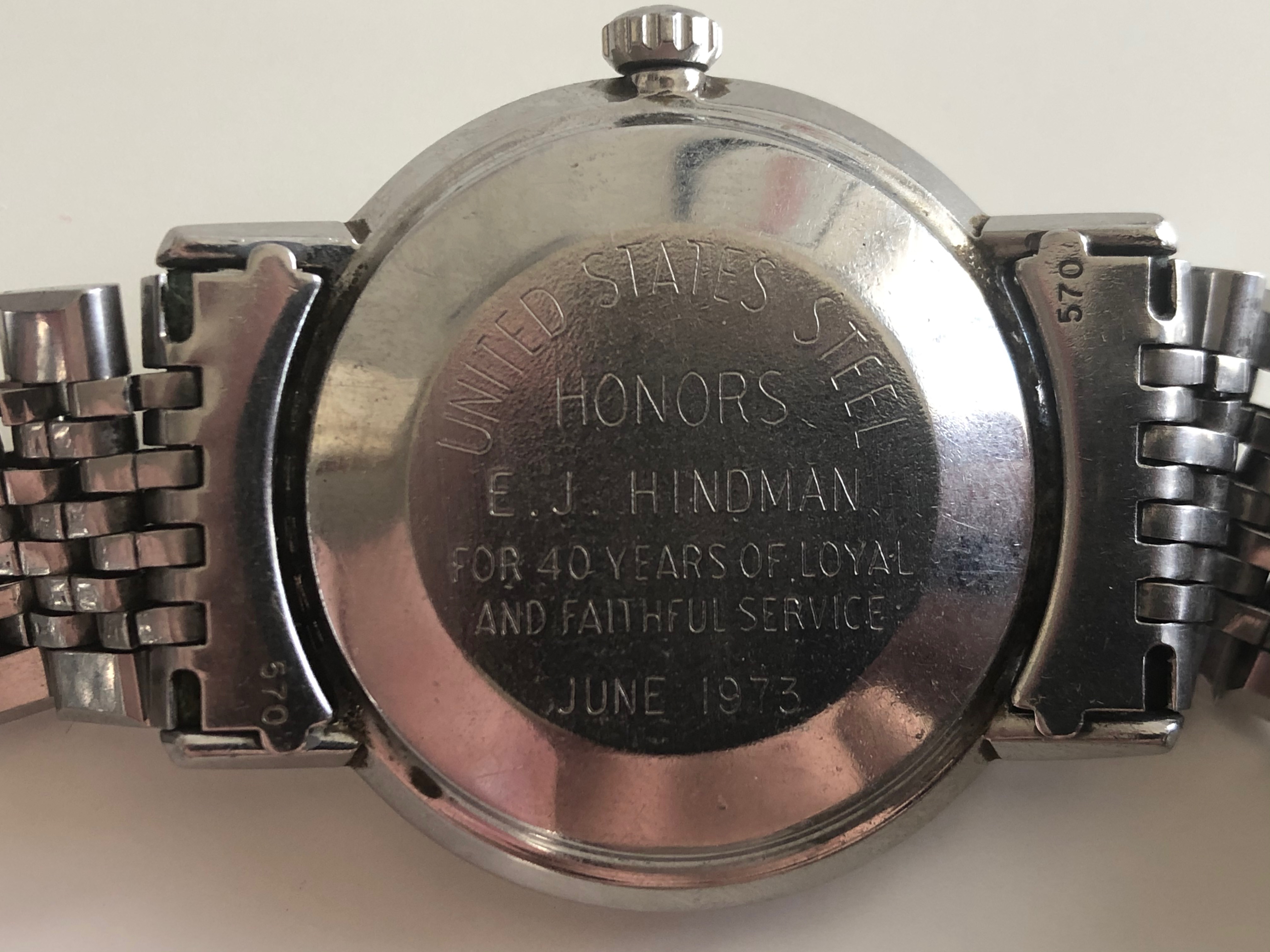

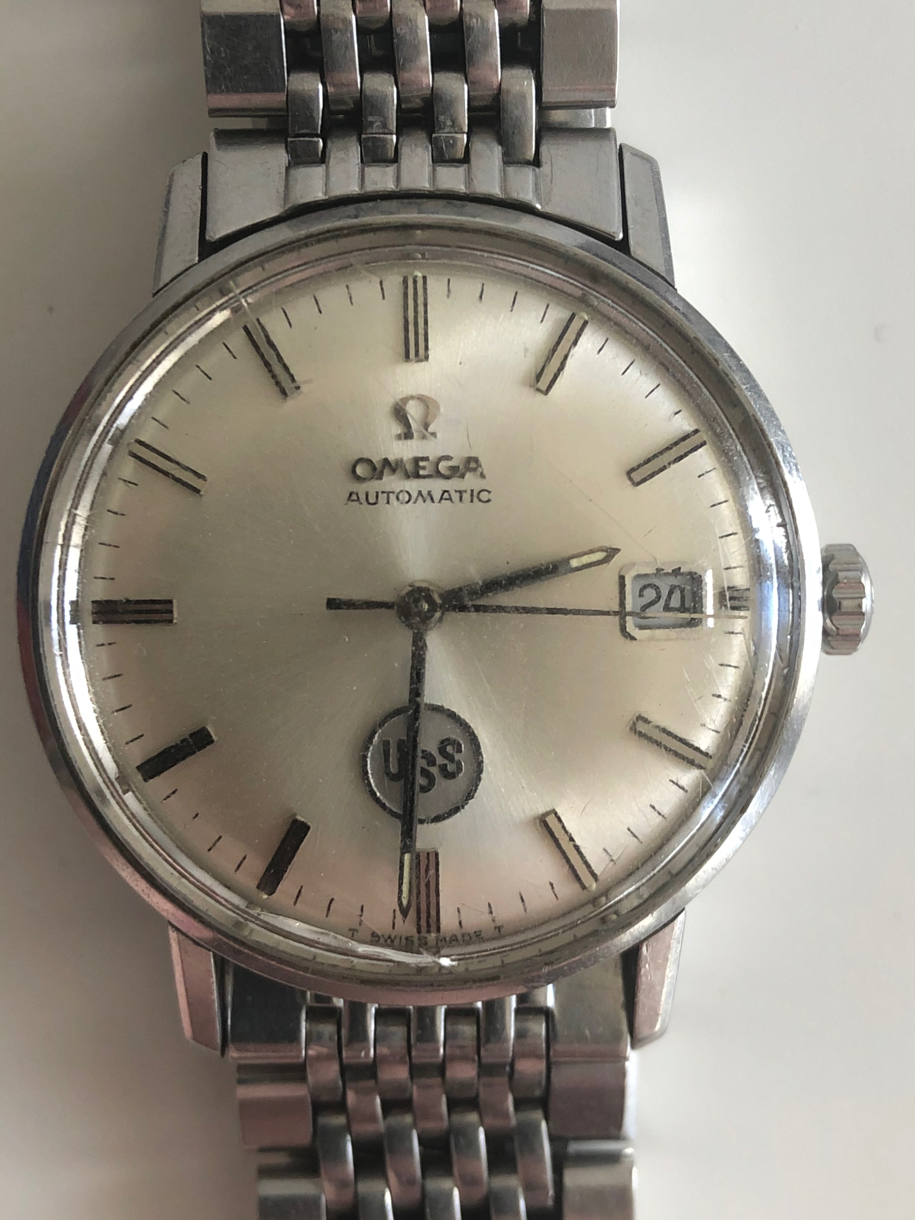

Hi everyone! I recently inherited my grandfather's US Steel 40 years of service Omega watch. The engraving says it was given to him June 1973. I'm a total newbie to watches, and I'm hoping you all can help me learn a few things and answer a couple questions I have. Since the USS logo is where the watch name would be, is there any way to know what kind of Omega it is? I was looking around the forums seeing if I could figure out anything myself, and it seems like most genuine Omega bands have a number stamped on the clasp. Does this band look original and or genuine Omega? It is just the tiniest bit too tight on me and I'd like to add a single link to it so it fits better if anyone can point me in the direction of the best place to find a link that isn't fake (unless the band is fake and it doesn't matter). And I guess lastly, if I took it to be serviced/cleaned, what would be recommended that I have done considering it is vintage? This watch means a lot to me, and I'm never planning to sell it, but I'd still like to treat it the right way as a collectible. Thanks so much for any info/help anyone can give me! Photos below.

Given the caseback, it looks like it's a monoque case (meaning: the movement has to be removed through the front of the watch). This means it probably shares a case reference with a DeVille or Seamaster DeVille, but you won't know for sure until a watchmaker opens it up.
I would search the forum for recommended watchmakers in your area and send a couple of them an email to get a quote for service. The movement needs to be cleaned and relubricated and the gaskets replaced. It looks like the crystal is cracked, so that will need to be replaced but they aren't difficult for an experienced watchmaker to get. Personally, I don't think any other exterior work needs to be done other than running the empty case and bracelet through a cleaning machine. The dial and hands look in great shape.
As for the bracelet, I'll wait for others to chime in, but I *think* 570 (stamped on the end link) is an Omega endlink part number.

Fabulous watch! I have seen these pop up on eBay occasionally and always loved the USS logo on the dial. I have seen earlier Elgin’s as well which were all high grade watches, US Steel knew how to gift!

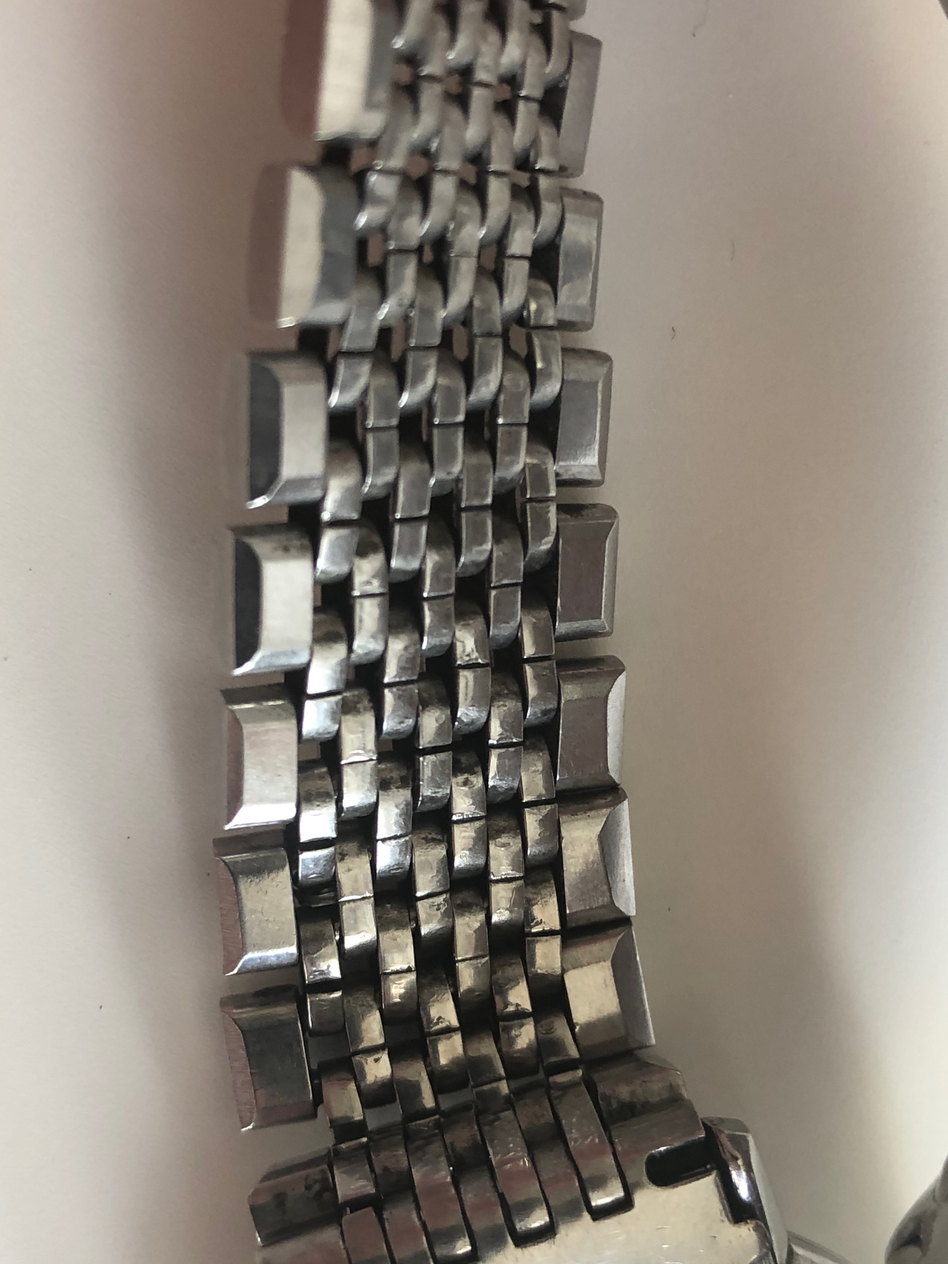

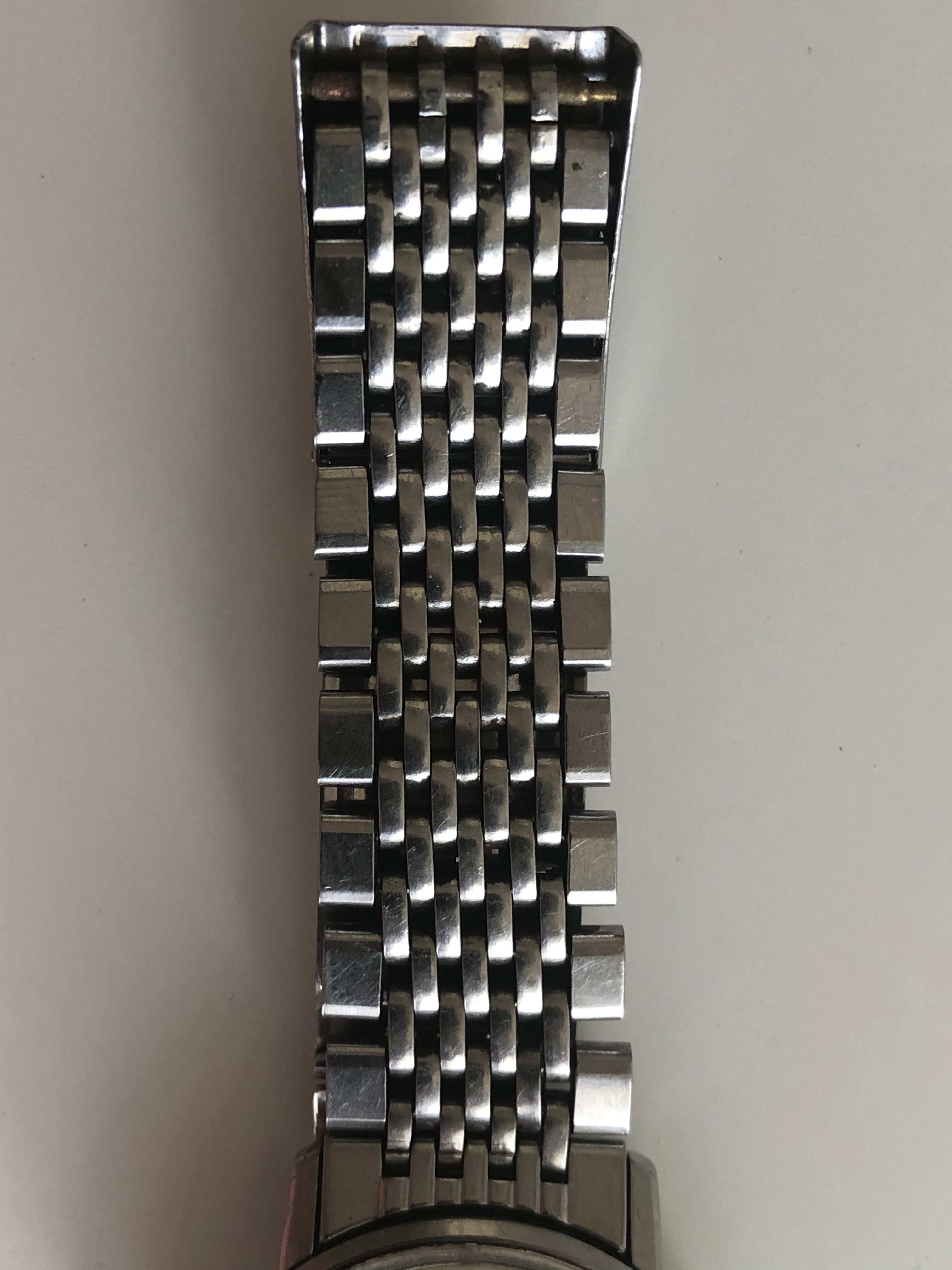

Bracelet is original, and is Omega (570 endlinks). Some of the USA market watches weren’t stamped the same way with the numbers on the clasp. Yours needs a good clean and to be refitted to the case properly- one of the endlinks is a little tweaked. There should be holes on the sides of the last links towards the clasp. Those have little spring bars in the that hold the links in place. It’s a black art to get these links to swing away- but when you get it it’s like magic and “duh” genius (when you get links, we can explain how to put them in). Links can be sourced on the used market but you have to know what you are looking for- they should be exactly the same width and construction as the aforementioned last links.
As for what the watch it, most likely a Seamaster or Geneve with engraving back. These were common as corporate gifts and came with blank backs to be engraved. The movement can be serviced by any competent watchmaker, but Omega parts can only be ordered through a certified Omega watchmaker, so try to find an independent with a Swatchgroup account. Tell them to just clean it up and service it- don’t polish it or replace cosmetic parts- they will get it.
