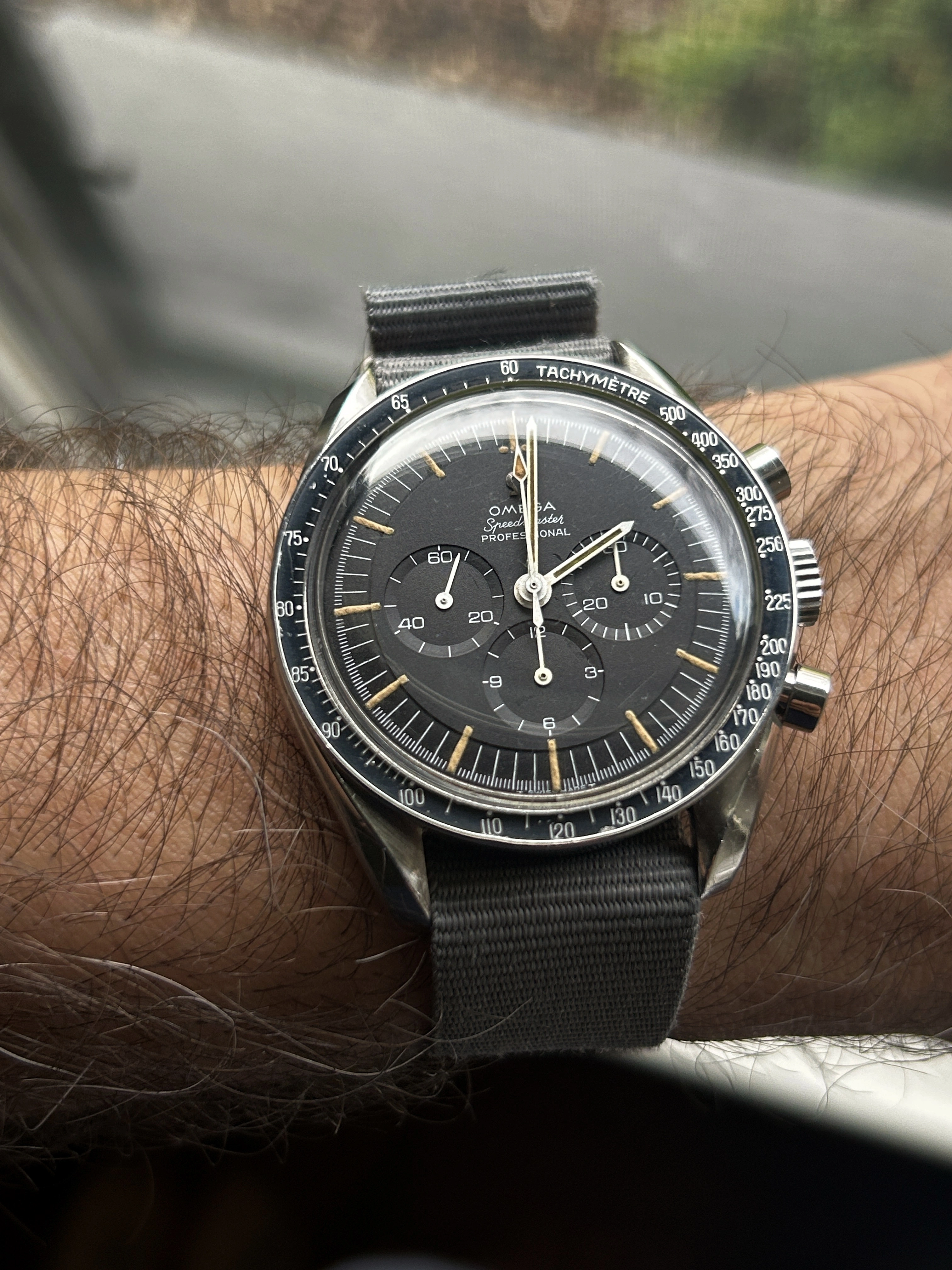

Being a completist and a purist and an absolute maniac loser watch nerd, I see why everyone is suggesting a period correct bezel, and a possibile relume... so on and so forth, but the other option is, have it serviced so it works.
And wear it on a leather strap or nato without a bezel. This is how your grandpa wore it I'm assuming. Will it look weird to us dorks? Sure. Is it a fun story and does it still look kinda badass? Yes. It'll also be way cheaper than sourcing a DON bezel.
Also, you can always do that stuff down the road!
Just my two cents!
Here's my 105.012-64
Just my two cents!
First off, I want my watch to look like yours, that’s exactly the look I’m going for.

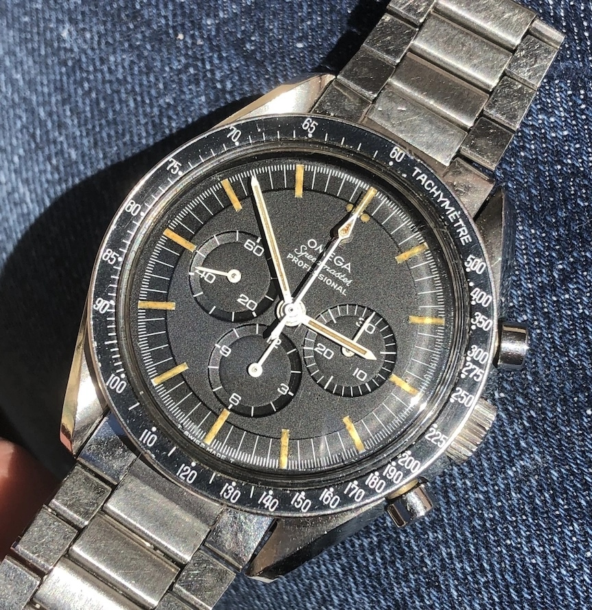

To be totally honest, I tired of Speedmasters and sold most of mine, but I kept a few including this 105.012. It has some issues and it's nothing special, but the pumpkin lume appeals to me even though it's a little moldy, and it's totally wearable.
The good thing about having yours relumed is that you could choose any color you want.

I can't imagine ever tiring of this particular speedmaster. What a beauty!

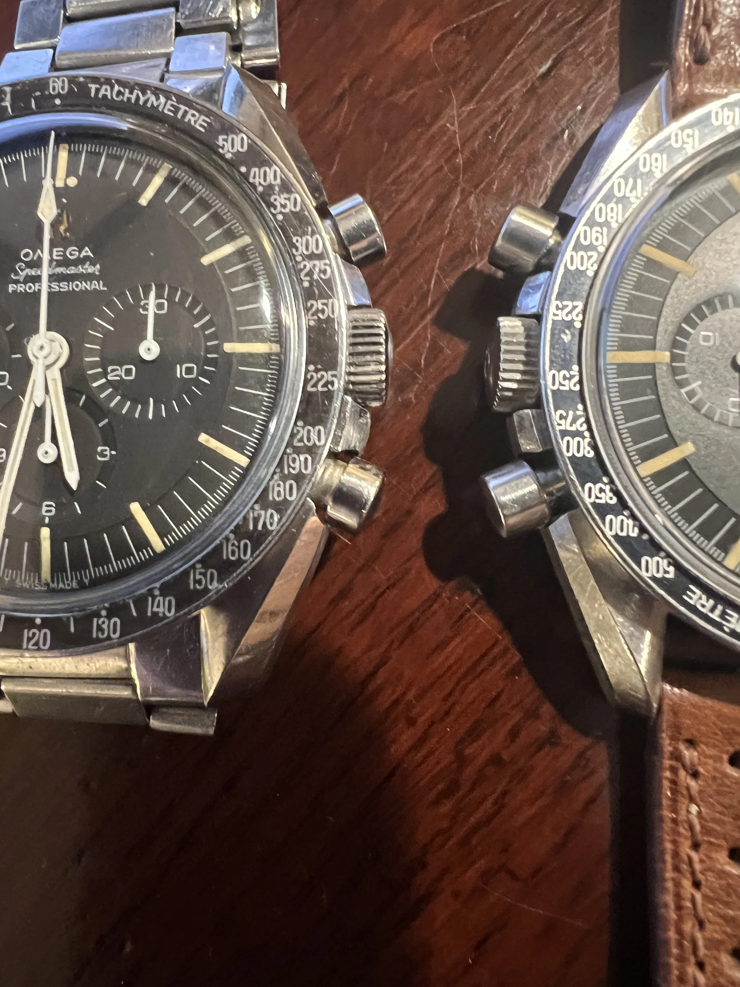

Thanks, that’s actually really helpful. Funny timing, I just heard back from Horoluma the lumen specialist and they asked me the same thing about color.
I’m honestly not sure yet, so I need to look into the different lume options for this watch.
Do you recommend any specific color that would look right for a 105.012?
Also, what would be the original lume color on these?
I think you should just choose a color that you like. The color of aged lume depends on the conditions it has been exposed to.

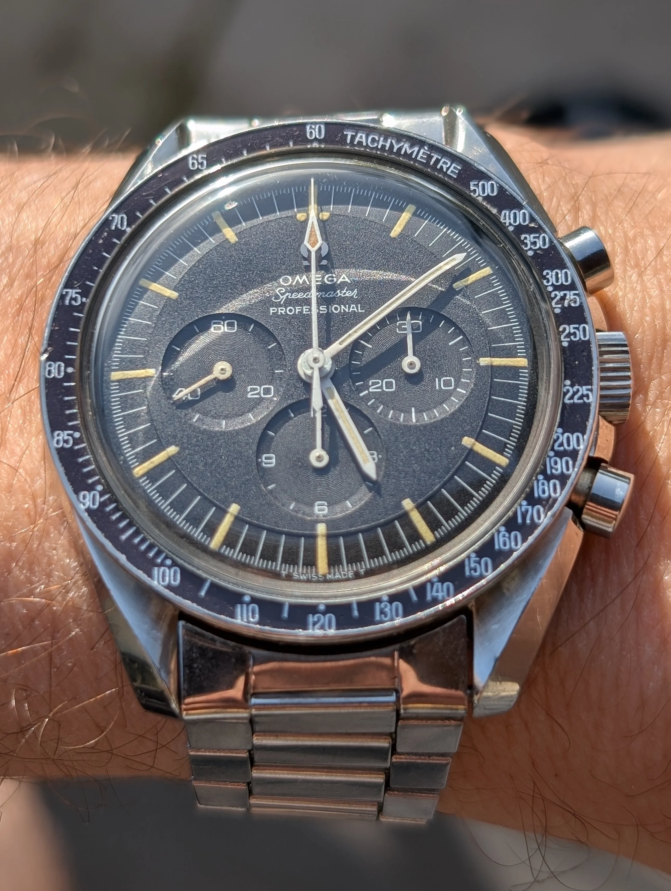

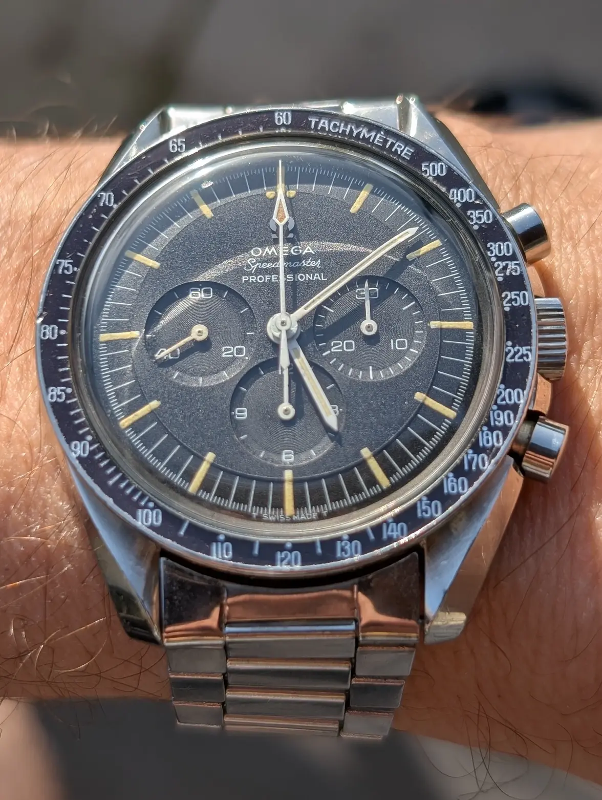

While this is hard to know original colour without seeing a true NOS example, my understanding is something like egg shell white.
Look through speedmaster101.com I think there is one close to original colour.
Many 105.012 I have seen are now what I would call custard yellow . Some a bit darker or “latte”.
Check 105.012-66 thread started by @hansaboy lots of examples.
Lighting can change the look. Here is my 105.012-65 I think custard, and 145.012-67 a bit darker or latte.
