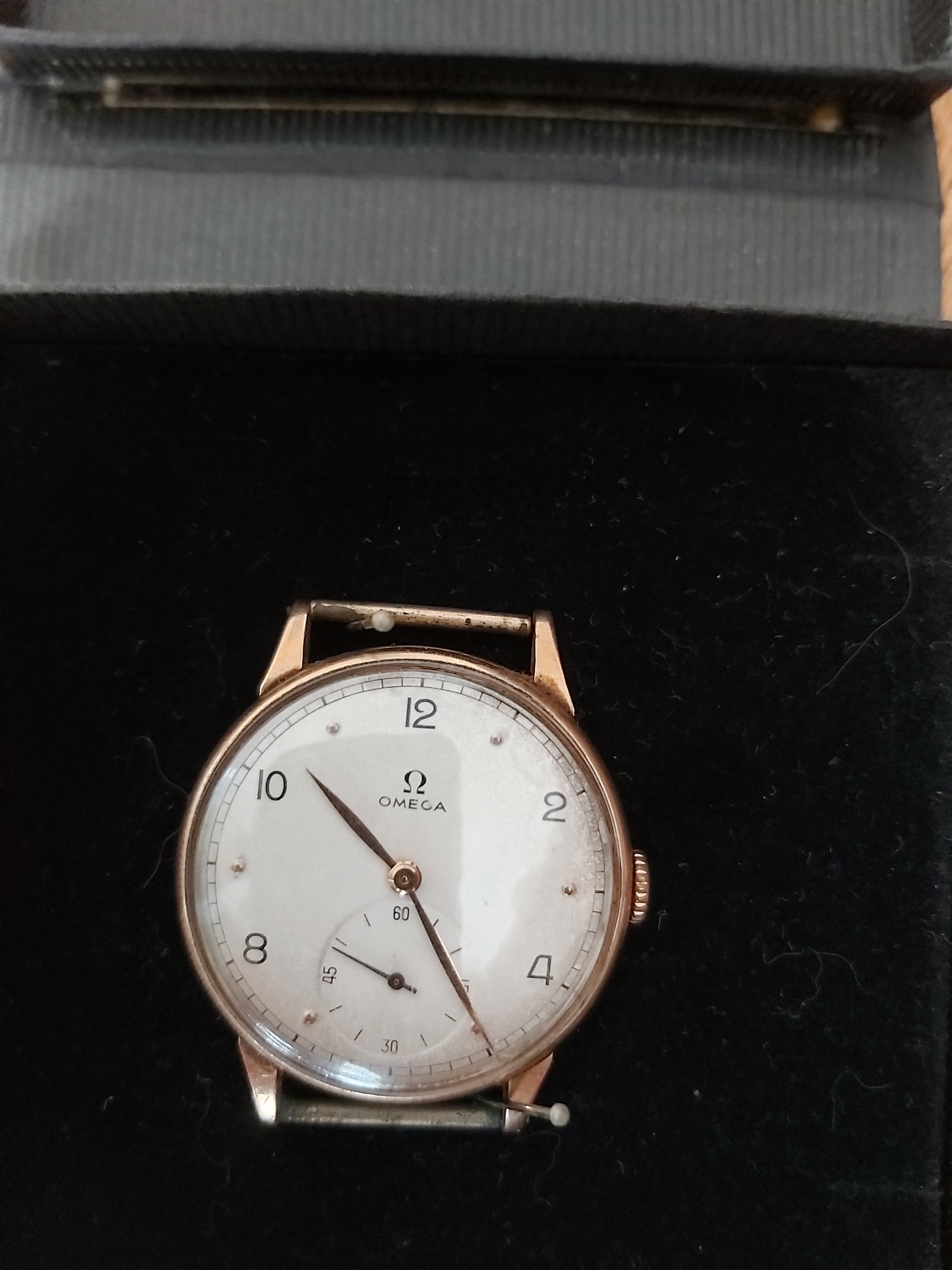

Hi guys,
I have inherited an Omega watch from my Grandad. I have found similar watches on line, but can't find the same one. I'm not looking to sell the watch as it has massive sentimental value to me, but was wondering if i need to get it added to my home insurance. Could anyone help with model identification and / or rough value? Many thanks.

I am not at all competent to answer - someone will no doubt be along shortly. Any further information and photos you could provide will be of help: a back photo, I guess you've not had the back off yet? Case overall diameter will be relevant as would any hallmarks on the case back.

Thanks for your reply. There are no markings at all on the external rear casing its totally smooth. I have not dared remove the rear casing. I cannot find any gap in the case that would enable its removal easily and don't want to cause any damage.

Don't use this watch until you are able to get it serviced. The case is a lovely colour of rose gold but even if it is solid, it isn't worth enough to add it to your insurance. It could very well be a 30T2 movement inside (these were fantastic) and is likely from the 1940's. The hands match the colour of the case and look correct. The dial does look like it has been repainted at some point - the minute track is not evenly centered around the edge of the case. This was a common thing to do back in the day and reduces the value to a collector. This won't matter to you though. If it works when you wind it a few turns and give it some motion, the movement may only need to be cleaned and oiled. Either way, don't use it until it can be properly serviced.

Thank you for your advice. Service wise, does it need to go to Omega for this?

No
A local WM with knowledge of vintage movements should be fine.
we can recommend one if you generally tell us where you are located

Looks nice! A little bit of TLC and this will be a gorgeous timepiece on any wrist! Does this have 38mm case size?

Not quite sure how you should measure but it looks like its around 36 mm, not including the bezel

There are lots of members here from the uk, so if you use the search function on this forum, you should find plenty of threads. Also, to answer your question DO NOT under any circumstances take your watch to an Omega Boutique or Omega repair centre. A good independent watchmaker will easily repair this and preserve the integrity/character of this antique piece. If it was a new watch, that would be a different story.

All will understand the importance of preserving the character of the watch but you still would need to be clear what you want done and what you don’t want done. And yes, don’t take it to a jewellers or even an Reputable Omega jewellers because if they send it off to Omega, they could ruin the character of the watch. Don’t be fooled into a cheap repair/service. [/URL]

He will do a movement service; clean and regulation. He’ll clean the case but NOT polish it and will polish any scratches out of the crystal. The dial will be left alone. Make sure you state all of this clearly but he will know exactly what this entails. It’ll cost you shy of £300.
It’d be a shame if you didn’t wear your Grandad’s watch otherwise it’ll lose its purpose. Maybe save it for special occasions like weddings and christenings if you’re happy to keep it in a safe place. A service will increase its longevity.

You can put it away and leave as is if you are going to wear it. It is a shame though, as it is not worth enough to really worry about. My nephew has my grandfathers 25 year service, solid gold watch that he got about a dozen years ago. He has worn it as his everyday watch since he was 14. It is nice to see it used and we think about my grandfather every time I see him with it on.
