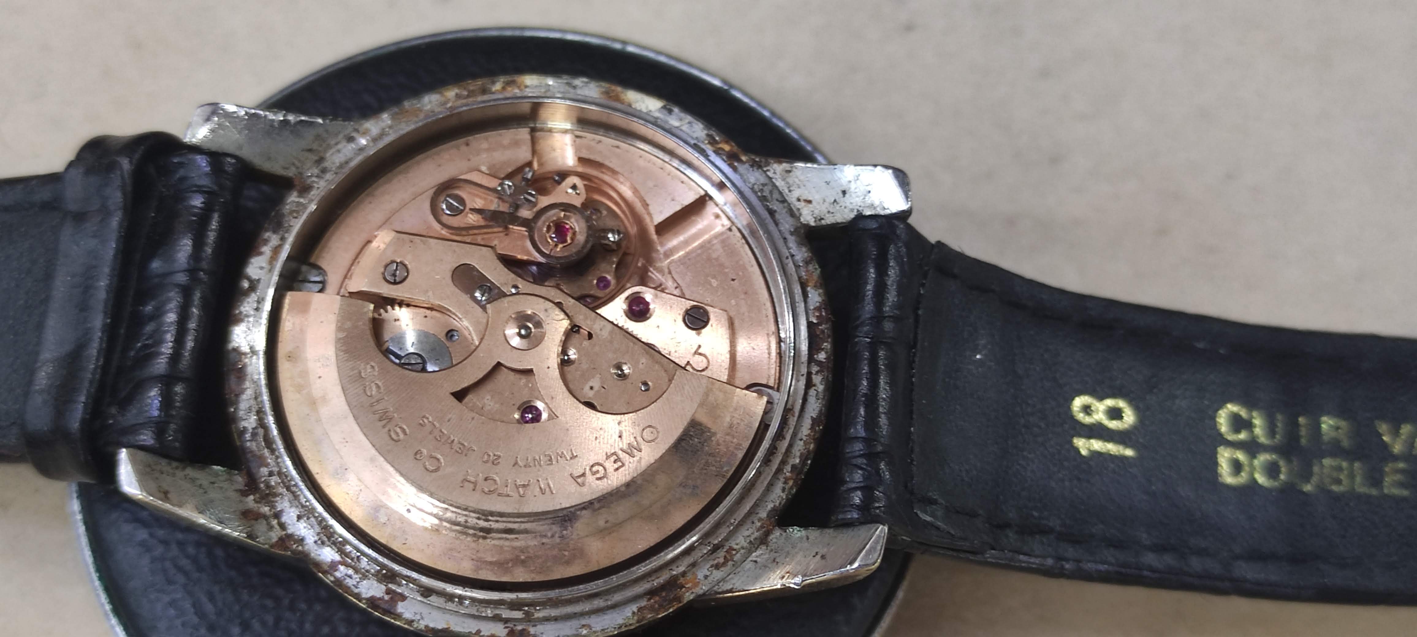

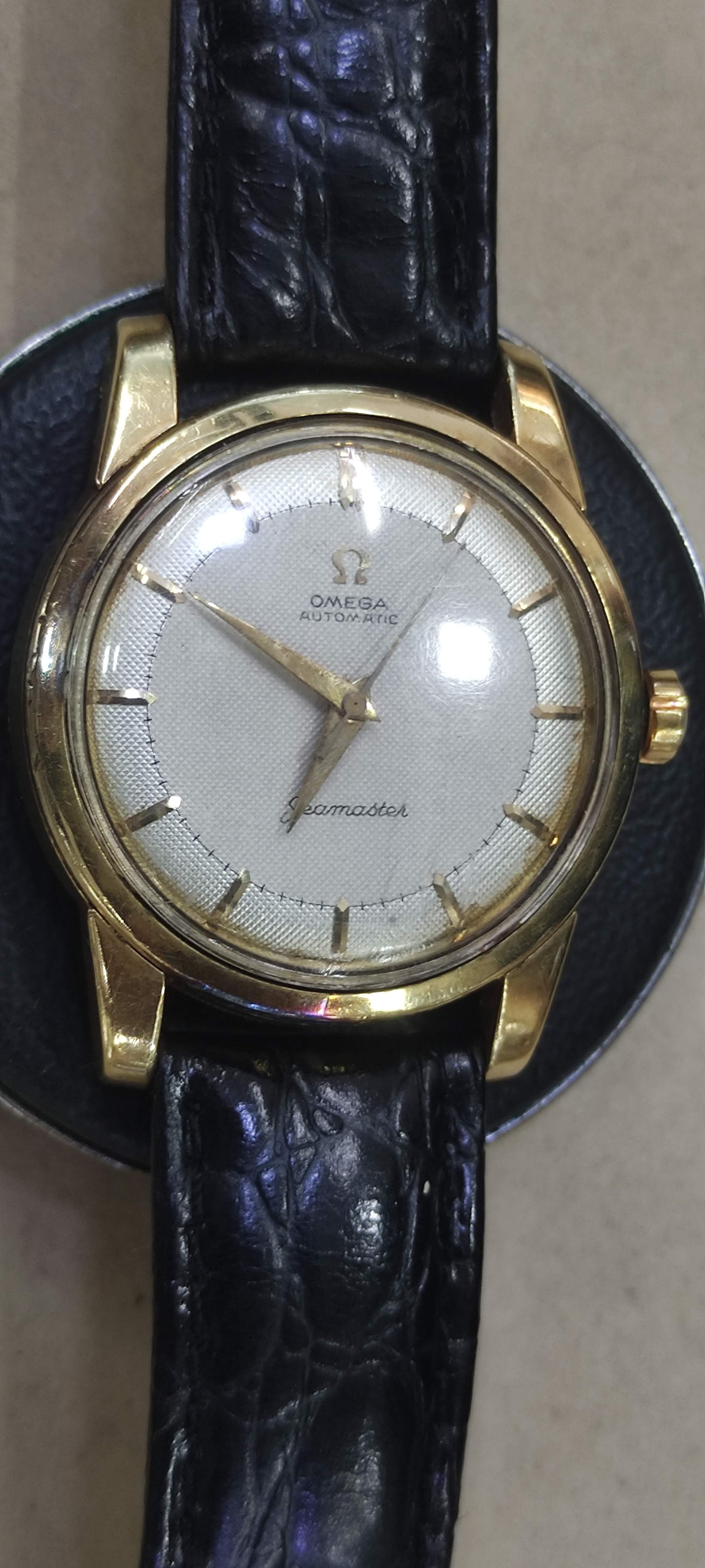

Hello,
I have recently inherited this watch from my father who got it from his father in 1969.
Could you help me to identify the exact model?
The back cover is slightly cracked and need full servicing - how much would this cost in your experience?
Thank you.

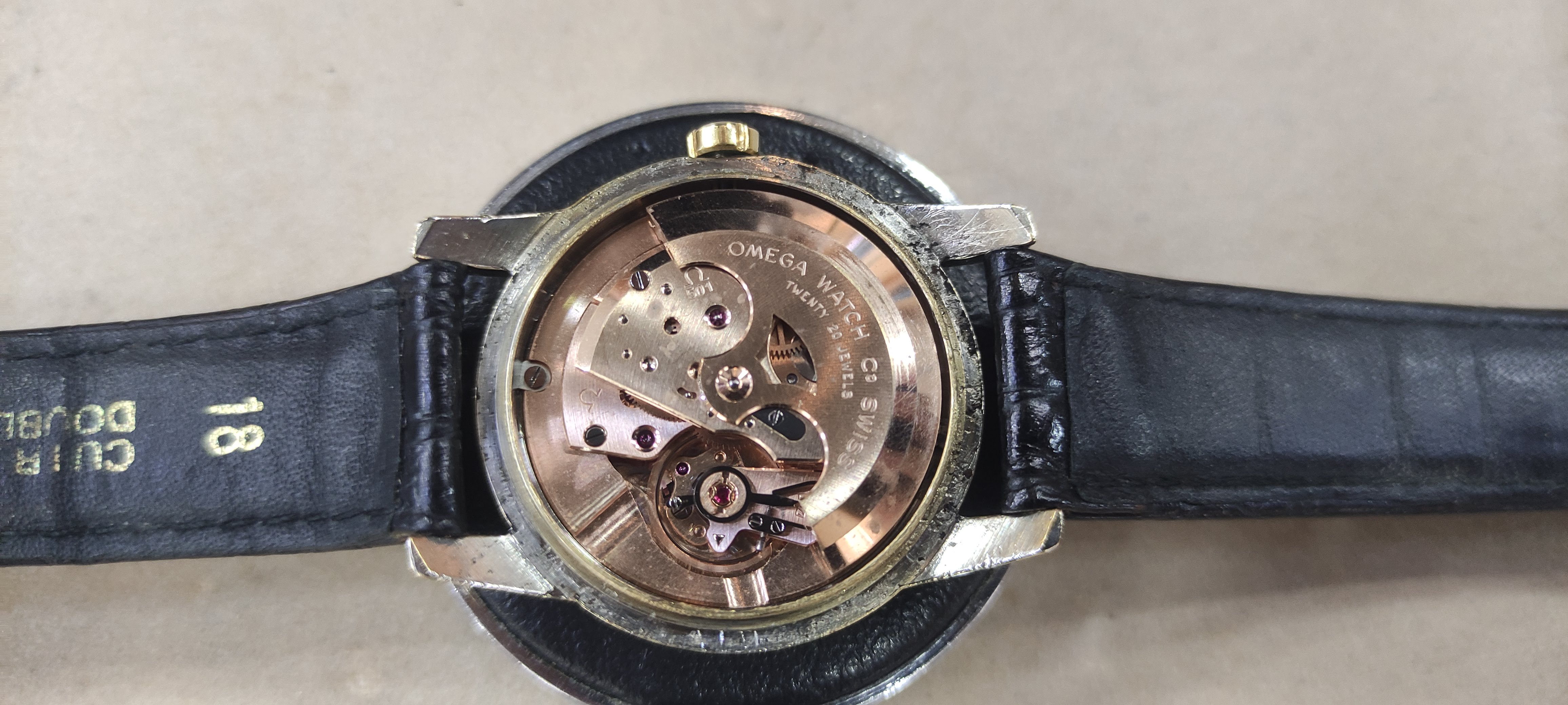

Your watch is a "waffle dial" Omega Seamaster reference 2846, manufactured in the late 1950s. The serial number on the movement would allow a more accurate estimate of the production date, but it is covered by the rotor in your photo. This is known as a gold-capped case. It should have either a caliber 500 or 501 movement, but again the caliber number appears to be covered by the rotor.
Fortunately, I do not see an actual crack in the case-back, since that could not be repaired.
The watch looks great. Personally, I would just have the rust cleaned up and the movement serviced, which may cost a few hundred currency units from a skilled independent watchmaker (this is an international forum, and I don't know where you are located). Please, go slowly with any restoration, since things like case polishing or dial cleaning cannot be un-done if you're not happy with the results.
https://www.omegawatches.com/en-us/watch-omega-seamaster-omega-ko-2846

Just a quick note. Looking more closely, I am seeing some "rotor rub" in the movement, and obviously some pitting from water intrusion on the back of the case (and a little bit in the movement itself), so there may be some corrosion in the movement that needs to be addressed. This can all be repaired by a good watchmaker, and I would not hesitate to do it. This is a nice watch, and obviously it's a family piece. However, the watchmaker may need to replace some parts, so the service cost could be a bit more. Honestly, it is hard to know until the movement is completely disassembled. But don't panic, it will be worth it for your heirloom, and once repaired, it will be something that can be passed down through the generations. It will be good to find a watchmaker who is experienced with vintage watches.

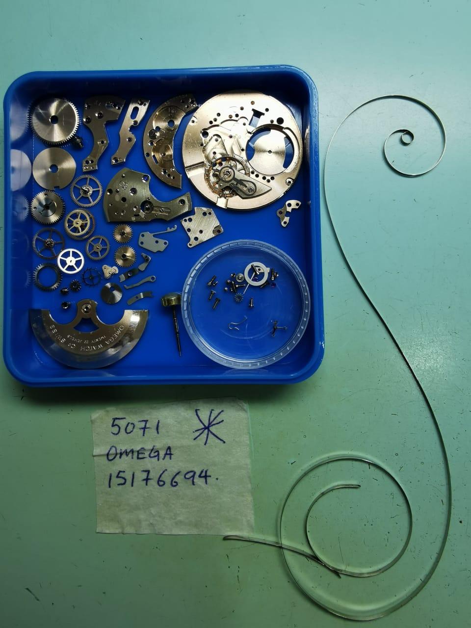

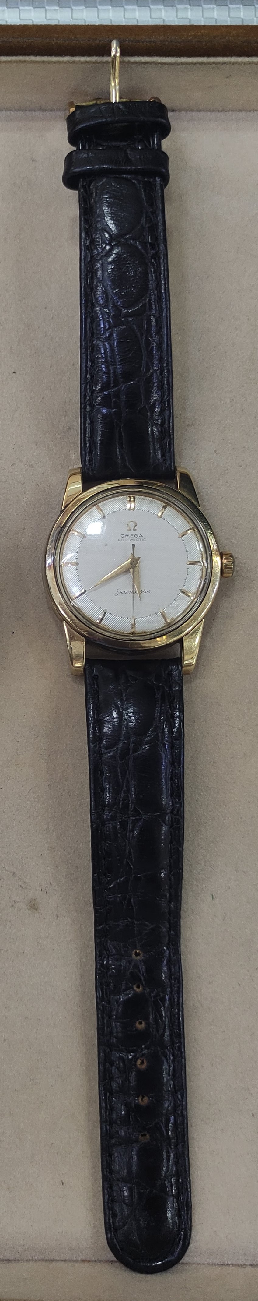

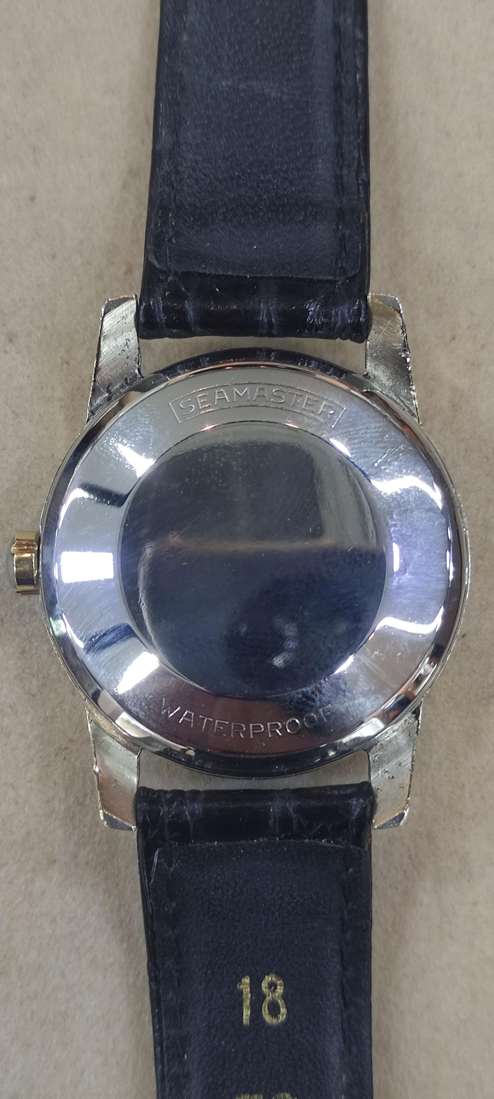

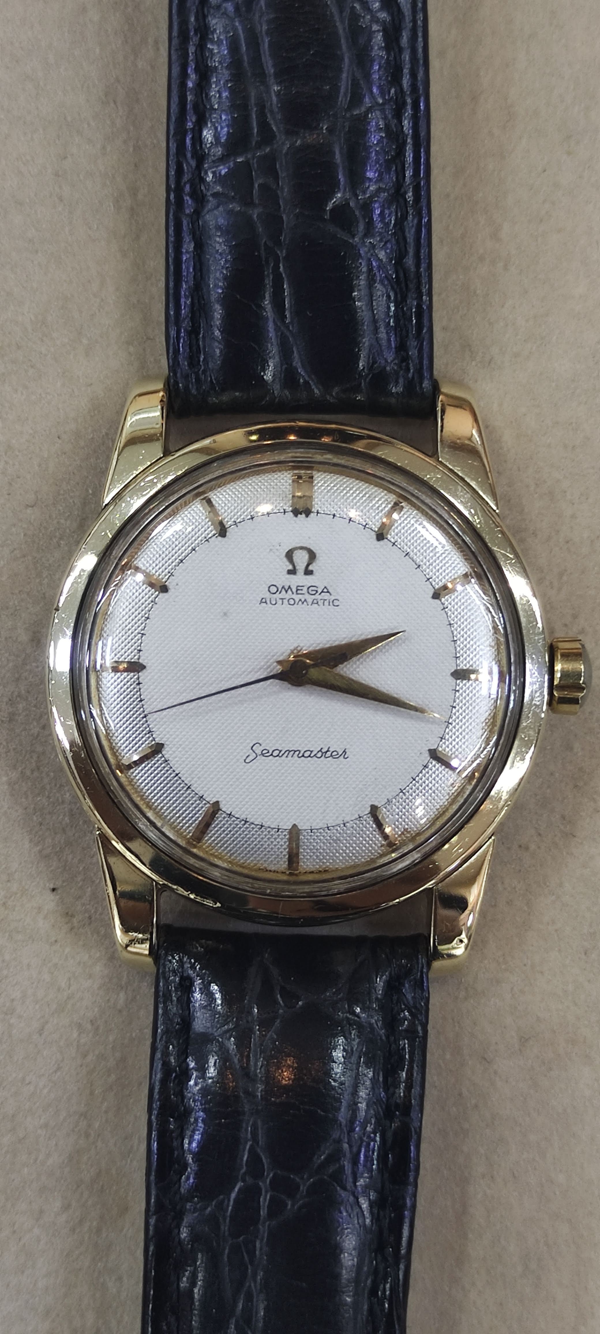

Just got it back from servicing. I am very pleased with the outcome.
No part has been replaced.
The case-back has been fixed and polished, the watchmaker said this was needed because of the crack fix.
It is a 501 movement.
I am seeing some "rotor rub" in the movement.
Well spoted! The watchmaker explained to me how this could happened.
Again Thank you Dan for all your advise.

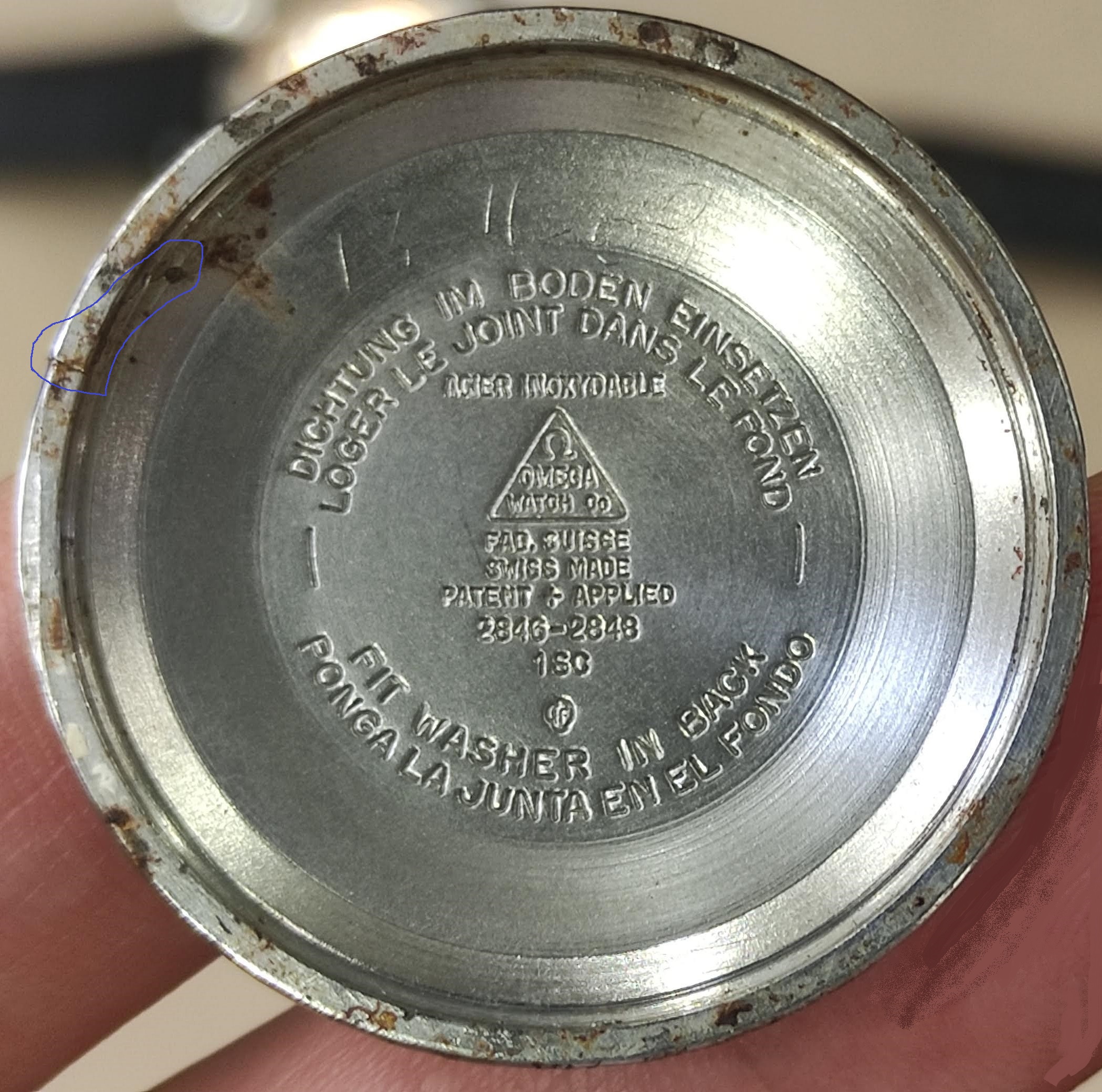

Looks nice. What crack?
Thank you. 😀
I have seen it myself when the watchmaker pointed it out.
I try to highlight it again on the attached picture. 😀
I believe he`s no english native speaker so I tend to think he confound crack for scratch.
Yes, you are correct I am not an english native speaker but I didn't mix up crack and scratch. I meant crack on the case-back.
5
17
Oh my 😲
How did he fix it?
He outsourced this to a jeweler to fix this, some heating process was involved but I don't really know the technical details.
