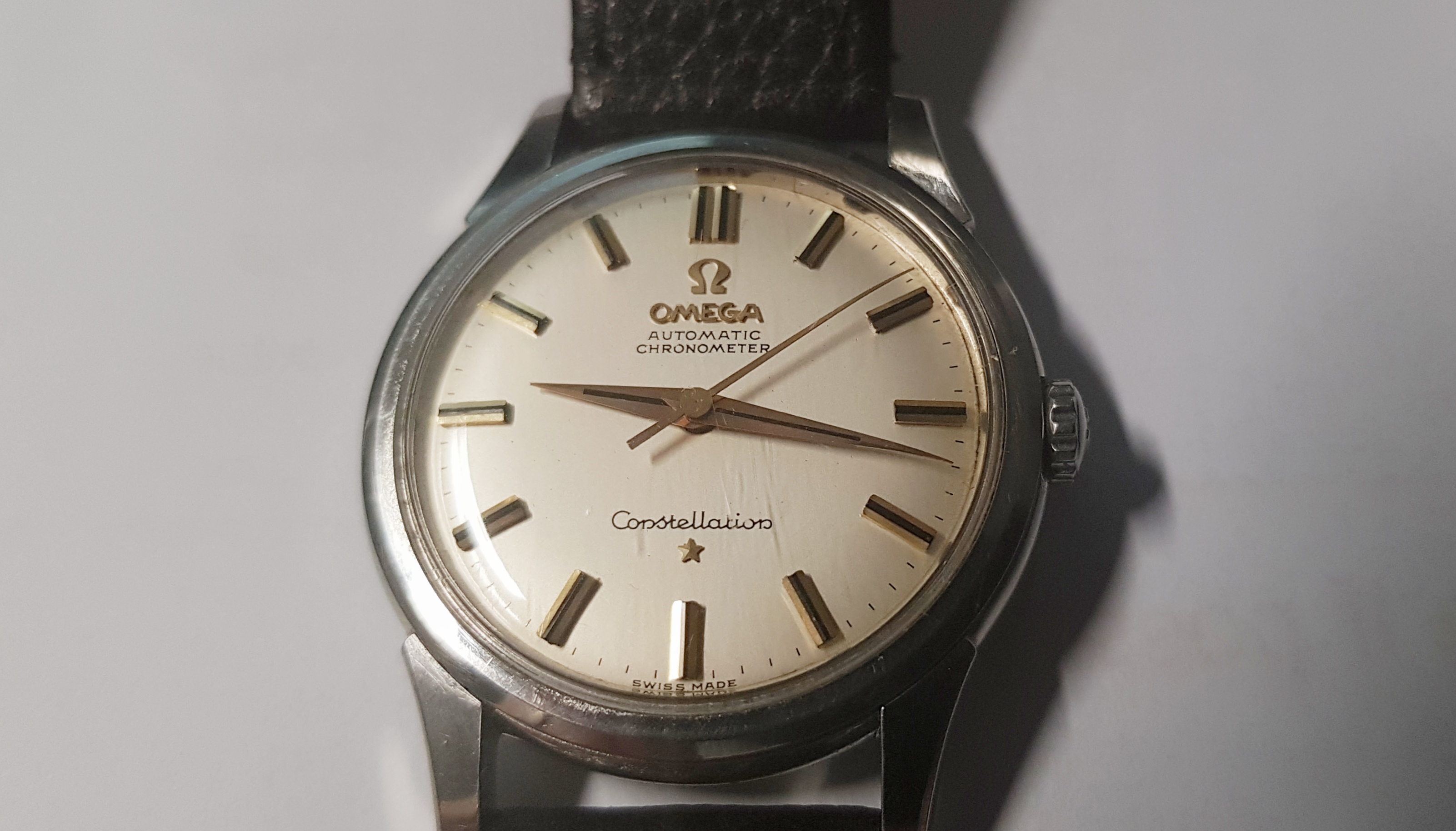

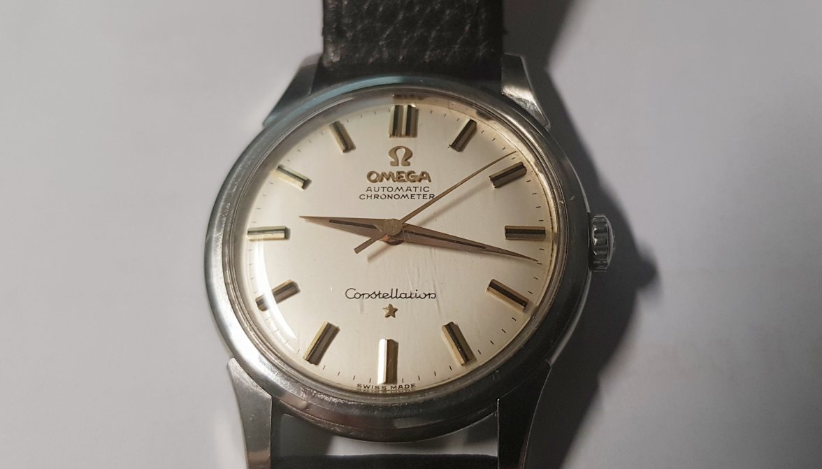

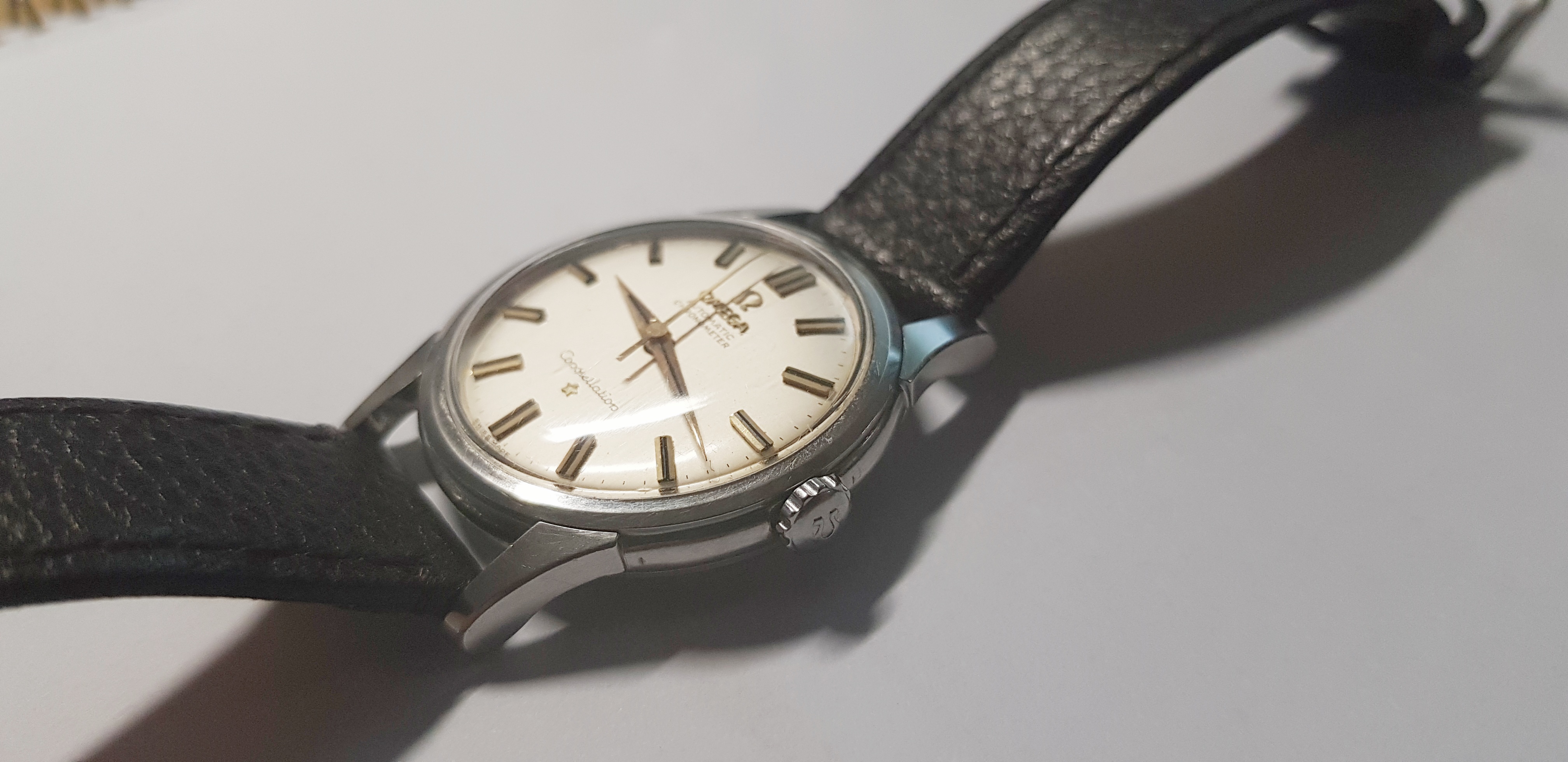

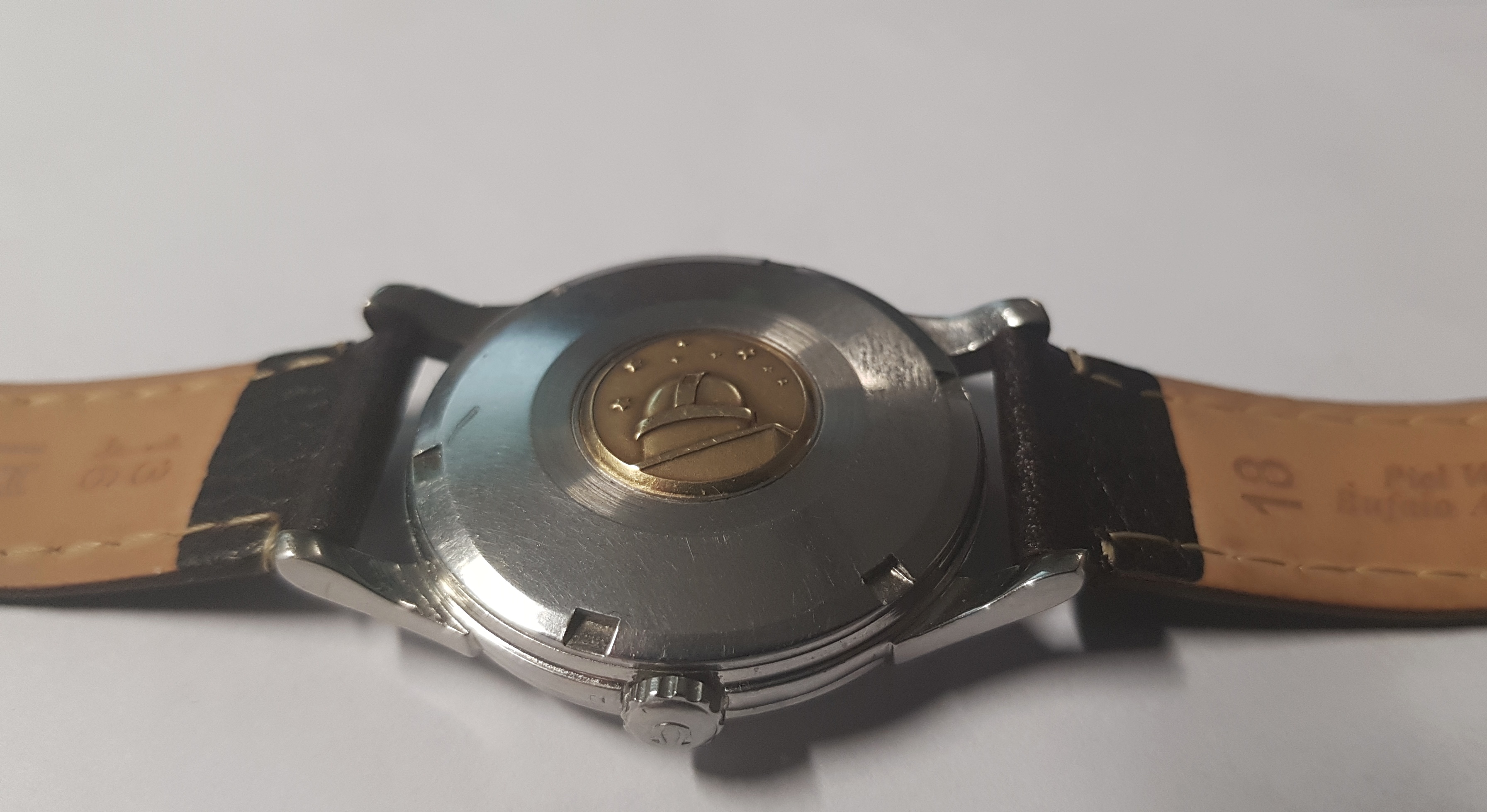

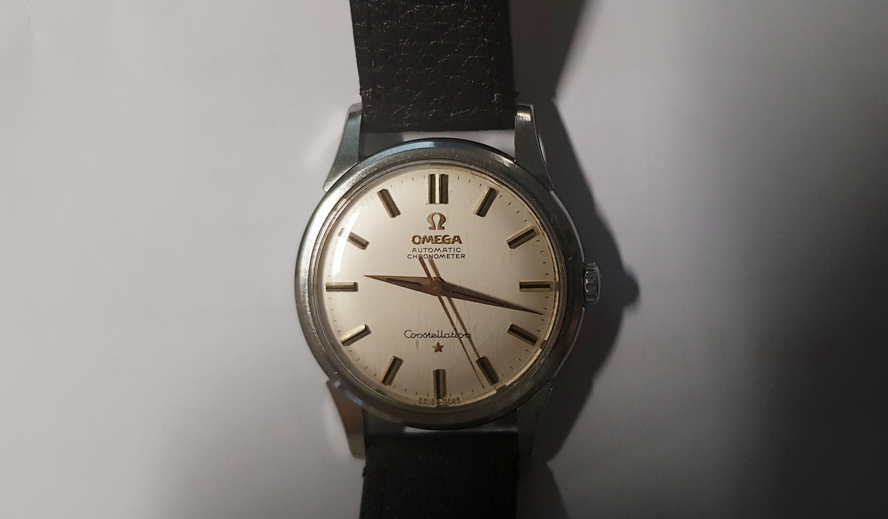

Hi all,
I'm a timepiece noob but recently found a Constellation at an estate auction that I couldn't pass up.
It was purchased without papers or service history knowledge so it was a gamble for sure.
It turned out to be in pretty decent condition upon receiving it.
I had it looked at and serviced by an independent Omega repairer in Melbourne last month, and it only required a clean, oil, and new strap.
I've also taken it to the Omega store in Melbourne cbd earlier this week for some additional information and requested some pictures of the case back and movement (still waiting on these to be emailed through).
They did provide the following information after the tech opened it:
Cal: 551
Cal No. 1773****
Year: 1959-61
From my research, that cal no. would make this made in 1959.
I just have a couple of questions regarding this that I'd appreciate some input from the experts.

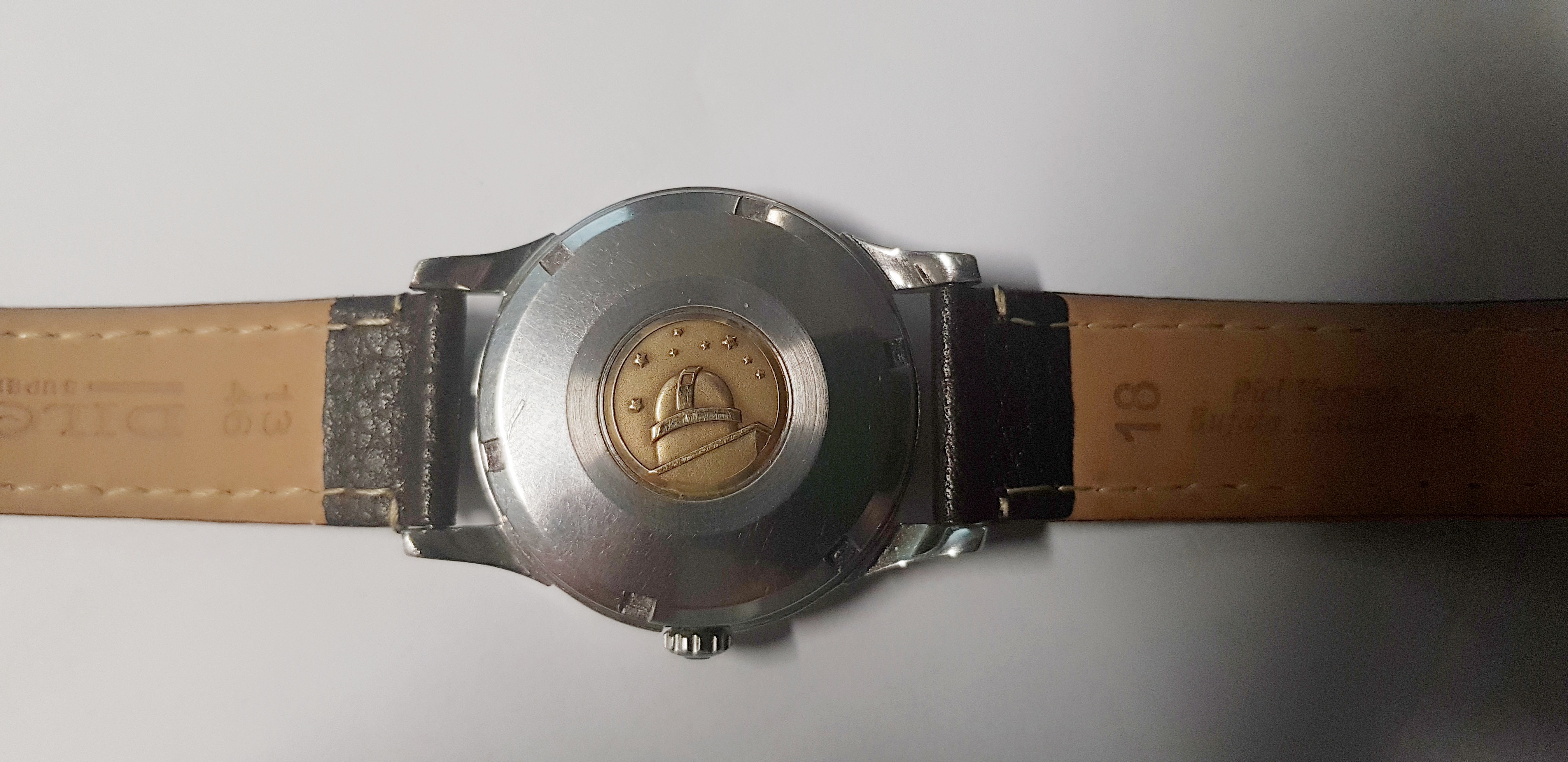

- Does it appear to be original? Does anything stand out as being replaced?
- Can I look at this purchase as an investment? Is it likely to increase in value over time based on the year, cal, 2 lines instead of 3 (no "officially certified" line? I know this is certainly speculative at best.
- If I were to sell it (which I'm definitely considering) what could I expect to get for it? I'd like to avoid eBay.
Photos below:
Thanks for your time! (hah)

You bought it and wanna sell it for profit, right?
Your questions regarding the originality should have been answered by the watchmaker that serviced it as he/she inspected it closely.
8,174
36,709

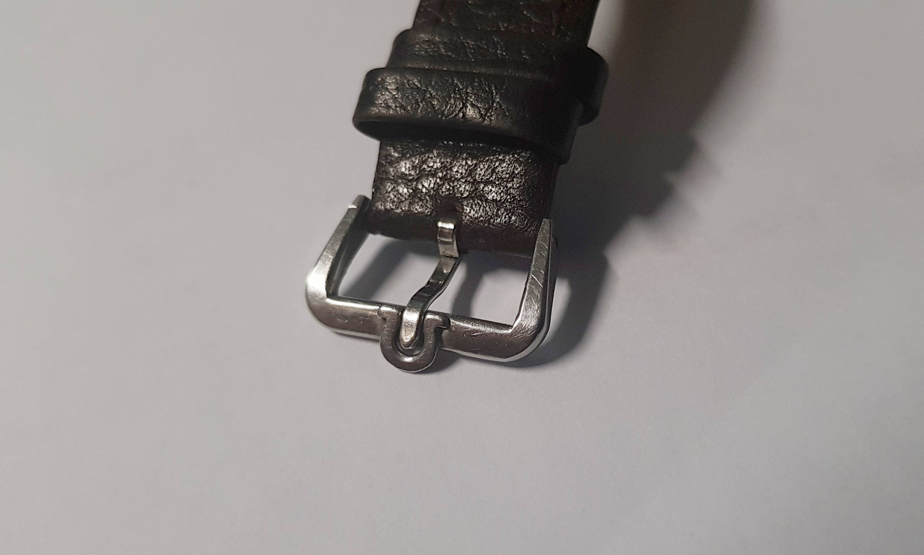

Ref 14381, movement serial number is in the correct range. The watch looks to be in very good condition with a bonus for the nice steel buckle ( this buckle version I see more often in soild gold ). I'd say €600-700 as is, perhaps a bit more if you have the service papers.
You are asking a lot of the watchmaker. It might be possible to indicate replaced movement parts that are not original but, no-one can know every dial/hand/case variation and that's not really the watchmaker's job as it's more of a historical issue.
As @cristos71 says, it looks a nice watch and correct but, I happen to know these and I have one. If someone sends me a Zenith bumper, I can't be sure that the dial and hands are original to that watch so, can only judge based on looking under a microscope for flaws - it's not easy to state anything about originality with certainty. Just bear in mind that you shouldn't expect a watchmaker to make the call on originality of everything.

It's a particularly nice example and looks totally original. That's onyx inlay in the hands and markers. The rubs on the crystal will polish out and it will look even nicer then. This is a high-quality watch which as a beginner you could learn to truly appreciate if you took the time. If you are not desperate for money, why don't you keep it as a dress watch?
10,804
16,814
I would put that serial at 1960-1961, Most 1959-60 stuff still used the 50X movements.

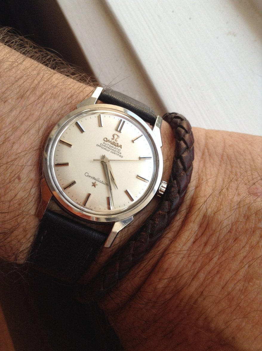

I favour the non date dome dials. Here is mine I got a few years ago that lives in Sunny Darwin nowadays.
