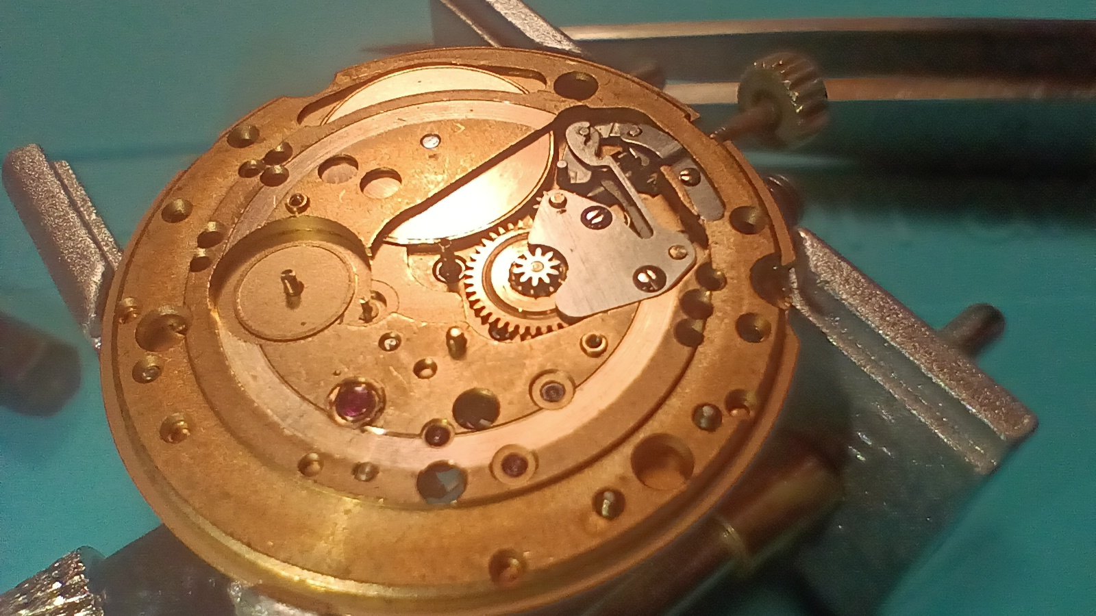

Hello,
This is my first post, so let me say that I really enjoy looking through the conversations here, and appreciate the in depth knowledge of the Omega community. I am a watch enthusiast and enjoy working on watches. i am an amateur, just doing your basic cleaning and lubricating.
So, I am hoping that there is a way that I can fix this problem. I had cleaned my Omega Cal 750, and was about to finish lubricating. I unlatched the incabloc spring, on the dial side, and it just falls off. The hinge is no longer attached. I am at my wits end trying to figure out how to reattach it.
If anyone had some insight they would share on how to reattach this, I would be very grateful.
Thanks

I am unable to see enough detail in your poor photograph to be able to help you. If you locate the Google Image app and search for Incabloc Springs, there are several tutorials showing how to do this. Be sure you haven’t broken off one of the ends of the “T” hinge of the spring.

Not uncommon on these. You can try to feed it back into the setting, but if that isn't working you could press the entire setting out a little from the other side, then slip the spring in, and press the setting back in.
If the setting comes all the way out, make sure you orient it correctly when you press it back in - there is a portion of the setting that is shaved off to clear the calendar functions, so it has to be pressed back in in the same position it is in now.
Thanks. I will try to press it out slightly to get it back in.
