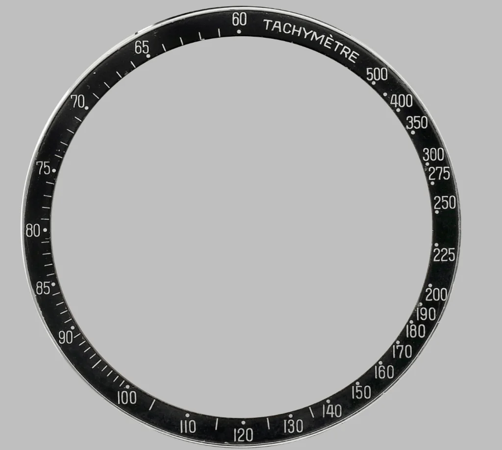

Bezel does line up with the layout of the early 2998-3 bezels.
OP if you can give us something like 177621XX, it would be helpful placing it in time with other bezels.
A good clean photograph (ideally with a longer focal length) that is orthogonal with the bezel would be helpful to give best results on reporting on it.

The bezel is tricky. To me, it looks legit. We sometimes see fatter font at the end of production runs. The scratches along the upper left make me nervous, as that is what we'd see if someone were aging a bezel. But it's also where cuff wear happens, especially if wearing a heavier fabric. If real, it's not a bad looking bezel, and certainly does not distract from the watch.

Comparator animation against another B1 Mk1 bezel.
It is a weird bezel. The left side seems normal, but the right side is very fat with a rightward bias. The positioning does seem very close though.
The 6 in 160 and the 50 in 350 in particular standout. I guess it could be uneven pressure when they pad printed it?
