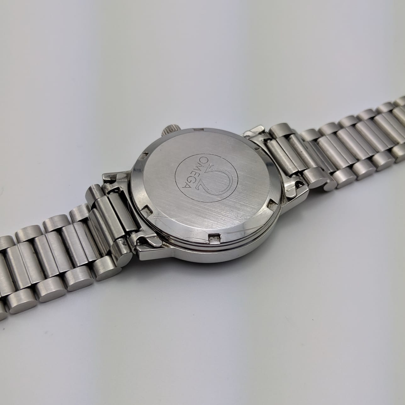

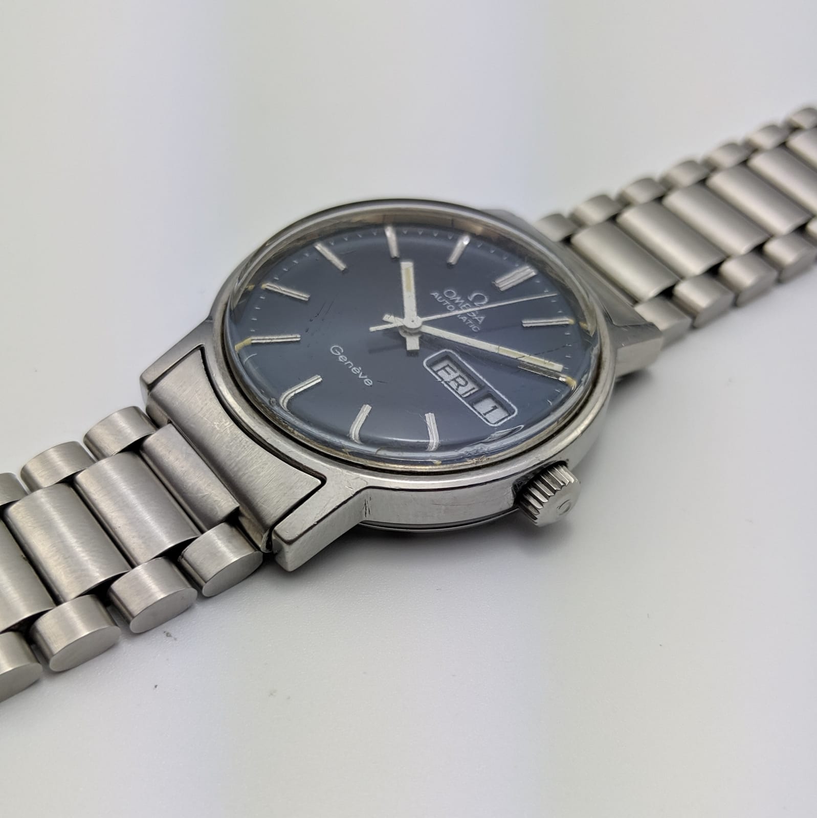

Hello,
Im about to buy an omega Geneve DayDate.
But I really want it to be on a metal strap, thats why I wanted to ask you if anyone could help me find a strap with Endlinks for the watch.
Aftermarket straps would be ok.
Referencenumber is 166.0117
Thanks alot!

Just do a search for Genuine Omega strap and you should be able to find what you need, there are plenty of “curved end bands” that would like great on your watch from after market strap makers too. Good luck!
24,833
55,242
Try some research. For example, do a Google Images search for the watch reference number to identify examples with bracelets. Then follow the links to find photos of those watches from the back, to identify the end-links. Then once you have identified some end-links that fit the watch well, you can do similar searches to identify a bracelet that accommodates those end-links.
Here is one that I found, see if you can find others: https://mall.elady.com/OMEGA-Geneve-Day-Date-Steel-Automatic-Mens-Watch-1660117-BF331634.html

Hi,
First of all thank you all for your helpful replys.
The seller told me he can give me the old Endlinks, but is there any way to find out what strap is fitting?
I mean its a 1125 strap on it, should another strap with 18mm on the end fit aswell?
935
1,058
You are looking for a 1193/672 bracelet but as other members wrote, many may fit.
