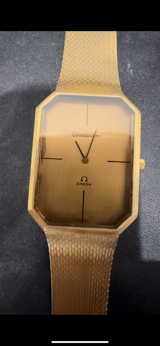

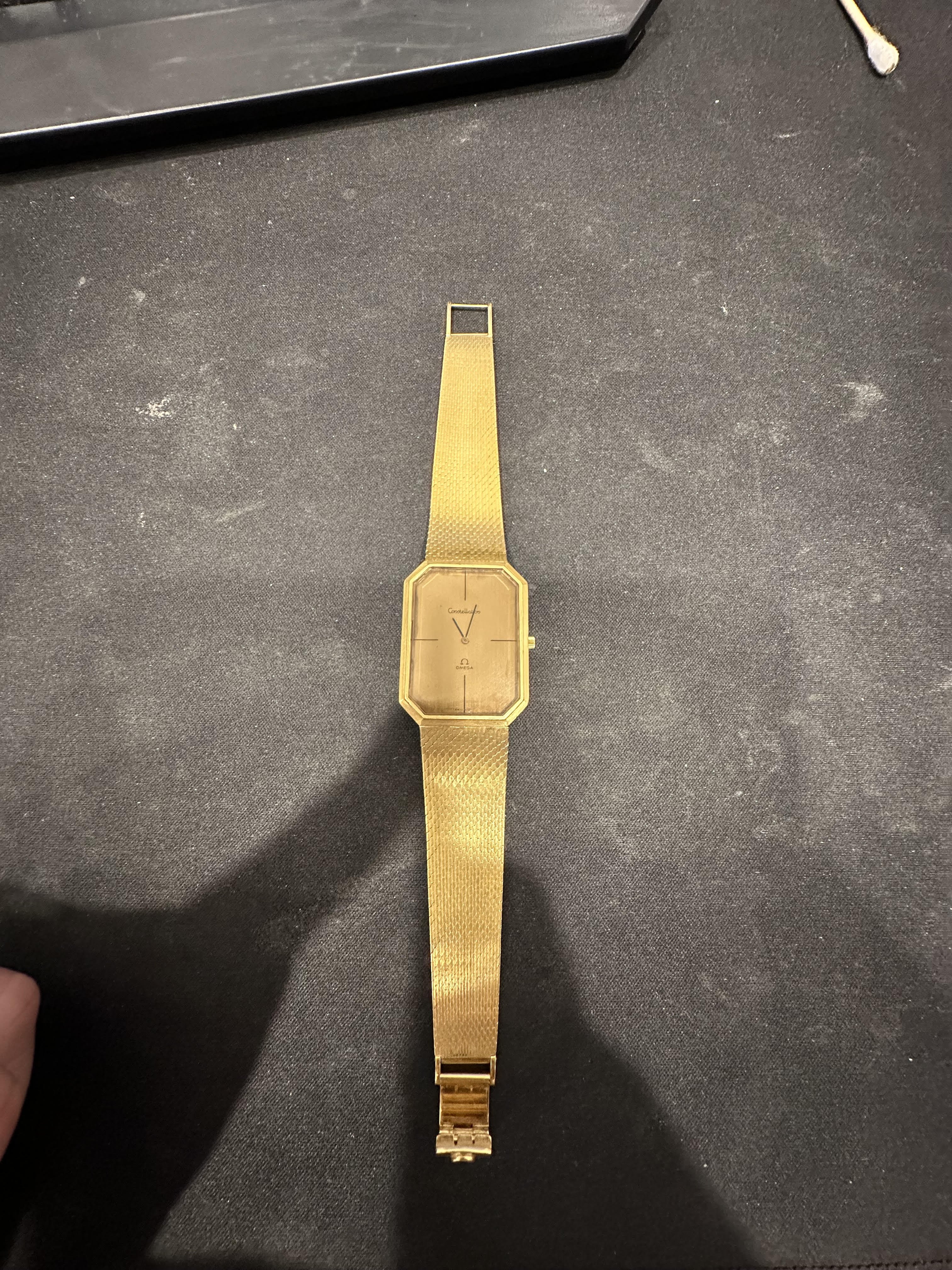

Hello,
My Father recently passed away and left behind this Omega watch. The only pictures i have found that look similar are from a 1973 Constellation Emeraude but the face isnt the same. Any help would be greatly appriciated!

The dial appears to have been refinished at some time, unfortunately not very well.

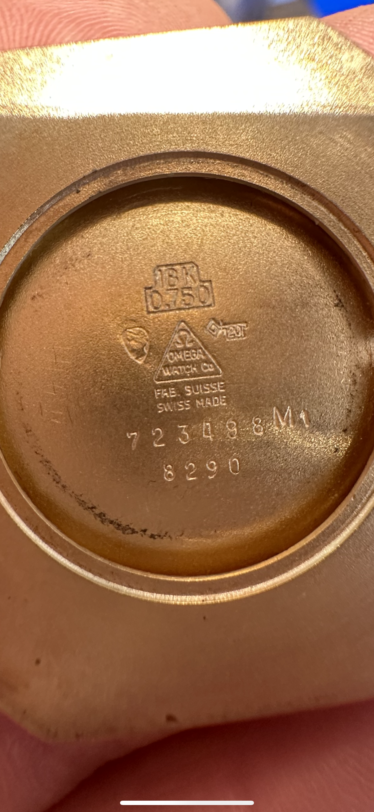

I went to the local Jewler and we took a look. He was blown away by the fact that it is an Automatic. He said the dial doesnt look to be refurbished, but rather worn areas where water has creeped in over time.

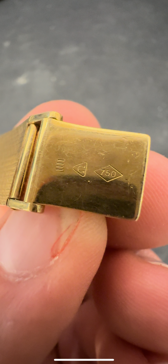

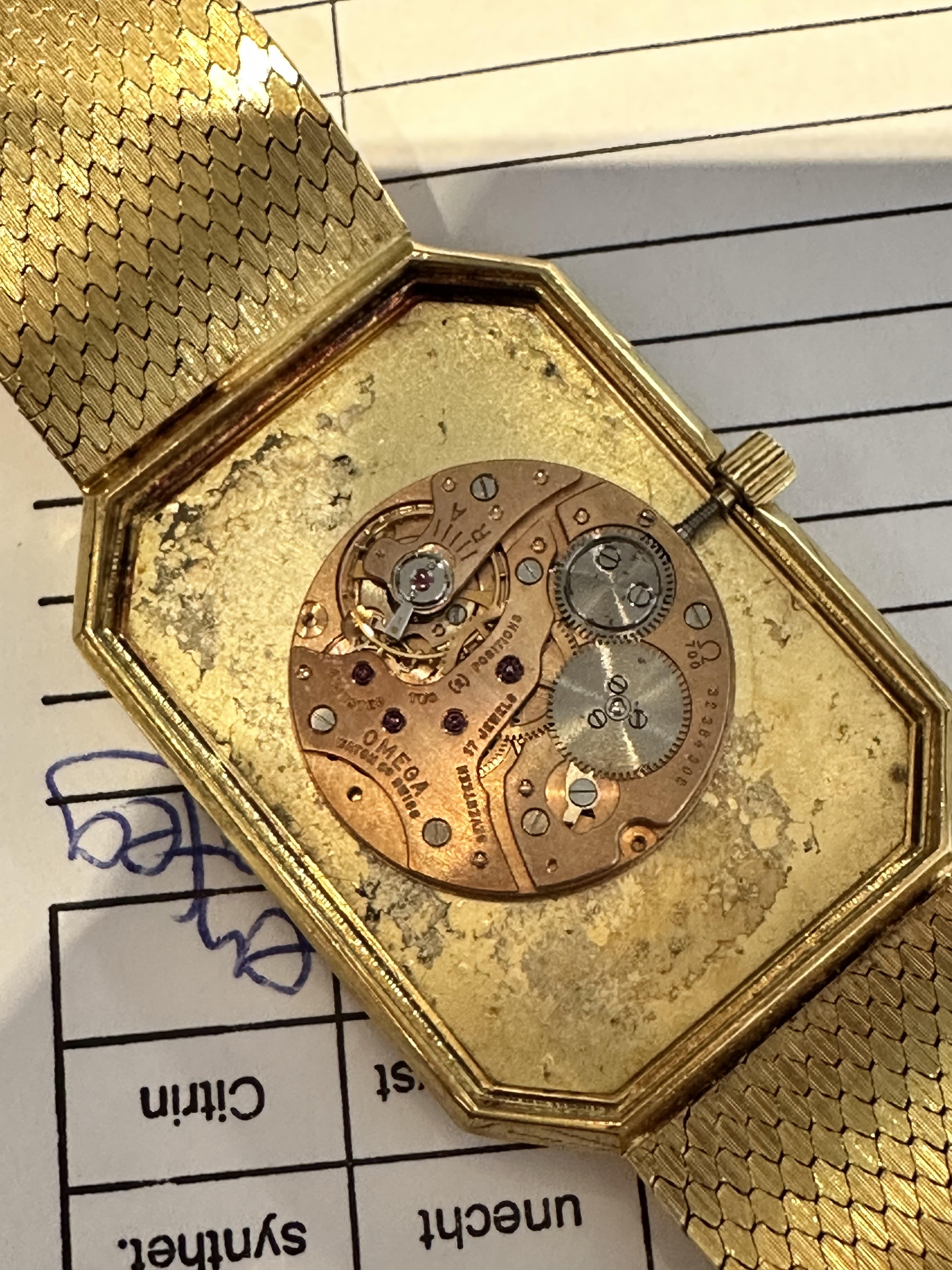

He is convinved its a real Omega from the 1970-60s in its original state, he was pretty flabergasted. Here are some pictures as well as numbers.
Watch movement: 700 ?
Reference number: 723498
Model 8290
looked up the numbers but couldnt find anything on it.

welcome @Vettbryan and condolences on the loss of your father.
Your watch is real - and relatively quite an uncommon Omega.
The range is one of Omega's 'ultra thin' Constellations.
In this case a cal 700 hand wound, non-chronometer, movement. (they also did a 711 & 712 automatic thin watch)
The movt dates the watch to around 1970/71.

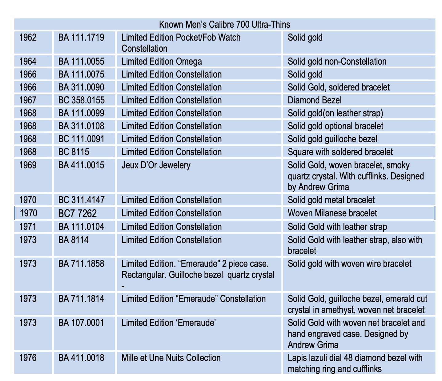

Due to its uncommon nature, specific info about your watch is hard to come buy (without approaching Omega) but I've attached some info and links that talk around the subject of ultra thins.
There is only one dial configured like yours and that is in the 'Emeraude' collection.
I too think your dial has been repainted, due to the thickness and shaping of the print but it may have been in this 'inverted' format originally.

Info and links:
http://omega-constellation-collecto...6/strangely-nothing-of-substance-appears.html

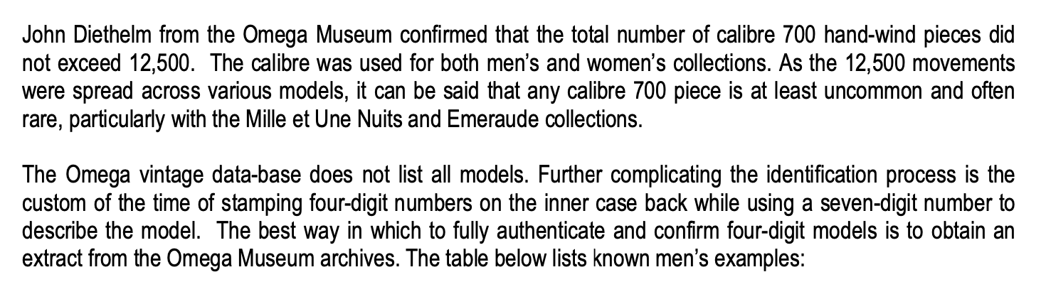

(excerpts from the above )

Sadly there are no papers Authenticating it, this being the reason i questioned it in the first place. Is it possible to contact Omega directly to have someone take look at it and "Authenticate" it for me, tell me the condition it's in internally and produce new papers etc?
I've also noticed today that the movement runs extremly fast, like 20 min is 30 mins on the watch..... Is it even possible to Repair something like this? Should it even be done? It's Probably better to leave it "as is" if its 1 of 12.500 huh? 😟
The watch is authentic albeit with a refurbished dial.
You can apply to Omega and pay for an Extract of the Archives. This will give you some information you are looking for including date of production and where in the world it was first delivered to. Unfortunately the last I heard the service is currently temporarily unavailable so you will need to wait until if/when it comes back.
