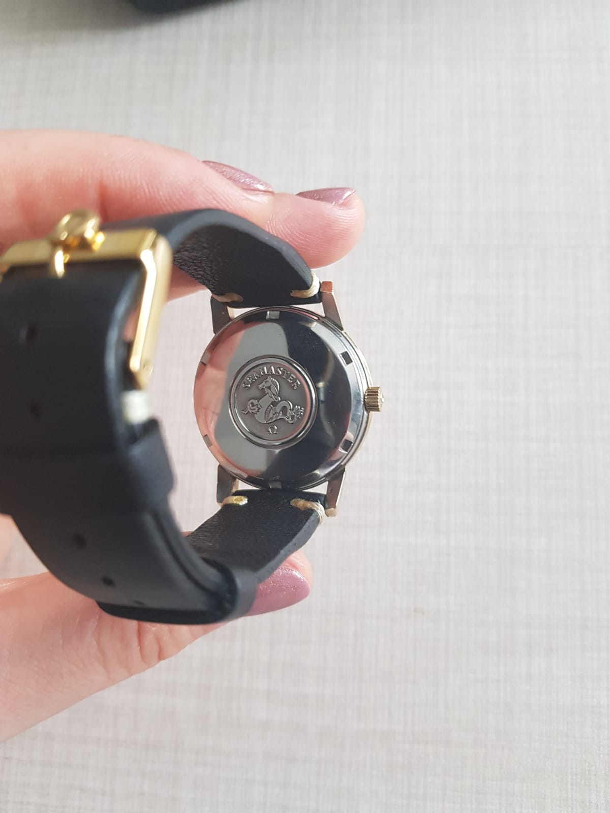

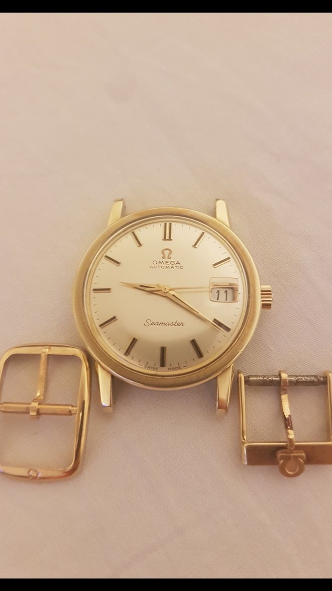

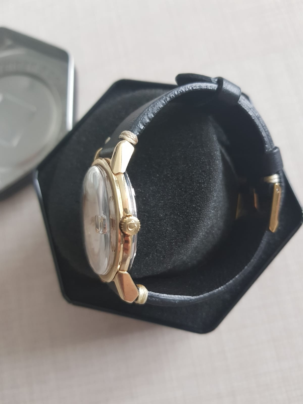

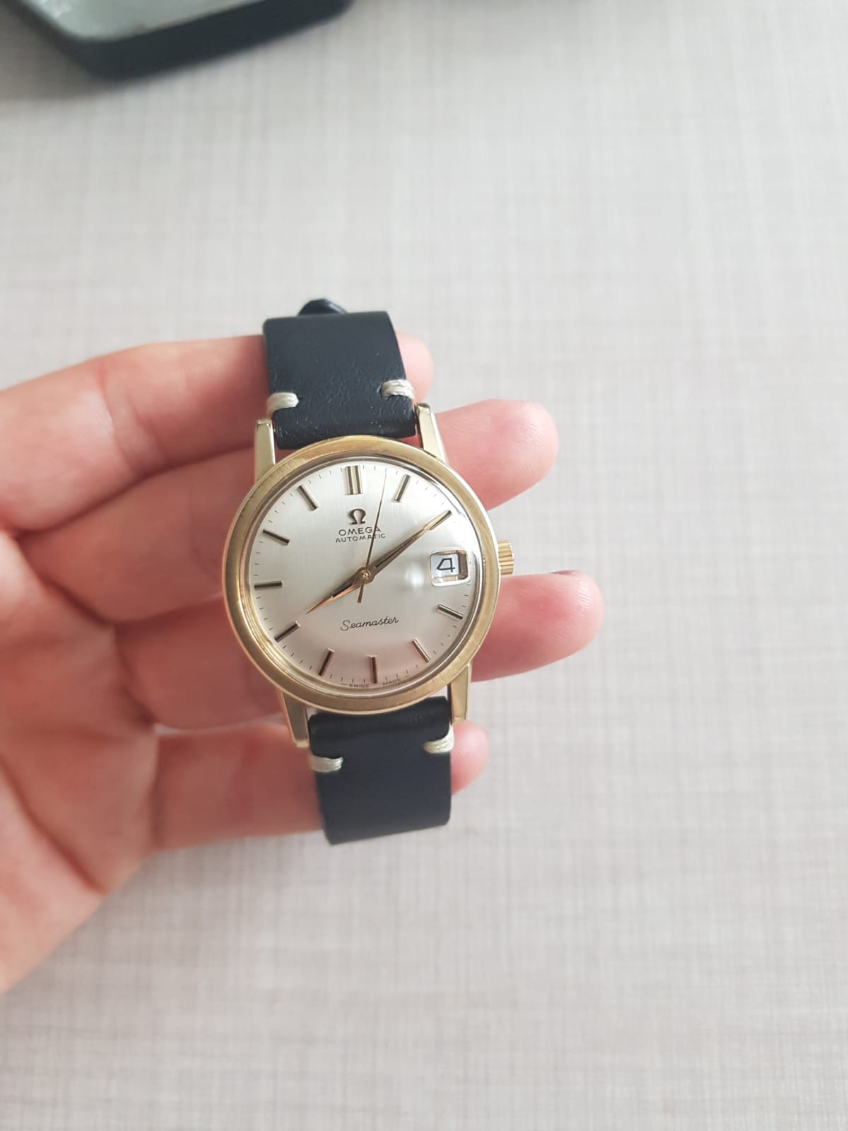

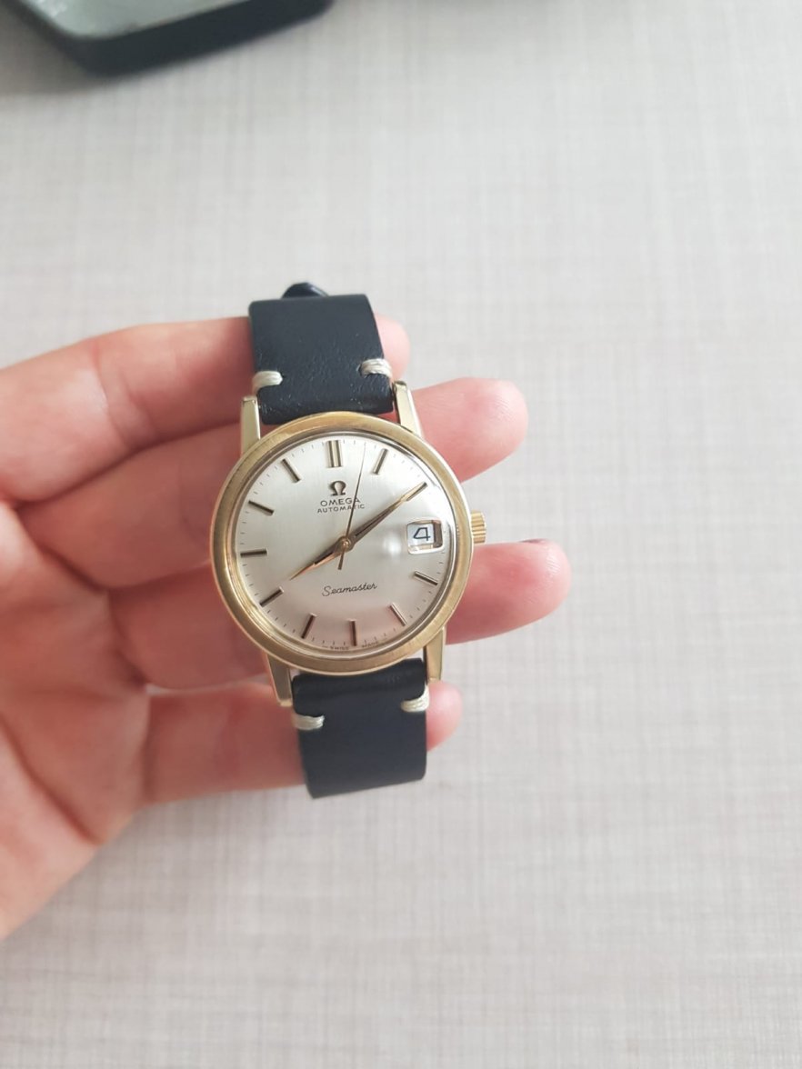

Please help me check the authenticity of this omega seamaster ref: 166.003 about which I can find nothing on the internet, I want to know if it is worth paying 1000$ for him.

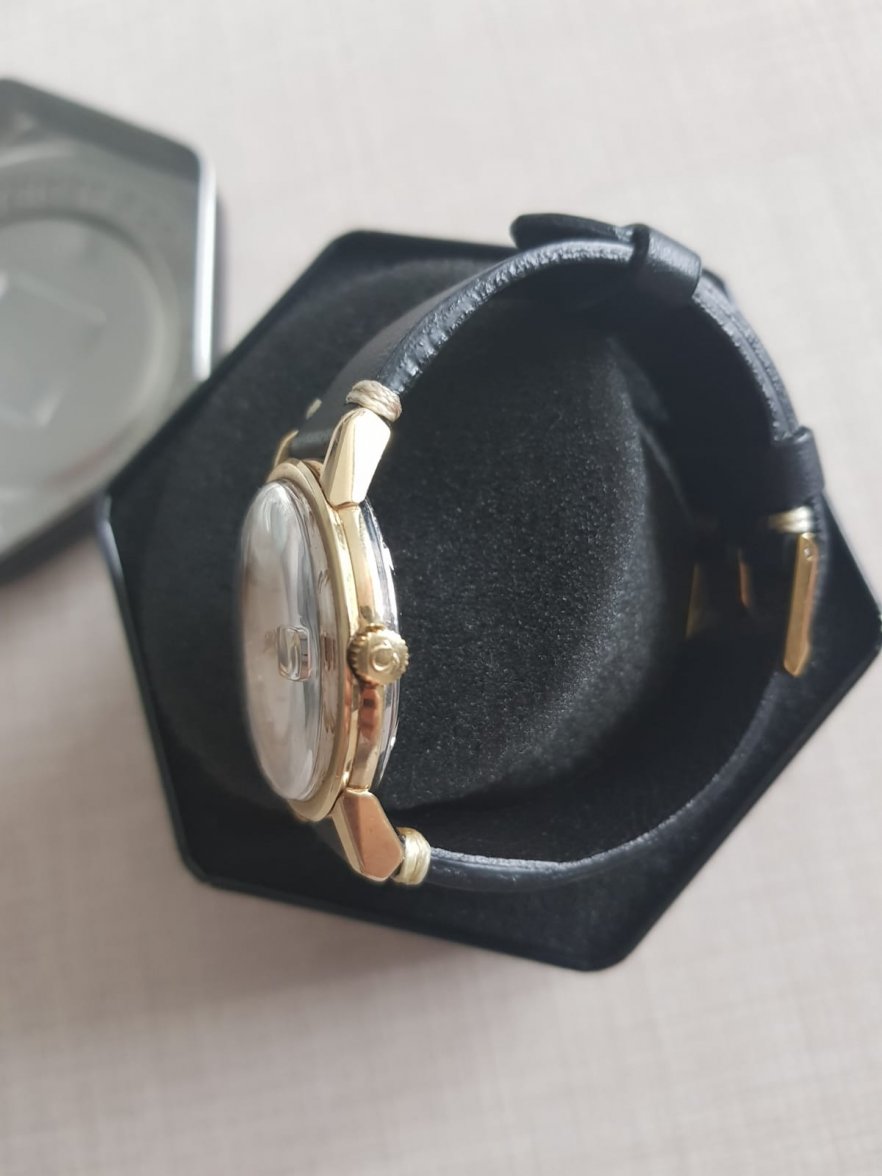

The watch looks legit and appears to be in good shape.
You should ask if the movement has been serviced.

To sum it up (as I understandt it)
You are looking for a gold capped Seamaster watch with exact this case as shown above.
The reference 166.003 may either be stainless steel or cold capped but the case will always look like the OP speciem.
It may have a 562 or a 565 movement and different hands.
IMO the reference number is not rare in SS but more rare than other Seamasters. The gold capped ones are clearly in the minority.
1000 USD for the OP watch is much money, if its too much this depends on you.
As pointed out already the watch looks legit and in good overall condition, concerning the exterior (dial, hands, case)
Please ask the seller for a picture of the movment and ask him about its service history.
Than come back to discuss that here.
My 2 cents 😀
My 2 cents 😀

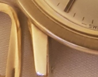

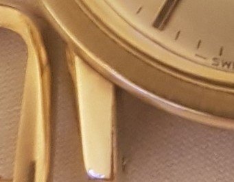

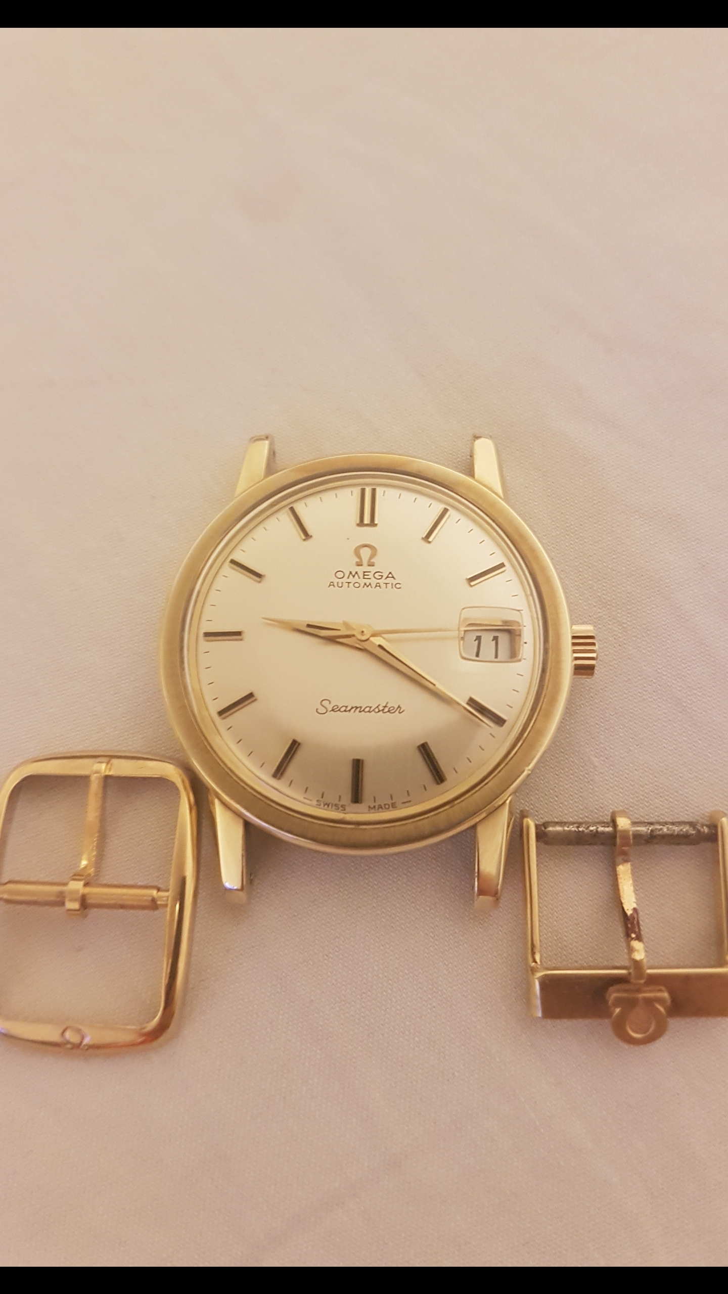

I agree, apart possibly from the "good overall condition", as I believe there is some evidence of the gold cap having been polished through...

ok I understand thank you for the answers, I will go to the watchmaker to remove the watch lid for some pictures, from what I saw when he presented it looks well maintained and had no service done.
Rechecked the case and you are right:
That is absolutely not acceptable for a 1000USD watch!
14
I assure you that this is just the light bulb reflection in the room.
2,086
2,899
How do you know this?

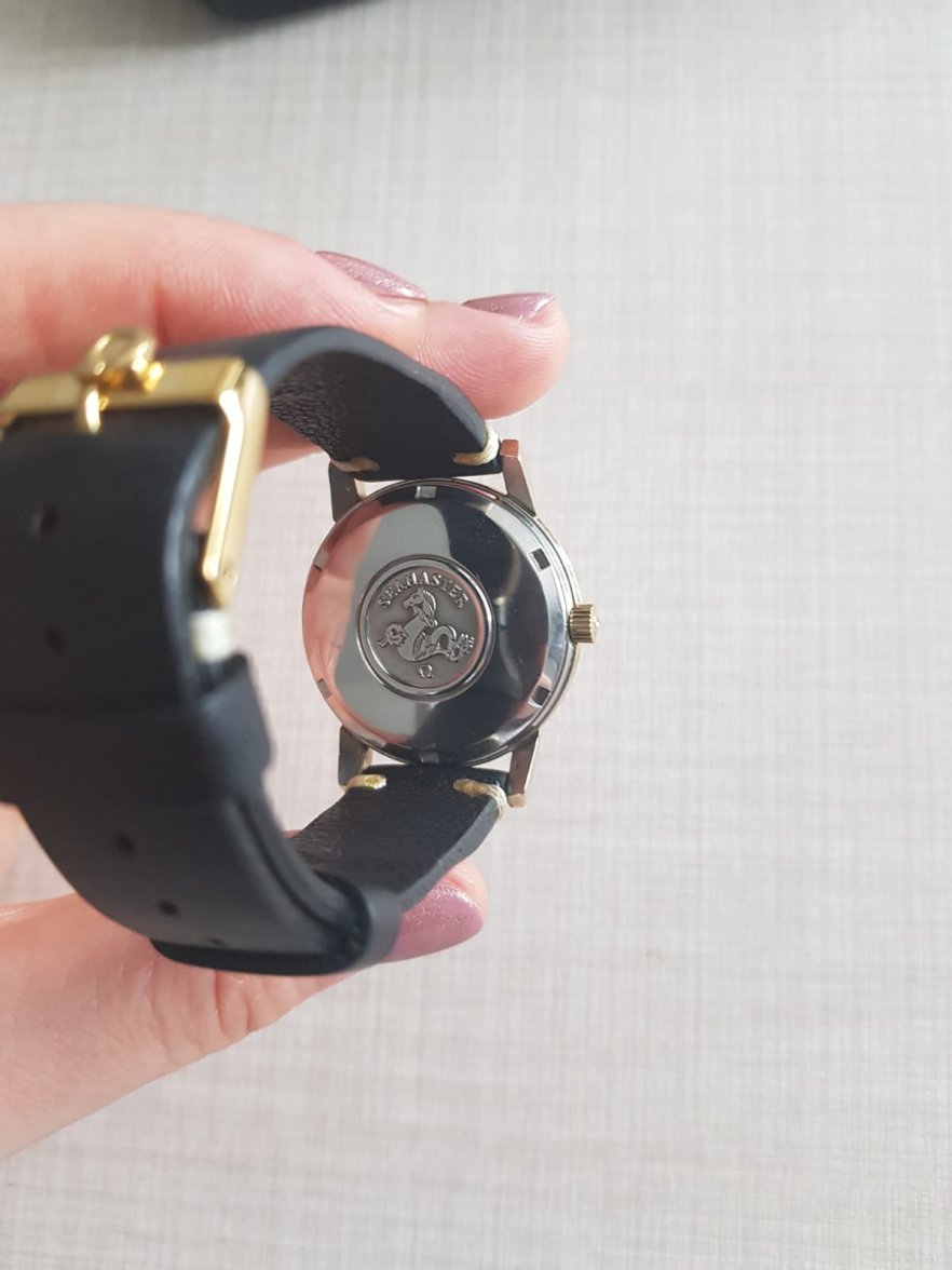

All of the pictures are WA pics, except this with the light bulb reflection, which is a screenshot, judging by the image names.
2,086
2,899
I assume, because he took the photo.
These are WA pics and a screenshot and "he" has a wonderful nail polish...
