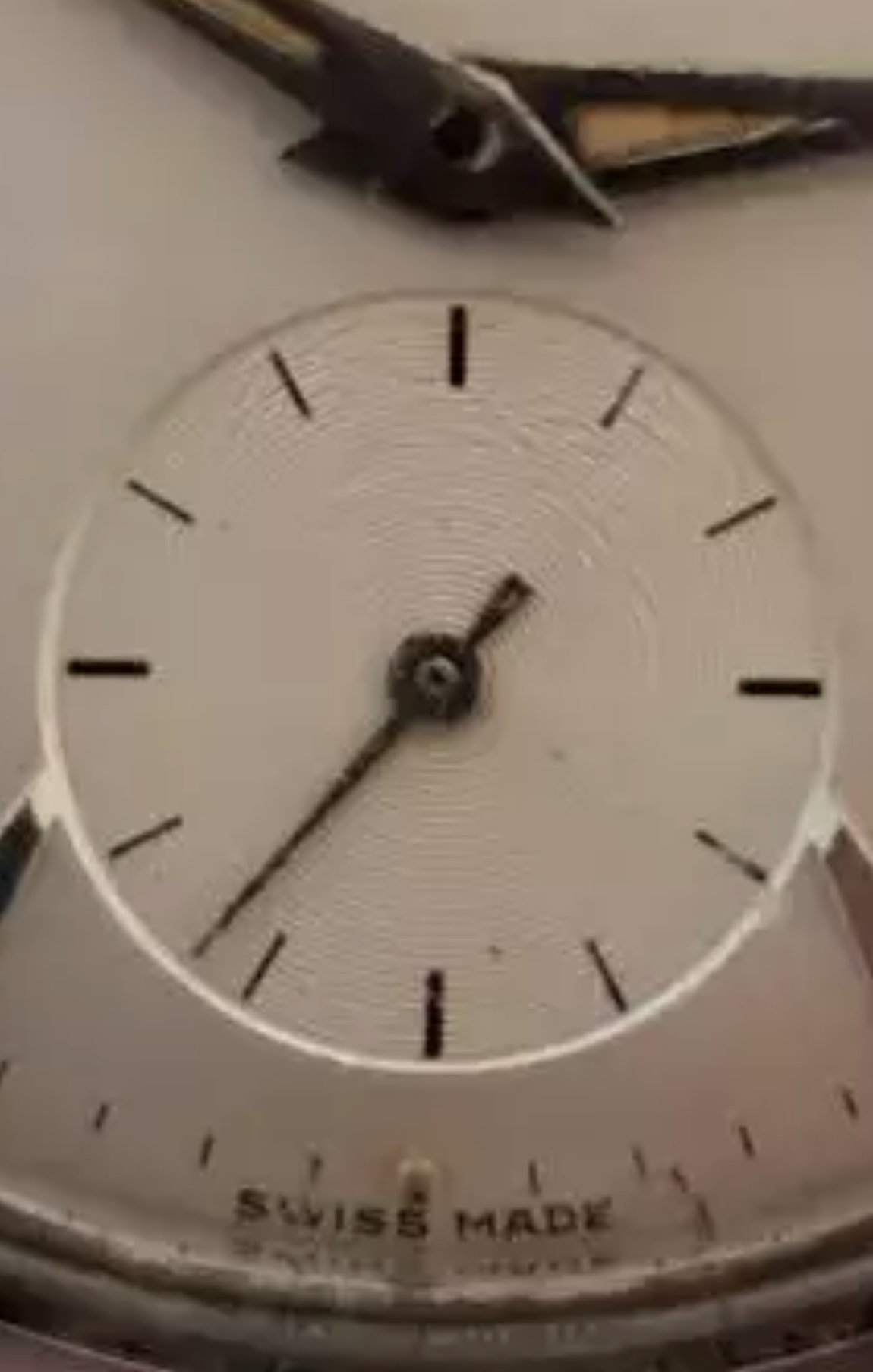

The dial has been refinished. Here is a close up of the sub seconds dial:
You can see where the guilloche lines from the original are partially filled with a second coat of paint.
