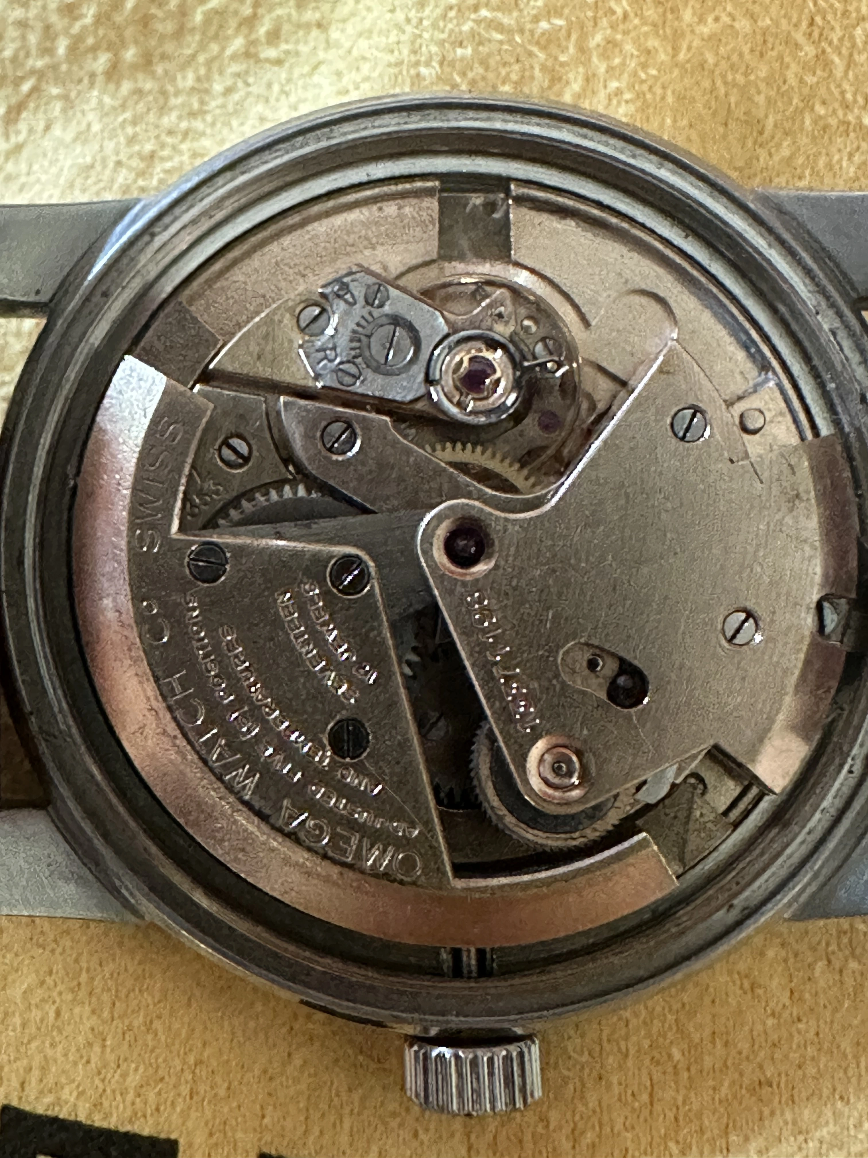

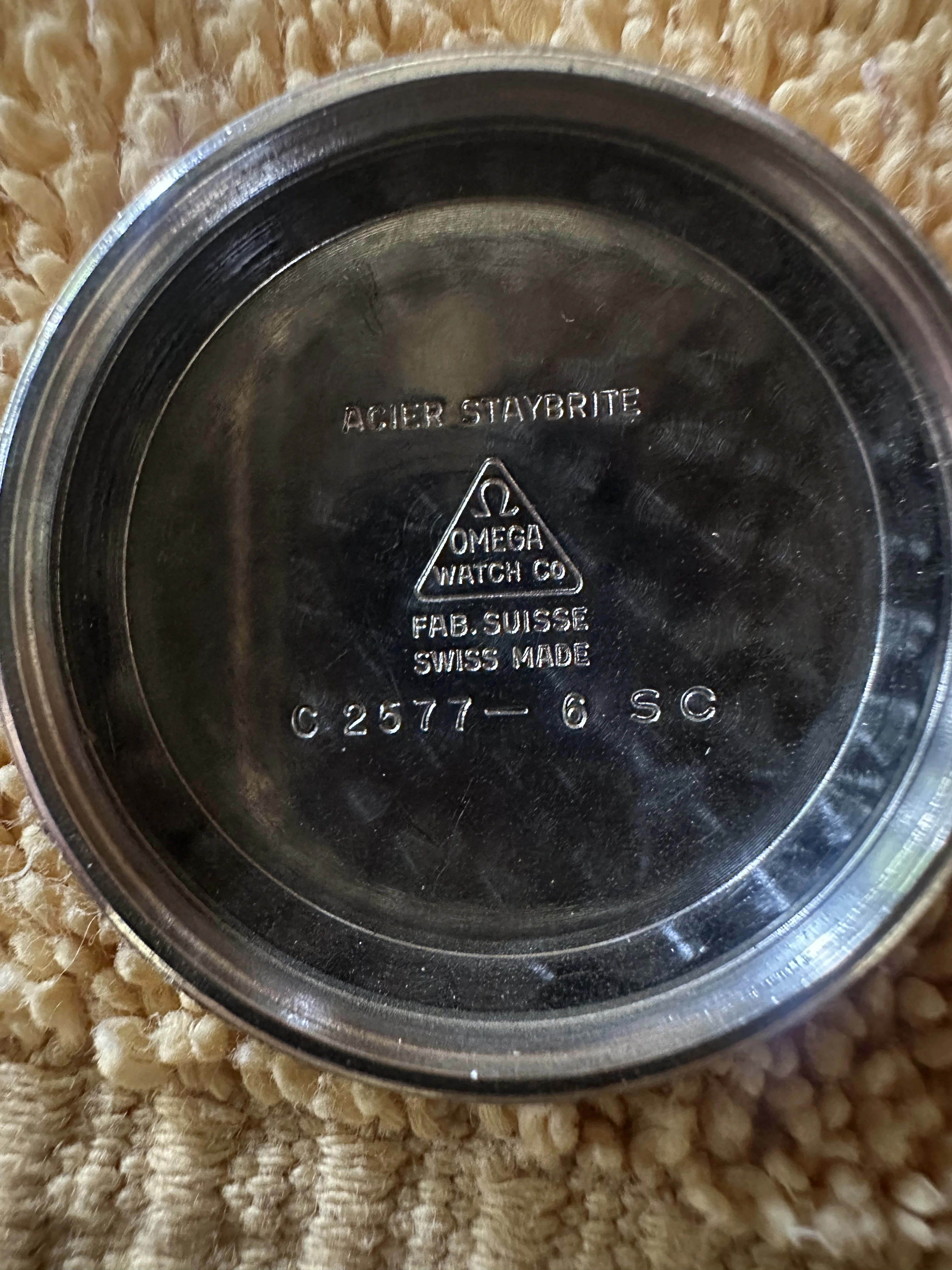

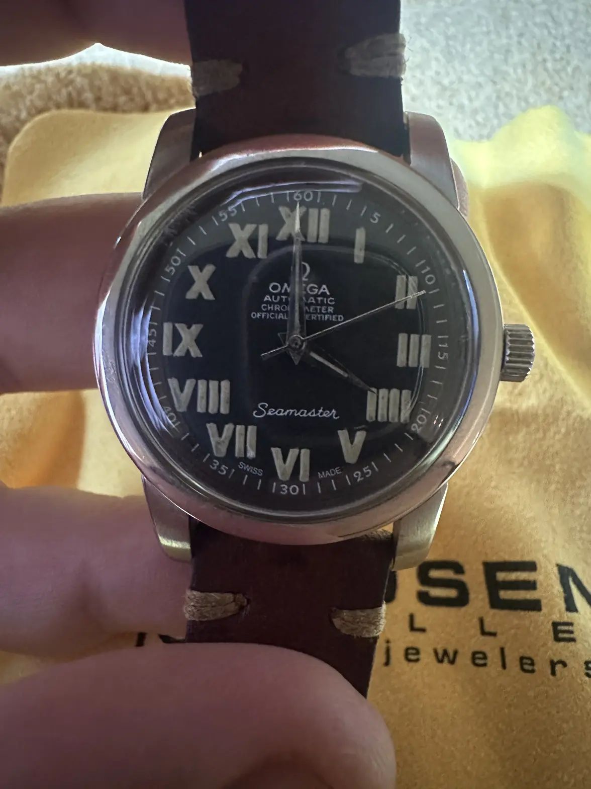

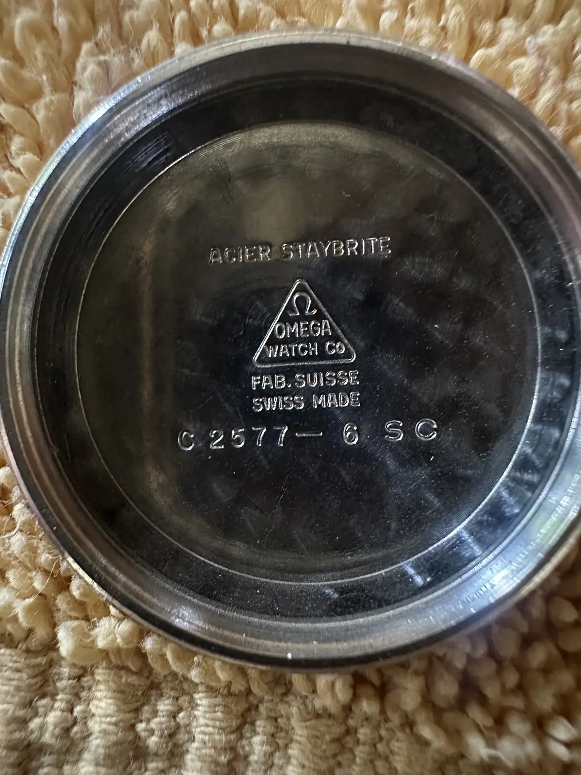

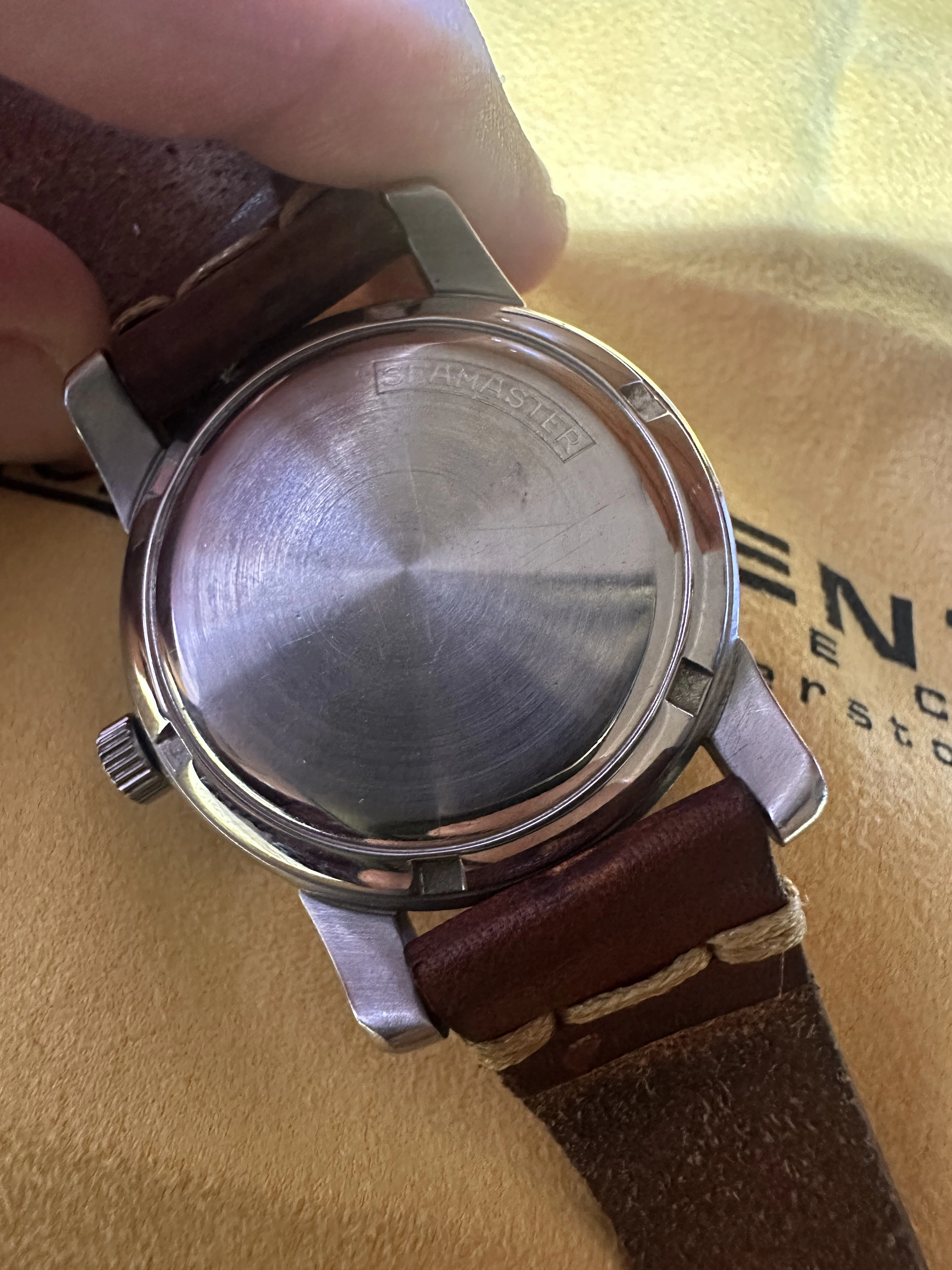

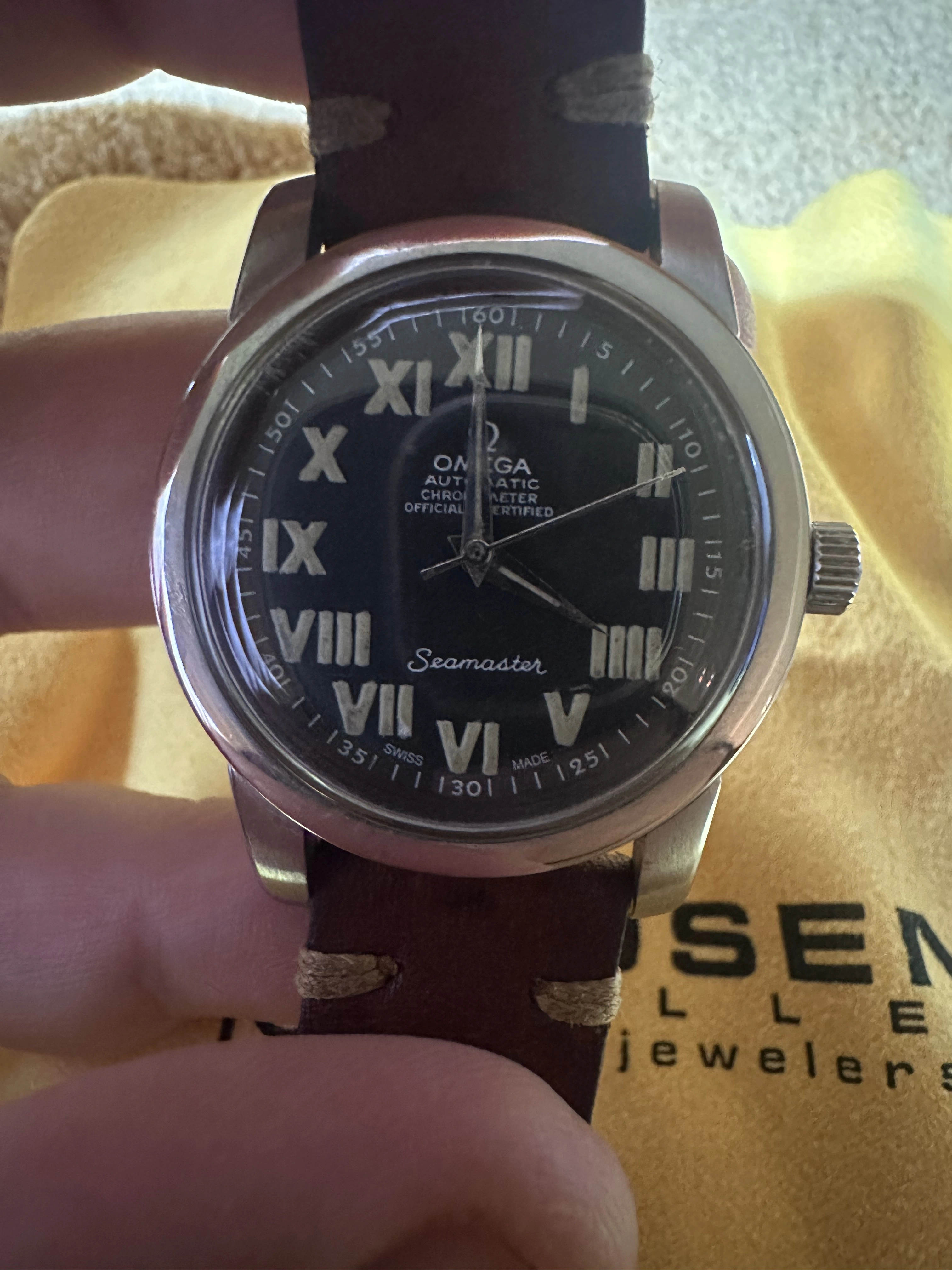

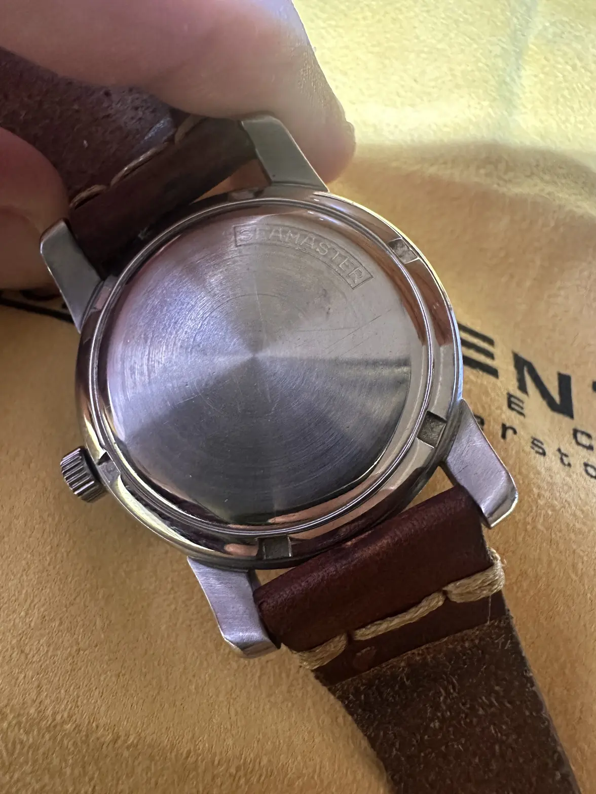

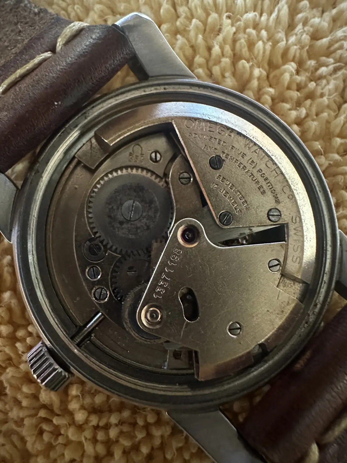

Hey all, I purchased this omega seamaster a few years ago off eBay. I was (still am) a novice and the listing said it was a 353 bumper auto. I can confirm that’s true after opening it up and taking a look. What I need help with is the dial. Is it period accurate or a franken-watch?
10,662
16,631
Well the good news it is a rare chronometer spec 2577. The bad news is the dial is most certainly not original. When you have seen a few Omega's this will become blatantly obvious, but as a big tell, when this watch was made, around 1952-53, Omega spelled Chronometer on dials the French way ie as Chronometre. This was the case up until around 1958, long after this model stopped production.

Well the good news it is a rare chronometer spec 2577. The bad news is the dial is most certainly not original. When you have seen a few Omega's this will become blatantly obvious, but as a big tell, when this watch was made, around 1950-51, Omega spelled Chronometer on dials the French way ie as Chronometre.
Any idea what the value would be, noting that the dial most likely isnt authentic?

Typically redials are worth the sum of the parts or so to a collector. IF you find someone unknowledgable & greedy for a deal, you could perhaps get a little more. But to an informed person, this is about $300-$400 or so. A few hundred for a good movement, maybe a bit for a good case.

Super helpful. I paid like $650 in 2020... eek. Oh well, i bought it because i liked the look of it and i still do. Thanks for the helpful info.
Sorry to contradict. Ref 2577 should not have a cal. 353 in it - rather a 354 or even better a 352.
Besides this cal 353 is not a chronometre nor does it have a RG regulator like the 352, only a simple regulator - RG is wrong here.
Further cal. 353 should have a date which is obviously missing.
This watch is a dog, assembled from parts of different watches - it is not only the wrongly reprinted dial...

Hmm I should have checked Ranfft I guess. I got target fixated with the dial.

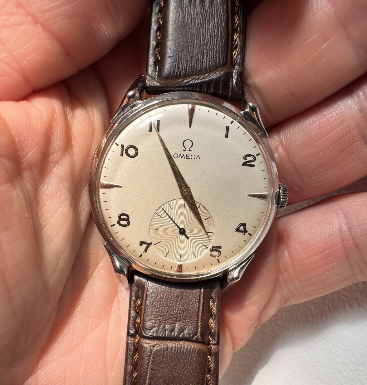

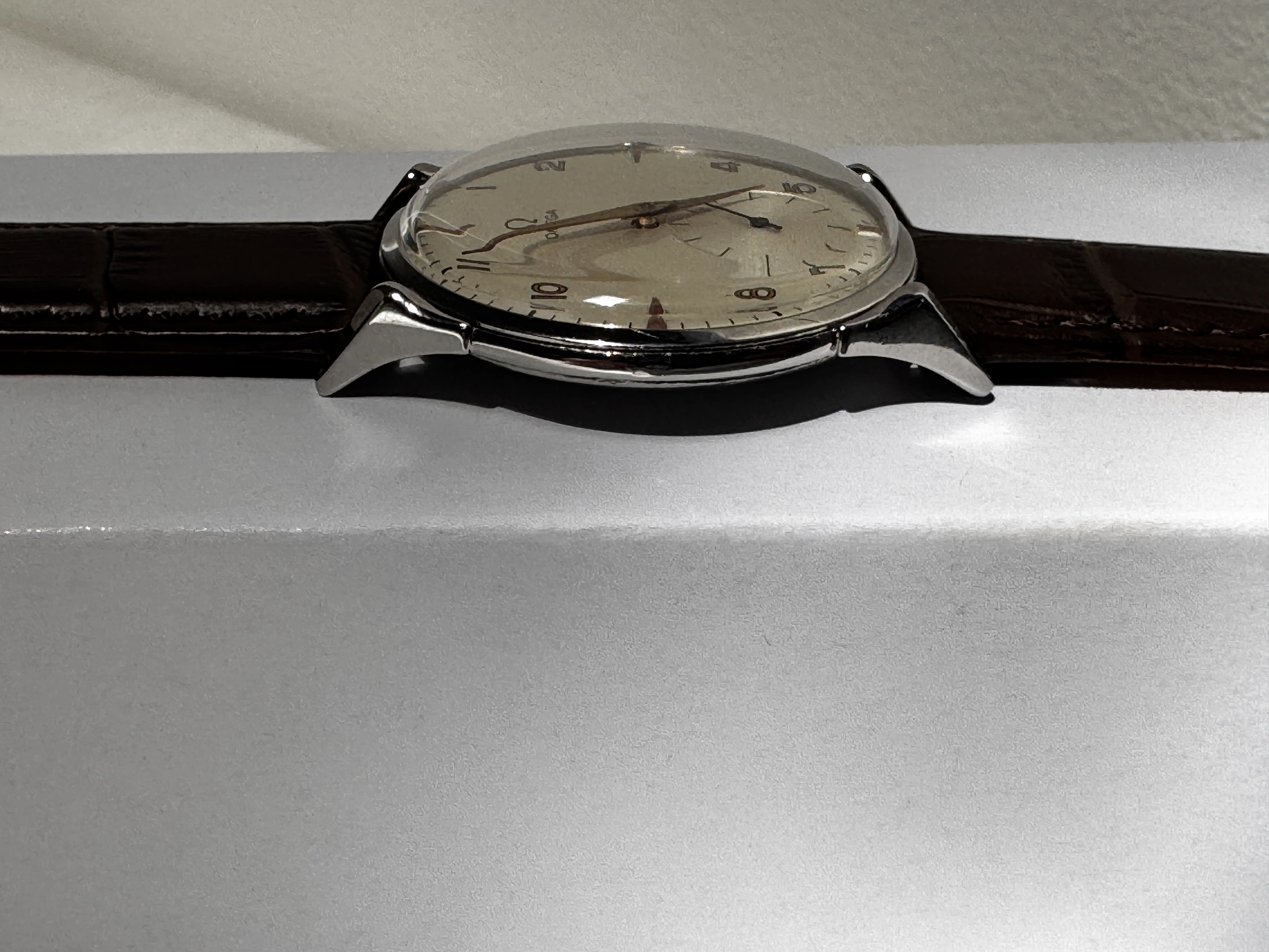

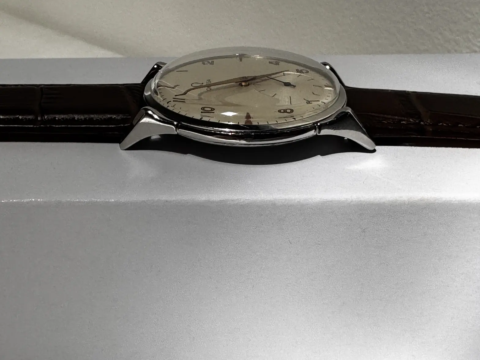

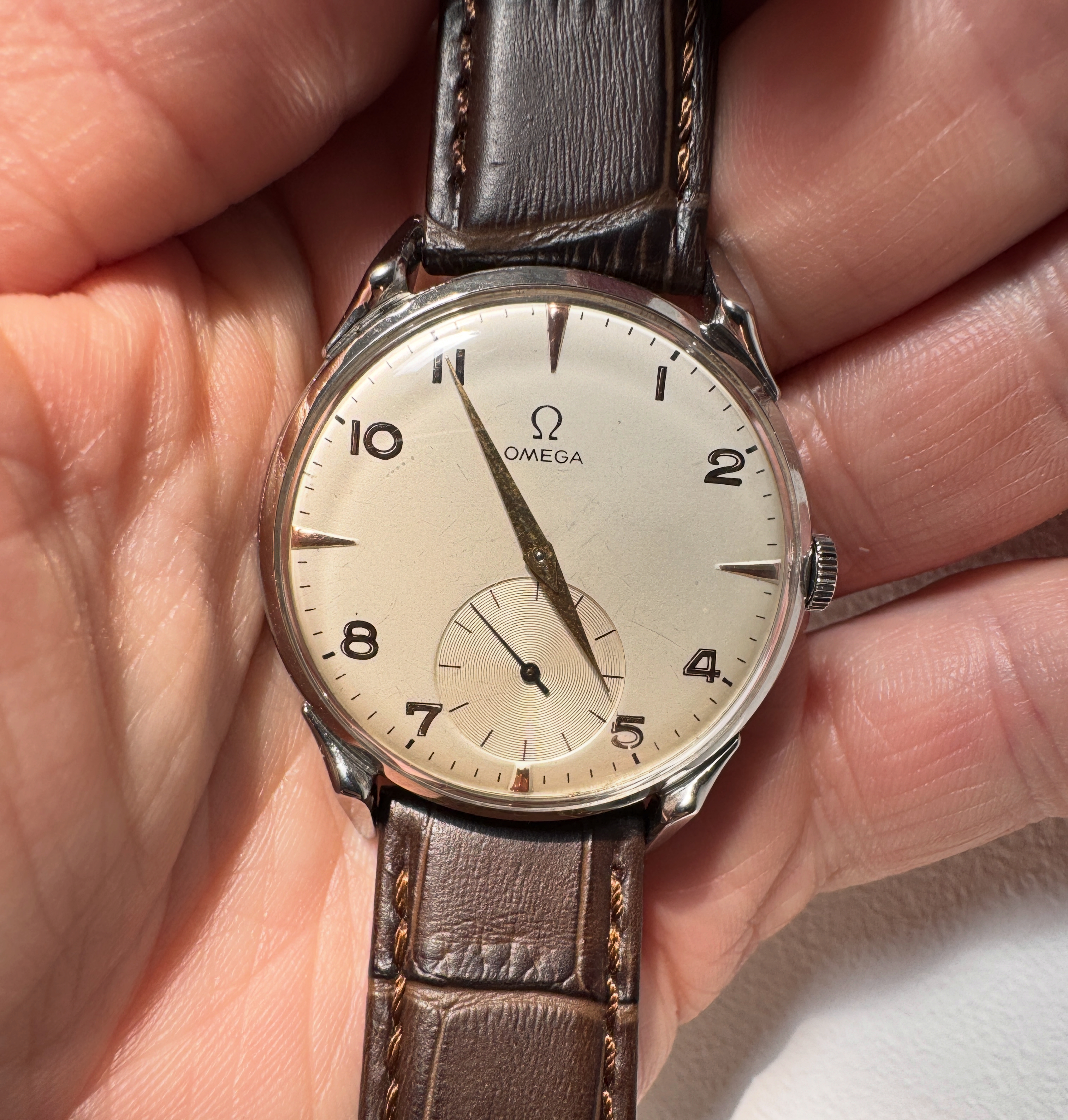

I’m considering buying this 2603-2 Jumbo Spider Lugs but can’t seem to find the same dial reference anywhere.
I know it a redial because it was mentioned by the watchmaker, but it’s still a really great looking watch..
Any help or comments will be greatly appreciated.
