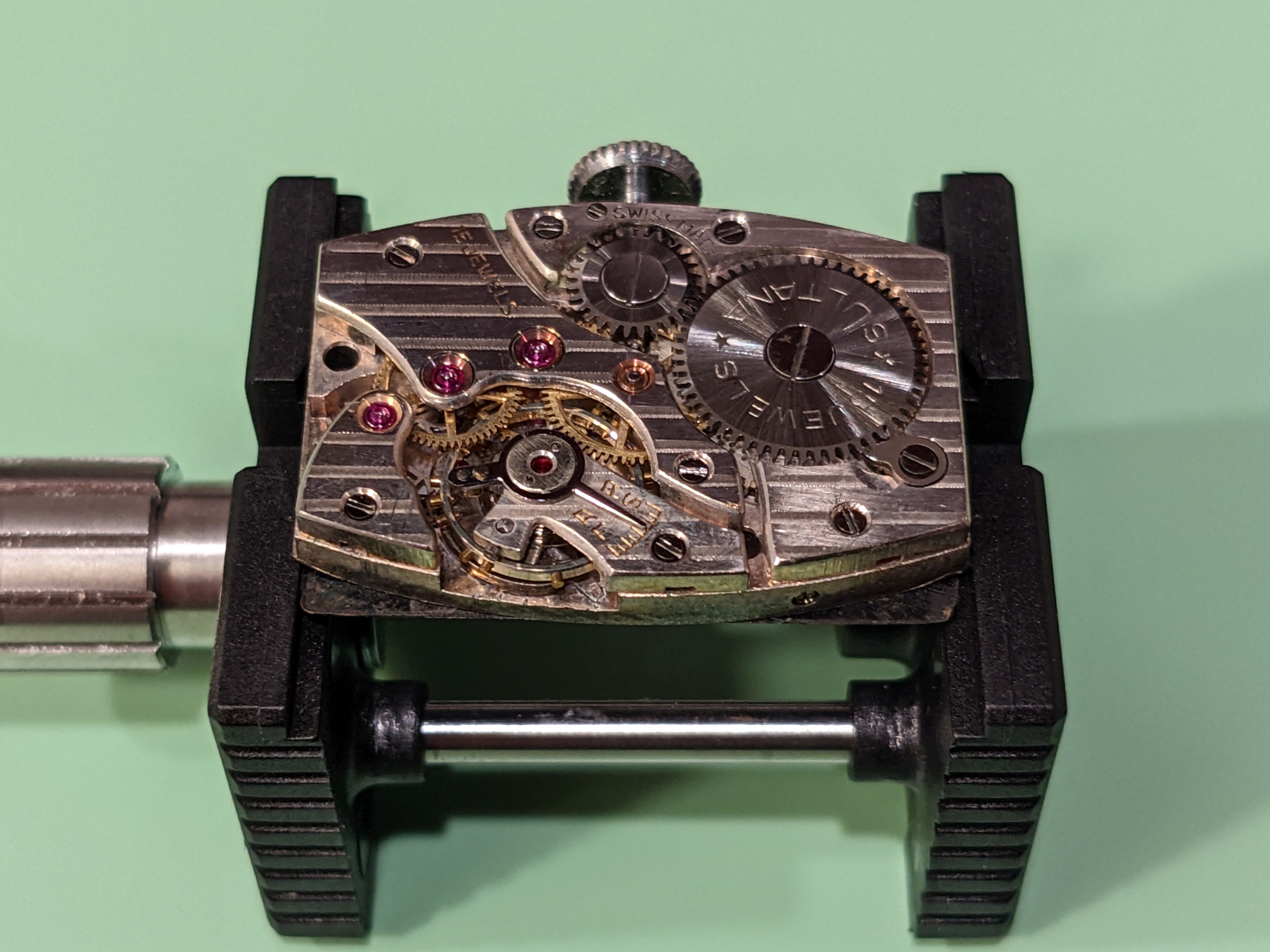

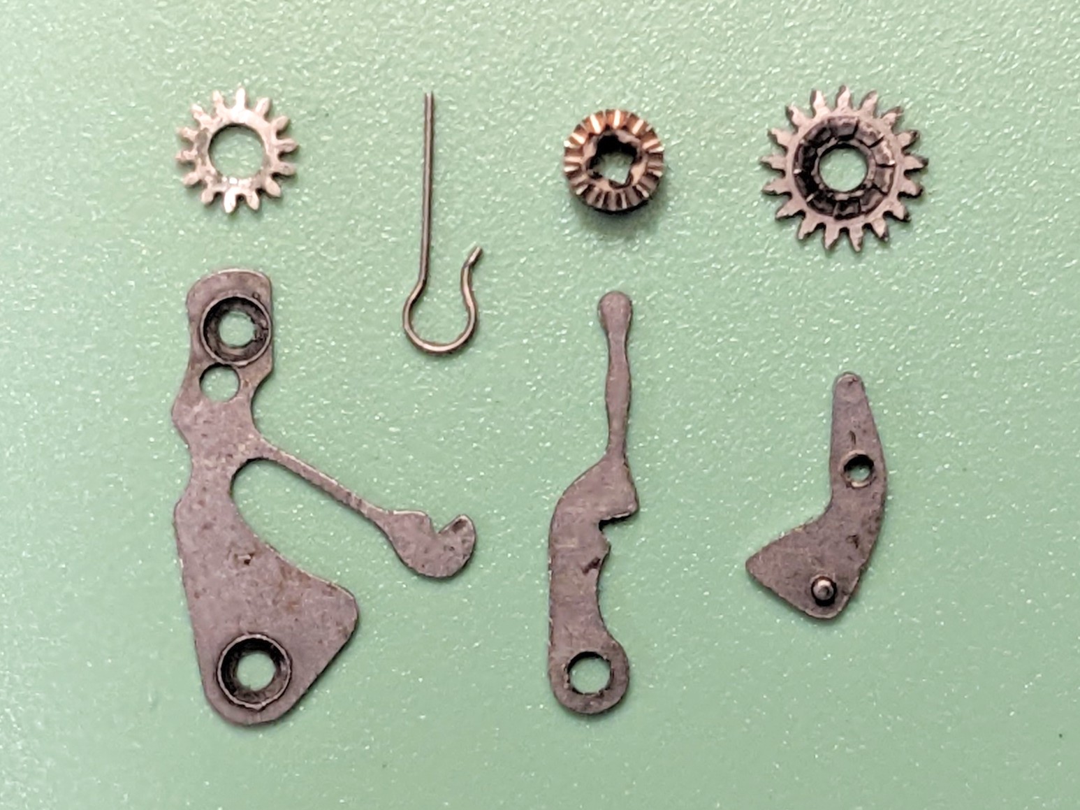

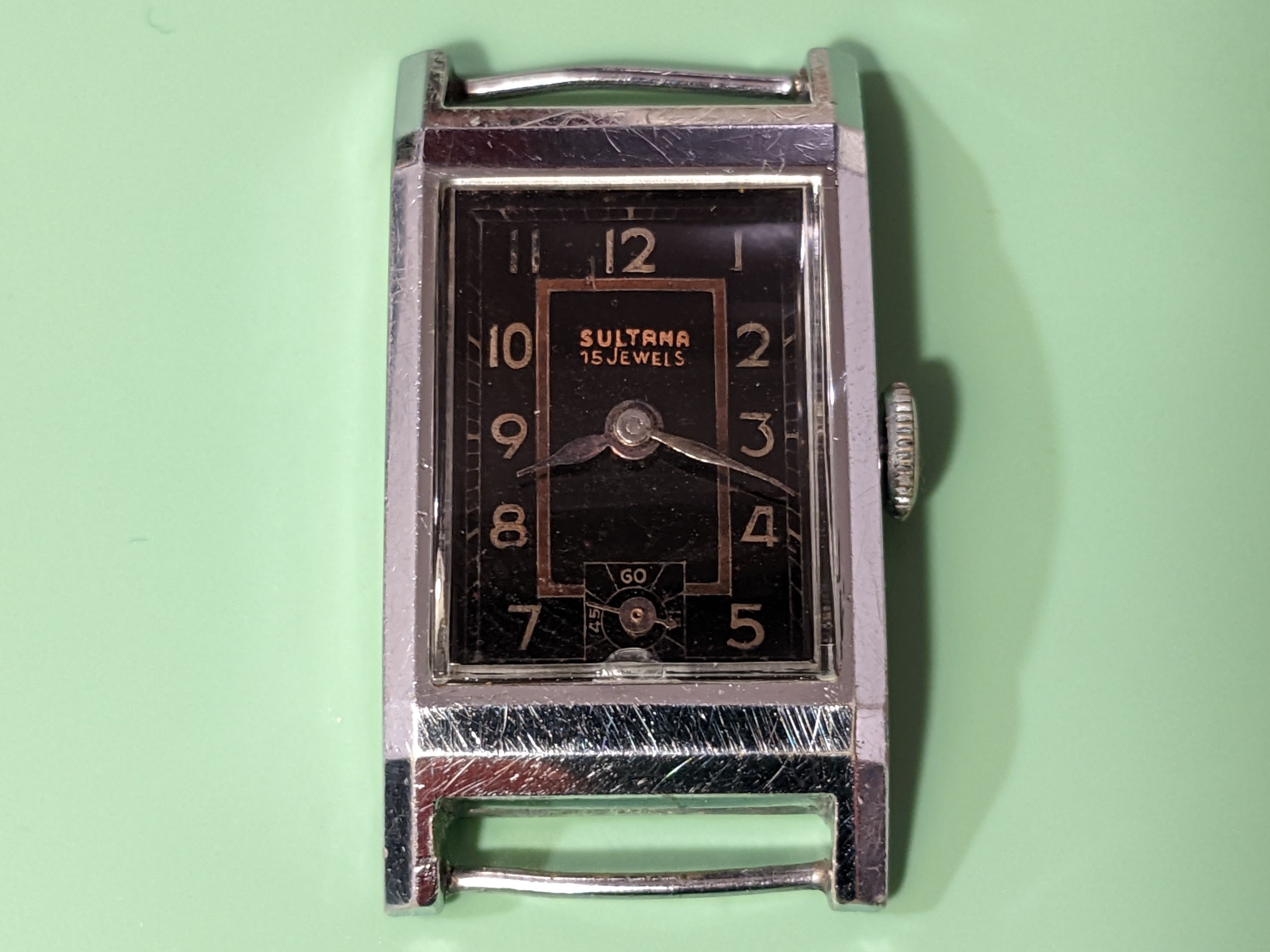

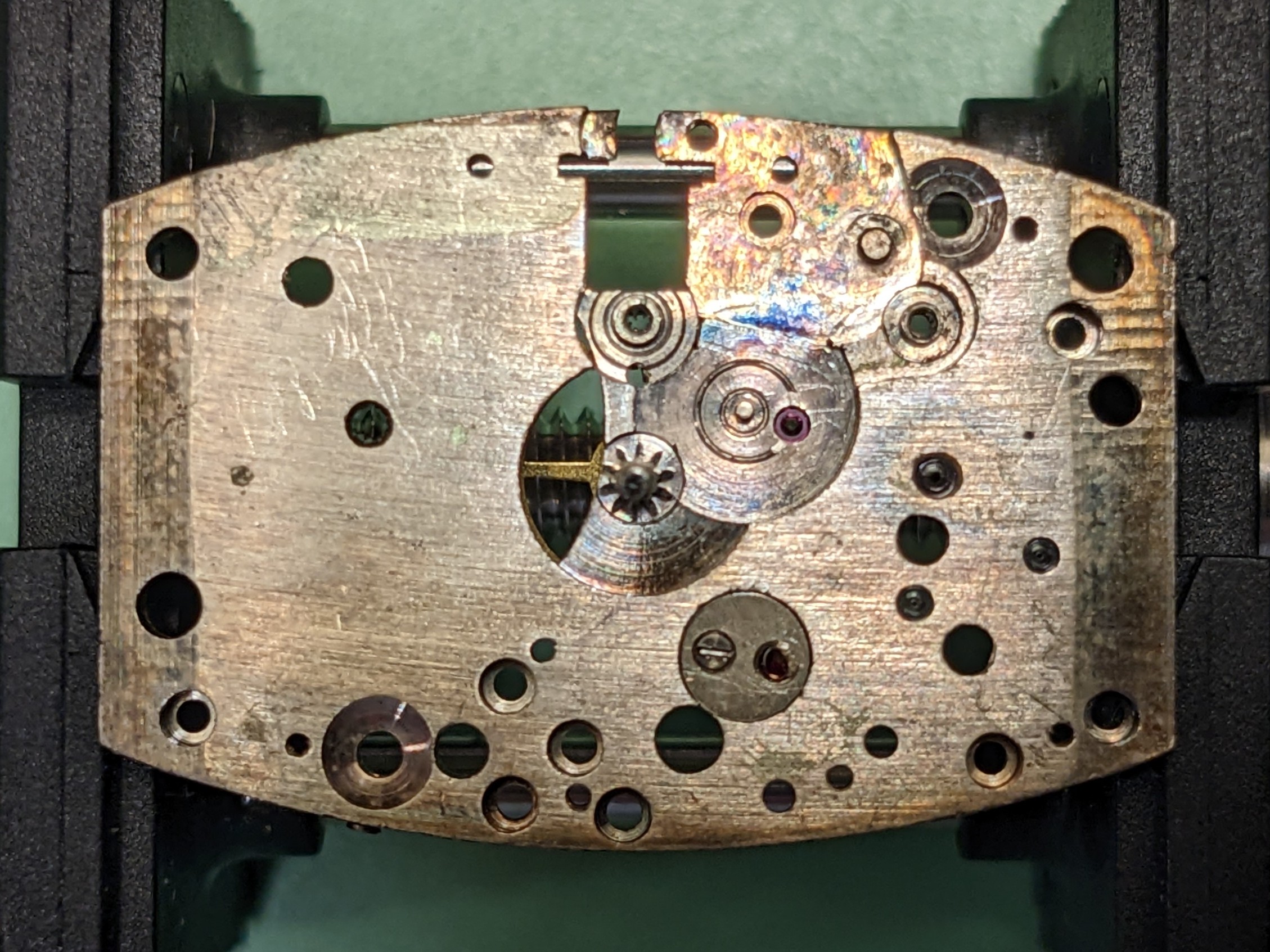

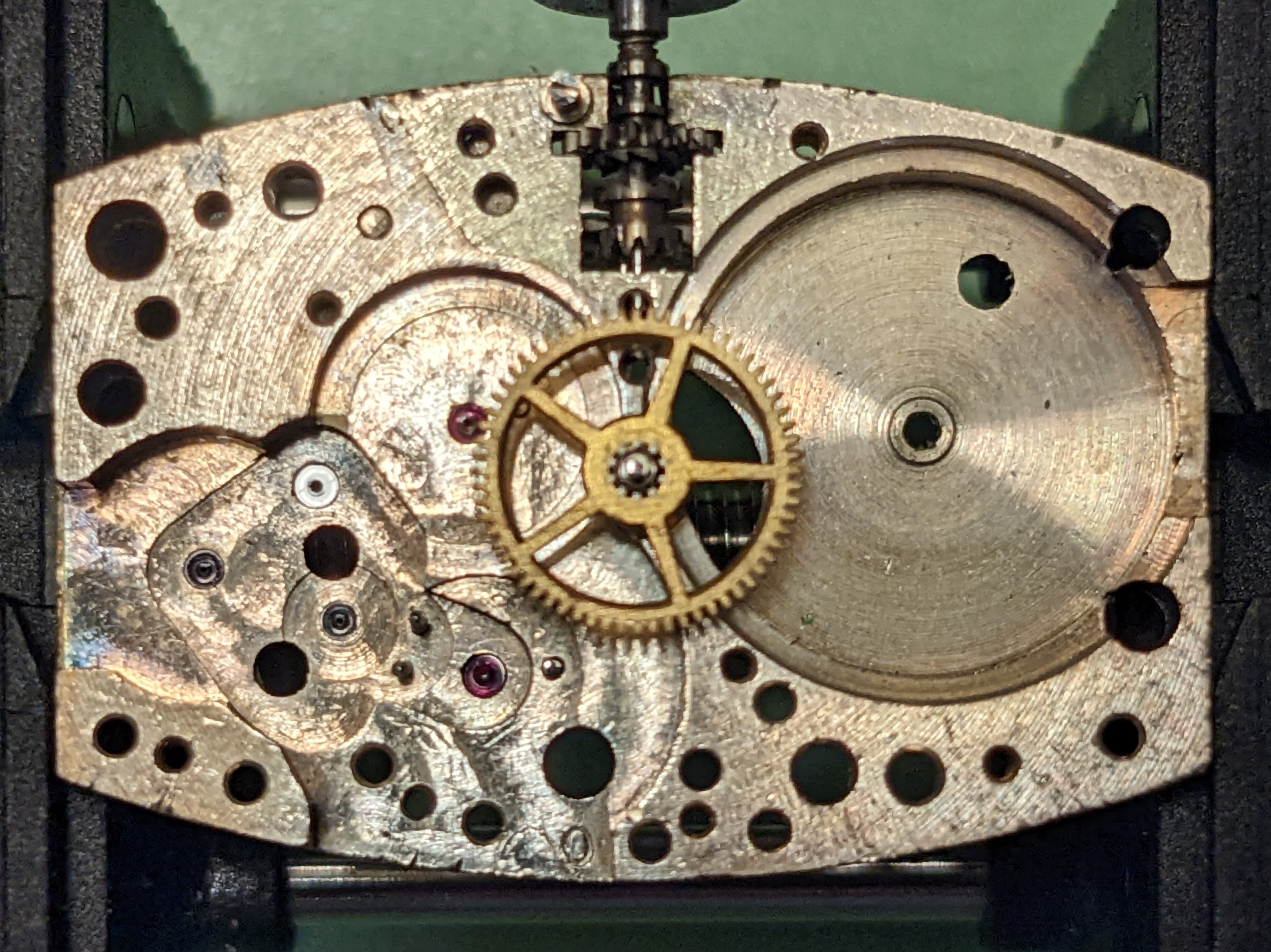

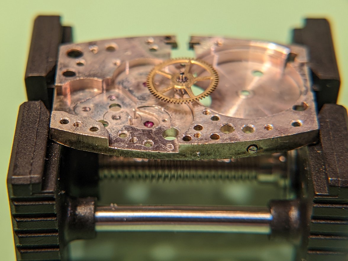

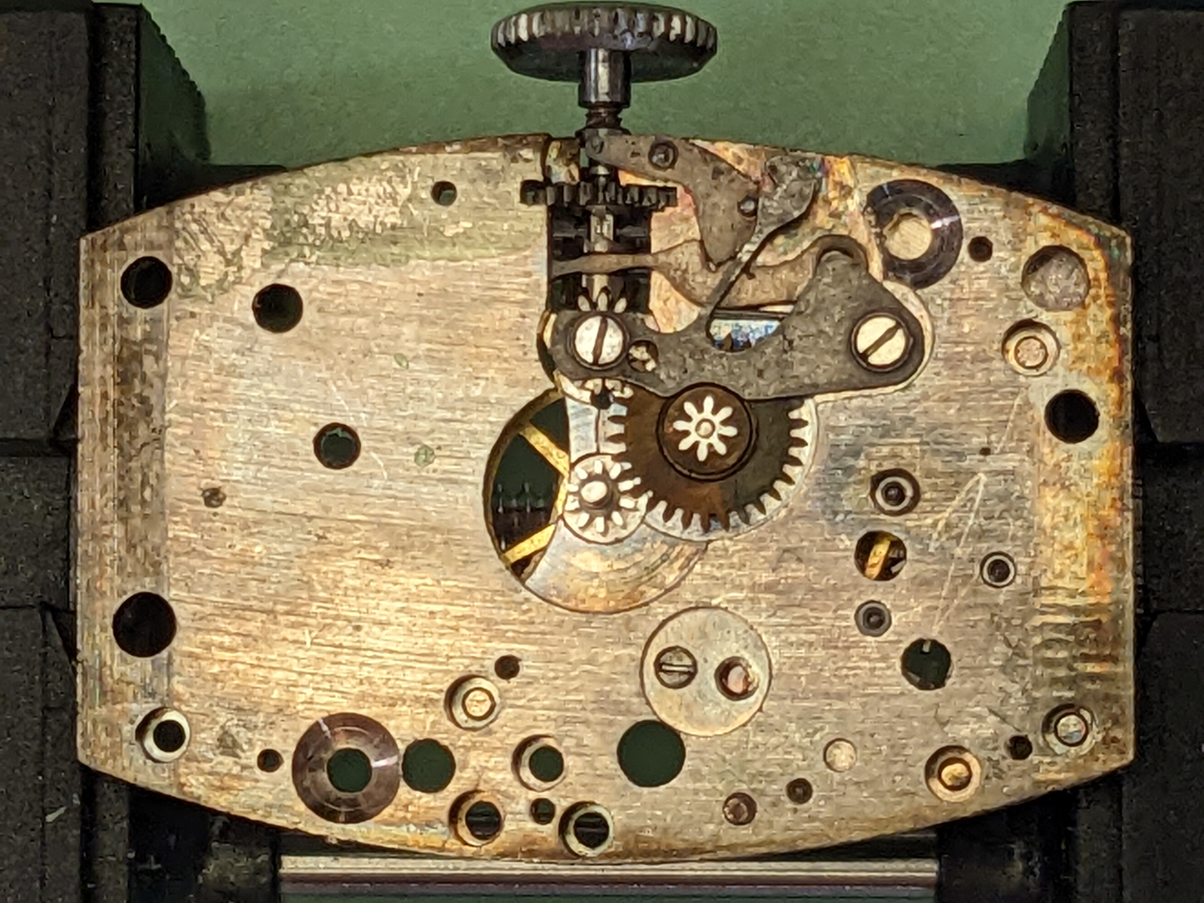

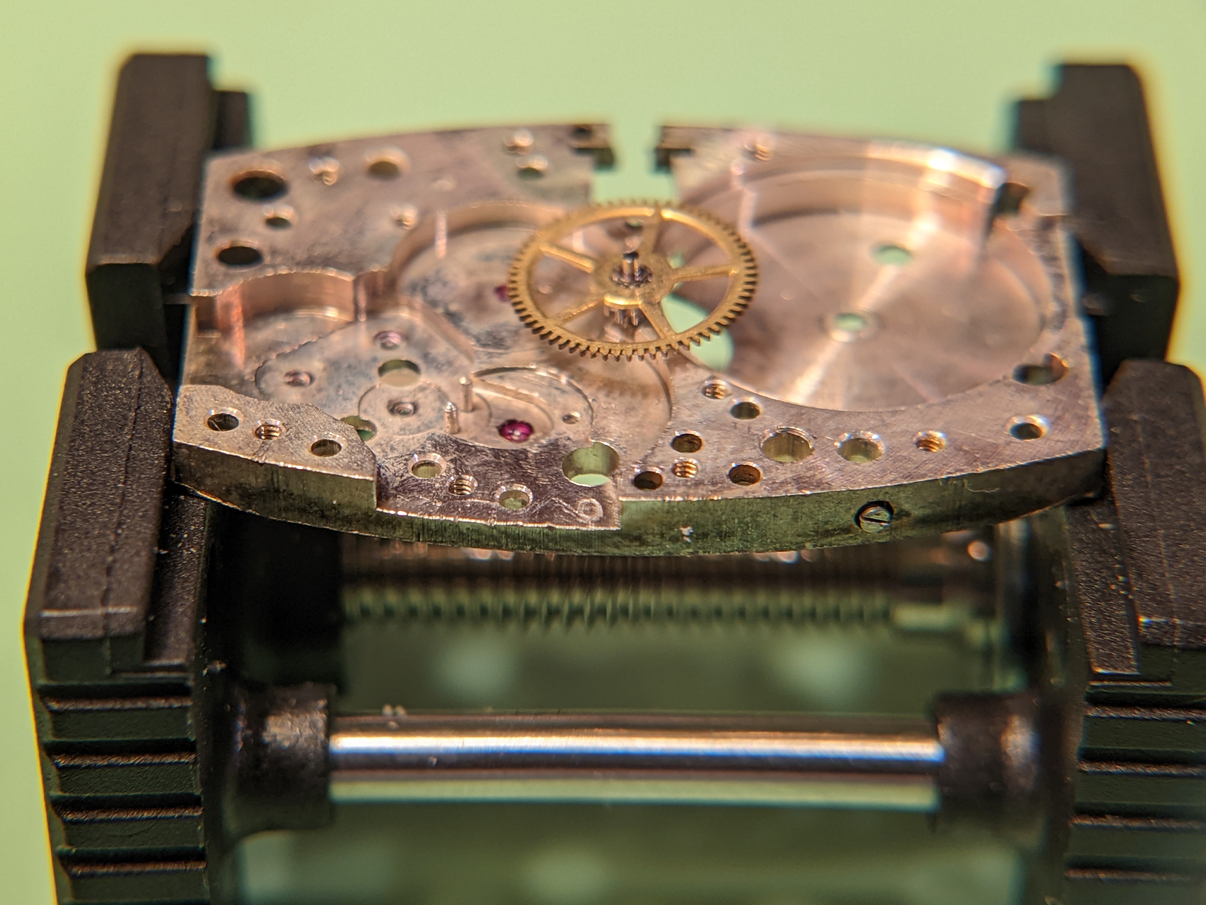

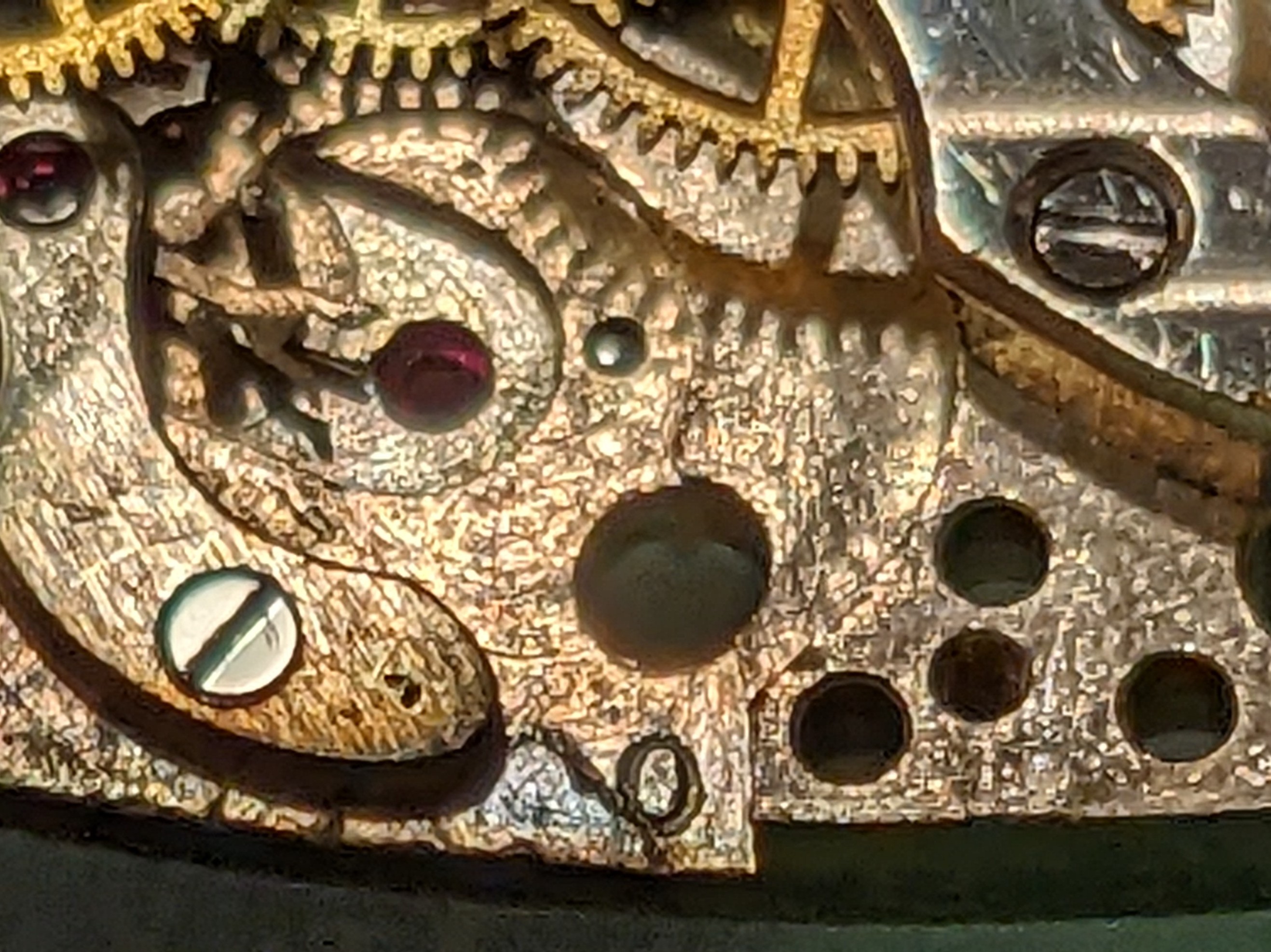

    Anyone recognize the movement in this little Sultana wristwatch? The only mark on the main plate I can make out is a zero, six or nine. The more I look at it, the more it looks like a stamped zero with a tangential scratch. 15 jewels, circa 1935, the movement measures 25.2 mm x 17.4 mm.
    Searched through Ranfft for 7-3/4 x 11 L movements but couldn't find a match for this setting spring. My best lead from Ranfft is that Revue fastened their setting lever springs through the intermediate wheel.
    Thanks in advance!

  2. Canuck Oct 8, 2022
    13,442
    37,869
    I checked four BestfIt fingerprint catalogs, and nothing matches.

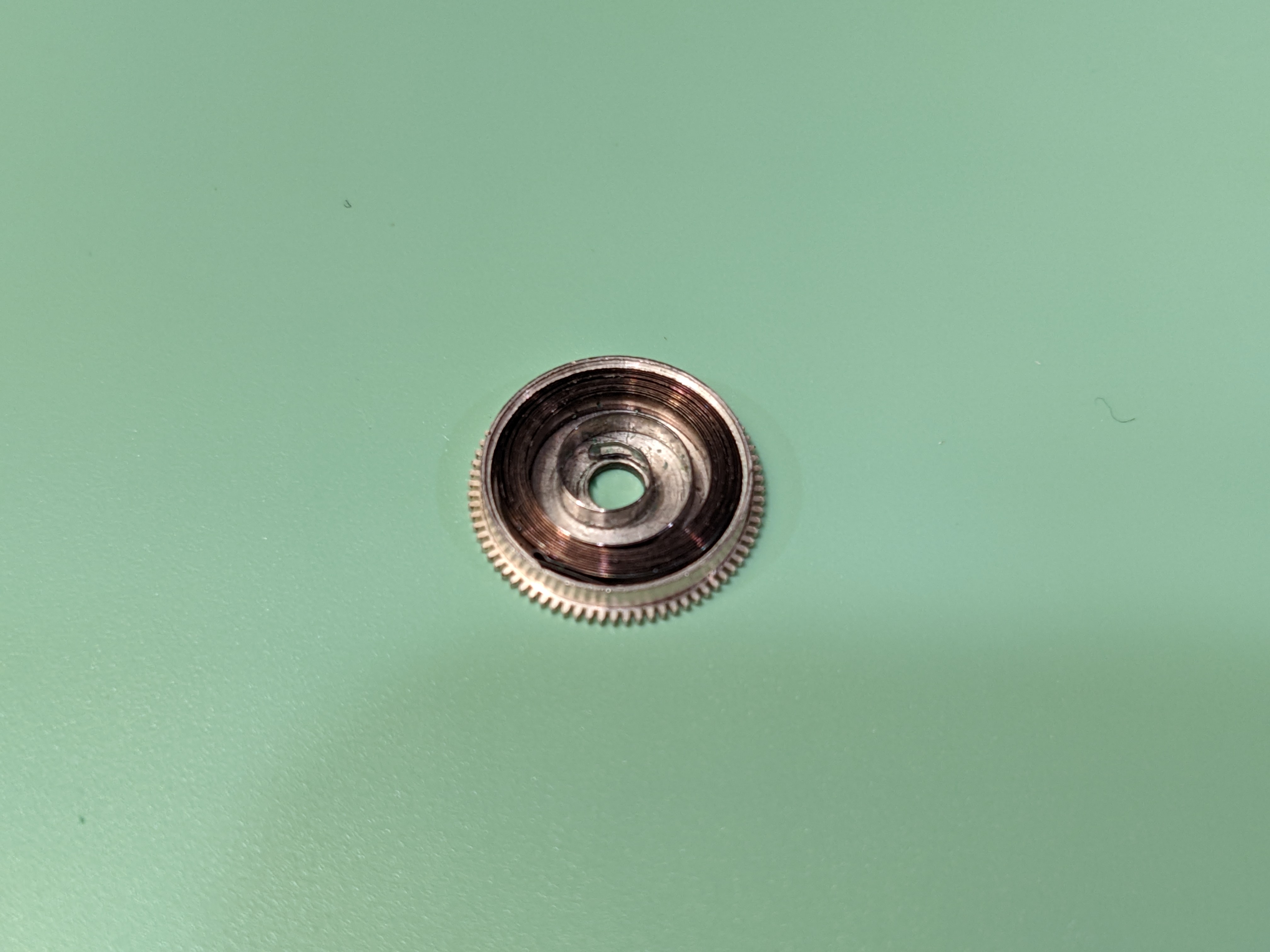

  6. sleepyastronaut Oct 8, 2022
    963
    1,228
    Thank you for checking, Canuck.

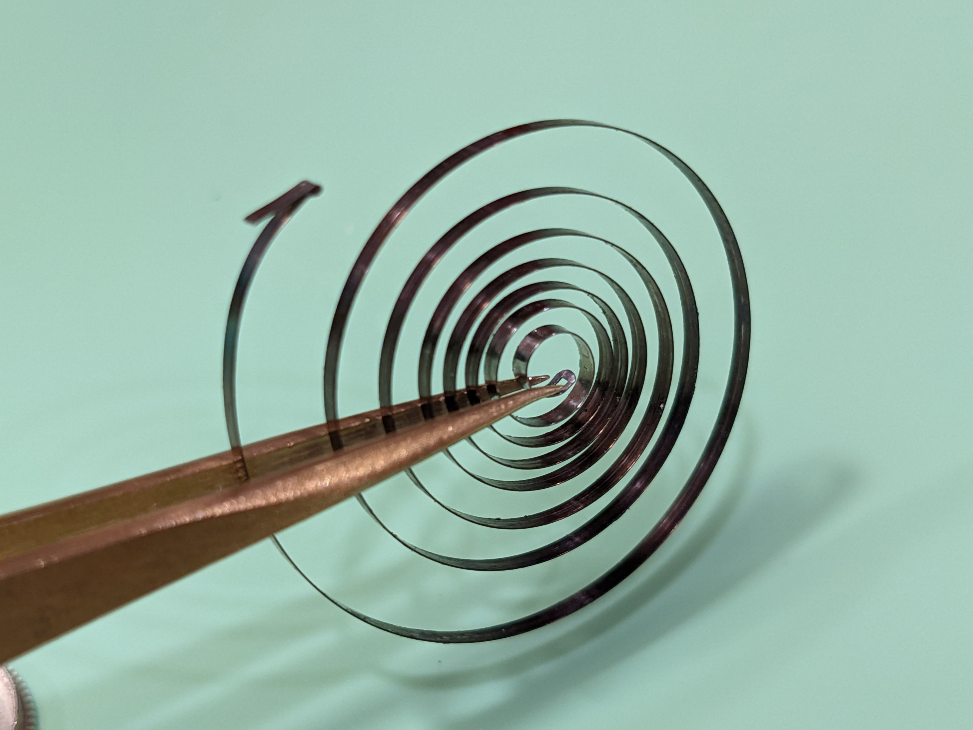

    Was hoping a base caliber would give me a part number for an alloy mainspring. I'm reluctant to reinstall this carbon steel spring.
  7. sheepdoll Oct 9, 2022
    1,798
    2,958
    You should be able to measure the spring and barrel. I think there is a guide in the bestfit catalog. There are two scales used, dennison and metric. Probably easiest to use metric.
    The calculation is fairly simple. A lot of watchmakers did not trust the ready fit springs, so this was sort of a basic skill.
  8. JimInOz Melbourne Australia Oct 9, 2022
    15,458
    32,291
    I went through my Paulsons catalogue from 1950 but nothing identical. Many similar (ETA 735/757 etc) but slight differences ruled them out.
    Shouldn't be too hard to measure up the original and get a GR replacement.
