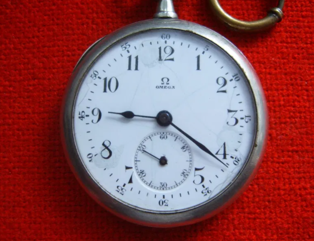

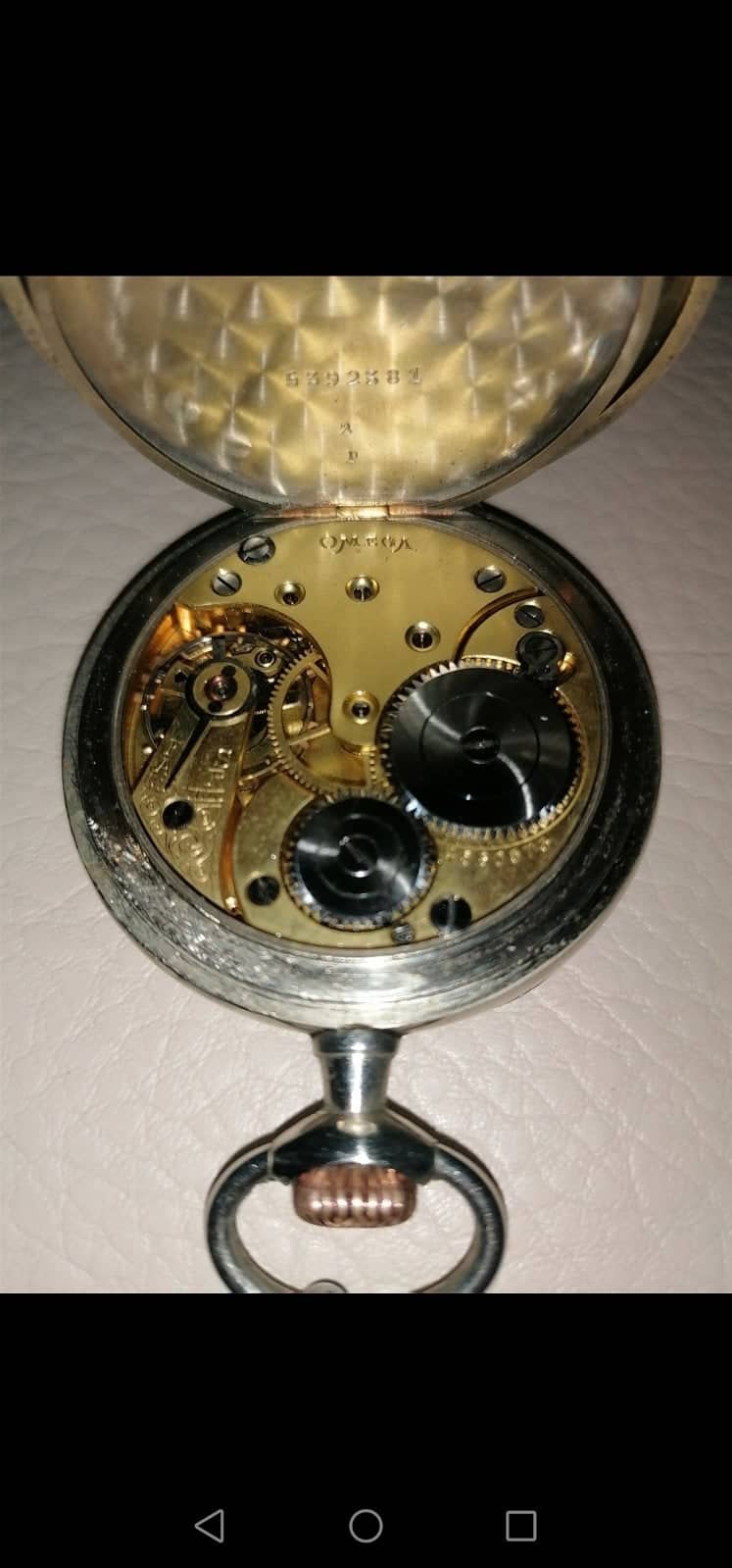

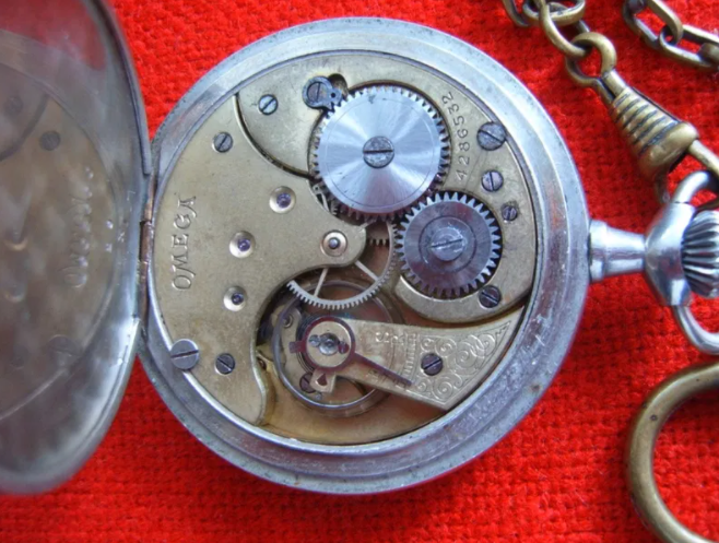

Greetings,
As I posted several days ago, I'm on the verge of buying a vintage watch.
Please, help me to confirm based on the photos if the watch is authentic.
Thanks.
6,900
10,764
Looks legit but the dial is not that good. But if it still floats your boat...

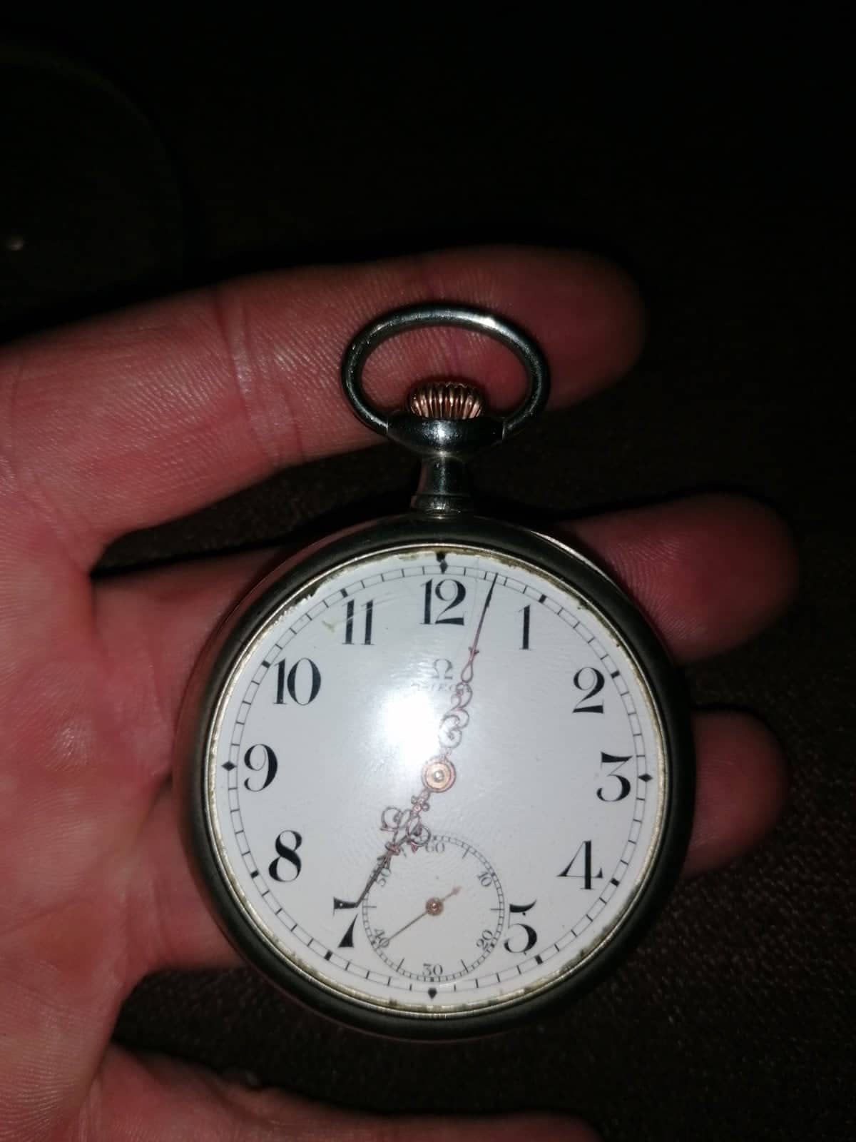

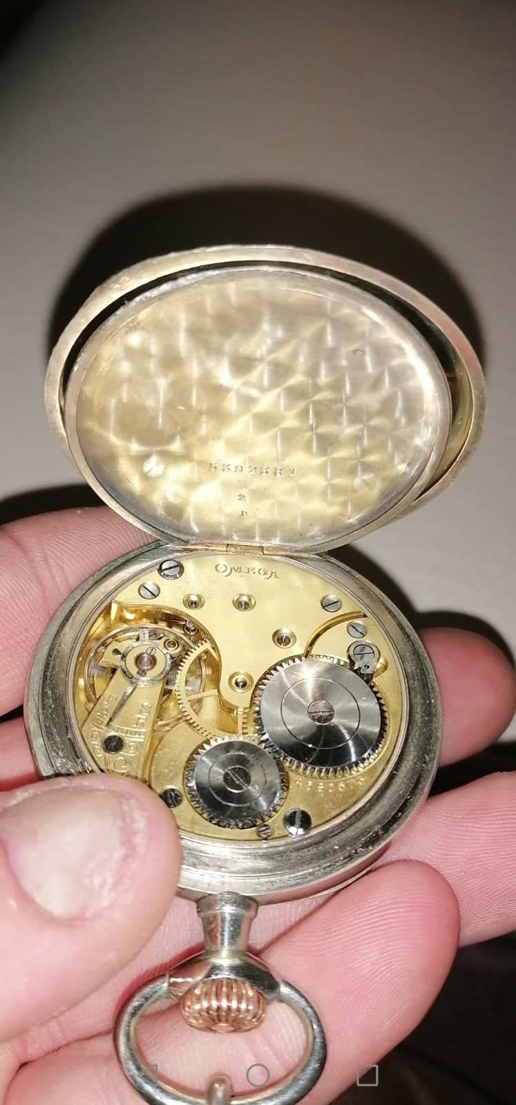

How about this one? The dial isn't great again. Legit?
363
1,277
I am not that deep into pocket watches but the movement seems legit to me (the movement of the other pocket watch seemed to be in better condition) - as you noticed the dial isn`t in best shape.
According to the serialnumber the watch should be more than 100 years old. (somewhen between 1912 - 1916)
11
17
This is what the owner says - it has been produced in 1912 😀 Checking if he's right.
