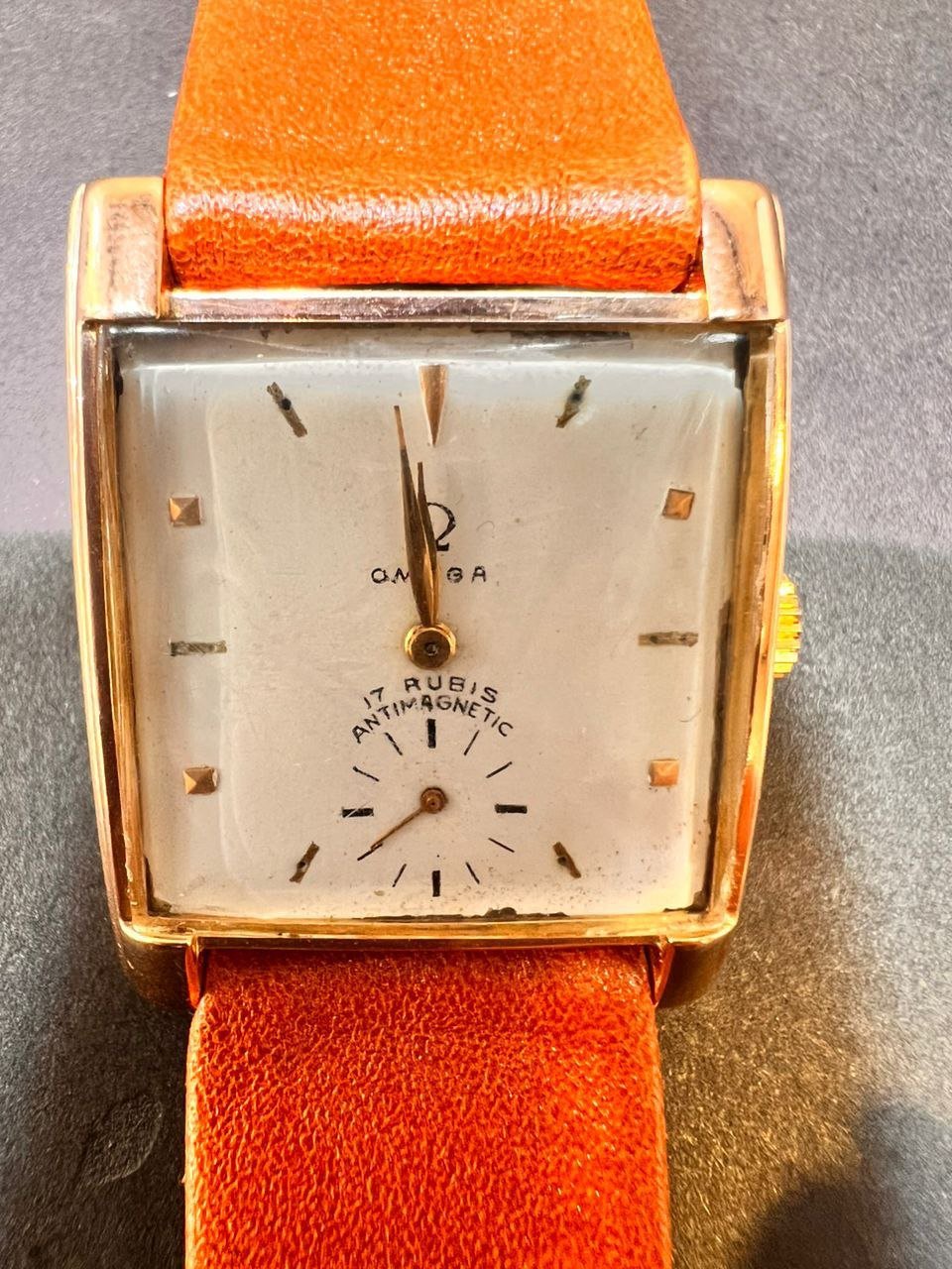

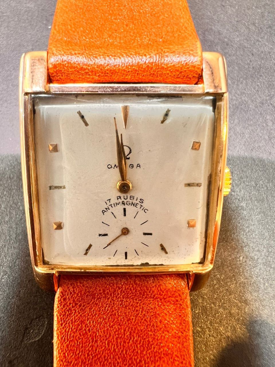

Hi all and thank you for you patience and help, even if you just reading this thread.
There is a hand watch illustrated by attached photos which i need your help and advices to identify if it’s fake or not.

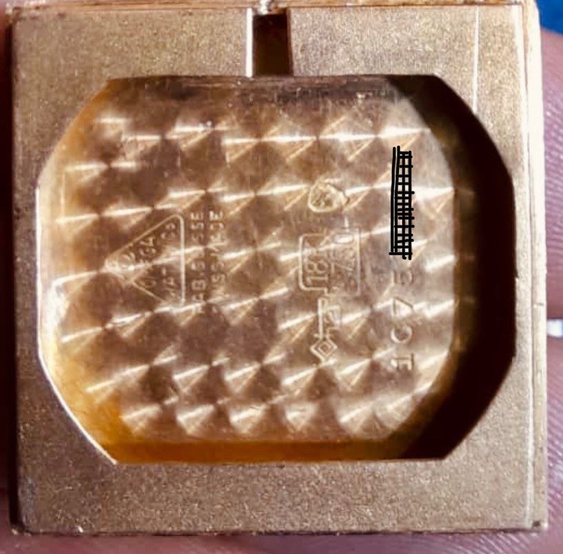

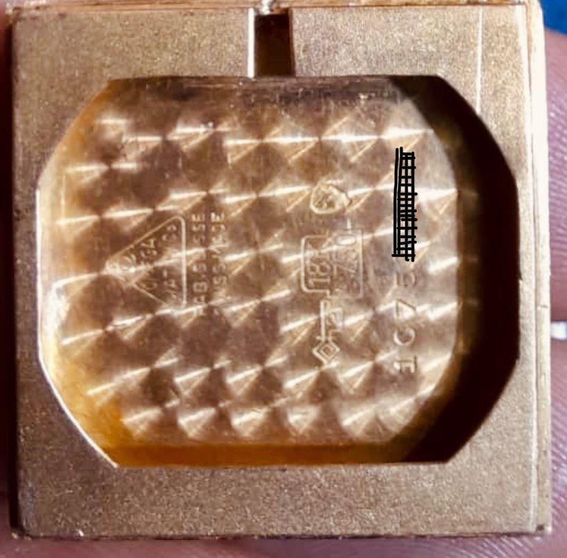

I should tell you that this watch is owned by a person in my family who has a jewelry store and examined it to make sure it’s gold with a strong feeling of a solid frame/cap of gold; plus i’ve marked some digits of the serial numbers to respect the privacy of the owner.
Personally i’ve been searching for any picture similar to this watch by reverse image search engine and other search tools, but failed after watching 1k+.
If anyone could give me the model, year of manufacture or any information would be so appreciated!
notes:it’s been repaired by a professional watch repair professional (as said to me).

There is no model name. It has a repainted dial, which deducts 50% of the value.My guess: The value is the gold value plus $100 for the movement.

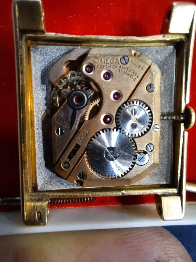

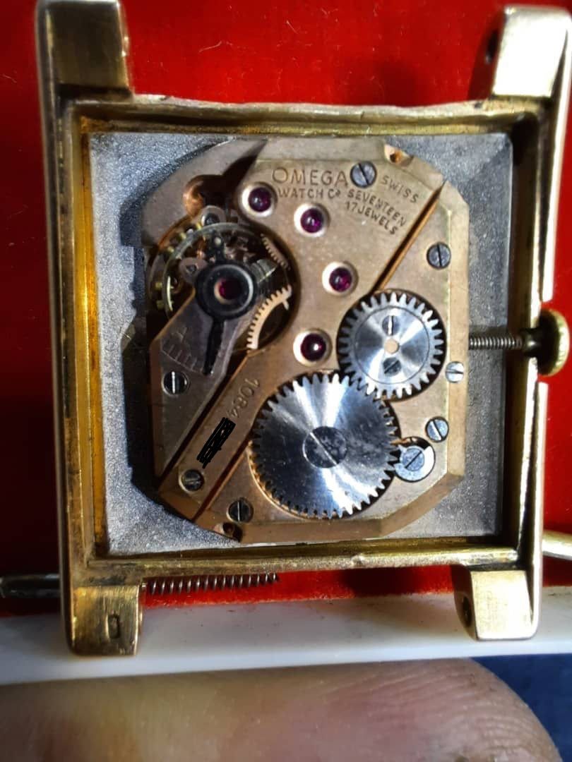

Genuine Omega movement and case with a tragically repainted dial that has ruined any value the watch may have had.

There is no model name, it was produced around 1946 +/-.
Having a correct restoration of the dial will be your best/only option.

From the serial numbers (or what is left of them, the idea of blurring them here makes no sense), the watch was made in the late 1940's. I do not believe it to be gold-capped. I think it is solid 18K gold based on the case hallmarks, which look correct for an Omega from that era.
Most Omega watches from this era did not have model names. Only the top end models like Centenary and Seamaster had them.
If the watch is not running, only a watchmaker will be able to tell you if it is possible to purchase the parts required. You will have a very difficult time finding an original replacement dial. The solution would be to have the watch redialled again with a more accurate pattern.

Just have the dial refinished and just Omega under the logo and Swiss Made at the bottom.
Hands are fine. Some models use Dauphine styled and some leaf.
Movement R17.8 and shouldn't be a problem finding parts if needed. Simple movement to service
Can use a company in Canada called Dialcraft in Ontario for refinishing. I haven't used them since the original owner sold the company
The original owner replated the indexes, so everything looked nice. Can only send the dial
If they still do it. Satin Silver or Satin Old (slight tinge for age) were my go to finishes

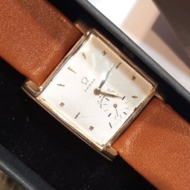

Similar dial
