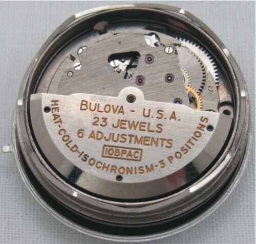

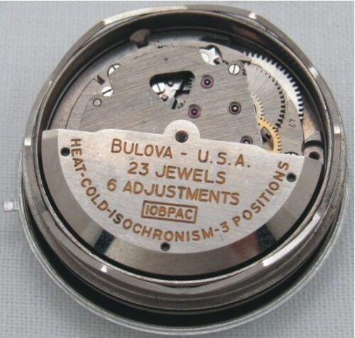

fun fact about elgin- the only US manufacturer that produced a free-sprung movement. also, and I've gotten into arguments about this, the only US manufacturer to produce automatic movements. some claim bulova did, but I haven't seen compelling evidence to support any idea other than they assembled automatic movements made by the swiss.
Bruce Shawkey wrote a good article about Bulova's "23" models for the NAWCC Bulletin in August 2010 (Bulletin #387). My recollection (and I could be wrong, just ask Mrs. Allwoundup) is that he claimed the self-winding 10BPAC movement used in the "23" models was designed and manufactured in house.
71
354
interesting. well, to me and all of the 4 people who frequent this particular board who like US made watches. Bruce is, of course, an expert on whose words I would easily rely.

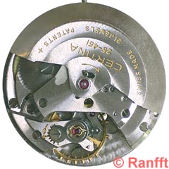

As a Hamilton collector myself, that is a very interesting factoid. I know that Hamilton used ETA, Certina and of course the famous Buren micro rotor auto movements. At the time I'm sure they thought they were betting on the right horse, but focusing on electronics rather than modern, mechanical movements (like the Swiss were doing) probably hastened their demise. Their in-house manual wind movements, while extremely high quality, were quite old-fashioned by the 1950s.
15,951
47,909
They also used Kurth Freres (Certina) movements in some of their self-wind models. The movement shown is marked Certina, but this movement was marked Hamilton 661 when they used it.
106
133
That was what actually attracted me to my first (and so far only) Certina watch, because Hamilton chose them as the first importers for Swiss movements when they decided to come out with an economy line of watches using the Hamilton name in the 50s. I believe the manual calibers were used in the so called "Weatherproof" models.
