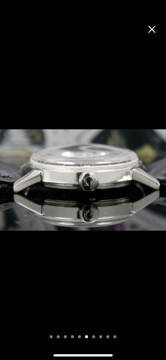

    As I am new with Omega vintage watches, which caught my interest not so long ago. I would like to ask experts/enthusiasts regarding a watch I’m keen on buying from the internet.
    The seller has written that it’s an Omega Seamaster 69’ - cal. 613 (recently serviced). Dial has been repainted by an expert, and case has been polished. And also remarked that no original Omega buckle is included in the deal, and that the glass is an aftermarket (acrylic)
    What are your thoughts on this watch?
    Kind regards

    It's horrid.
    "Polished" generally means the nice clean and sharp lines that the case once had have been rounded off so it looks like it's melted. "Repainted by an expert" means the original dial that was printed in Switzerland has been repainted by Ken in Kent, and now looks nothing like it originally did. Furthermore, it's probably been repainted in black (as is the case here) as they're currently in vogue.

    Thank you for the response!
    What about the hands, dial lettering, crown and mechanism inside? Do they seem to be original parts for an Omega-model as mentioned by the seller?

    Serviced recently? Grungy case, no gasket, filthy in the groove where the gasket should be. Original rose colour plating on many of the bridges in the movement is washed off. This watch has a lot of miles on it. Repaired many times. I would expect the inside case back would show many watchmaker repair numbers. I don’t see any. The inside of the case back almost appears to have had repair numbers sanded off. One cannot help but wonder whatever other short cuts the guy who “serviced” it might have taken. If you buy it, plan on paying for a thorough service, and add that to the asking price for the watch. Don’t be in a hurry. Stick around on the Omega Message Board. Particularly in the For Sale forums. We’ll help you through the process.

    Honestly, Davidt told you everything you need to know. The watch is absolute garbage. Literal everything is either wrong or in terrible condition.
    How much is the seller asking? If the price is above 5$ you should stay away from it.
    Vintage watches takes time and due diligence, but unless you are in a hurry, you will find yourself a nice example :)

    Now, I am wondering if the watch used to be a ‘Geneve’, rather than a ‘Seamaster’ when clicking the link you’ve provided.
  8. Msad May 16, 2019
    5
    Wow, thank you for the detailed description of the misguidance the seller has provided potential buyers.
    In general, can these ‘type’ of seasmaster be found with a black dial with a much better condition? As I really like black dials on watches, have these seamasters existed with black dials from factory?

    Unless there is a proof of service, the term "service" in eBay listings is just a blatant lie.
    Yes, original black dial Omega Seamasters certainly do exist, but in far less number than their silver/white dial counterparts, as they weren't in fashion back then. Here is a couple of examples that I have owned.
    They certainly are in fashion now, which is why black is the go-to color for redialers. You can assume that a great percentage of the black dial Seamasters on eBay and Chrono24 are redials.
