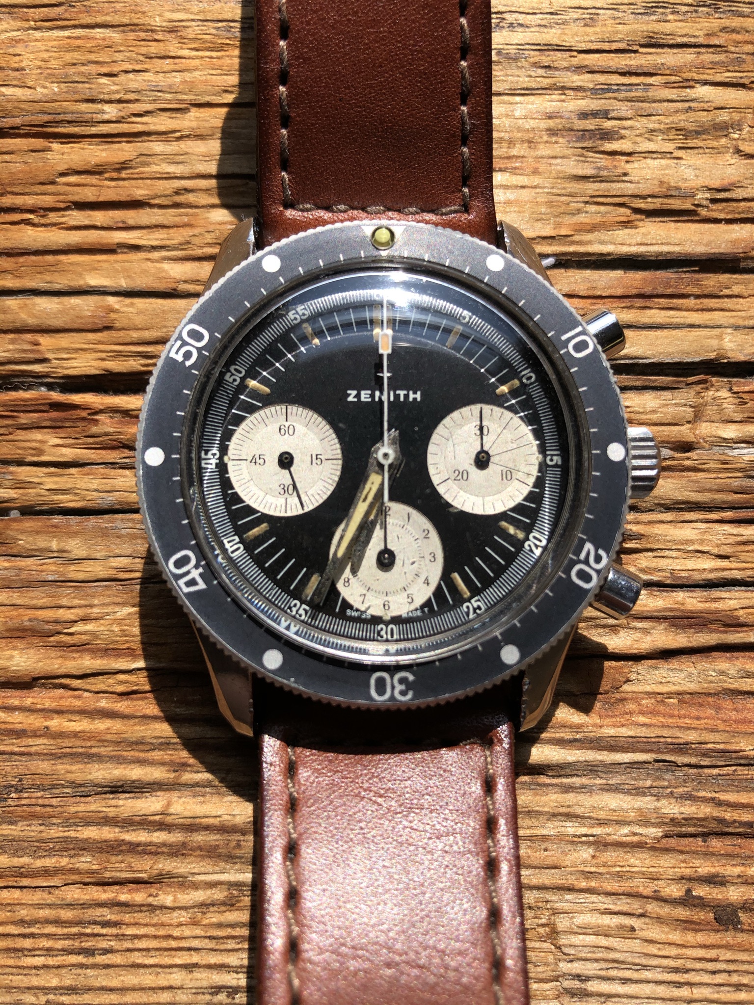

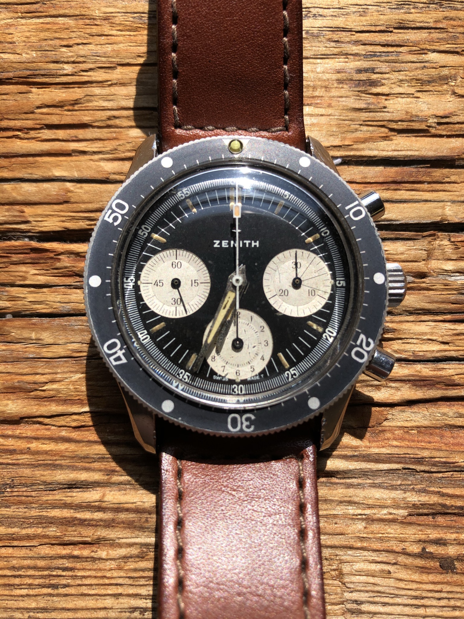

I have a Zenith a277 project, and I need a bit help!
I bought a Zenith a277 chronograph at the beginning of the year, which hadn't bezel.
Now I found one (bezel), but seems something is wrong here ... Maybe the bezel is not correct, or I missed a part or my watch case is polished ... etc.
(I have spring for the bezel, so that's not the missing part.)
I would like to ask for help from someone who has/had same Zenith.
  • Do you remember if there were any extra parts between the case and the bezel?
  • Could you measure the bezel for me? Outer diameter of bezel and inner diameter of bezel.
  • If you can take it off, what is the bezel outer diameter and the inner diameter on the back side of rim.
  • If you can take it off, could you take a picture for me about the parts?

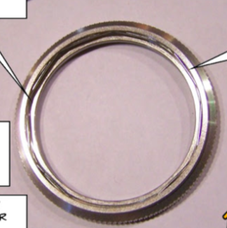

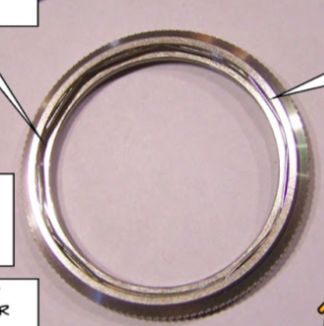

(Pict via shucktheoyster.com)

I'm pretty sure you need the octagon shaped bezel retaining wire that goes on the inside of the bezel and snaps to the case around & the acrylic (clear plastic); may be hard to find but it will be open on one side, not a complete, full octagon but open on one side which will allow you to bend it if needed. hope the helps. Look at this photo and you'll see the wire tucked inside the bezel and should snap right on. Good luck!

I have the same watch— I can measure the outside diameter of the bezel later when I get home if that’s helpful.
