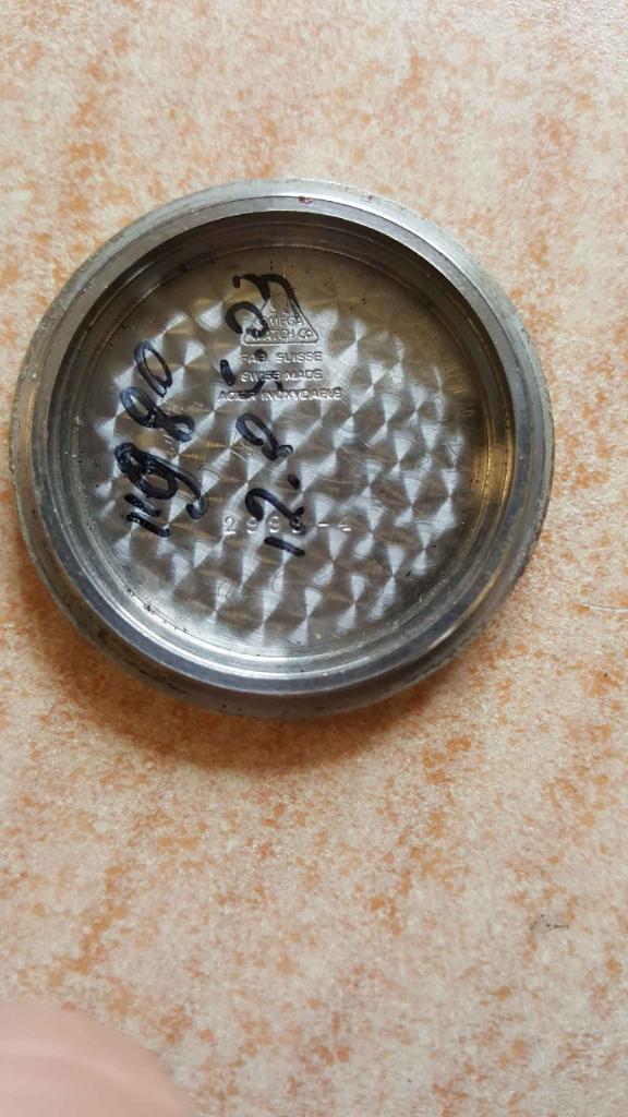

Additionally, I am told this is an Omega with 321 movement, my dad got it as a wedding gift, I believe in 1965, and the case back (inside) is stamped 2998-4. Movement serial number, I think is 22082395.I have a picture of him wearing it in 1968, so it is definitely at least that old.

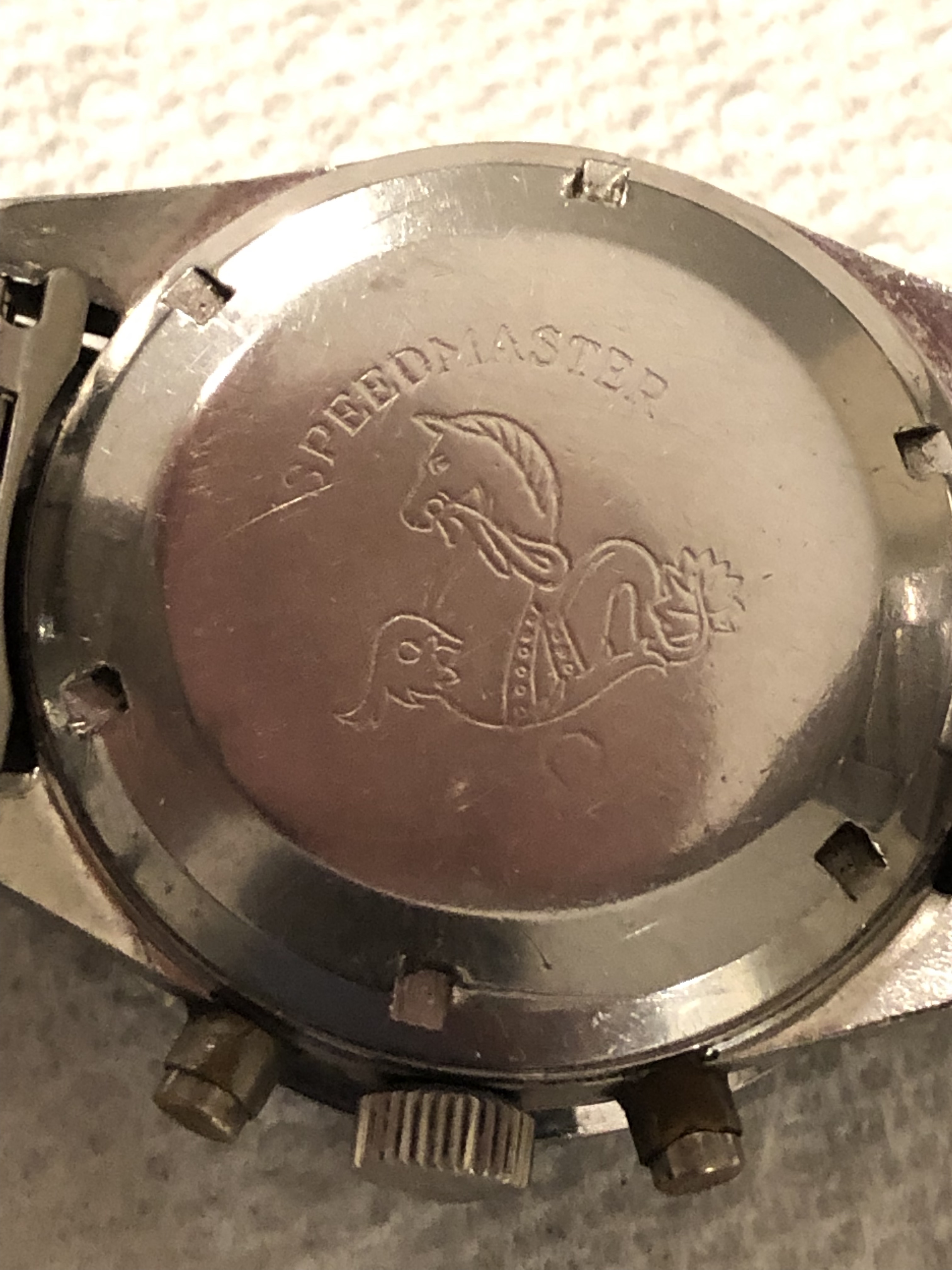

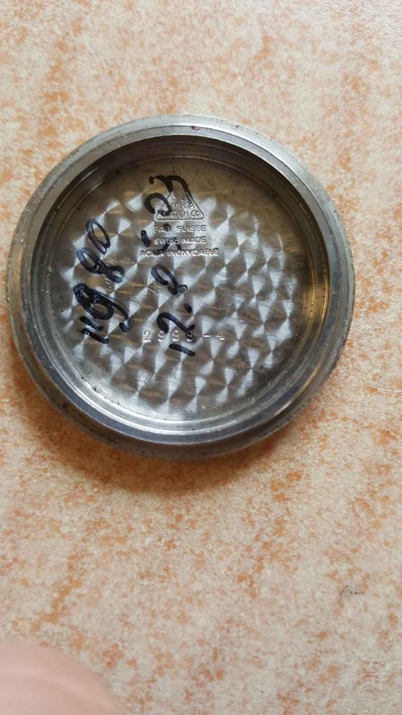

Case back inside, seems to have been repaired once...

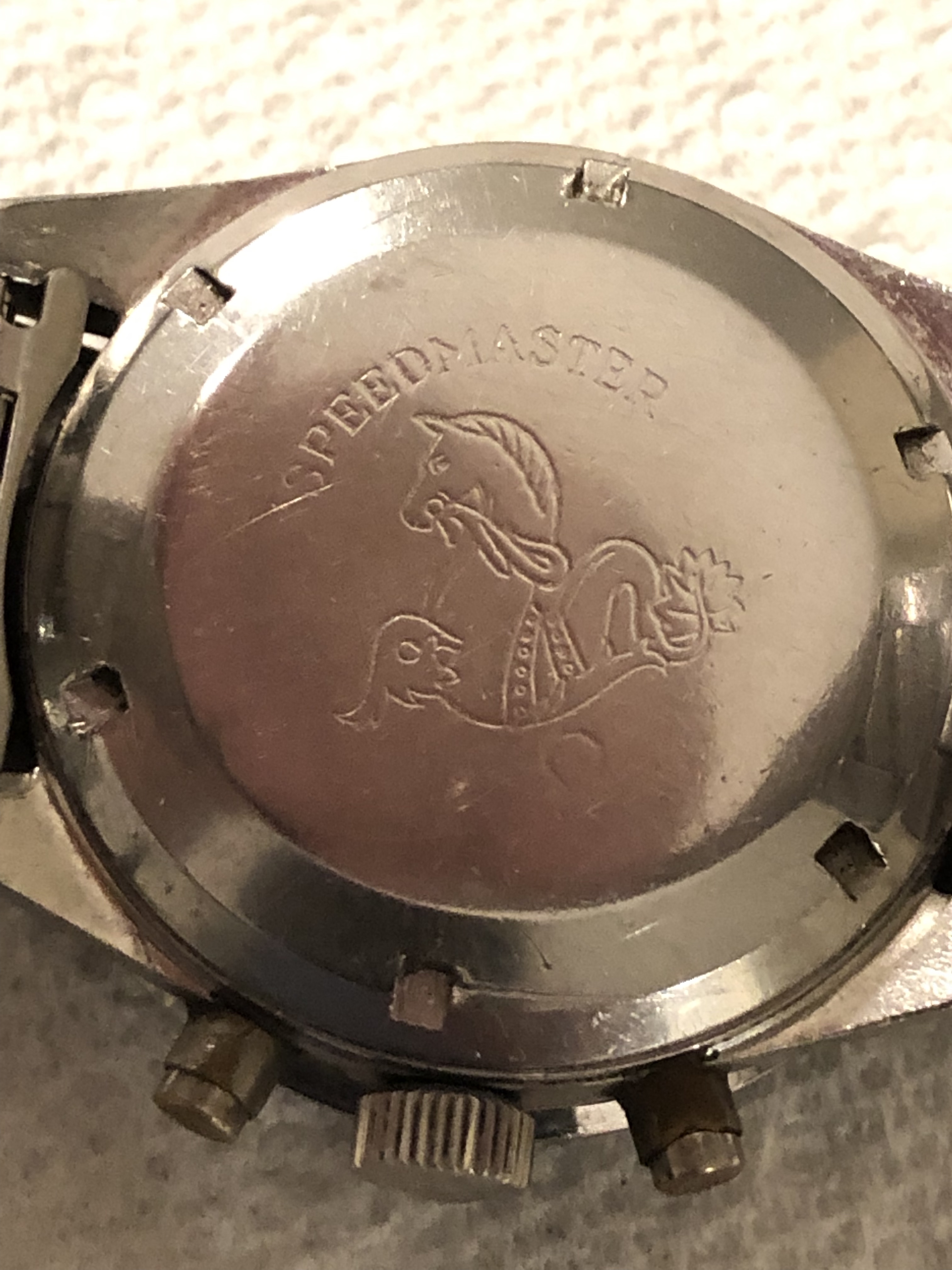

Case back:

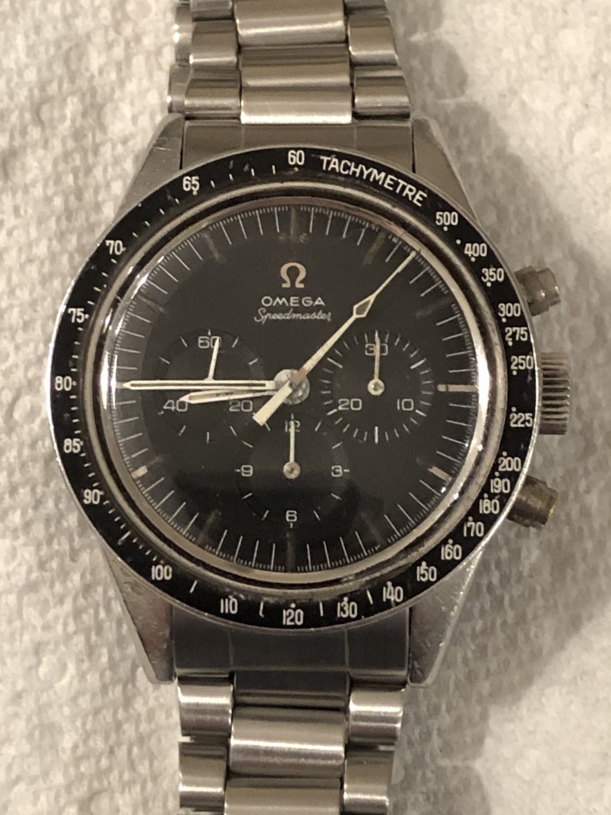

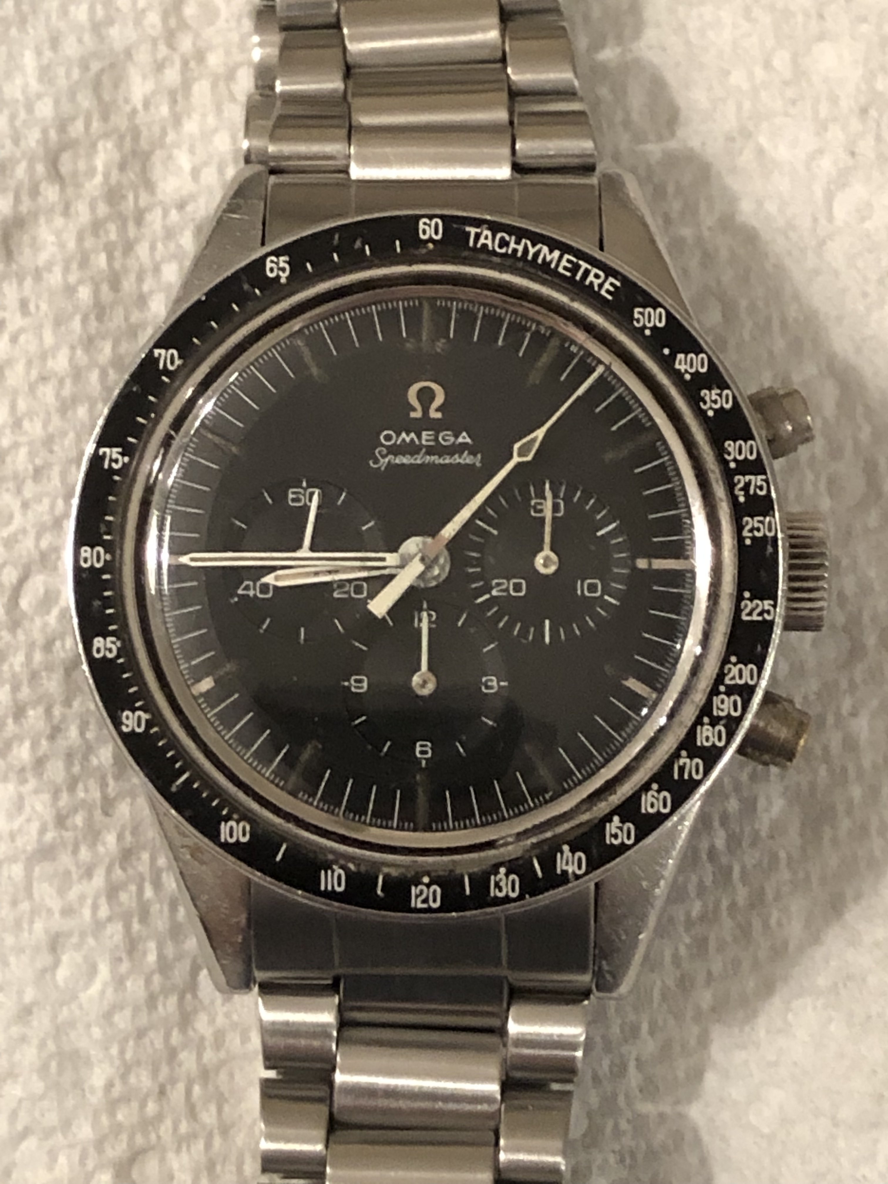

Dial close:

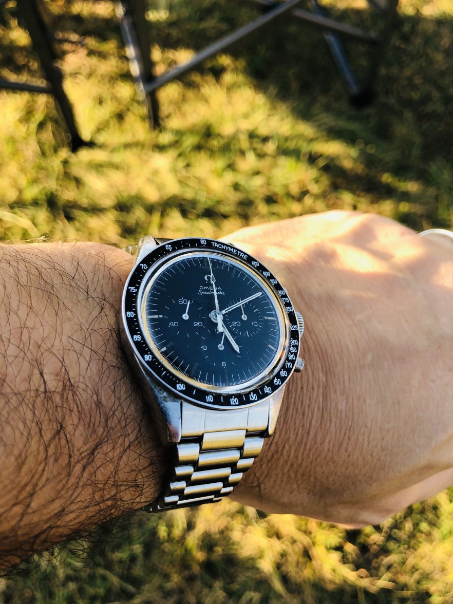

Moon watch out in the sun:

Very sorry to hear about your father ... it's great that you have such a wonderful heirloom. A 2998 is a special watch, and restoration is possible, if you choose that path. You should take your time and learn about the reference. Don't rush into it. Ultimately you can choose how much you would like to keep it in the final form that your father had it, vs. how much you would like to restore it to its original condition. Period-correct parts are available, at a price.
Your watch has some replacement parts, including the pushers. I don't think the caps are missing, they are actually a different style of pusher (inverted/inverse style) that has been installed. Certainly non-Speedmaster and probably non-Omega ... just something that fit. So I agree with getting the correct pushers, or at least authentic Omega service pushers. The rest of the watch looks to be authentic, but some parts are not original. The sweep hand (possibly all the hands, but the sweep hand is most distinctive) and bezel are authentic Omega replacements, likely from the 1970s. Such parts were often installed during a service. Case, case-back, and dial look original. Now that these watches are highly collectible, people fuss over the originality of parts. 40-50 years ago, owners didn't care, they just replaced damaged bezels with new ones, as you might expect.

I can only hope, that whoever replaced the pushers with these ( failing to find a word for THAT .....), left the origin pusher thread unchanged. Then it is no problem to restore the visual for that Beauty. Kind regards. Achim

That’s a 105.003 with a swapped caseback, according to the movement and the dial (a common thing to happen back in the day at service before these watches became so valuable was a caseback swap). It’s difficult to see in that pic of your father but the hands look all white in it, which happened only from the next reference up from 2998. Still a lovely heirloom. Cherish it! And lovely pic of him 👍
Edit: to clarify what I meant, but did not say, for posterity of those who can not infer it.
SN puts it in the range of 105.003-63/64.
Dial is for a 105.003 -> 2998/105.002 dials have minute track painted to the step in the dial, whereas 105.003 dials the minute track stops with a gap before the step (as in the watch pictured).
Fathers picture : clearly white baton hands in that picture (only found in later 105.002's onward).
Via occams razor thus...
Edit edit : if the silver rehaut is original (i think it looks silvery in the picture of your Dad) it may even be an early -63 (edit edit edit : most likely not...sn should be really early for that I would guess...so then the silver rehaut in the vintage pic is very interesting). It all depends on the 't swiss made t' (or lack of t) on the bottom of the dial, which is not visible due to the displaced nature of the minute track (and swiss made) away from the step, and the silver rehaut which has a slightly smaller diameter than the later black one (i think). If you can see the top of that from an angle, do post a pic.
Edit edit : if the silver rehaut is original (i think it looks silvery in the picture of your Dad) it may even be an early -63. It all depends on the 't swiss made t' (or lack of t) on the bottom of the dial, which is not visible due to the displaced nature of the minute track (and swiss made) away from the step, and the silver rehaut which has a slightly smaller diameter than the later black one (i think). If you can see the top of that from an angle, do post a pic.
Thank you! I did notice the anomaly between serial # and case back, but wanted to let the forum confirm, since I am such a novice. I appreciate all the information you provided. I cannot see any indications of the "T Swiss Made T" from any angle, but I'll try and use my camera to zoom in at an angle.
Even on 2998's it a tight squeeze. See how it almost slides under the rehaut?
With the Ed White dial, and the slightly larger radius track, that is most likely under the silver rehaut. See how your minute track is almost on the edge of the rehaut, compared to the pic above?
If you can see it, you might just see the tops of the letters...if not, you will have to decase the movement and dial to see.
In my research, I've seen the hands look the same, what makes you think they were replaced? Reference: https://www.hodinkee.com/articles/just-because-an-omega-speedmaster-reference-105003-ed-white
