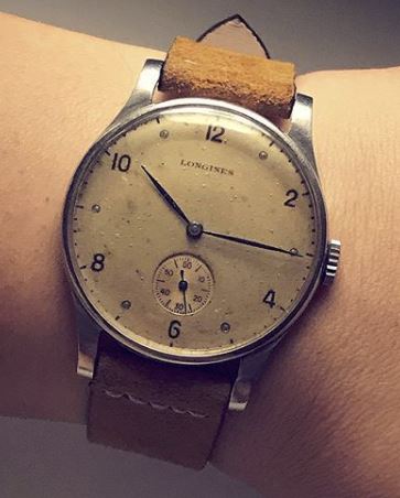

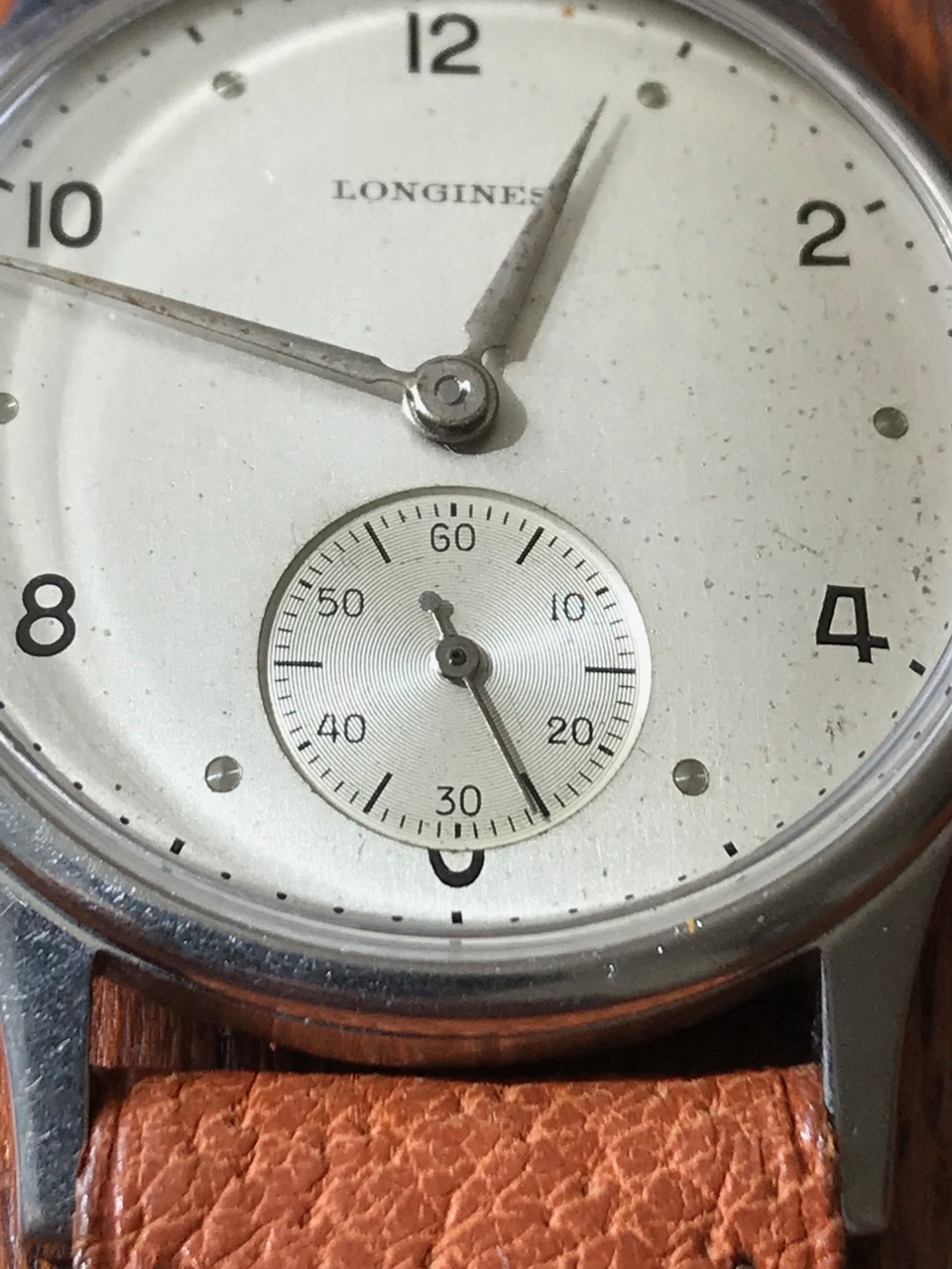

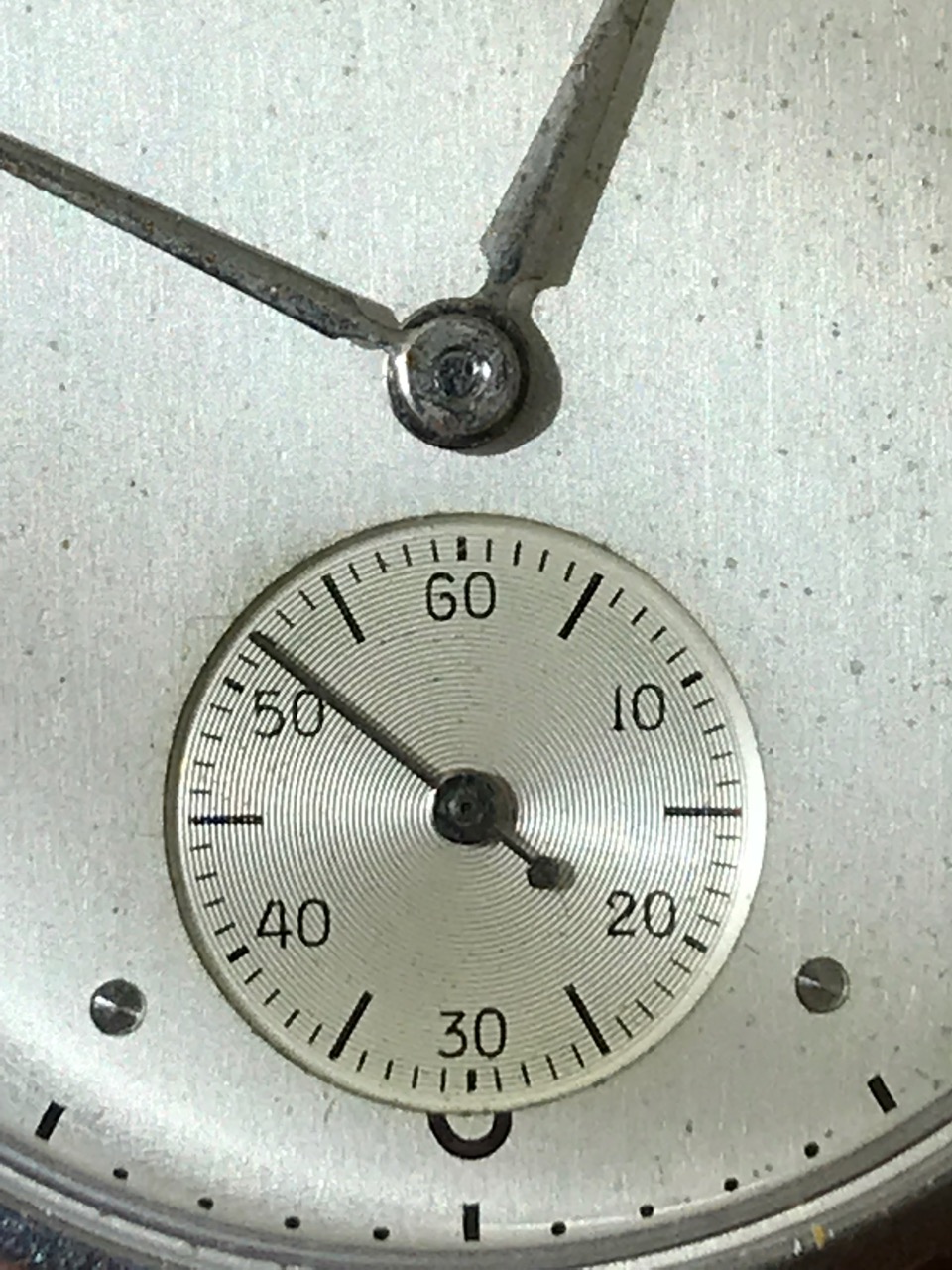

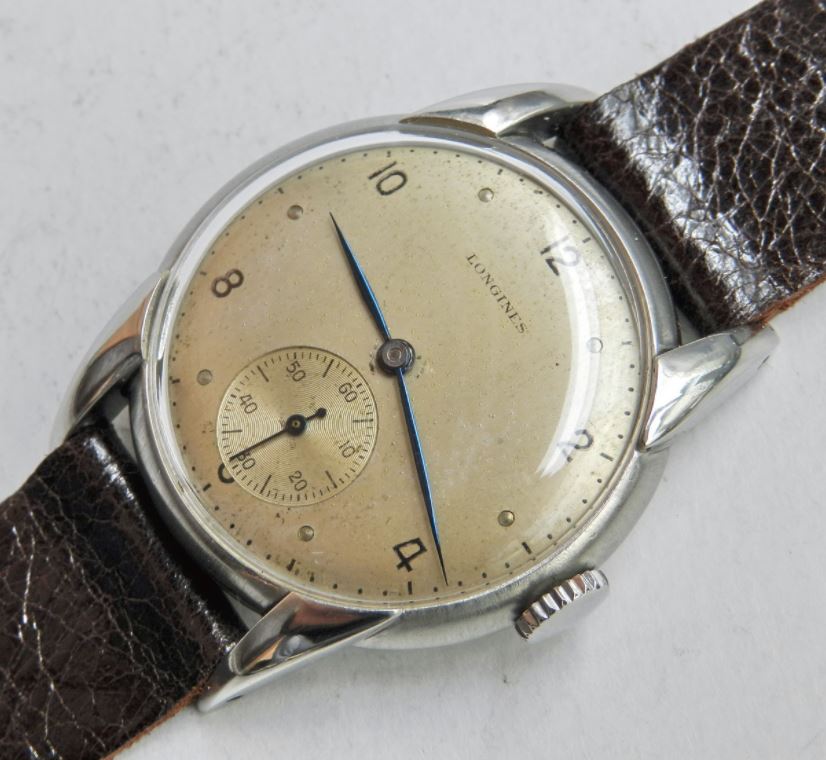

Detailed photo of sub-dial added upon a polite request to the seller. Looks crisp to me, but I think the hands would still bother me as possible replacements.
What say you based on the new picture @ulackfocus?
Now THAT'S the kind of detail necessary to make better evaluations. The possibility of it being original is better after seeing that photo, but I'm not going to say for sure it's original.
Well done! I鈥檓 not entirely sure that the hands are replacements?

They look to be Longines hands from that time period, but I'll defer to the experts on this one if they've got some more definitive information.
I'd say go for it if you think the price is right, otherwise I just may be tempted just out of curiosity. 馃槈

These lance hands may not be replacements but leaf hands are more typical of this dial design.
649
2,090
Are there any examples of a similar dial from that period using the lance hands? I haven't been able to find any.
I think such a perfection is impossible for a redial.

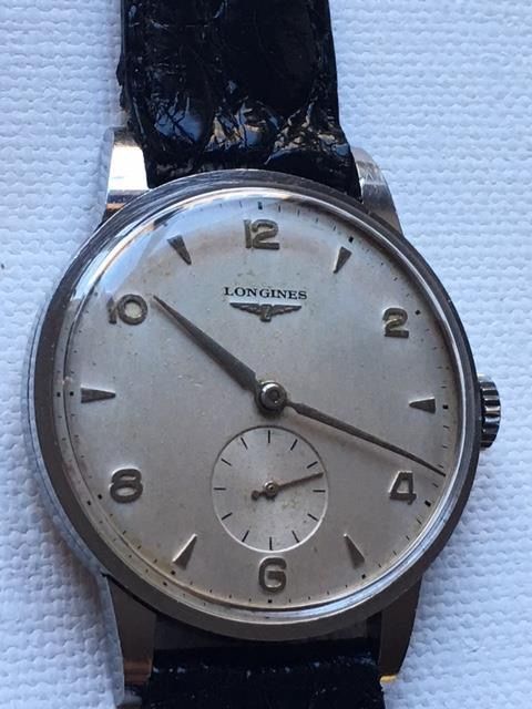

I have this similar style one, albeit central seconds, with what i believe to be more common leaf hands.

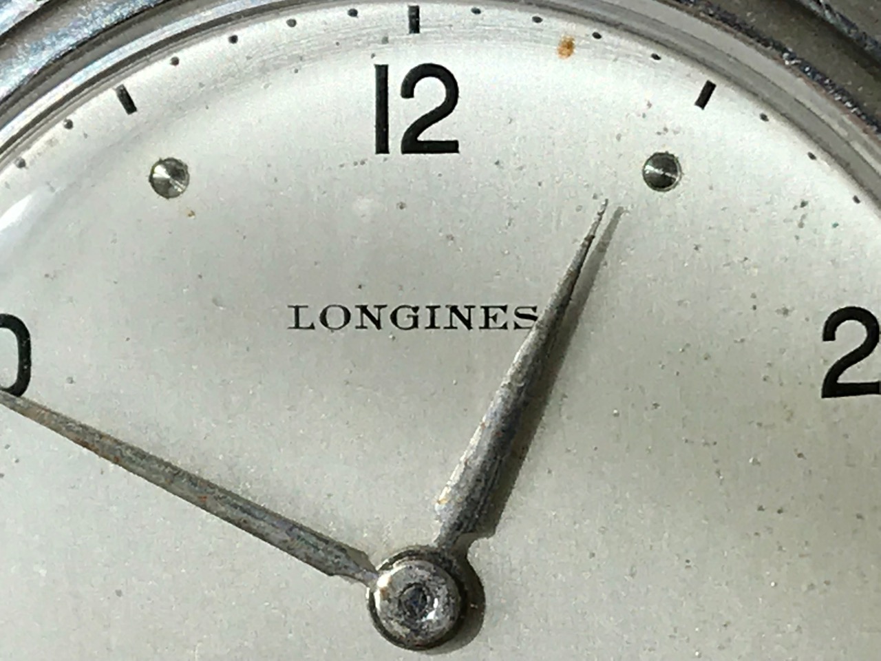

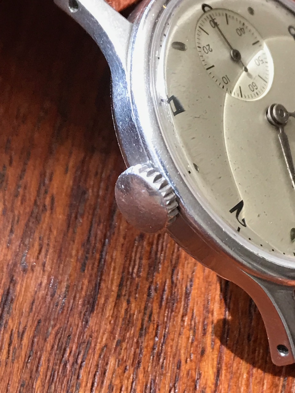

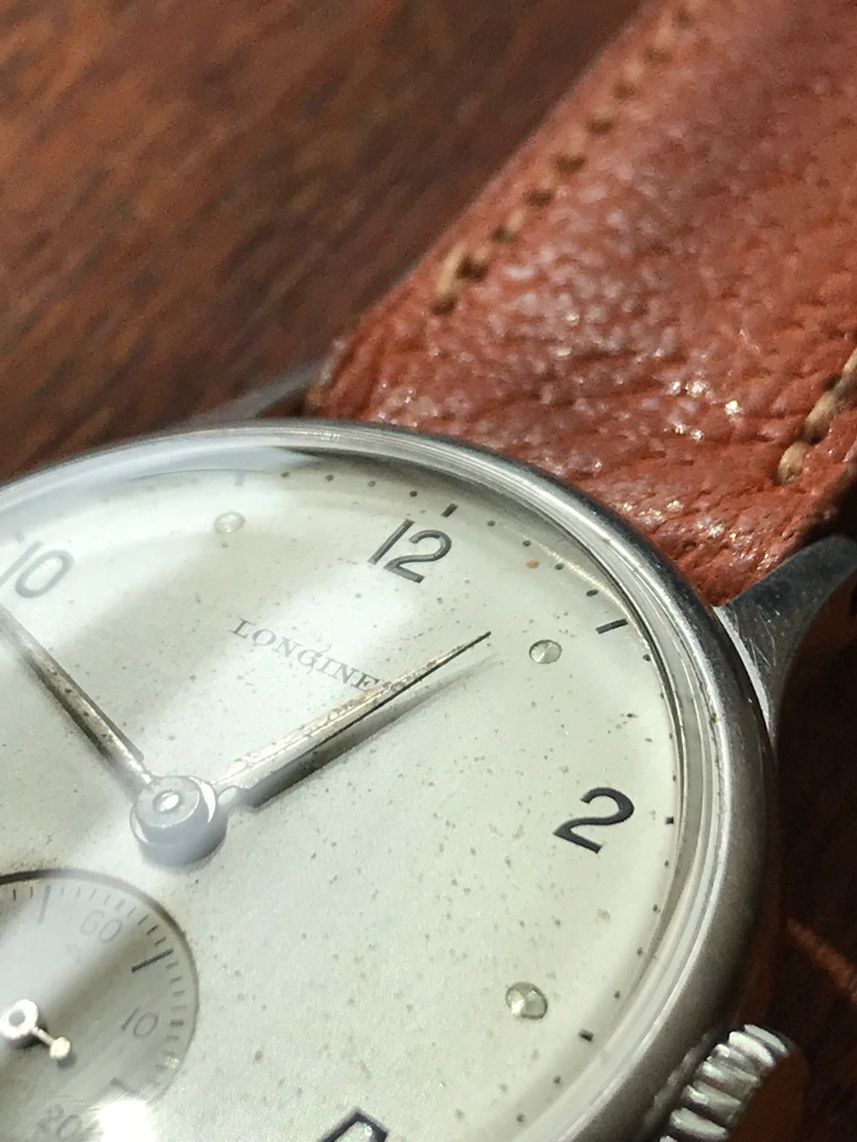

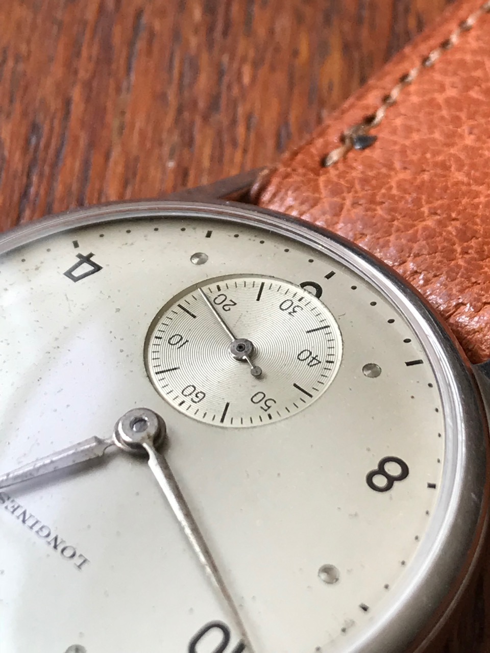

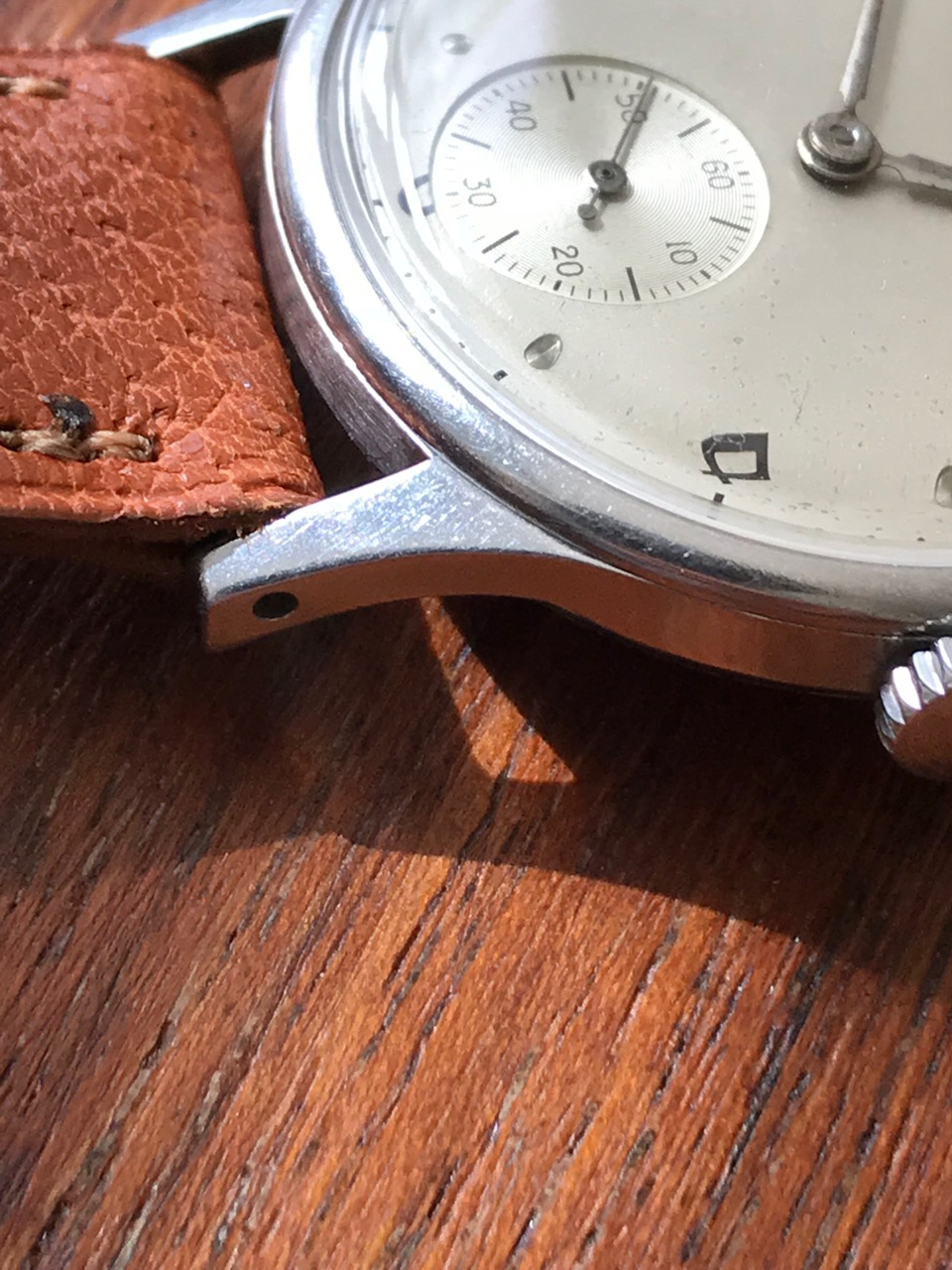

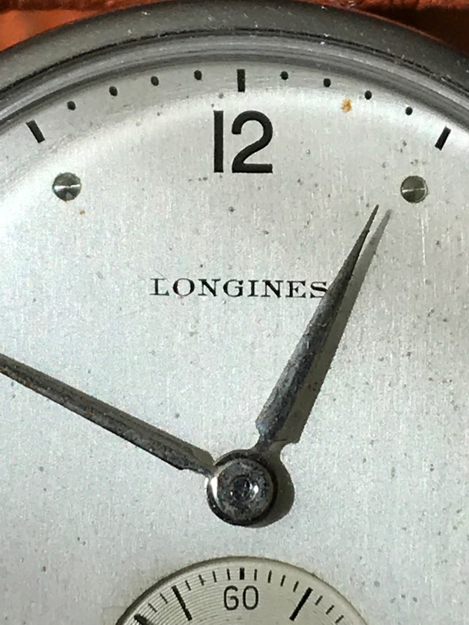

As promised, some updated pics now that I've received it. Need to find the camera and macro lens, wherever they're hidden, but here are some quick and dirty snaps:
25,980
27,707
The 2nd and 3rd shots, particularly the side angles of the 12 and 4, show that show the ink has depth to it. That's a very good sign.
649
2,090
Yep, having it in hand, I can't see this being a redial based on the crispness of the printing and the consistency of the dial degradation. Hands seem to match the age of the dial too, but I would still like to track down other examples with similar dials and hands if possible just to be sure. Case looks pretty sharp too with little to no polishing apparent on it.
I'll try to take some macro shots later when I do find that pesky camera, this is about the limit of the iPhone camera I'm afraid.

@Rumar89 - script looks in keeping of the fonts that are verified, and the subdial circles are nice and deep with.
Yes. I had little doubt once I saw the subdial.

I do think the hands are original. They seem to have patina roughly matching that found on the dial.
