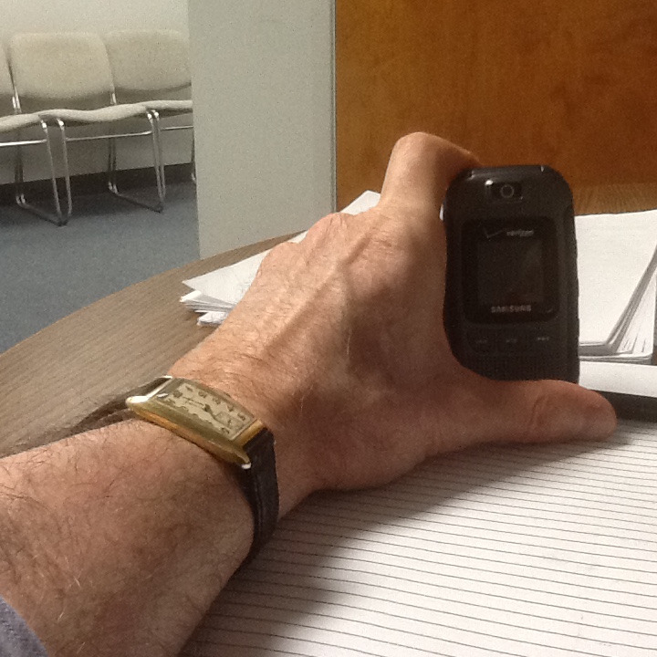

This watch I've worn for ten years, then all of a sudden it started losing 15 minutes at a time. So I stopped wearing it.
It's a Hamilton Custer from about 1936; cell phone from around the same era. But, I need a watch that will easily go under exam gloves. So I went to the bank, and pulled this from the safe. It hasn't been touched in 25 years.

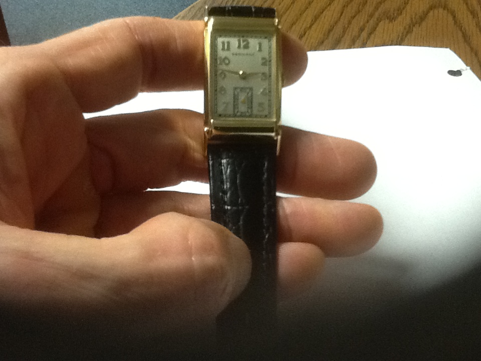

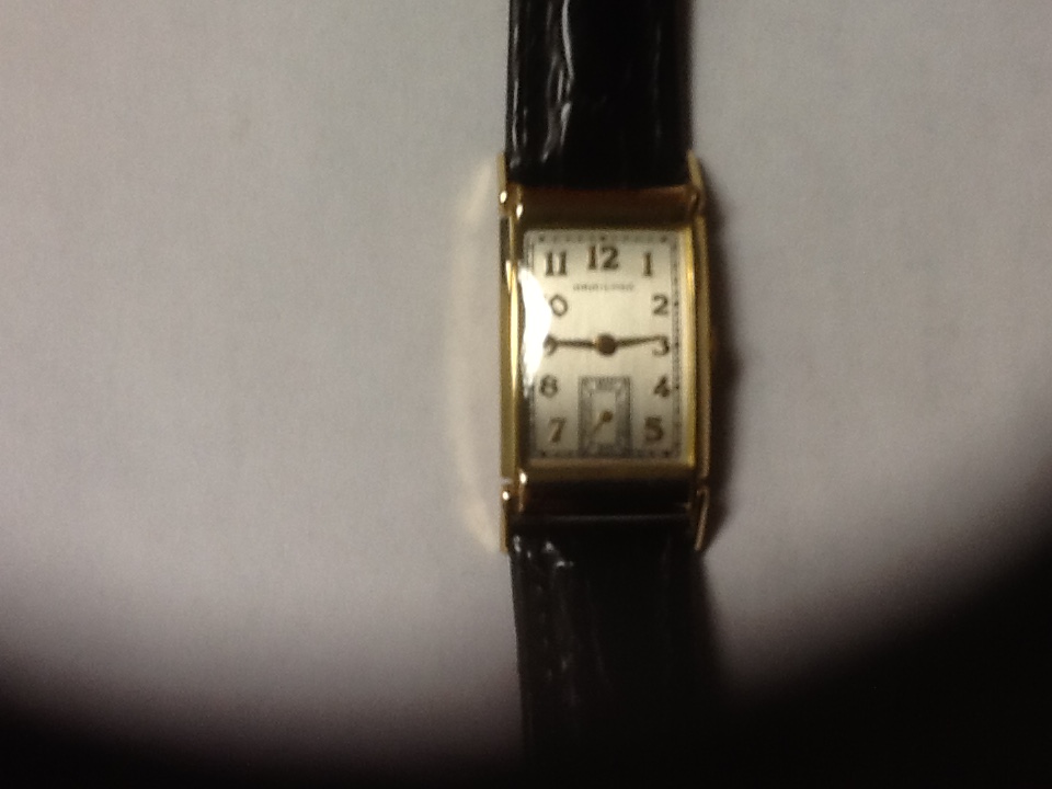

It's a Hamilton Gilman from 1947. So I wound it up, strapped it on, and it's keeping perfect time.
Now, one would assume after two and a half decades, all the oils would have dried out. So, it appears to be true that accurate time-keeping in not a good indicator of the need for a service, and I probably shouldn't even be wearing it. I have to confess, however, that I don't really understand how it could be performing so well with the assumed increased friction on all parts due to the lack of lubrication. Be that as it may...
