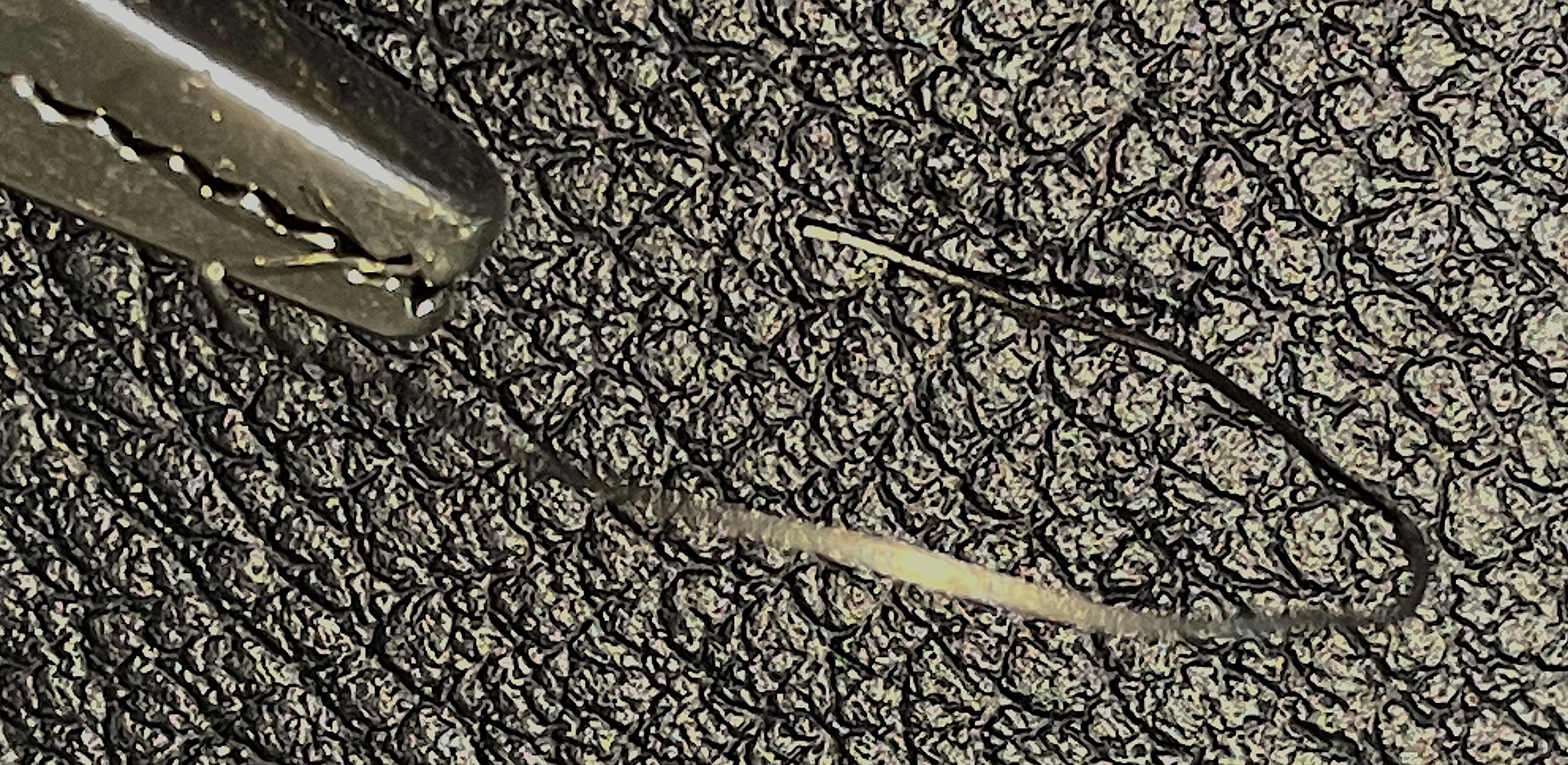

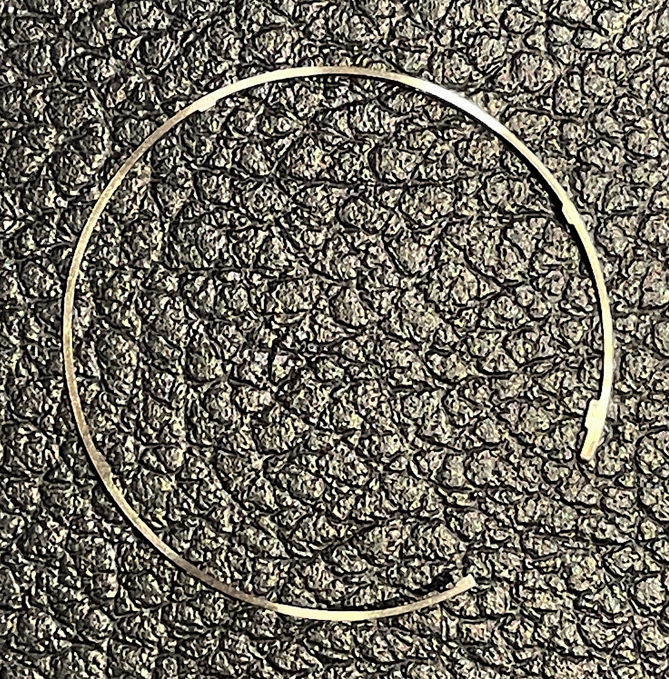

I found a wavy spring........
18,800
39,059
......in the bottom of an ultrasonic jar.
But I have no idea what it is. I remember cleaning a bunch of general movement parts so it could have been then.
It sort of rings a bell, maybe something Seiko?
Any ideas?

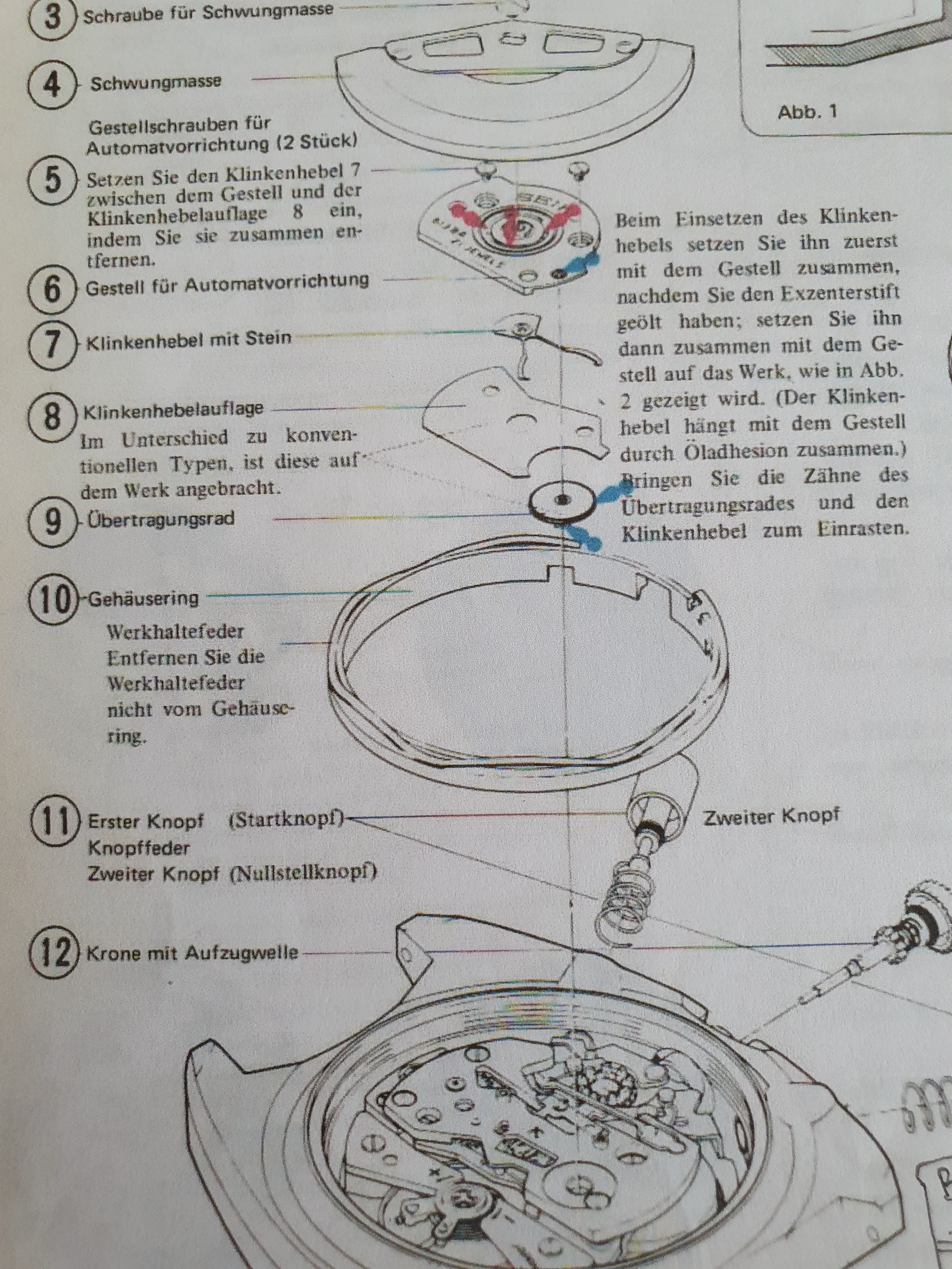

It is a Seiko movement holder spring.
Take a look at the movement holder ring, there must be a groove to put it inside.

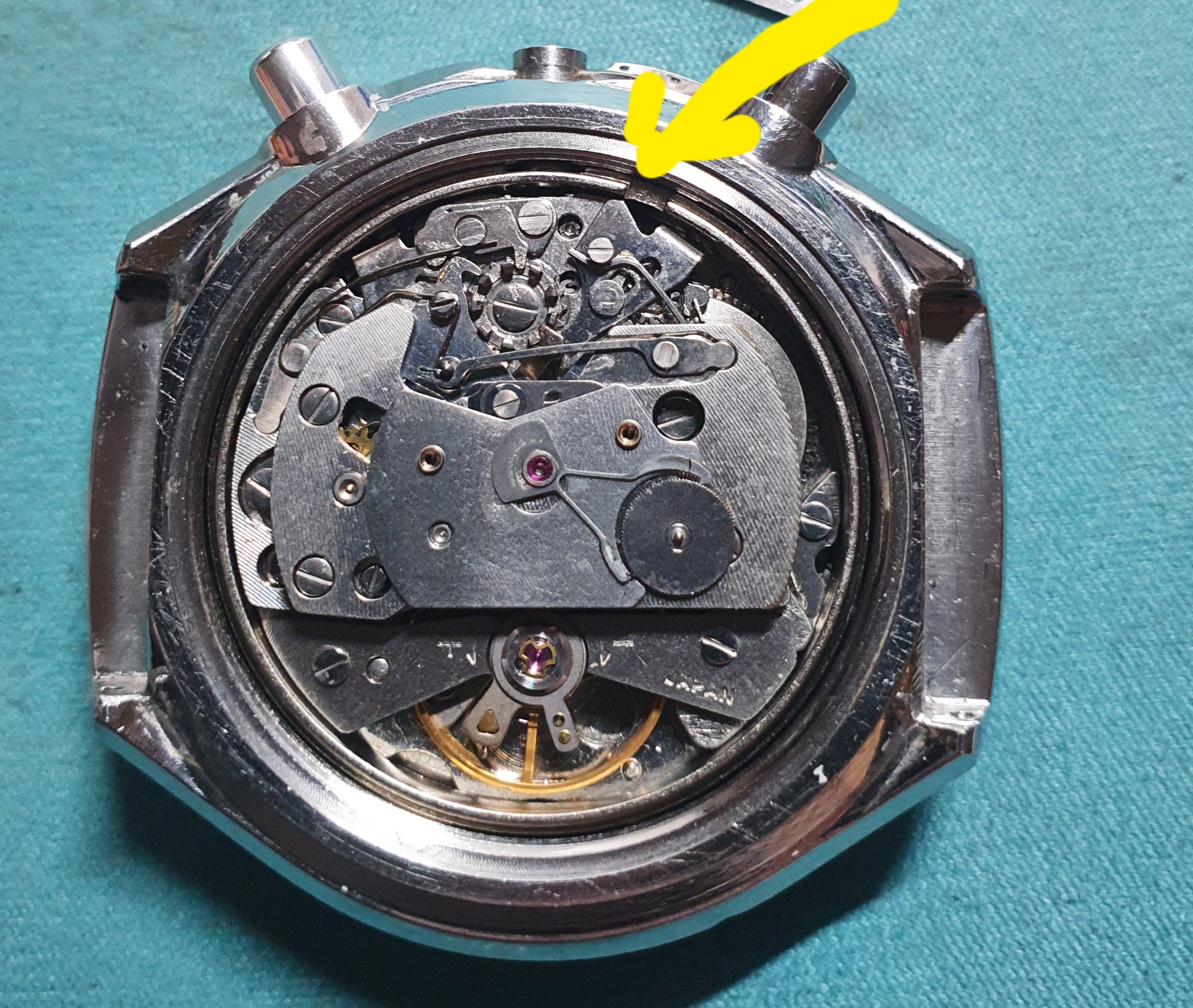

Thats the notch in the movement holder it holds in place:
Without this piece the movement shakes a bit inside the case after putting the watch together.
