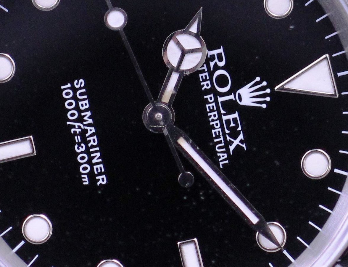

Given those two pieces... I prefer the watch from the 1st link.
2nd watch looks like super-luminova hands & tritium dial & tritium insert which is olded than the dial.
But hands on the 1st watch do looks a bit tired, don't they?

This is my first time giving my view on something like this, so I'd take what I say very sceptically, but if I was looking at these two, I'd say that the second watch has been more polished than the first. The crown guards on the second seem very shiny, but worn down, and if they're the same reference, then there's no definition on the crown guards on the second watch, whereas there is a sharp line on each of the first. And in fact it looks like the lower crown guard nub has actually been polished slightly lower down than the upper one, which is particularly obvious when you look at the photo of the watch face down.
I'd be interested to know if I'm talking nonsense from more experienced/knowedgeable contributors, because, as I say, that is my first attempt at this, and it would be helpful to me to know if/where I'm going wrong.

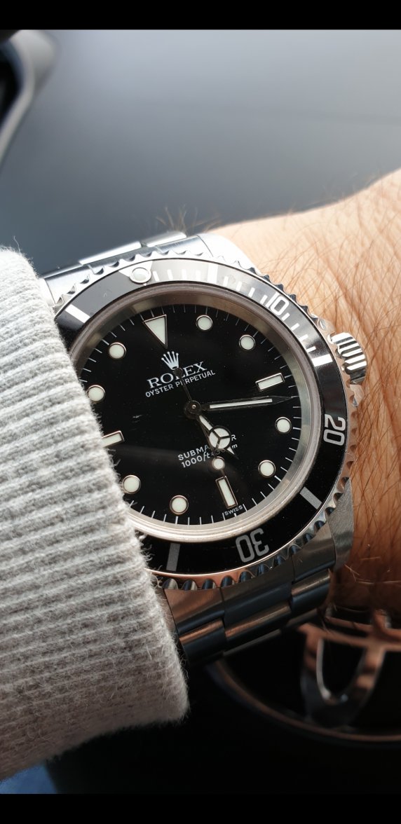

At the end I went for the luminova swiss only 14060 because all the tritium ones were polished to death. Difficult to find a good one.

I am not really a fan of the “whiteness” of the luminova, otherwise a 00’s Submariner would seem like the easy choice.
I understand. Tritium is more attractive. But I use my sub really as a utility watch. I dont need to be very carefull with it. You can bang it around. It was well build.
