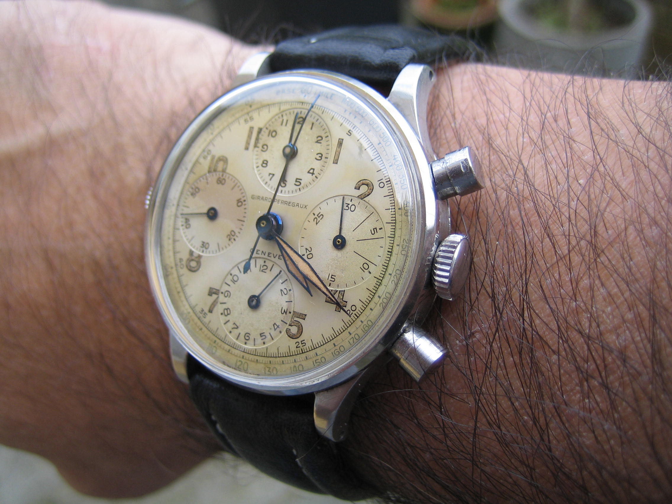

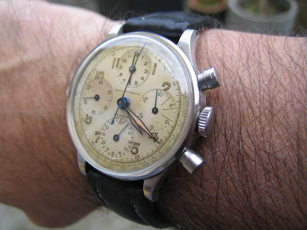

    Aero compax mushroom pusher fix (brass cheap ugly replacement) ...
    From this ...
    to this (custom made steel pusher same materials, look, style and functional characteristics of original) ...
    guillaume, LouS, pitpro and 6 others like this.

  8. Diabolik Apr 6, 2015
    1,374
    2,664
    No, no watchmaker involved. A lathe and some raw materials as well as plenty of hit and misses. It involves a number of different processes such as turning, tapping, silver brazing, polishing and then, eventually, the final revision was ready for fitting. Took the best part of a week to get it right and there are still a couple of things I would change but it looks good and is functional and I am happy with it now.
    It would not be too difficult to make the tube and thread it but it is certainly not a part you could mass produce as the amount of time that it takes to make each bit is way beyond what I expected (and if time is money, that would make it very expensive). Something you could only undertake for the sheer challenge and love of it.
    Anything and everything is possible and where there's a will there's a way.
