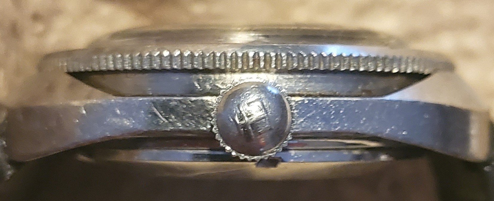

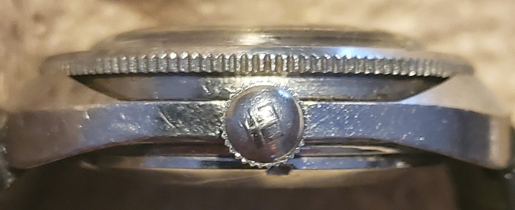

I've got a mid 70's Tissot Navigator 44940 dive watch with a frozen bezel. The bottom edge of the bezel is only accessible from 2 areas on the sides of the watch due to the case design. I've liberally dripped penetrating oil in there but after a few hours it still won't budge. I believe it can only be remedied by removing it, but that's more difficult because of the limited access. Any ideas that won't mar the case?

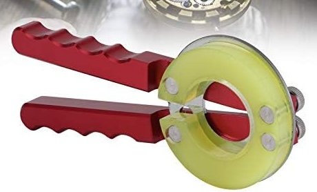

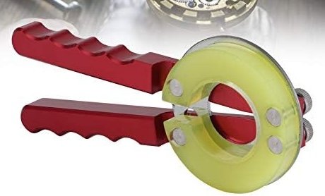

One of those pliers-style bezel removers with the split urethane ring. Same way you always remove a rotating bezel.
211
172
Doesn't the case design preclude the use of this tool? The dental floss idea is interesting. Could at least work the oil in there better. I'll give that a try.

I always use one of these.

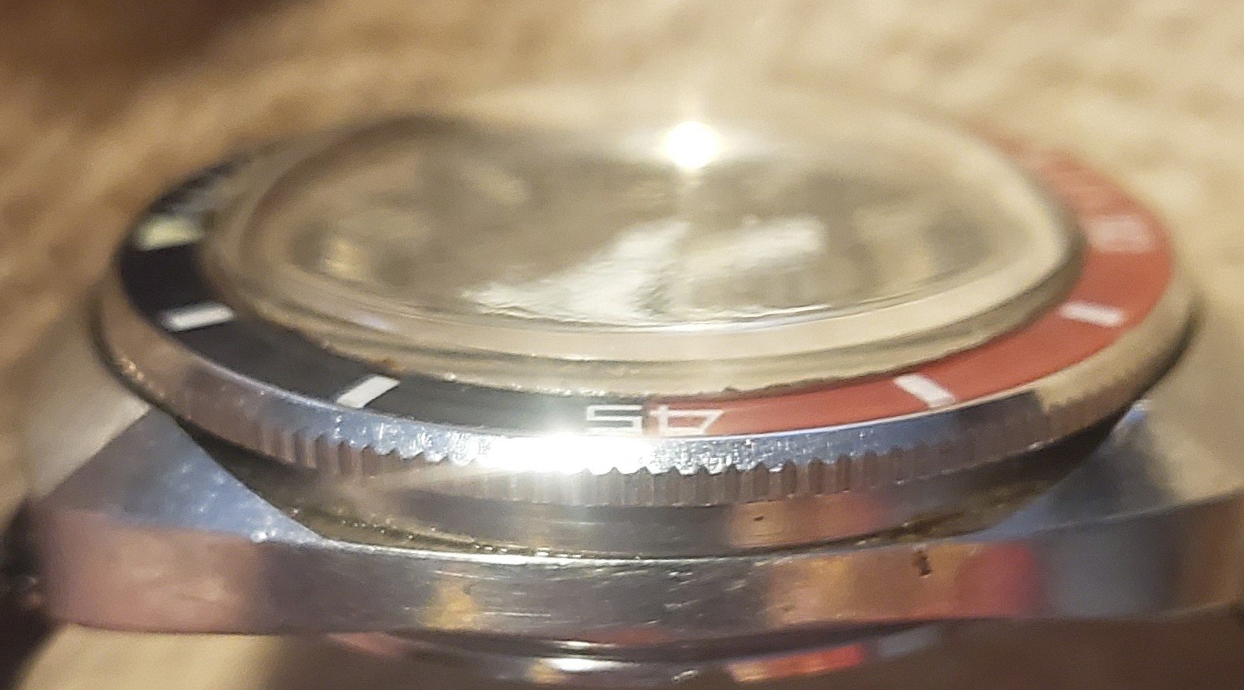

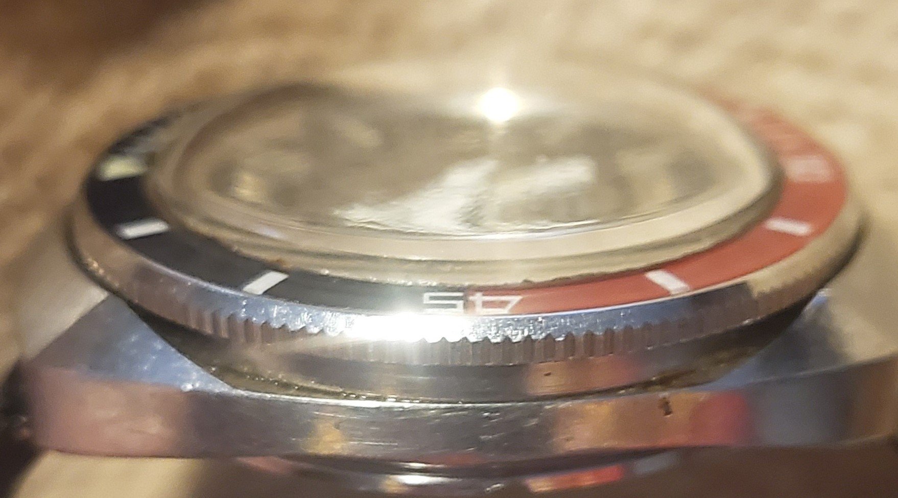

The floss method is a novel trick and it was working! Floss came out a bit dirty but not as much as expected. After a few minutes I was able to rotate the bezel for the first time since I've owned it. It moved 5 minutes counter clockwise and even made some nice sounding clicks with no grinding. But it was still very hard to turn so I decided to try a thinner floss. Mistake. It tore off on both ends leaving a tiny piece lodged under the bezel. I tried for over 90 minutes to dislodge it with the thicker floss but no luck. Using pliers to pull on the small protruding bit that I could grasp only ripped that portion off so that I could no longer grip any. If I'd stayed with the stronger floss it may have worked, but now I'm pretty much back where I was. I haven't given up though and will be back at it tomorrow since my fingers are raw.
I'm hesitant to try a razor blade. I did consider my ultrasonic cleaner but had the same thought that it might damage the nice bezel insert and perhaps also the crystal and seal. I'd sent a Submarino to my watch maker for a service and I suspect he did an ultrasonic cleaning as the near perfect bakelite bezel insert came back with one of the number damaged. So frustrating and he gave no explanation.

Yup! Bakelite in an ultrasonic is a big no-no. The numbers are backpainted and insert is glued in- I won’t even submerge my 50+ year old bakelite bezels as if any of the adhesive has separated (which is more than likely) and water gets under there- you have delimitation.
But your bezel (from the side shot) looks like colored aluminum so soap and water won’t affect the color if you soak it (movement out)- perhaps it may loosen the adhesive of the insert but that can be easily remedied.
edit- just looked at your pic again- Bakelite, no liquid for you!
Try a dribble of Naptha around the base of the bezel and see if that loosens things up. Art conservators use it regularly for grimy funk.
