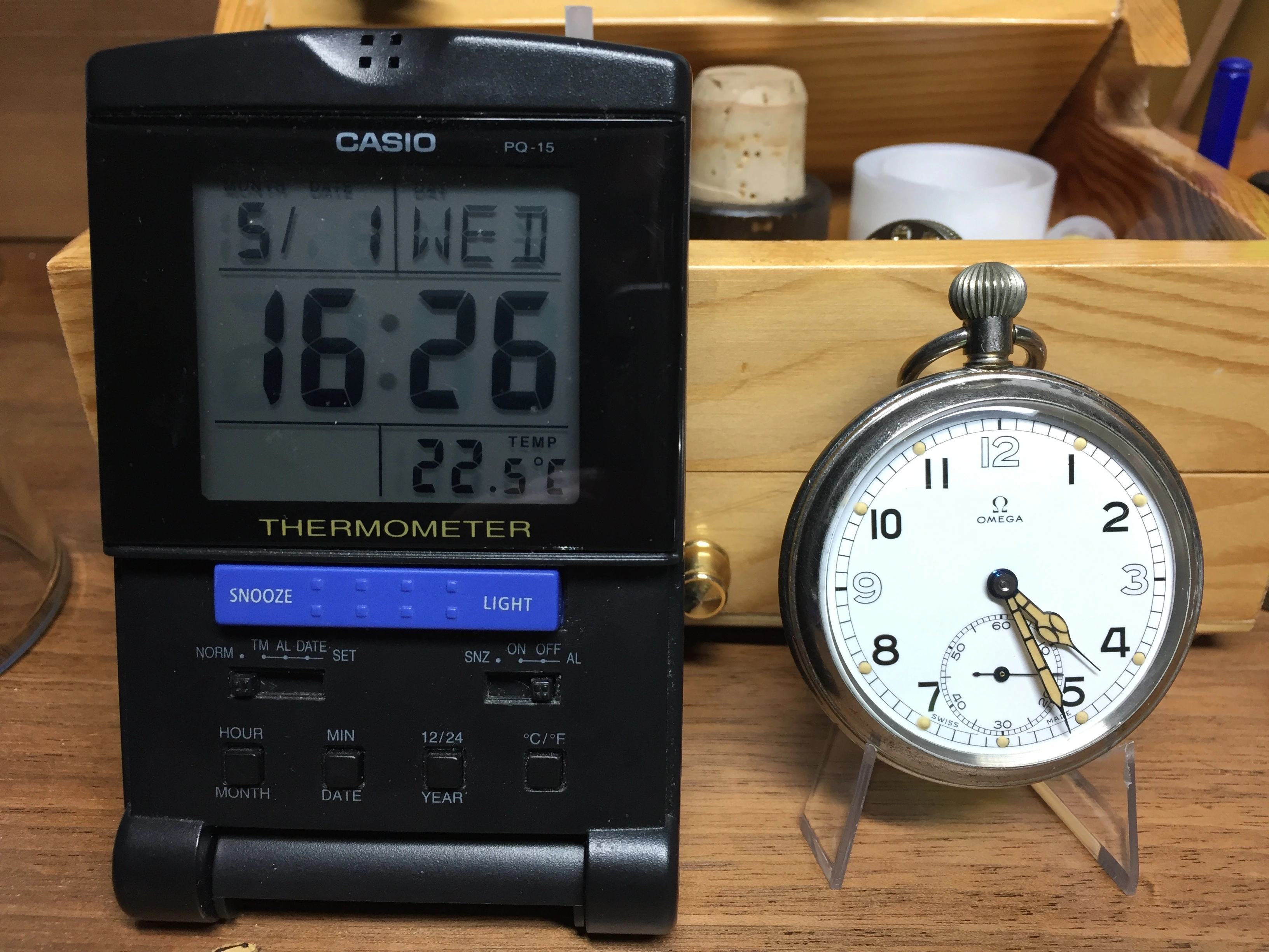

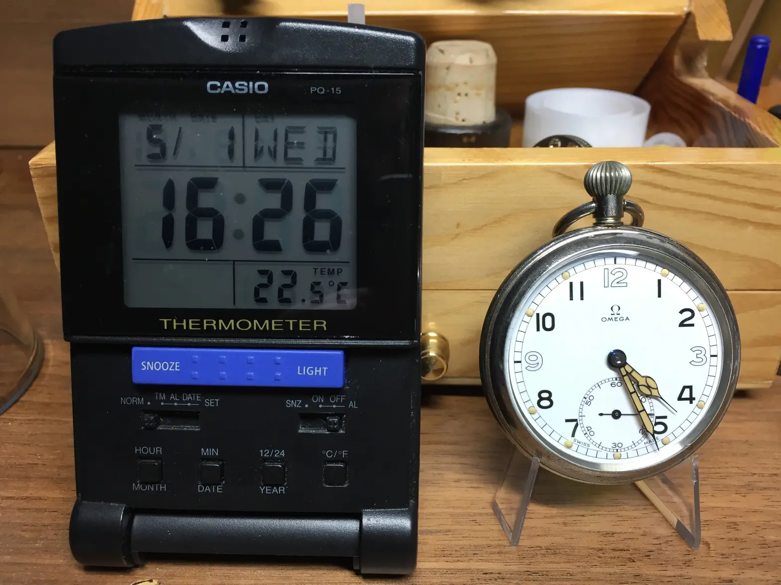

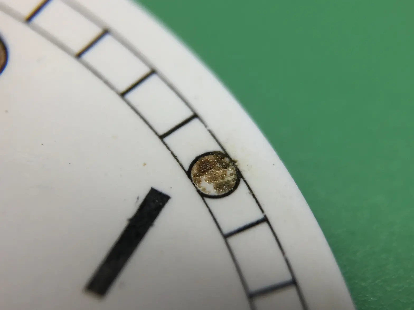

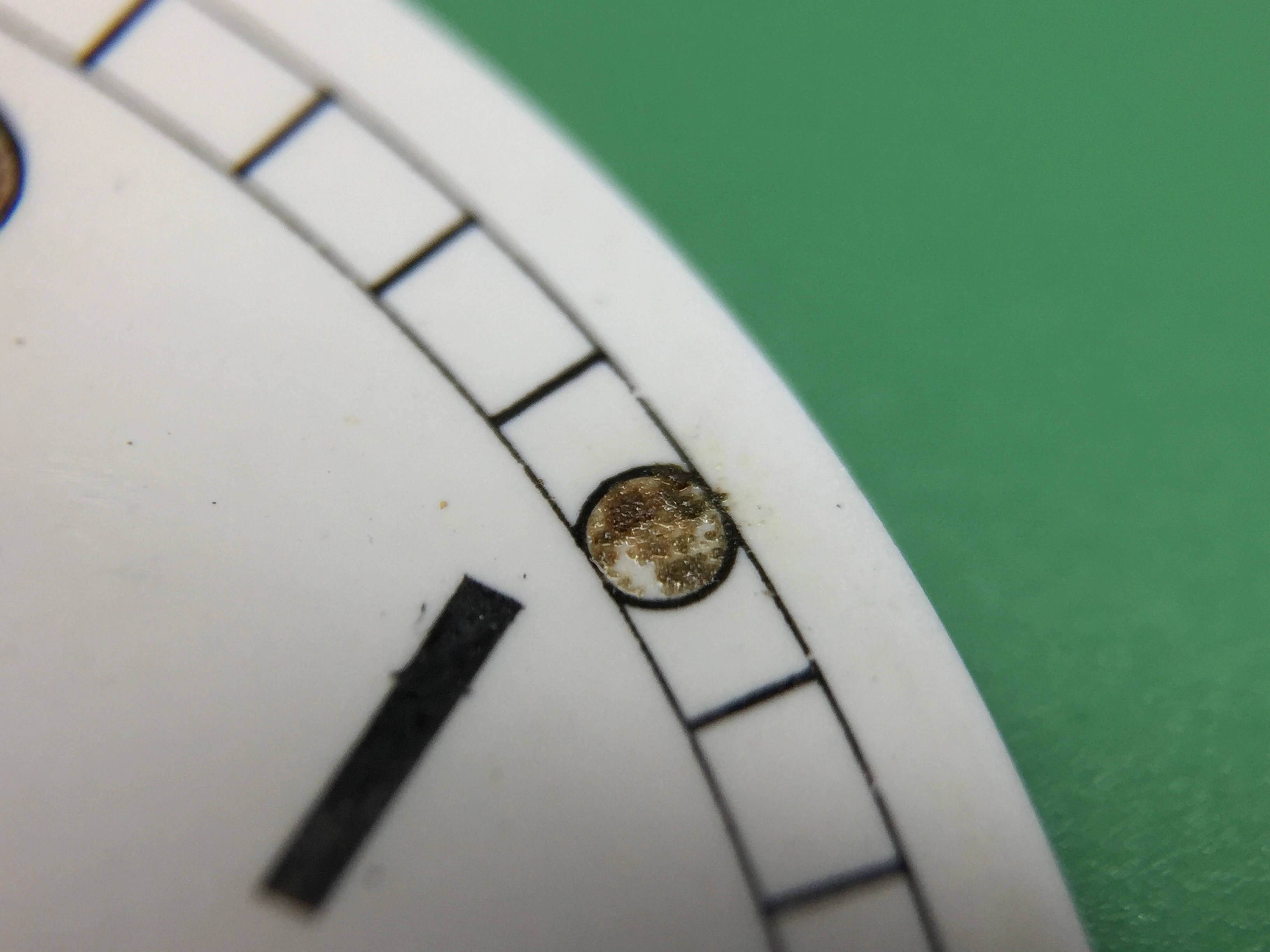

I've used white Bergeon lume with an enamel binder and a tiny amount of enamel model paint in an orange to brown colour.
It came up like aged tritium.
I'll see if I can find a photo of the dial.
18,249
38,055
PS: The paint was Humbrol 24 TRAINER YELLOW MATTE 14ML.
It looks yellow on screen, but IRL it has more of a tan hue.
