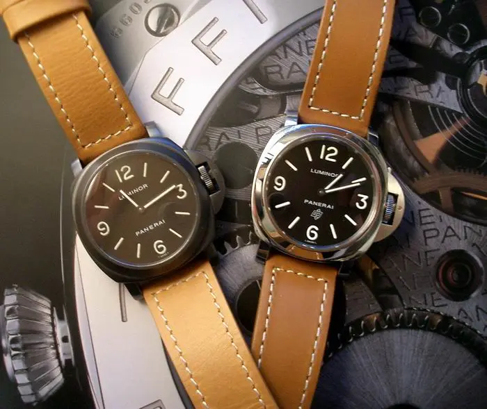

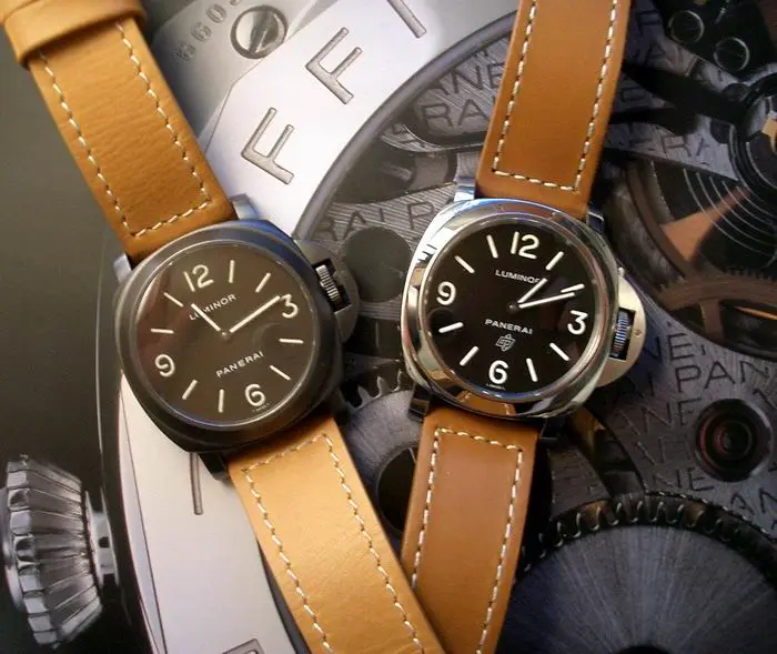

My Panerai is tritium and still look white. I think it would look aged like others, but not.
Could be the result of the mix. Little too much binding liquid or too little. Who knows
Oh interesting, what's the age of your Panerai? Would love to see pictures if you have any handy!
Model is from 1999 before the changeover mid ‘99

Wow yeah those don't look yellowed at all even after 25+ years, interesting!
The s/s one on the right is from 2005 and a L model
