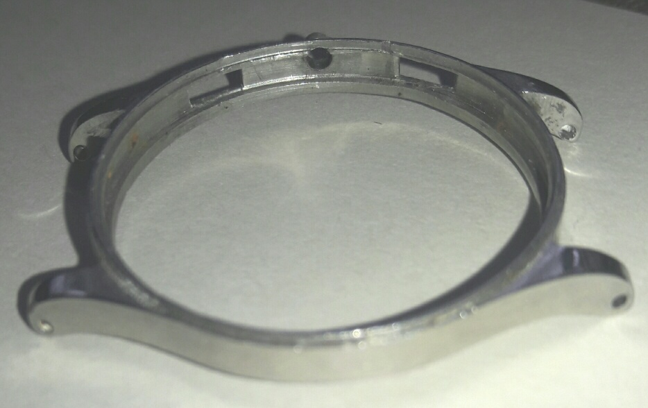

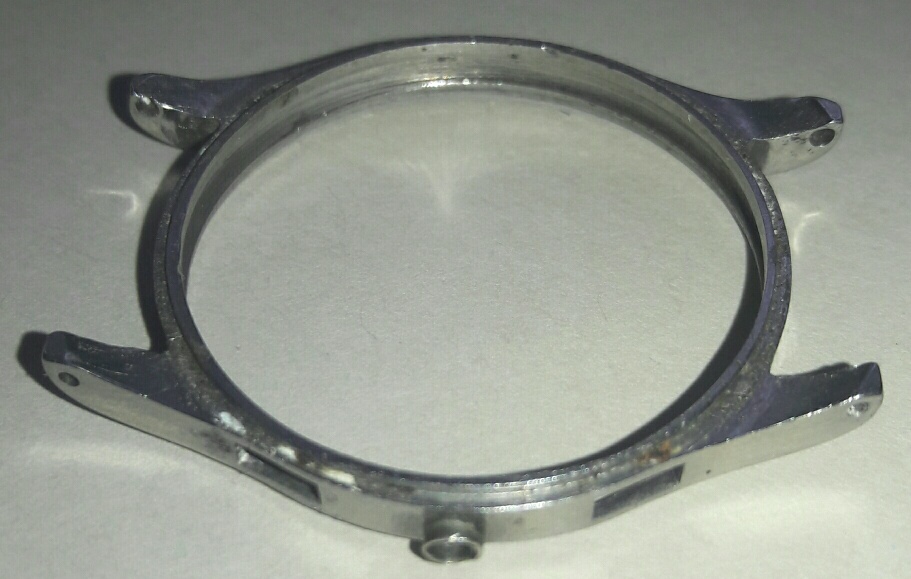

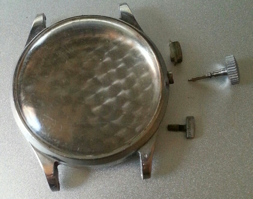

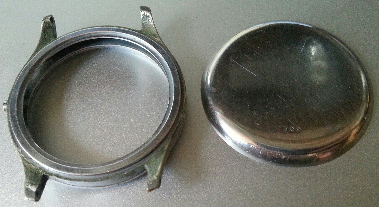

    I just picked up a few chrono cases, one with a flat bezel, 38mm across, dial about 34mm, movement 31mm across. movement height seems to e about 3mm, with an additional 1mm to accommodate the dial

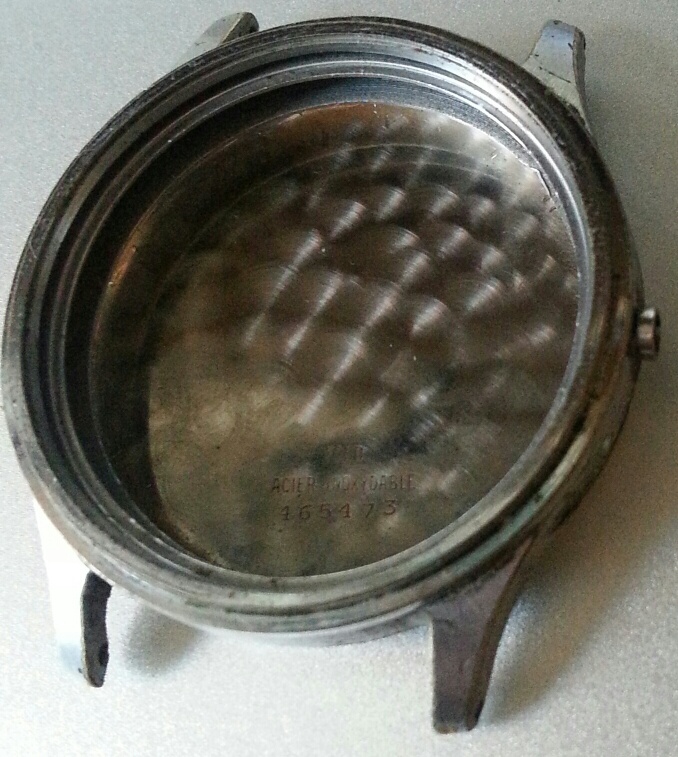

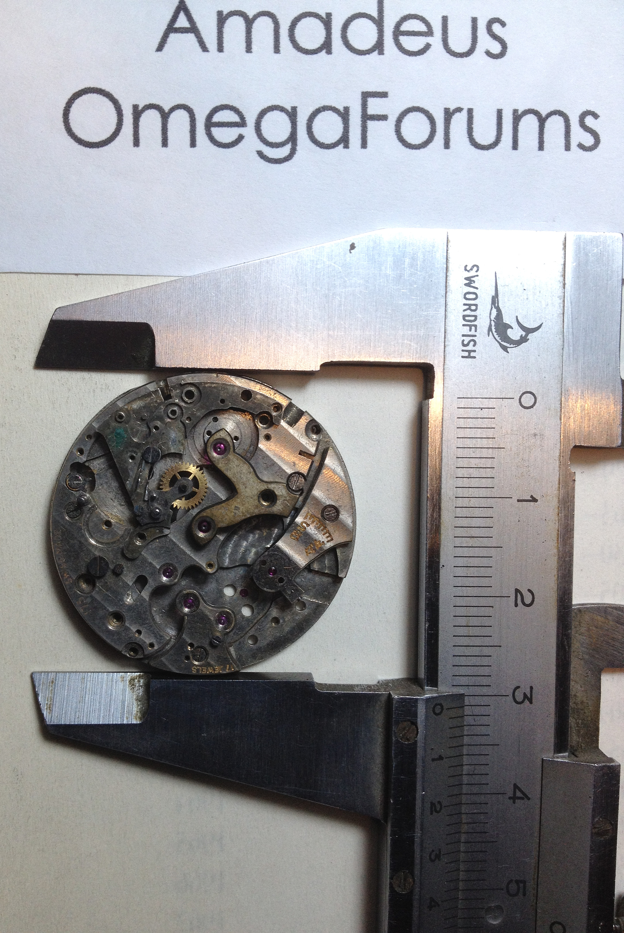

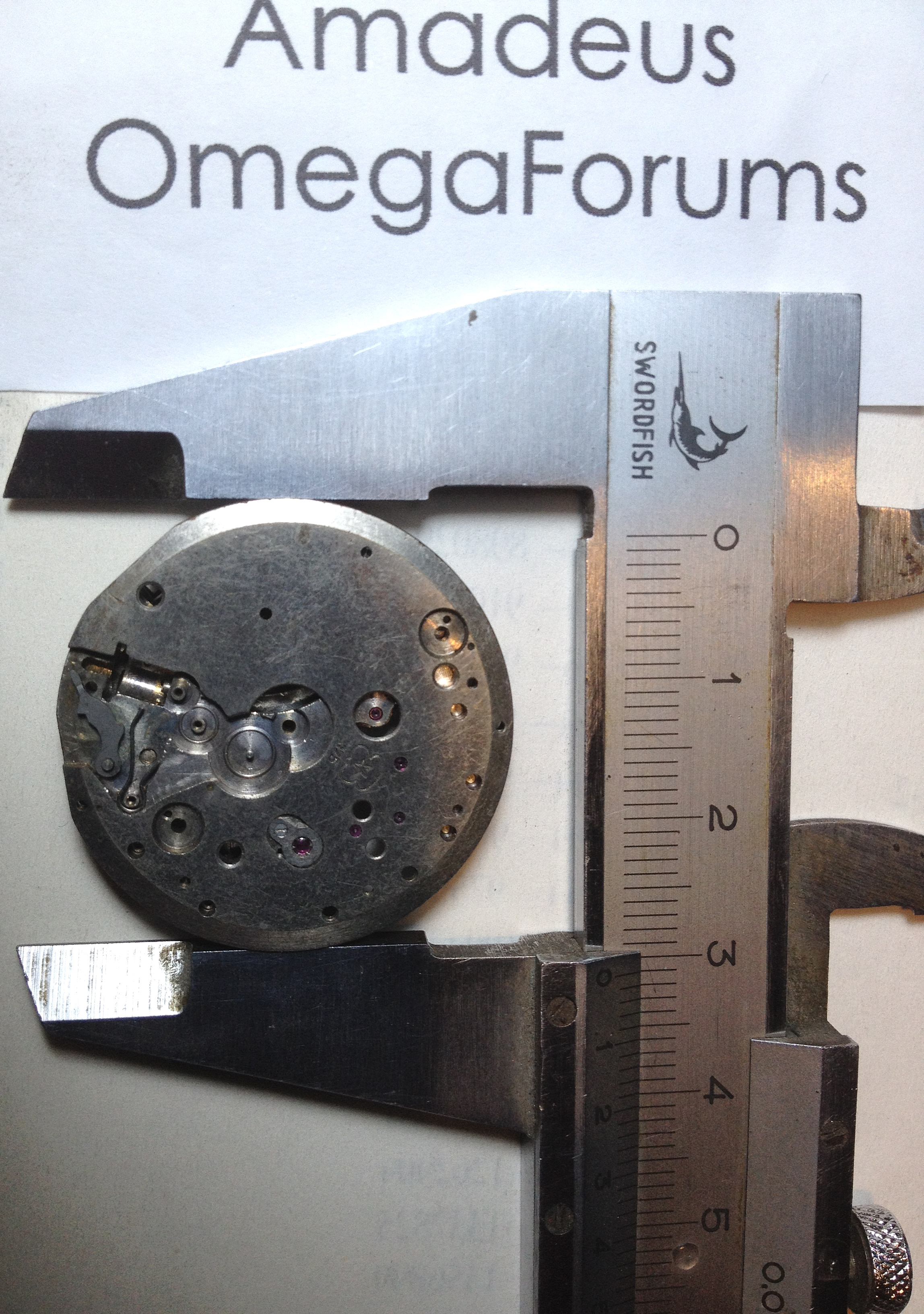

    the other one has a normal bezel, the case is 35mm , movement is 33mm across movement possibly 4.25mm high.
    Neither are marked with anything other than a serial number.
    Is there any way of identifying what movement was supposed to go in either of these please? 20160427_182054_1-1_resized.jpg 20160427_182206-1_resized.jpg 20160427_182522(0)-1_resized.jpg 20160427_182705_1-1_resized.jpg

    Hi, are you sure your movement height measures are correct? There's no way a chrono movement would have just 3mm of height. Revise your height measures.
    The flat bezel case ( 34mm x 31mm x 3mm) number 709 is a Breitling case and the correct movement for it is a Venus 175 like this one:
    As to the regular bezel case I can't tell you for sure until you tell me the correct height dimensions.

    Sorry for delay on this Amadeus but i have been trying to figure out how to measure height inside a case properly. The height of the Venus 175 one seems to be a shade over 5 mm between the base of the case and the bottom of the plate above which the dial goes. Now that you point me in the right direction, I see Ranfft says 5.7mm and I can imagine the plate on which the dial sits is .6mm high so my measurements cannot be as bad as I think
    The other case takes a movement which is about 5 mm high. Can you tell what movement this takes or does the shape of the parts behind the pushers help?

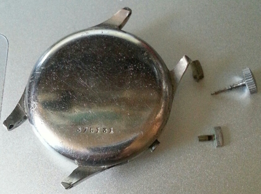

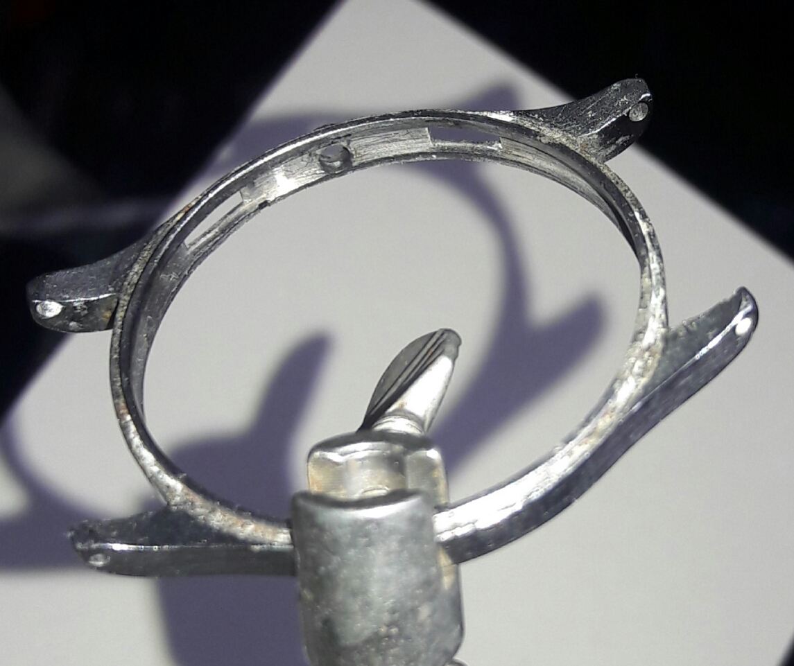

    Hi, could you send me pictures from different sides (including the inside) of the first case (the one with the 375131 serial number) if possible without the glass and bezel, so I can try to figure out which movement could fit the case.
    From a preliminary guess this could be a possible movement that could fit that case:

    Thank you again for your assistance, do these photos help?

    As I thought that case seems to be for either a R Valjoux 22 or a Valjoux 23 movement. My recommendation would be to try and get any of those movements and try them on the case, if you're having problems doing it, try to take it to your local watchmaker.
