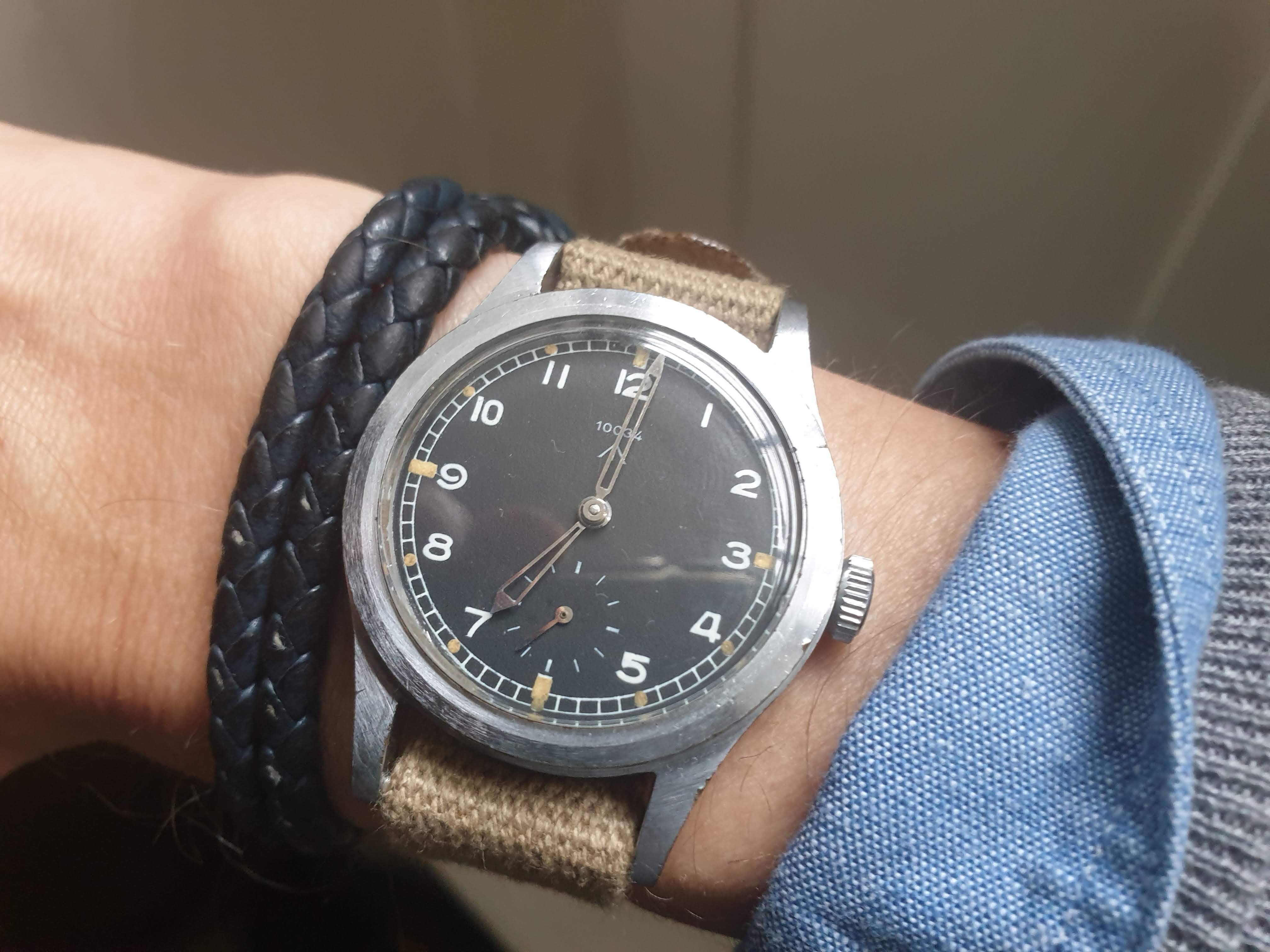

Afternoon all,
I have a piece that is running fast by a couple of minutes a day, and believe this could be caused by it having been 'magnetized' at some point. i have procured a cheap'n'cheerful 'demagnetizer' from eBay, but before i let it go with my watch, is there a way of telling whether my watch is actually magnetized? I believe there is an app for the iPhone/IOS, but not for Android... is there any truth in this?
Many thanks indeed.
