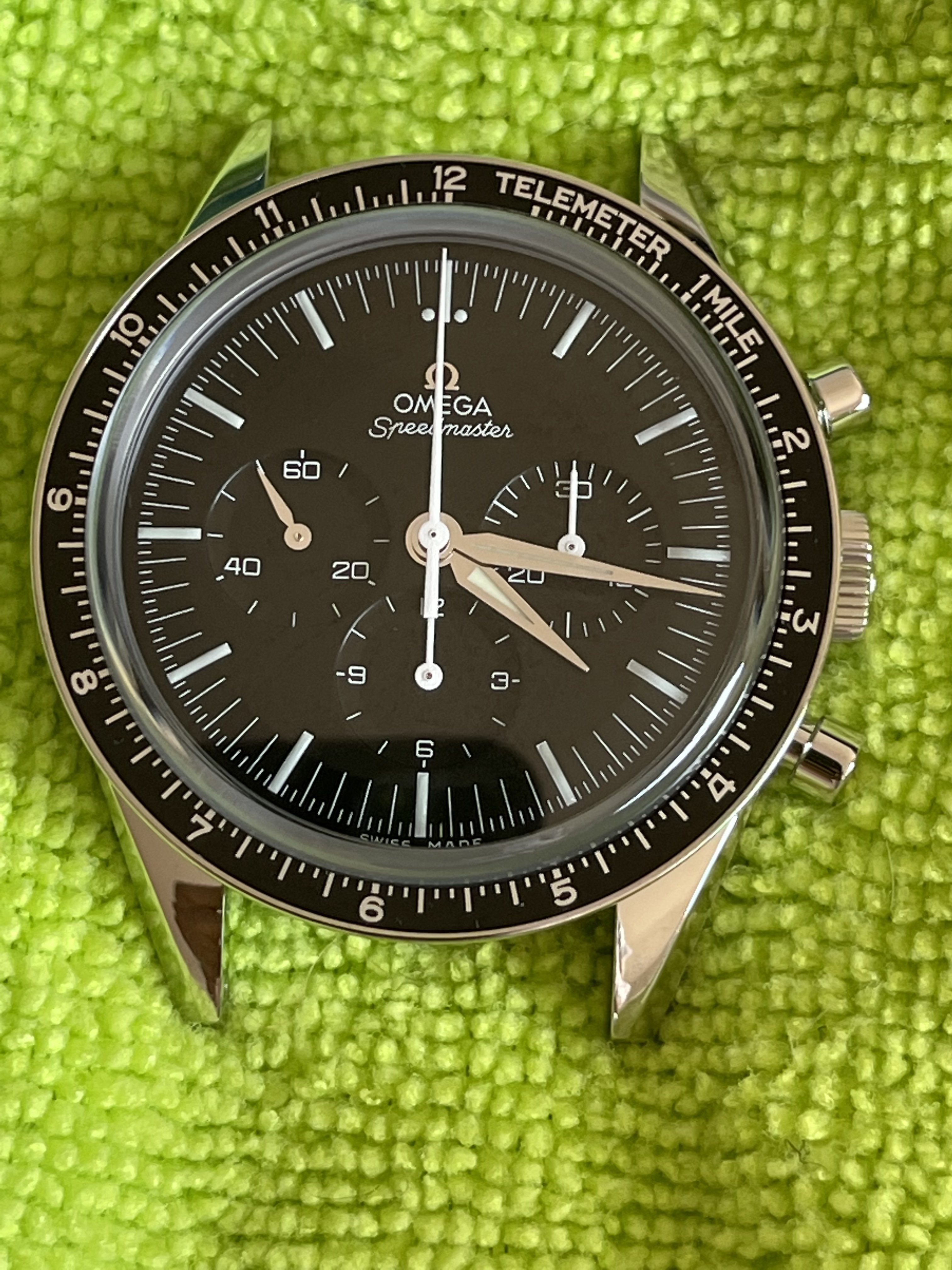

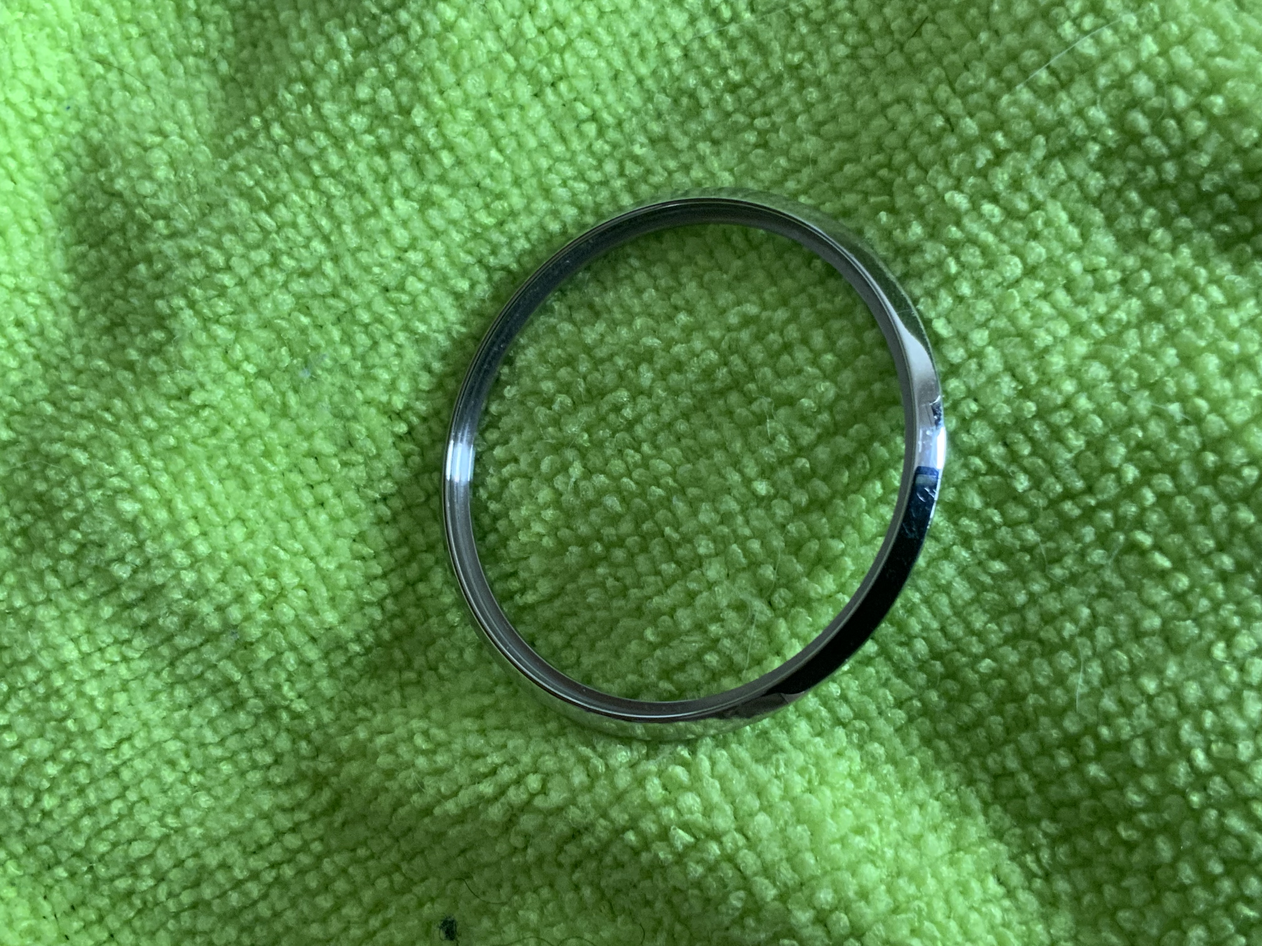

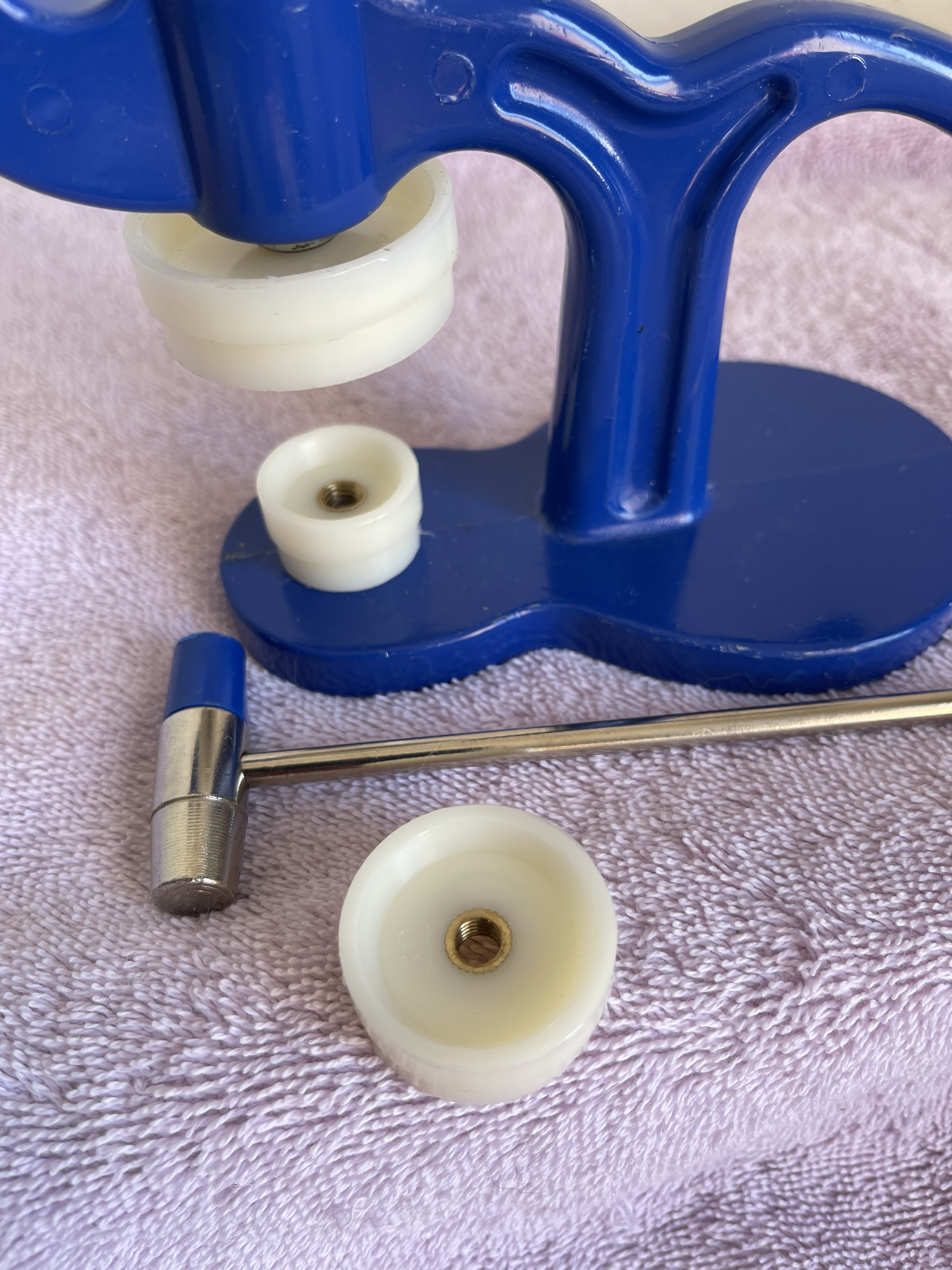

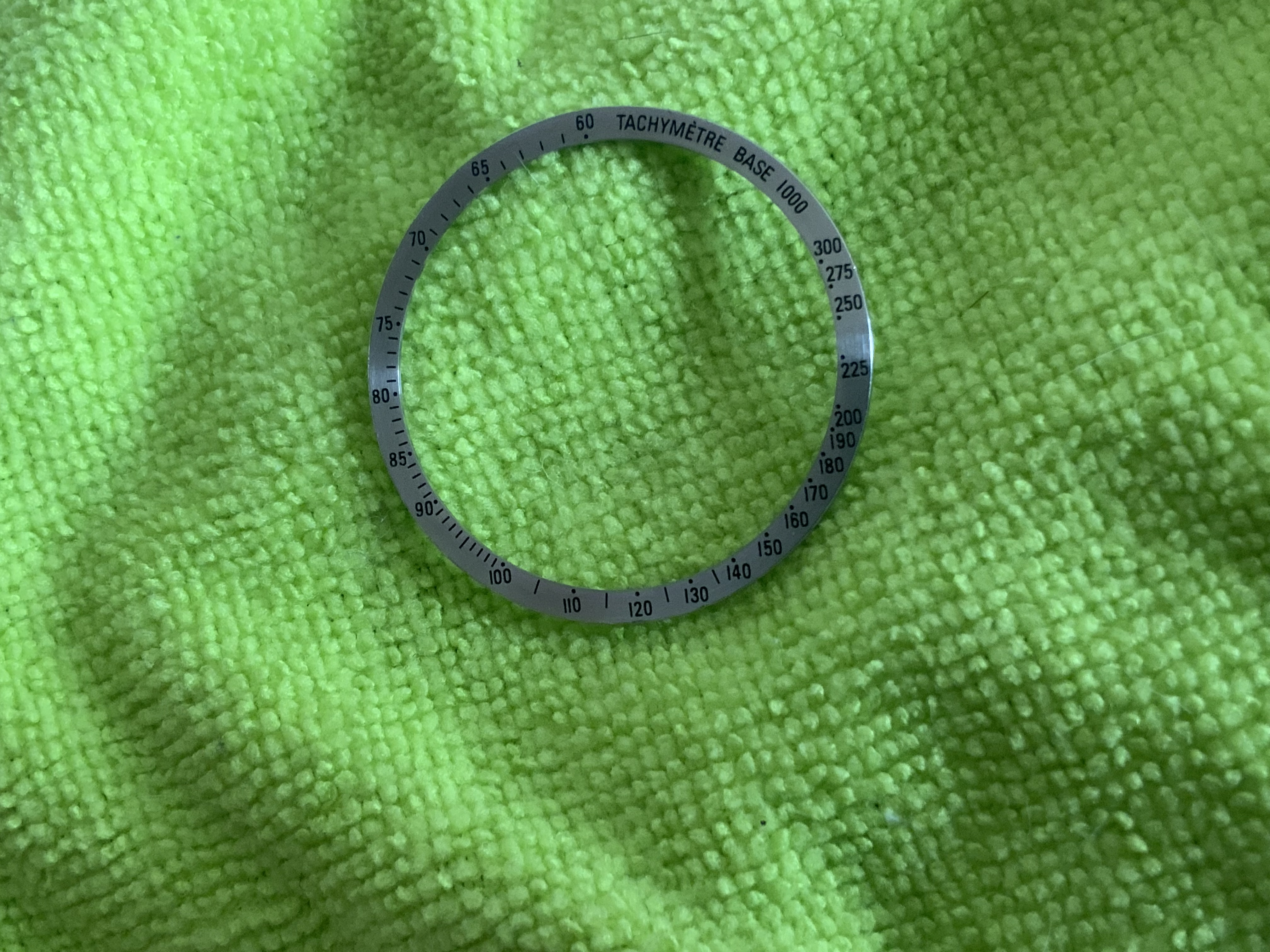

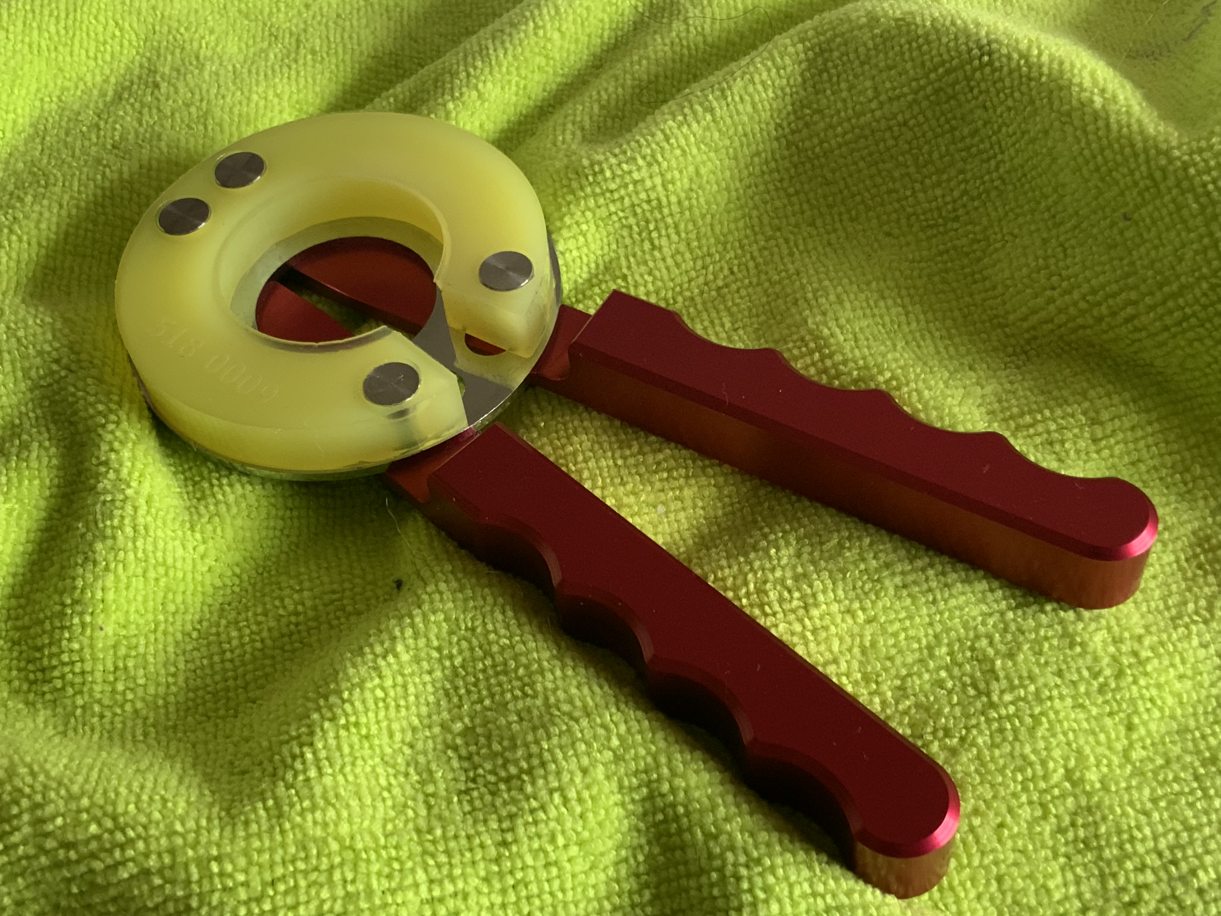

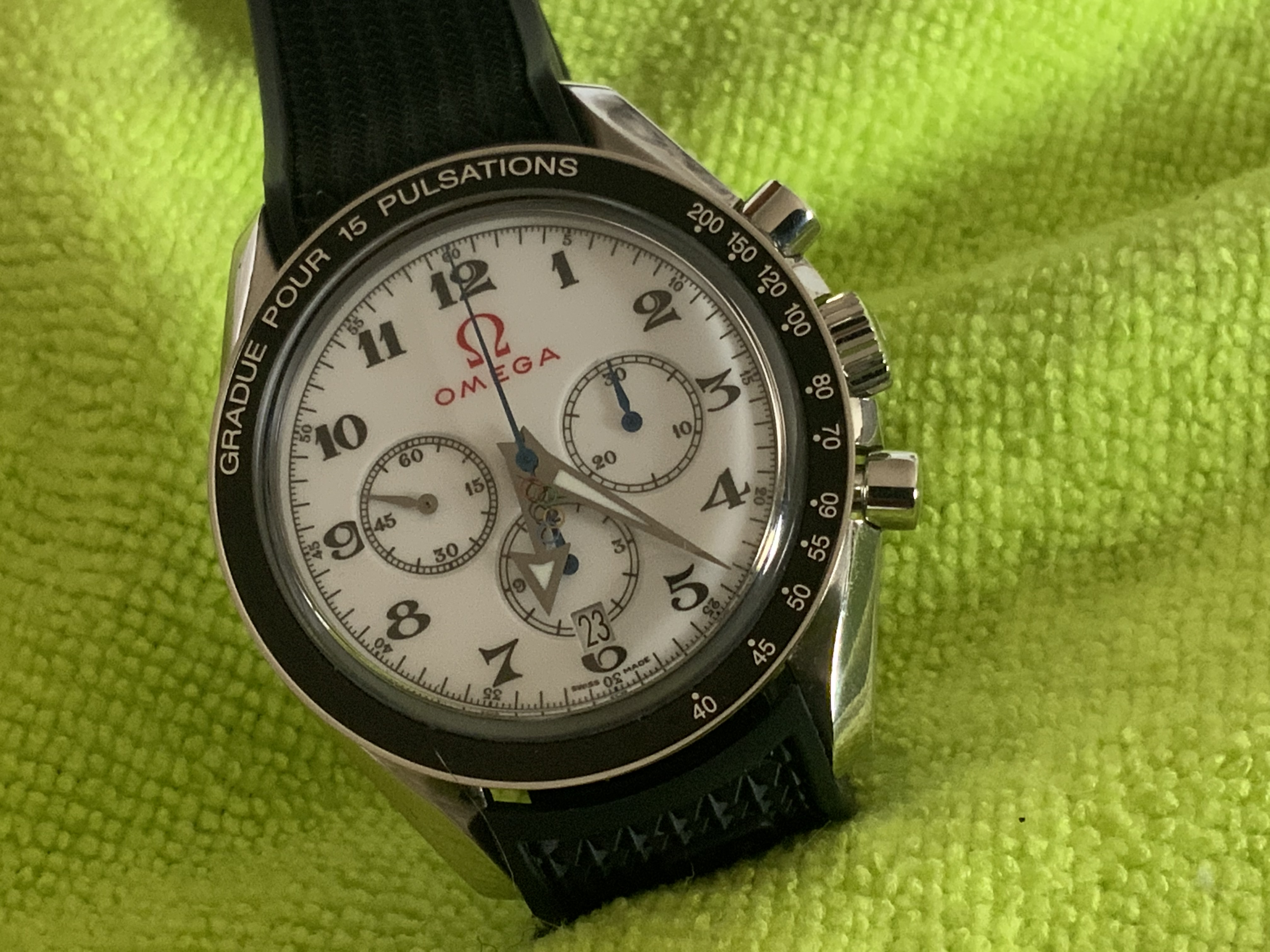

At first, I was very happy being able to remove the original bezel using thi)s tool, quite easily.

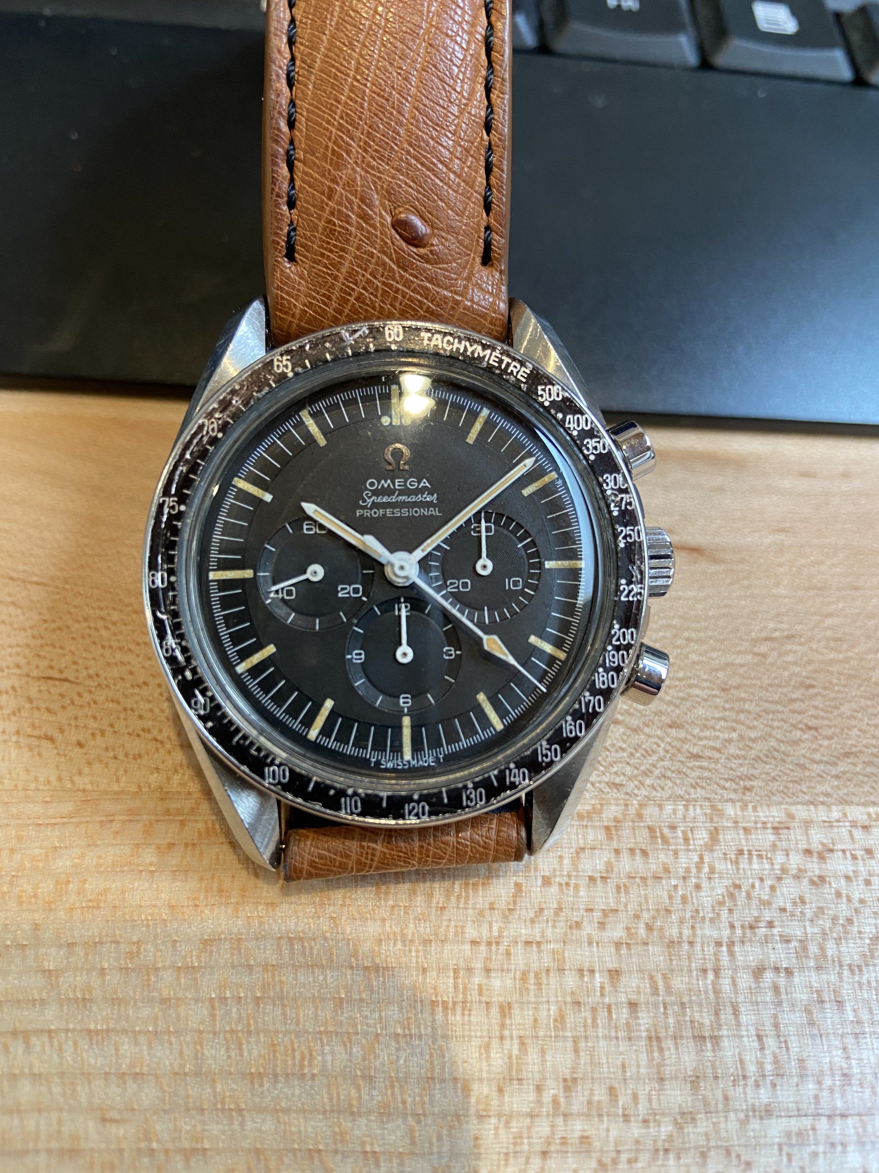

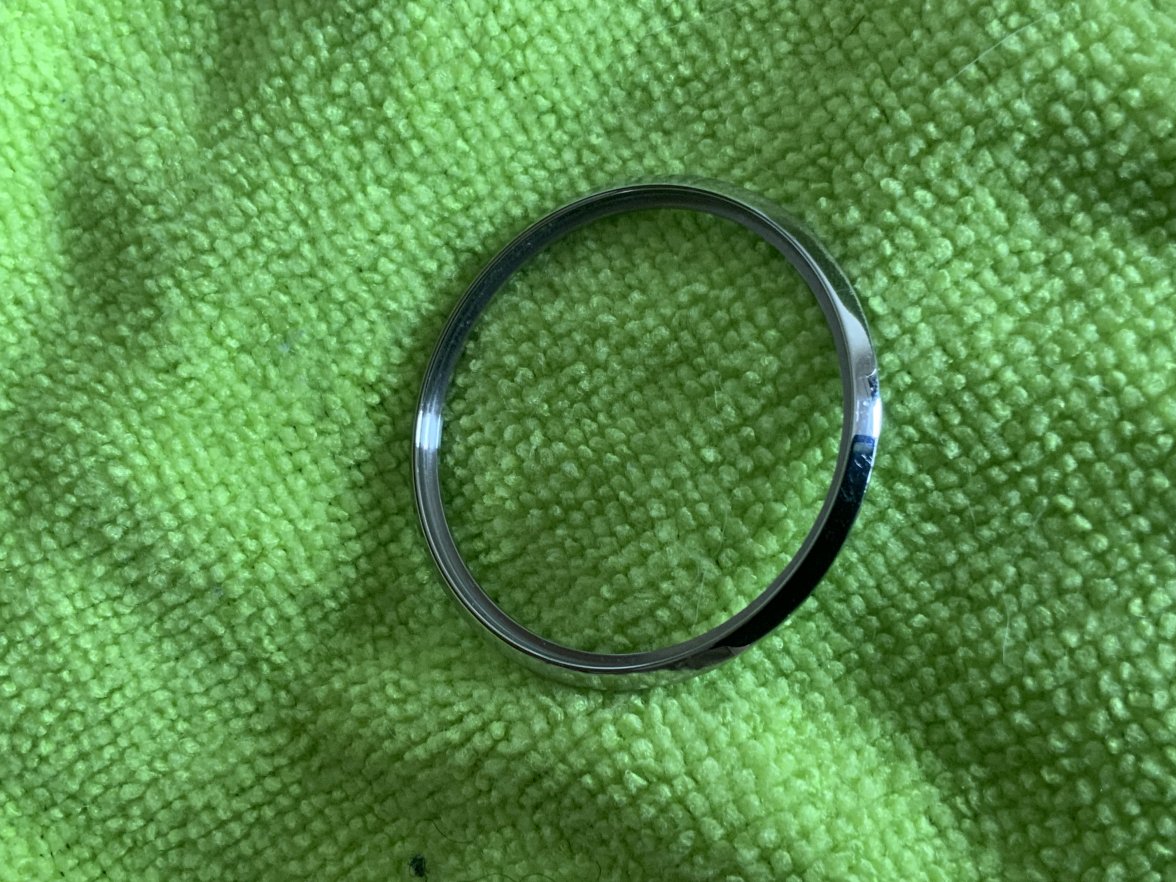

The stock bezel front and back after removal.

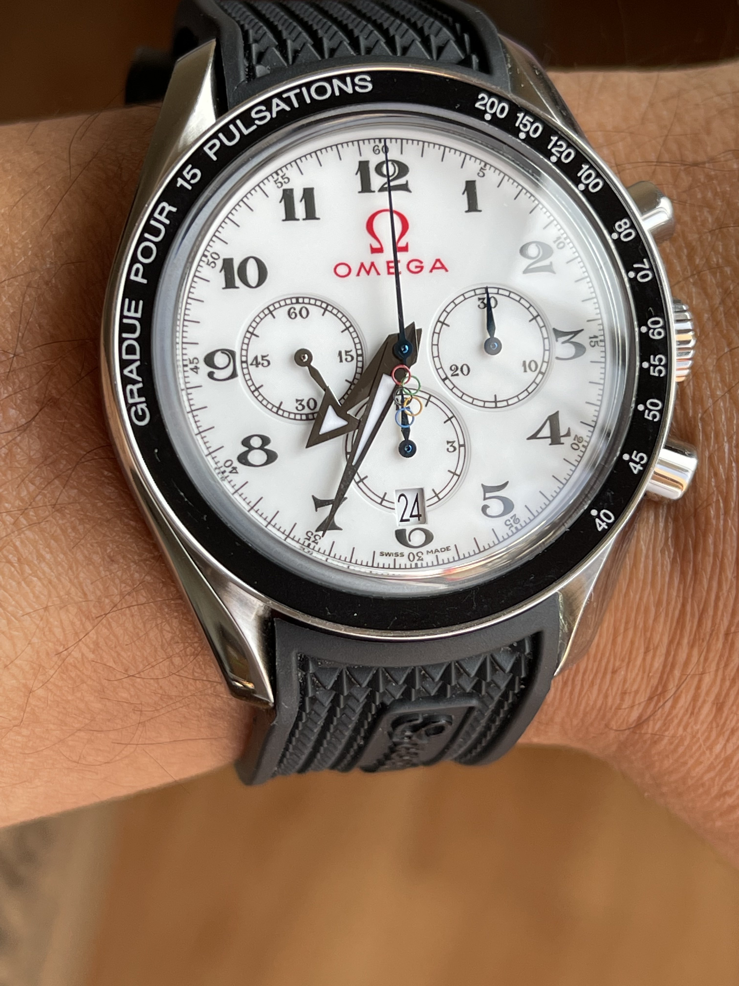

The replacement pulsometer bezel was ready. (soursed from https://www.swisslimitededitions.com/) . I believe it is genuine.

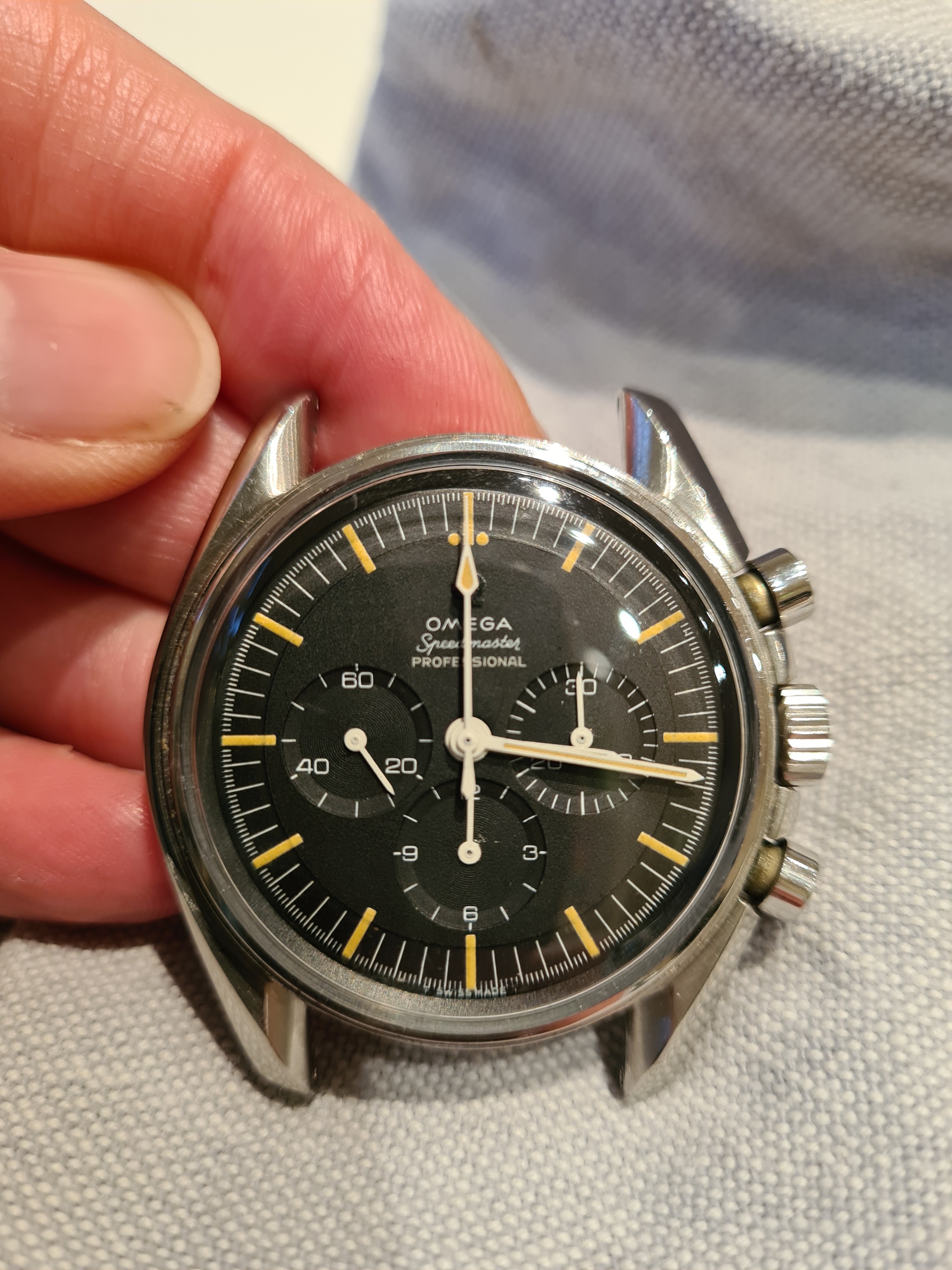

After pressing the bezel on with the crystal tool as recommended from gemini4, bezel fits firmly. Then I found out to be in some trouble. I thought I was not careful enough markers did not line up properly ( 60 on the bezel has to line up to 3 o clock). The problem at this point is I was not able to remove the bezel again either with this tool or the same one as oddboy's gizmo. Please advise, any idea welcome. (the excuse for my sloppiness - I was working the whole night, not slept yet. 🤨😁) Time to give up DIY?
Did you try the poker chip method? I actually use a nylon insert from a crystal press instead of a poker chip, but the idea is the same. Place the watch crystal-down on something cushioned. Place the edge of the nylon disk against the edge of the bezel at a downward angle. Hit the other size of the nylon disk gently but firmly with a small hammer, and the bezel pops right off.
Or go to a watchmaker. 😀

The bezel part number shown is not for that case. In addition, the bezel remover you show is not designed to remove fixed bezels, but is for rotating dive bezels only.
My advice would be to seek out a watchmaker who can help you solve this...
Ah several, lesson learnt. Thanks for your help.
That watch is 321.10.42.50.04.001. Is the bezel for 145.0012 I guess?
Another question popped up in my mind. Will that bezel fit 311.30.42.30.01.005 (speedmaster pro 1861) which I was also thinking to put it on? I like more the appearance of that bezel on the watch.
Thanks again.

I have used the top from an Advil (ibuprofen) bottle that is exactly the same size as a speedmaster bezel. That plus the crystal press works just perfectly ---> watch then bezel then open side of pill bottle top then press on top. Poker chip a là Spacefruit (from Hotel de Paris in Monte Carlo....edge fits under a speedy bezel perfectly!) and mallet for removal if it is not quite lined up correctly.

i got lucky with your method this morning
thank you so much everyone for patiently explaining in detail
now the bezel is alligned as it should. 😀😀
hopefully it won’t fall off

another bezel swap, decimeter service bezel on 1861 moon pro

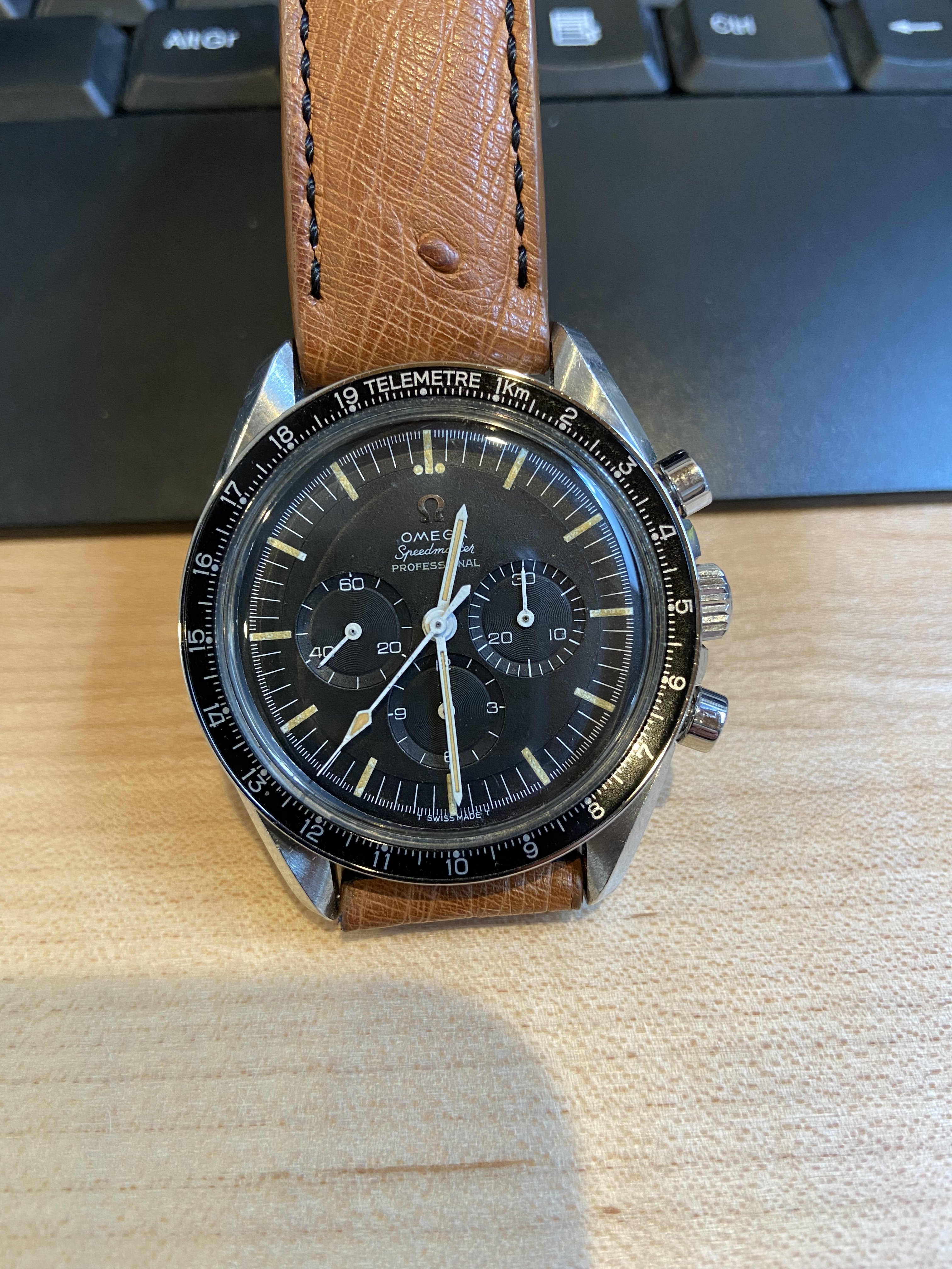

finally telemeter service bezel on fois
need to realign

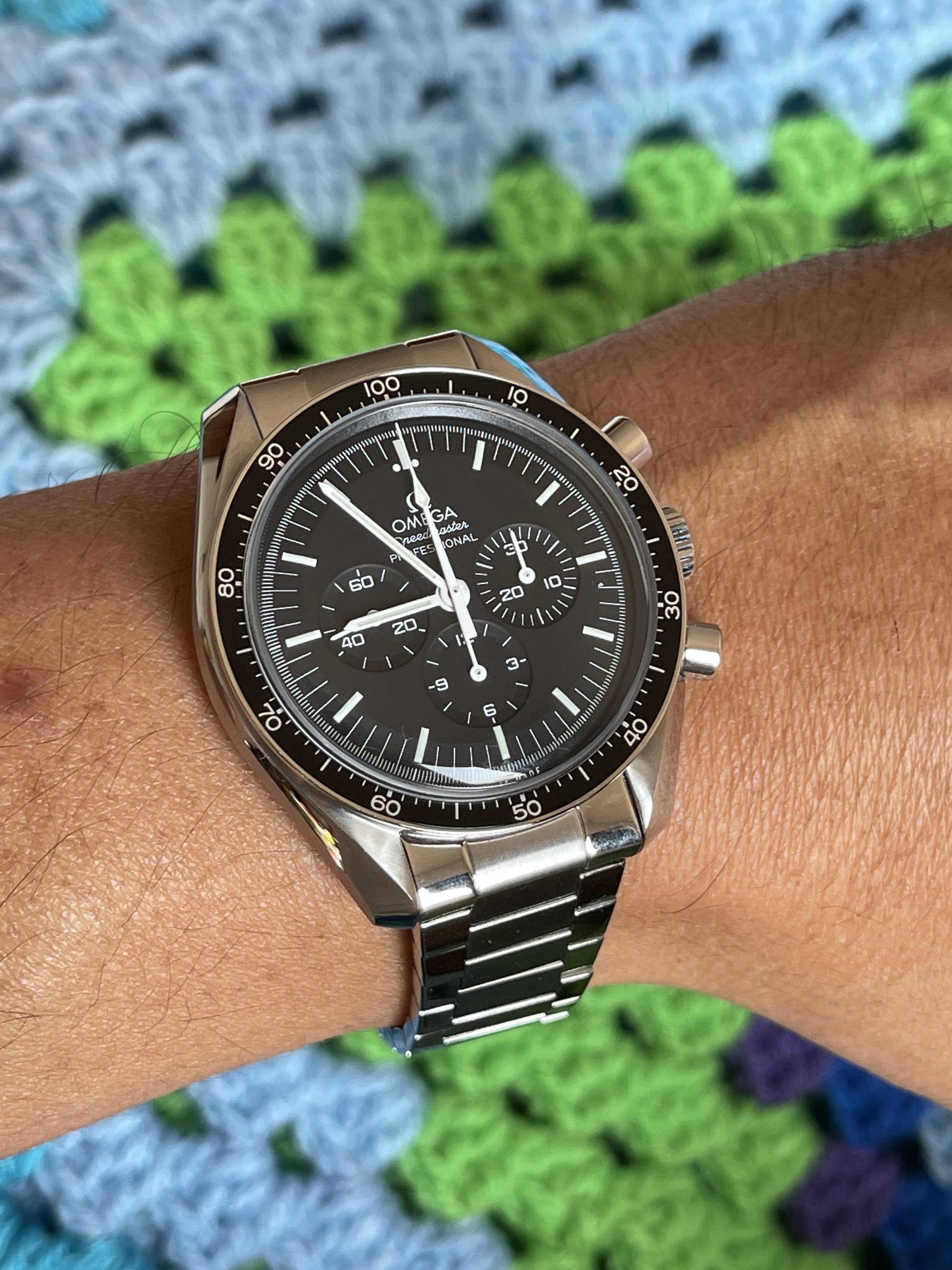

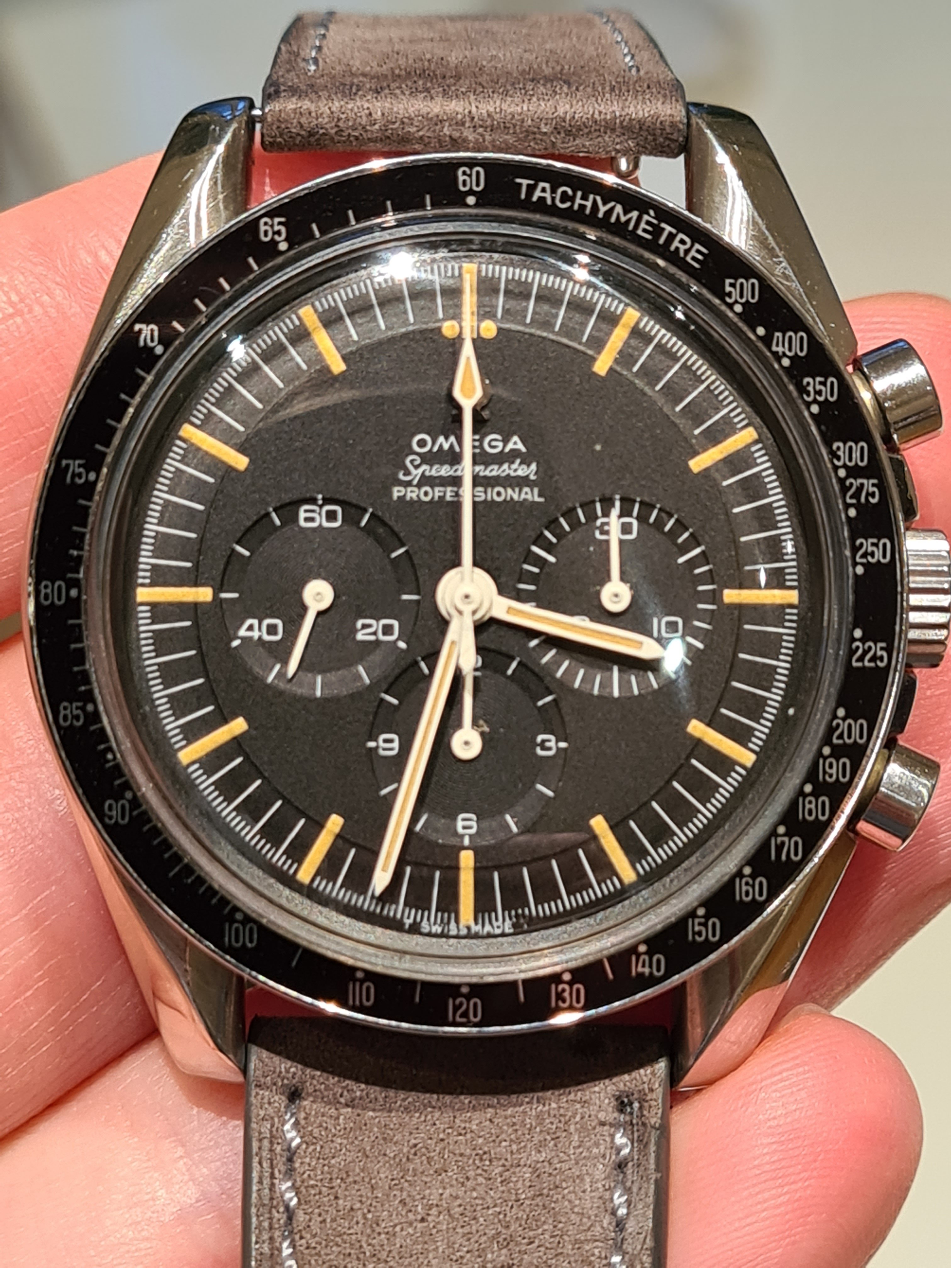

Just did my first bezel swap, thanks ya bunch of enablers! 😉
A nicer bezel makes a big difference and though I am not a good enough photographer to capture it, the newer bezel really brings out the brown in the dial.
Before:
After:
and no, it didn’t take me 2+ hours to do it, it took two hours to build up the courage to do the 10min of actual work. 😉

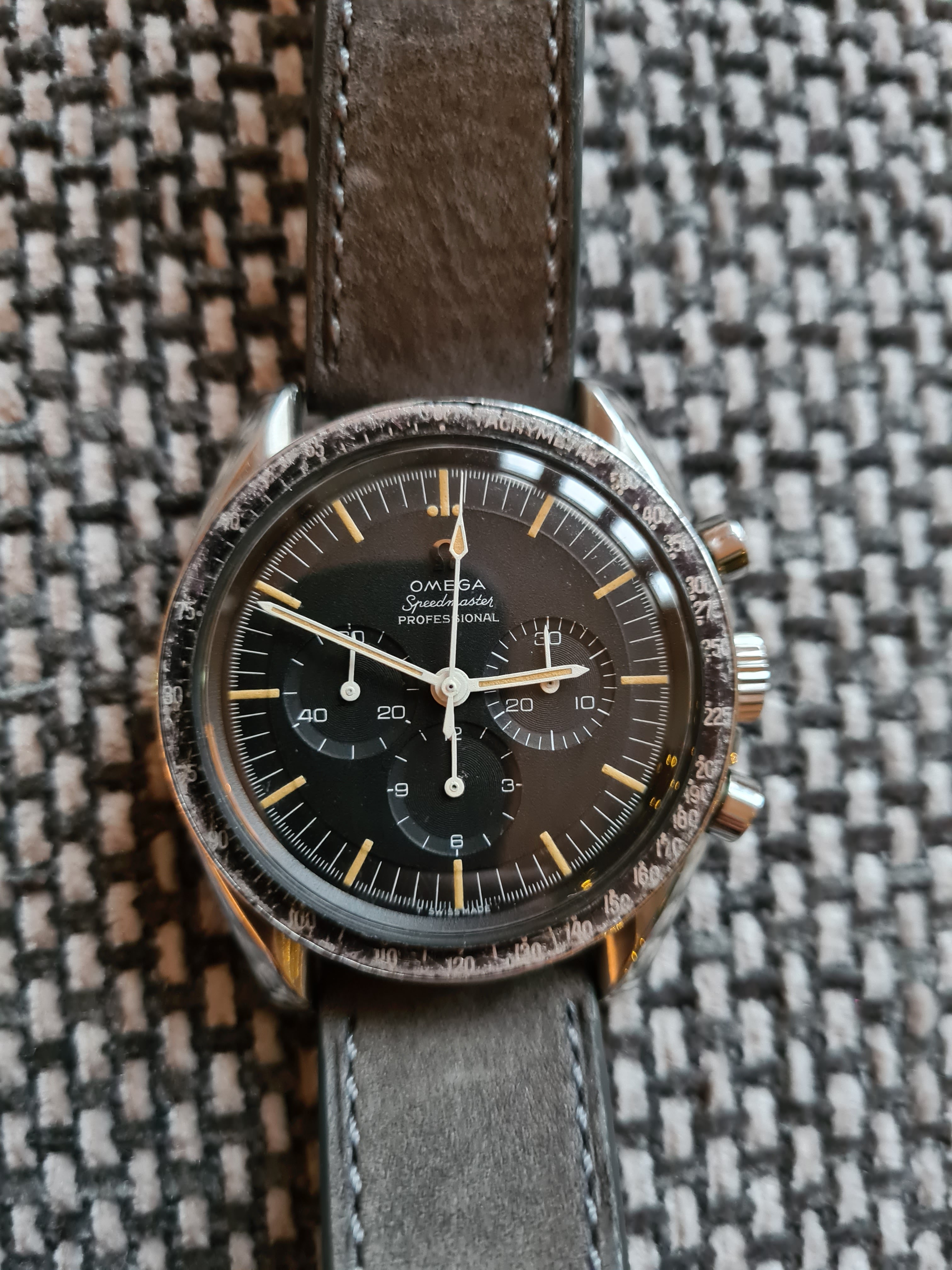

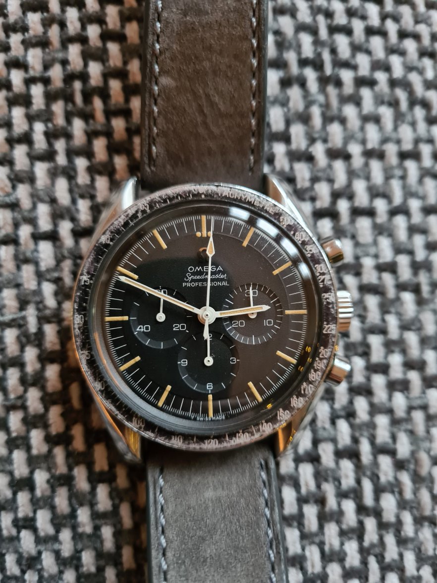

OK so I did it.... I didn't have a poker chip or a watchmaker's hammer so I used a nylon disk from my case press and a proper hammer instead, but other than that the "speedmaster 101 method". Took me a few strikes as the first ones were too gentle, but on the 4th or 5th go it popped right off with no damage whatsoever.
The replacement was put back on with a cheapo press from ebay and is not OEM (and sold and priced as such) - I have no interest in spending a few k on a genuine DON. My original DON is now safely stored away and I'm happy with how the watch looks. Plus I don't care if the bezel gets dinged ;-)
Before
During
After
