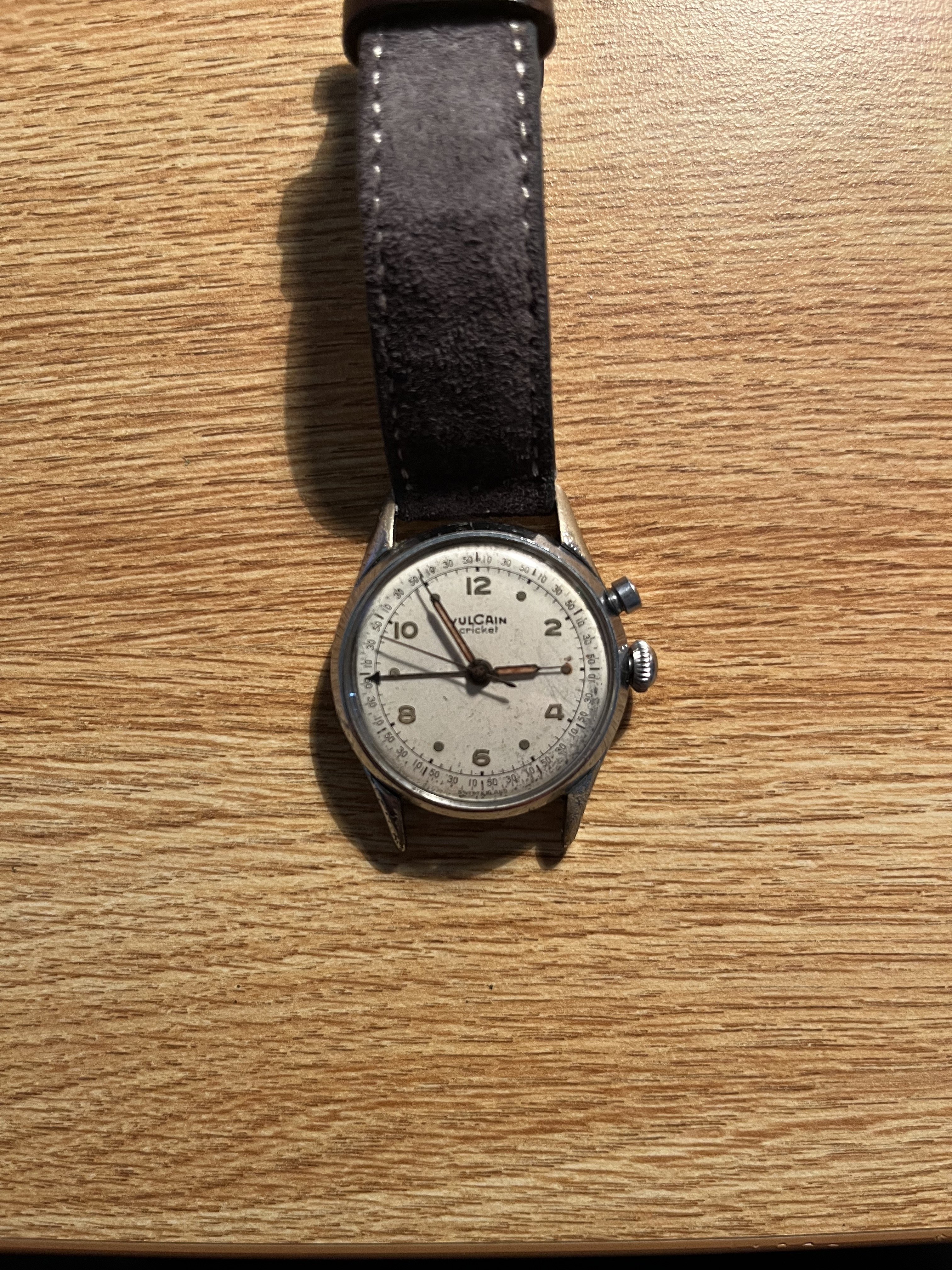

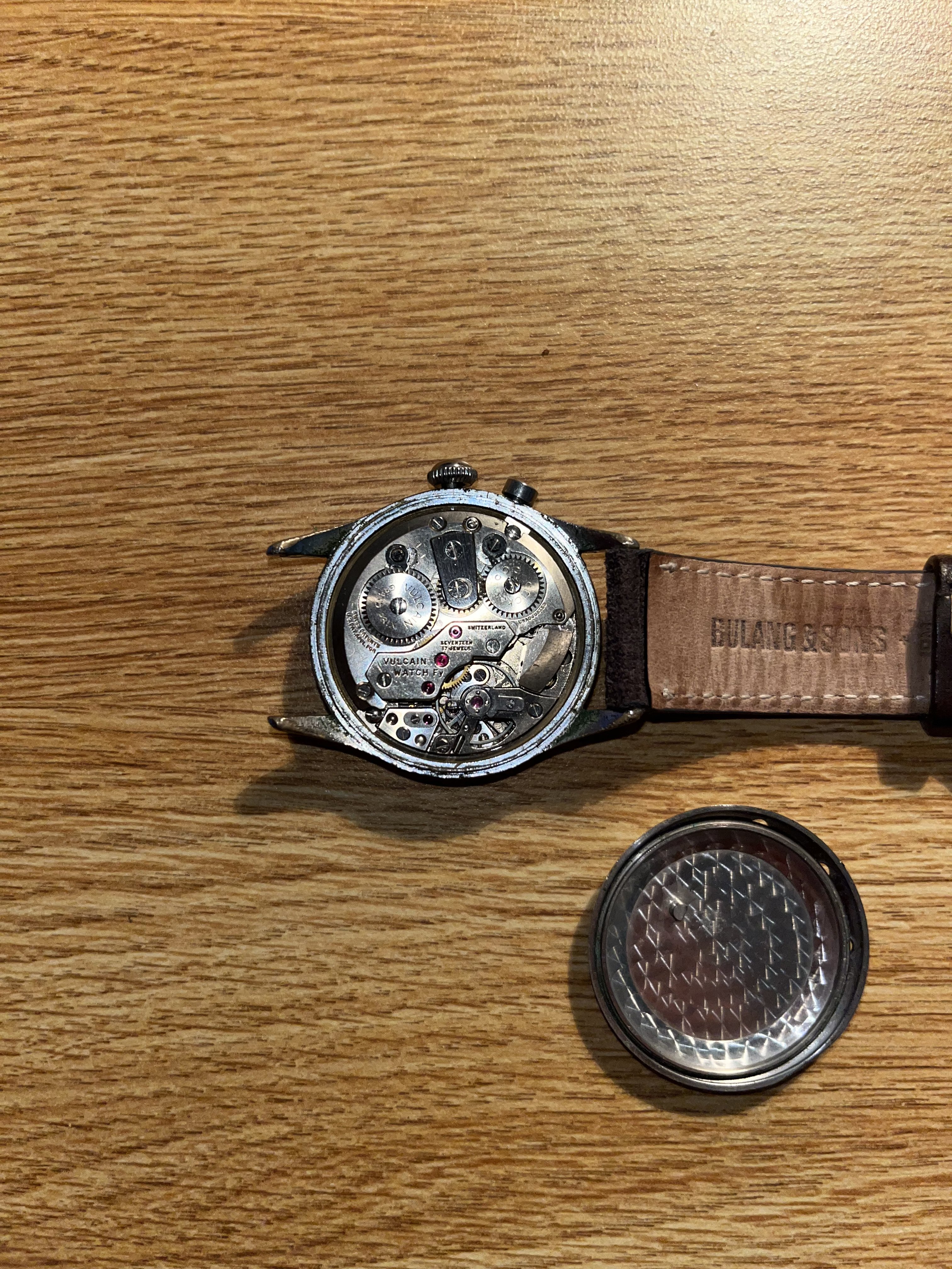

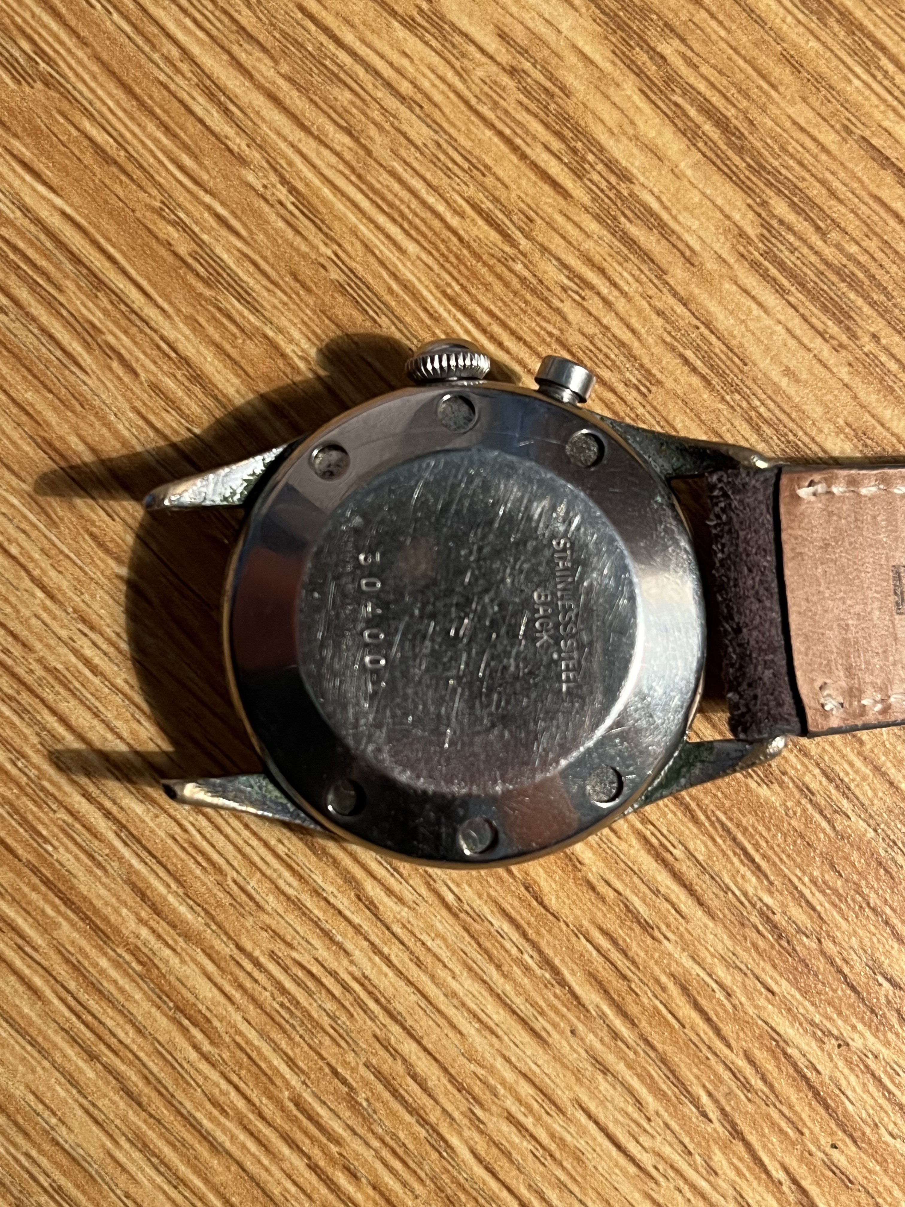

How modified is this Vulcain Cricket 304001?
I've come across this Vulcain Cricket (ref: 304001) and can't find any records of this dial with this case (series 2 and I believe it is chrome plated with a stainless steel caseback) and movement. I'm fairly sure the hour and minute hands are aftermarket -- aside from them, wondering if anyone has come across something like it.

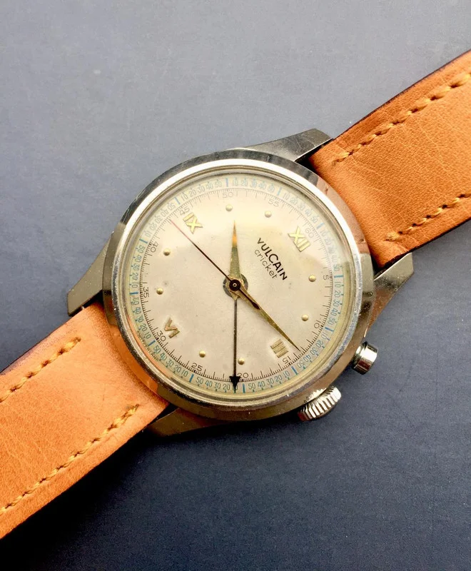

the pictures of the dial are terrible but it looks ok to me. I can't tell if the dial is lumed. the hands look like radium, could be original if the dial is radium. but again hard to tell from these pictures

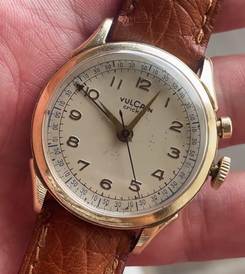

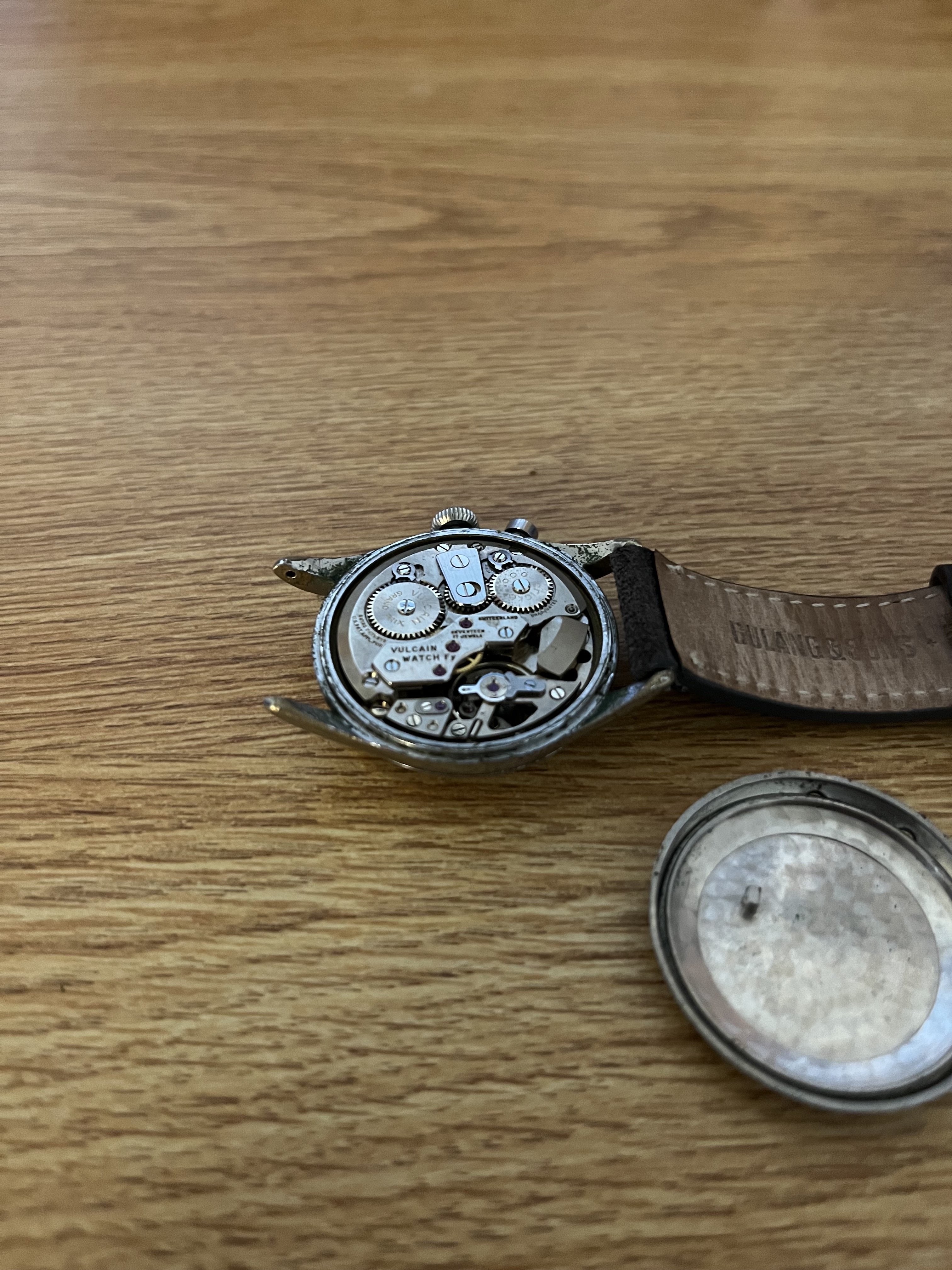

I recently acquired this Cricket, no markings on the caseback. Gold plated with a stainless caseback, but the case design looks similar maybe?

If there is no marking on the case back, the watch is probably imported in the usa

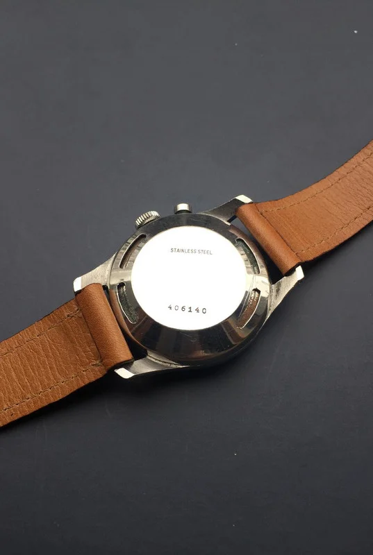

Numbers on the back are a case serial number I think, not a ref.
Hour and minute hands are wrong I'd say, I agree.

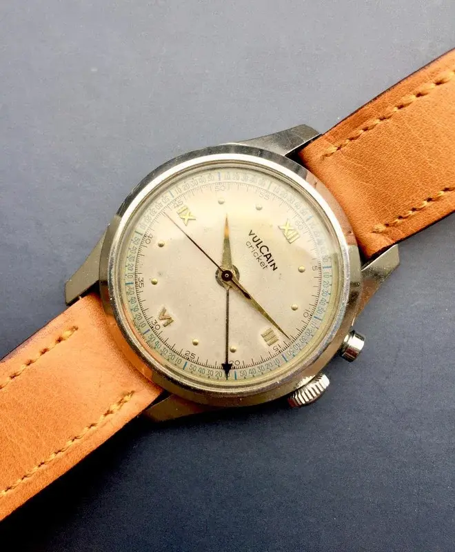

This is mine, no lume:

The first series of the Cricket had serial numbers on the back starting with a 4. The holes in the case back were openings. The second series had reference numbers on the back starting with a 3 and round openings.
