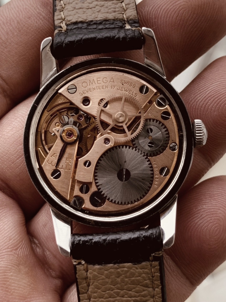

Noob question. I own this cal 285 for a while and wear it from time to time (not frequently). Watch was serviced by skilled man lately (Sep 2022).
My cal 285 (case ref 14390-62-sc) needs at least 50 full turns before full wound, ie crown turning cannot wind main spring anymore.
It is common/normal? How many turns should I wind on cal 285? Thank you in advance.

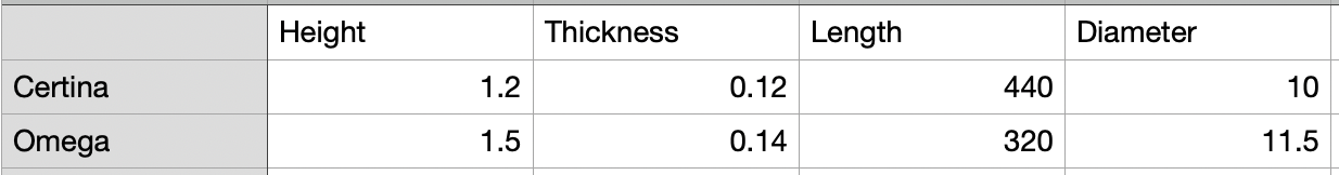

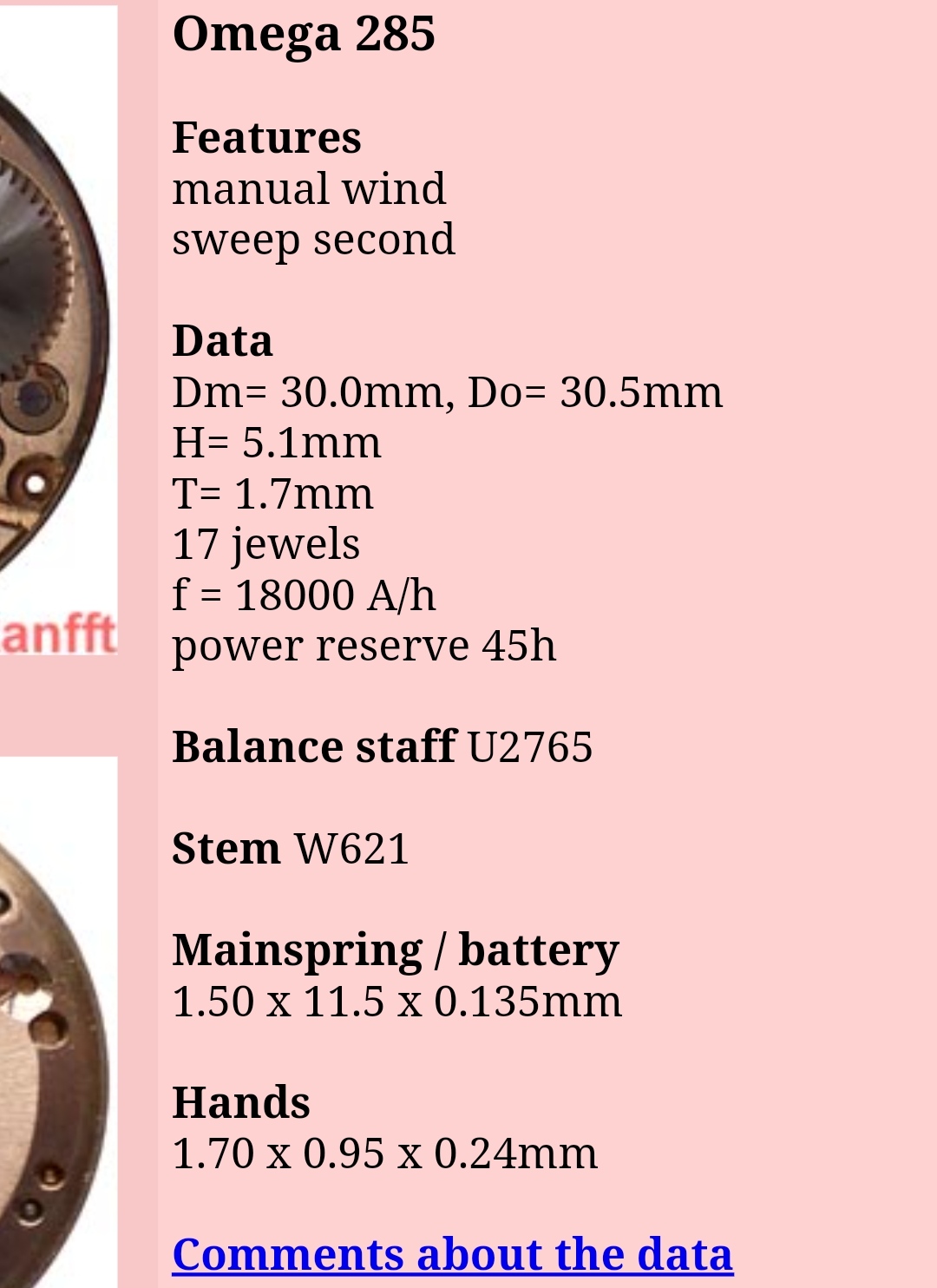

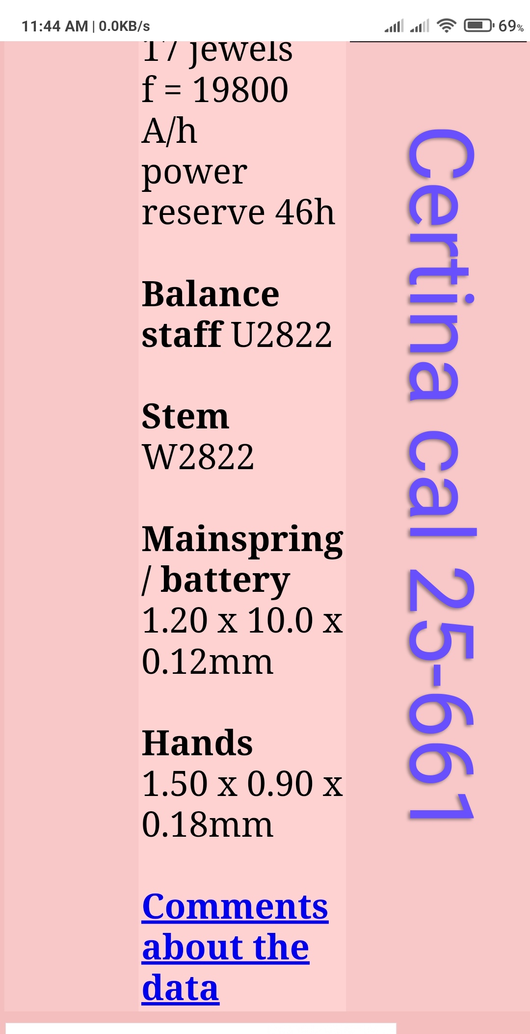

Plelase for my education help me to 'decifer' these data (pics below).
I only need 20-25 turns to full wind Certina while on cal 285 I turn more times that that to reach the 'peak', ie I cannot wind anymore.
Note that crown diameters are roughly the same on both 285' Omega and 25-661 Certina.
Thanks in advance.

The crown diameters are irrelevant, a revolution is a revolution.
If we look at the specifications of the two mainsprings we can see minor differences.
The Omega mainspring is taller, slightly thicker, shorter than the Certina and of a larger diameter (mainspring barrel) than the Certina.
The thickness usually indicates the strength, or stiffness of the spring.
So the Certina spring, being longer, would take more revolutions to wind into a smaller barrel, assuming that the gear ratios of both watches was absolutely identical, which is unlikely.
The only way to confirm "required number of revolutions" would be to measure both watches from dead flat using a graduated crown winder.
But I really wouldn't bother, just enjoy both watches.
