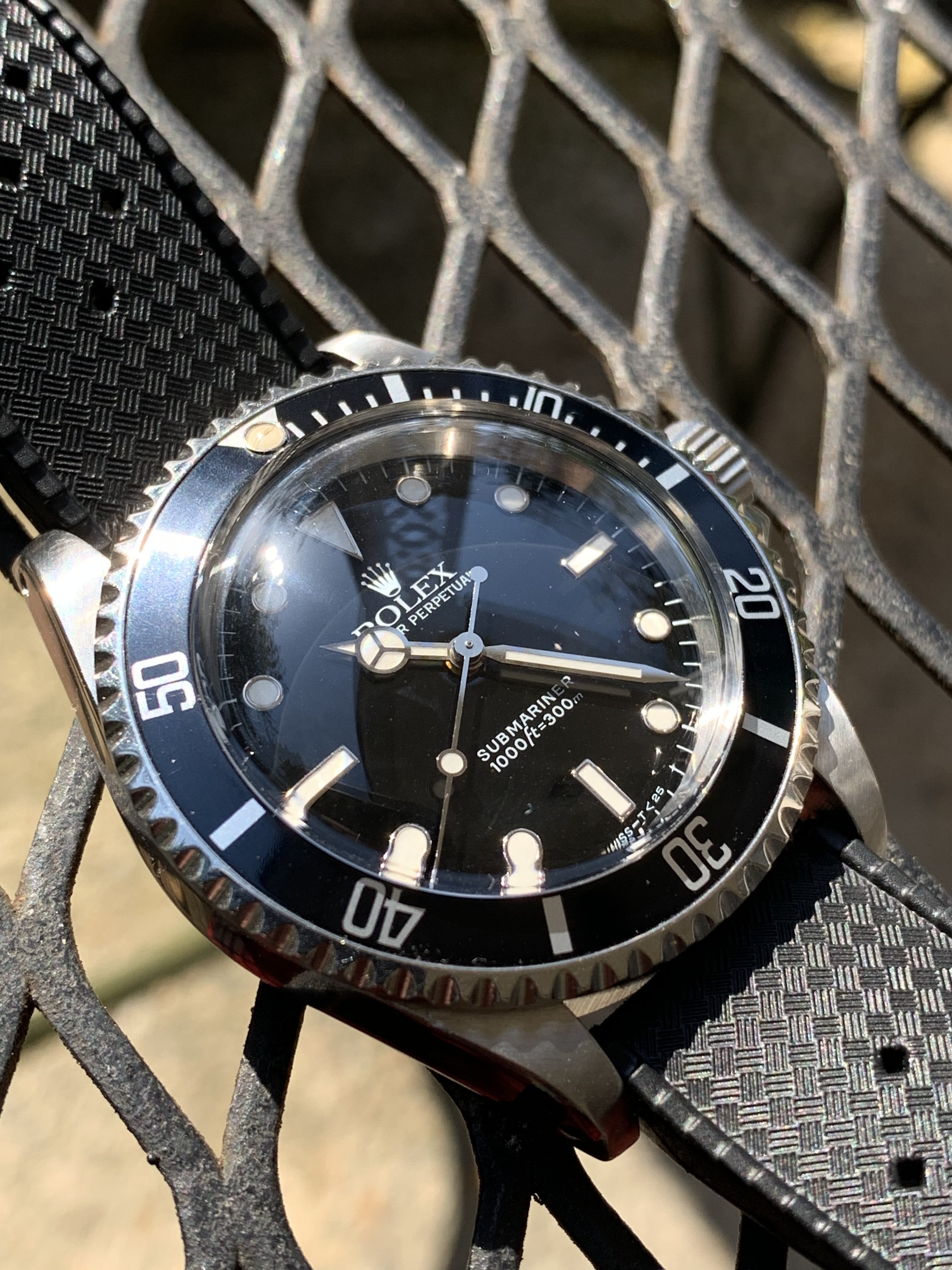

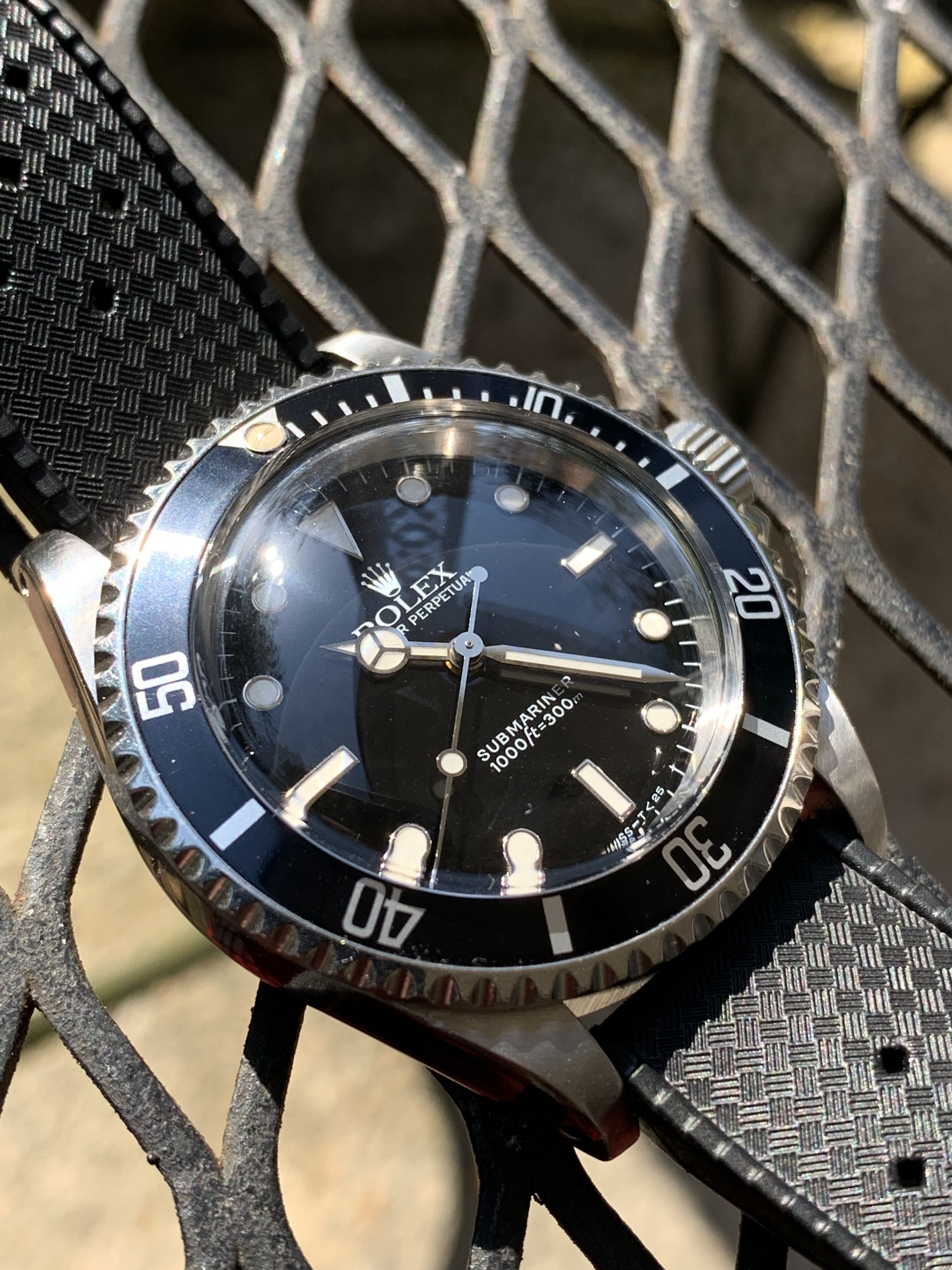

Isn’t half the point of a dive watch to wear it to the beach? 😁 A bracelet will probably see some wear with sand, but wearing it on a strap and rinsing it with fresh water afterwards should help out a lot? I am planning on buying the same watch as OP, and I plan to use it whenever I am near a water activity and my speedmaster should stay at home, but it sounds as you guys mean we should baby it because going to a beach with a diver is bad for the watch 😵‍💫
Yup on a nice dive STRAP.
