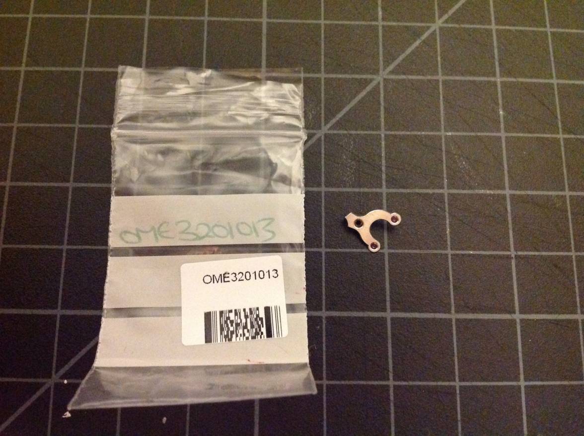

Hello,
here is a pic of the Cousins bridge with its original packaging:

Thanks very much for the photo. This is very puzzling - here we have a 320/321 part which is discontinued and not available from Omega, and which Al (Archer) has never seen damaged or broken before in his extensive experience. Bridges like this don't wear out, because you can replace the jewels if needed. And a fracture such as yours must be extremely rare. Nonetheless it would seem that Cousins (or their supplier) must have gone to all the trouble and expense of getting a pattern (repro) part made for which there can be virtually zero demand 😕

Can it be old stock Lemania? They did make all of the 320/321 movements and loads was not guilt for other labels.
15,048
24,057
Ah, I've seen this before, you ordered the standard bridge. They sent you the OME3201013-P edition, the presentation bridge.
29,675
76,836
Most certainly not original Omega packaging, or an Omega bridge. Most likely a Lemania part.

No - chronograph bridge, part #320-1013 (72203201013) and part is discontinued. OP will have to find a donor or find the part on the secondary market.
